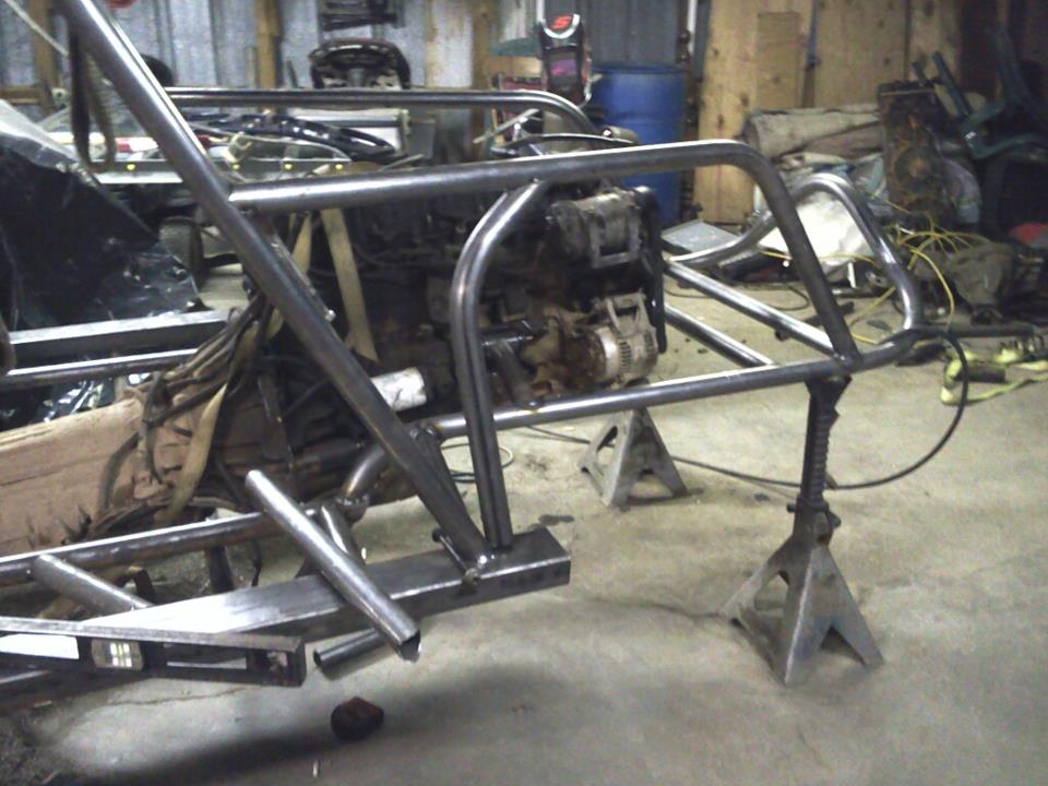

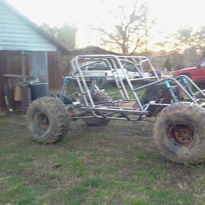

well had to cut the front off and regroup!!!! finally back where i started from took off the point on the front i didnt like it looks alot better with the new front bumper i think!!!

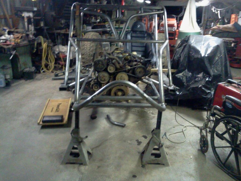

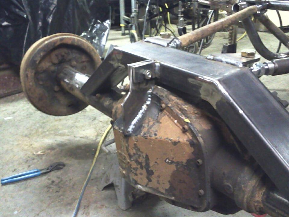

Got a little more done thisn weekend!!! Hopefully get the front 4 link done this weekend and get er rolling!!!!!

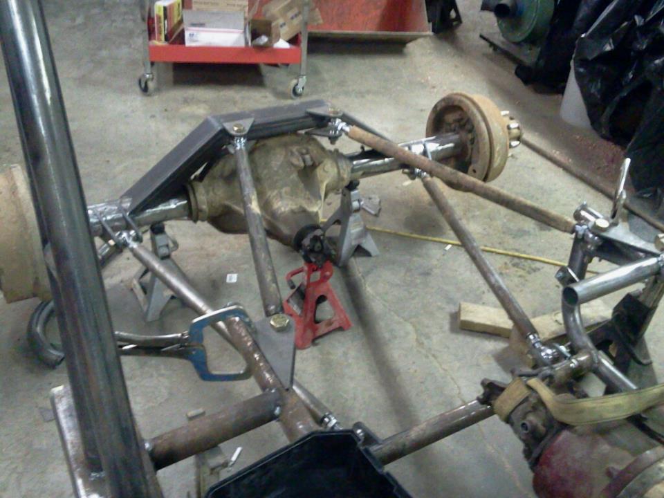

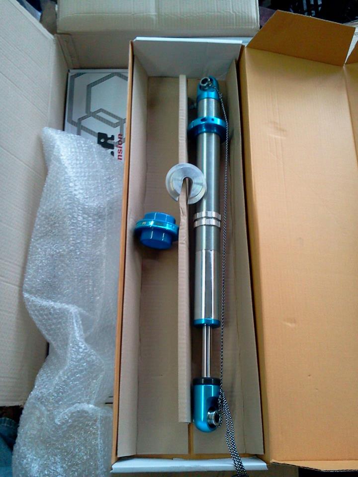

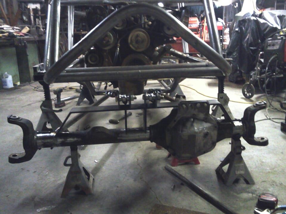

put em that way so upper links wouldnt be unlevel I try to keep links as level as possible at ride hight !!! If it put up top i would have gained 3 inch more separation on axle end!!! I checked have 9 inches up and 9 inches down travel!!!
