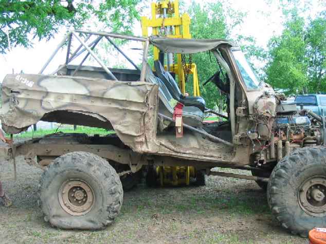

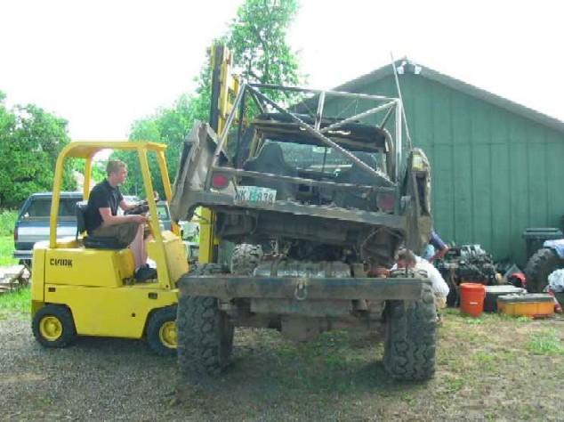

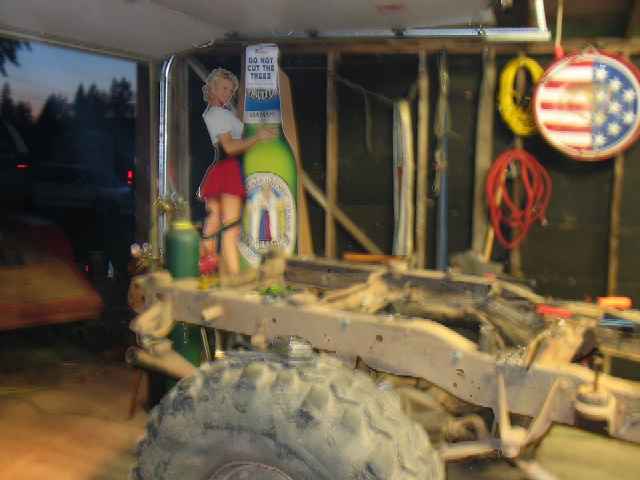

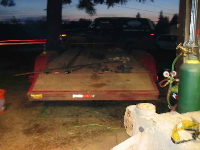

and so......it begins.....

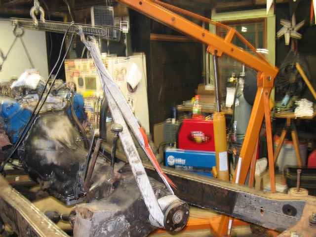

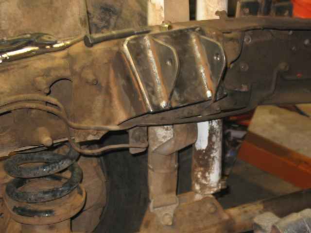

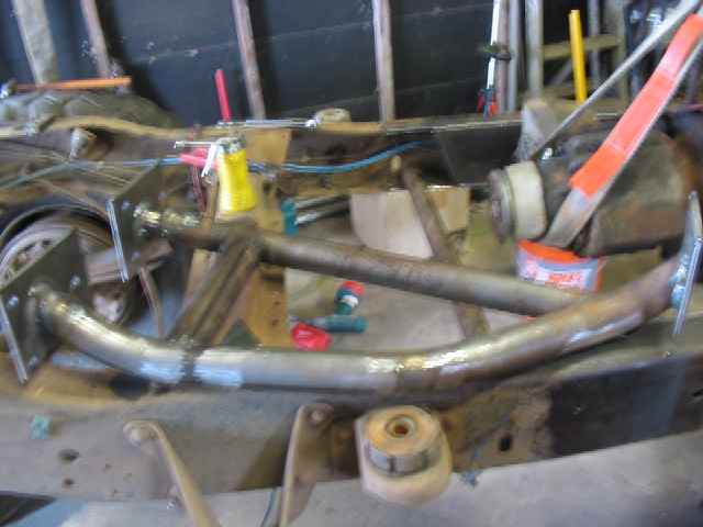

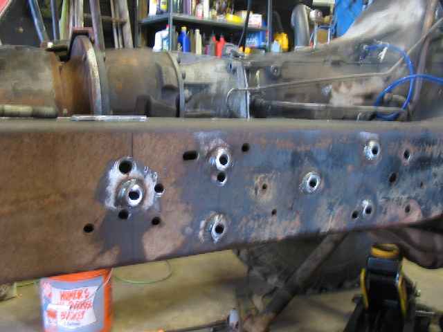

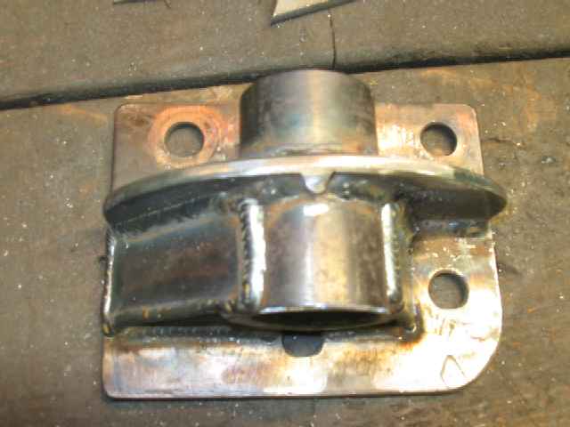

Built new motor mounts for it....

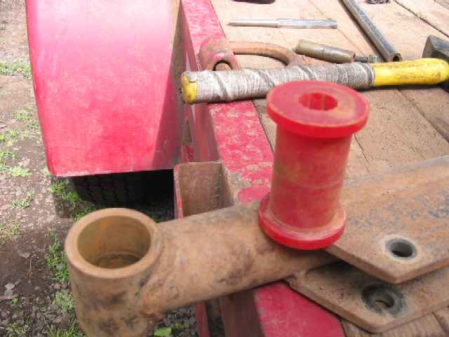

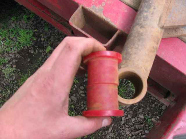

just FYI.....
these are the bushings that were in my front links.....for the past 3 years....
:kissmyass:

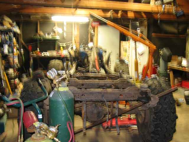

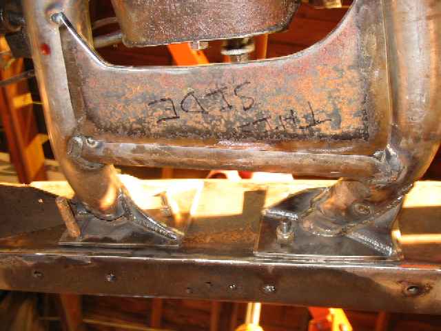

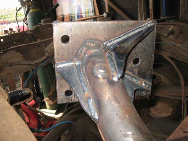

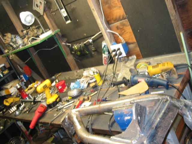

I boxed the frame where my big x-member goes, so it needed alot of re-work....its basically all new/different now...

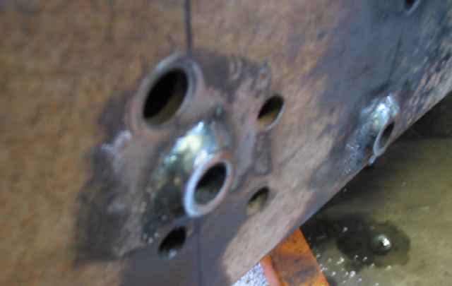

the sleeves through the frame for mounting the front x-member...

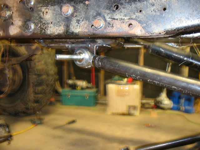

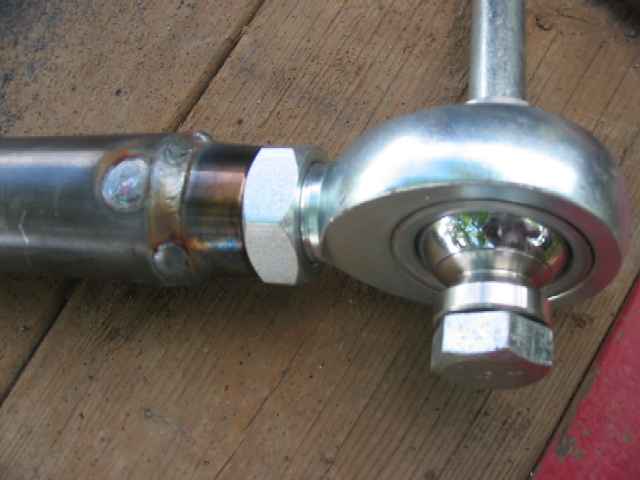

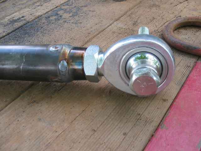

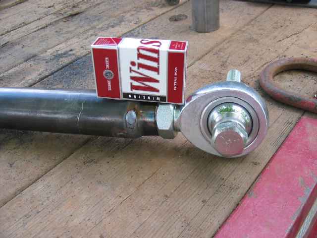

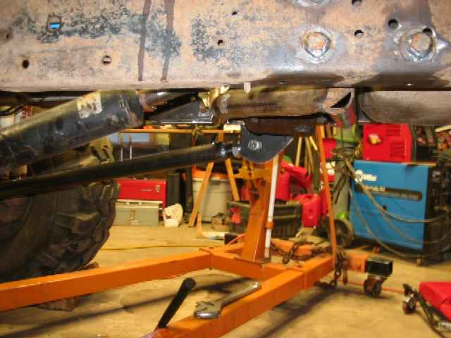

and a couple pics of the big-assed rod ends all ready to go...

I should have the front of the chassis finished up this week (need to make the mounts on the x-member for the front links and finish up the tranny mounting)
this weekend should be thestart the rear suspension....

the front suspension will stay just the way it was, something between a 3 link and a wristed radius arm setup......only I'm getting away from the radius arm bushings I was running on the chassis end (originally went w/ them because they were cheap and easy) and going to the big rod ends.
