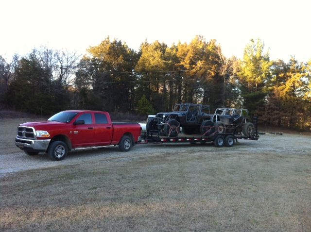

28' pumper pull, I do not see any need for a tilt :dunno:

This setup of a trailer is quite nice. Much less complicated than what you are thinking, unless you are wanting to be different for fun.
I have a tendency to over complicate things most of the time. The standard 28' low deck drive over fenders and ramps is what I will probably end up with.
I started thinking after my last trip to Morris Mountain in the rain and struggling to load the Jeep because the ramps were slick and the tires looked like big orange balls of mud, that and trailer that is lower in the back would be easier to load when muddy.
My driveway at home has a sharp uphill transition that a dovetail would drag on prevents me from going that route.
