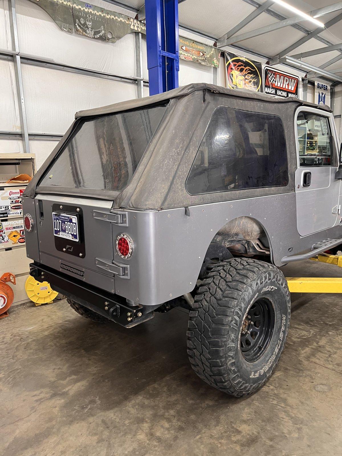

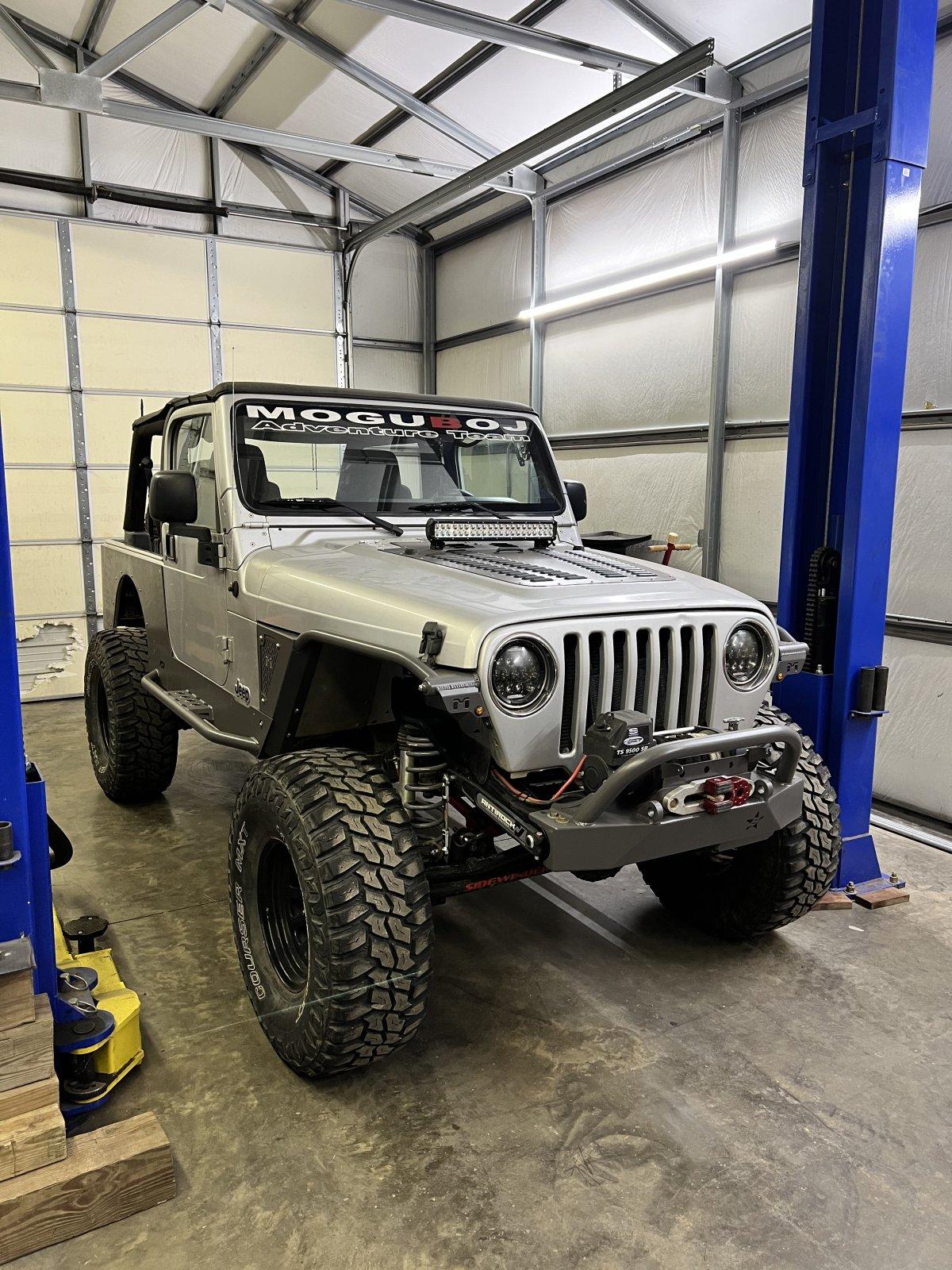

My TJ is mocked up on 40s/tons and 3" springs at 23" bottom of frame rail. 4.75-5" uptravel in the rear and a little more in the front. No real weight in it so I'll likely have to fiddle with springs later on.
