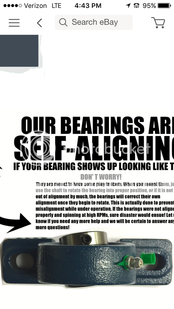

I dont know rzr's had the same size mid bearing shaft as a toyota, but on my buggy i couldnt keep a stock bearing in it due to driveshafts not being perfectly round and the vibrations. I went to this and it lasted a while noW. There is about a 1/4" of slip also so i didnt set the set screw on the bearing so the shaft has a little room to move back and forth since there is no rubber.
How tight of a fit is there between the inner race of that bearing and the OD of the driveshaft? Any noticeable wear on the driveshaft from spinning inside the bearing?
Not as of yet, it was a snug fit but i wouldnt call it tight. I figured if it does start wearing you could grab the shaft and feel movement and so far so good. Tight just like when i installed it.
