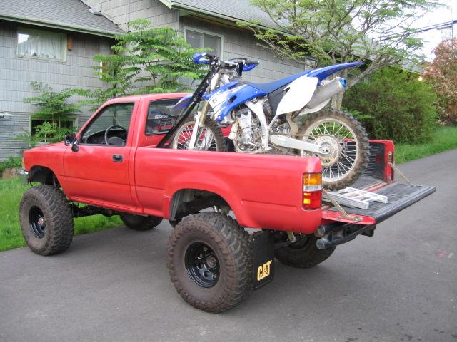

it's not relevant but i threw a pic in just for the hell of it.
