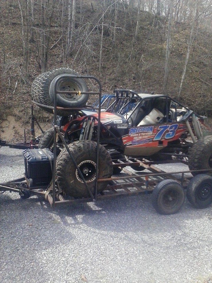

Get with Bobby Potts(I forgot his HL user name),He runs this setup. I stole this pic for his FB page.
