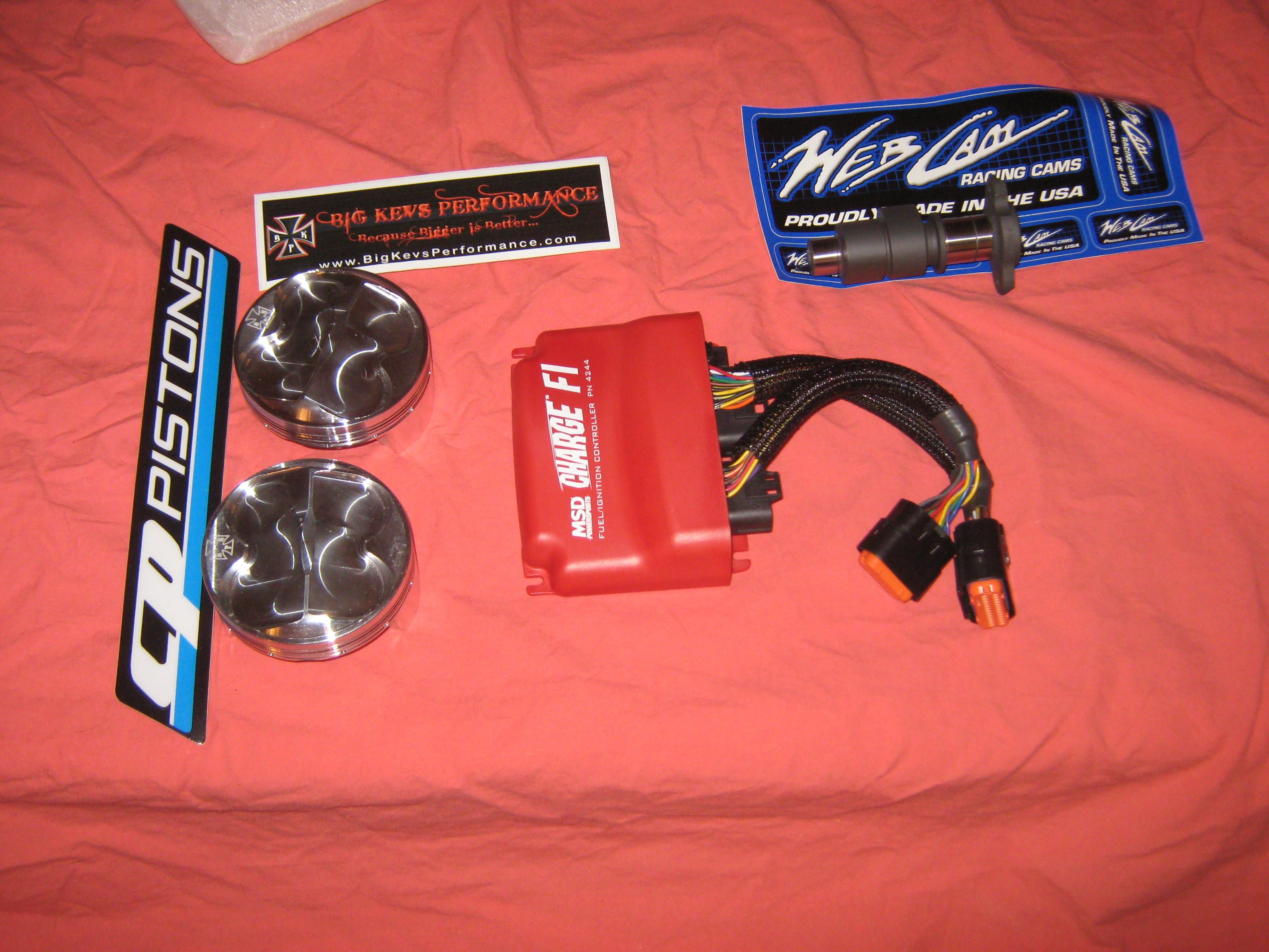

tyrex build !!!!!!!! booyang loller.gif :drinkers: :drinkers: :drinkers: :drinkers: coming soon !!!!!!!!! :spin:

thats what im hoping for anyway tired of being in da back ,guy i bought the kit from says its gona eat a 800 rzr up ,im kinda excited,he builds custom race kits .
it already has gas shocks pretty much go fast ,really just wanted a lil more for climbing long hills and short distance runs if it helps it as much as it helped my buddys brute its going to be awsome well see ,ill post some video when its finished,were pretty much changing everything on top end ,valves injectors ,clutch spring dual muzzy exaust igniction ,air box, with 12.1 compression. ,stage 2 race cams ,valve springs, well see what happens. :driving: we do alot of river, dirt roads, and powerlines where i live. gona try to make windrock in oct, hopfully :dunno:

just a lil woompow ,heck if i keep on up grading coulda bought a xp ,next thing its getting is power stering its worth the $$$$
got the pistons waiting on my heads they should be here wed or thur ,hopfully by sat or sun gona bust er off :driving:

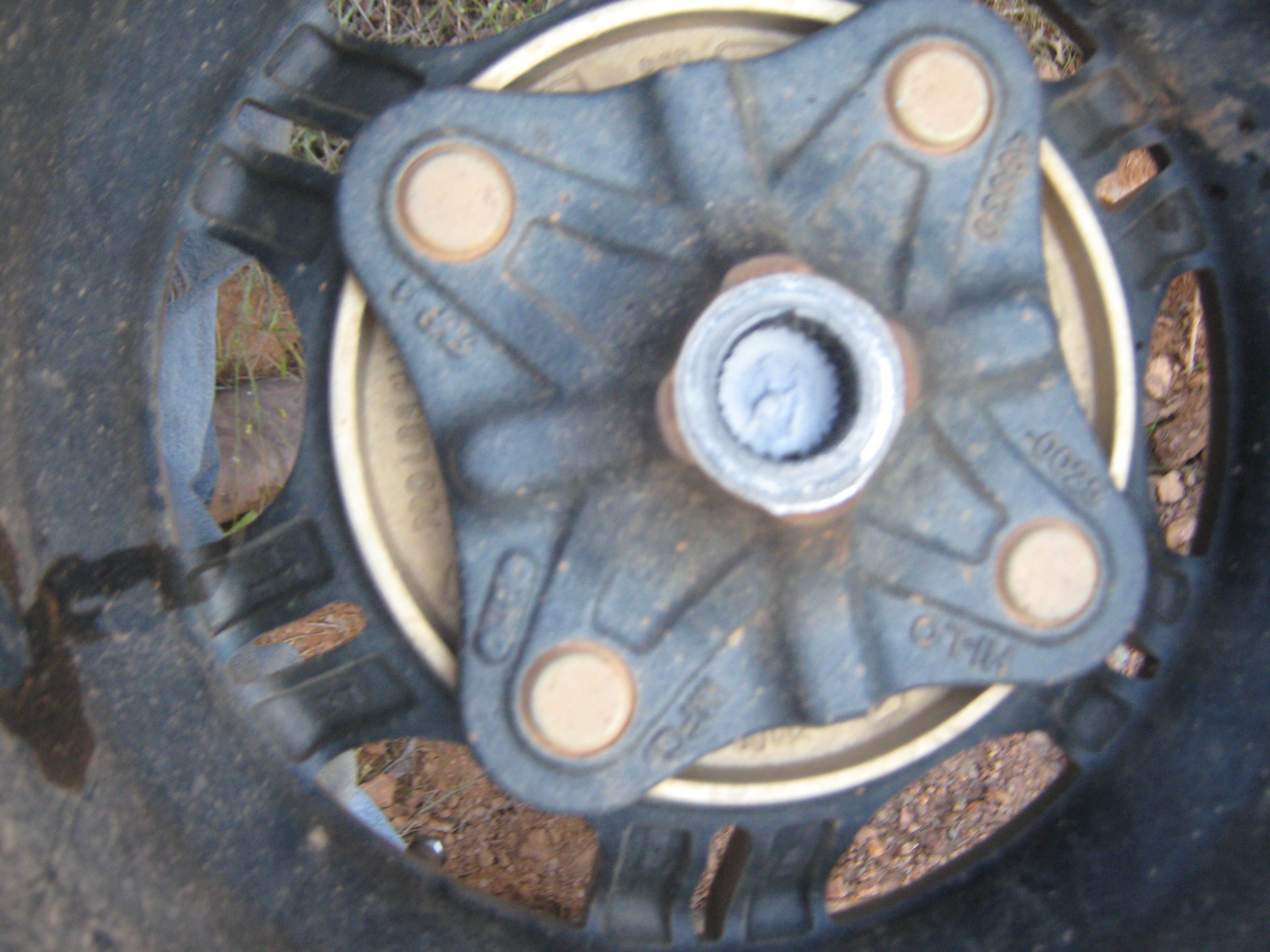

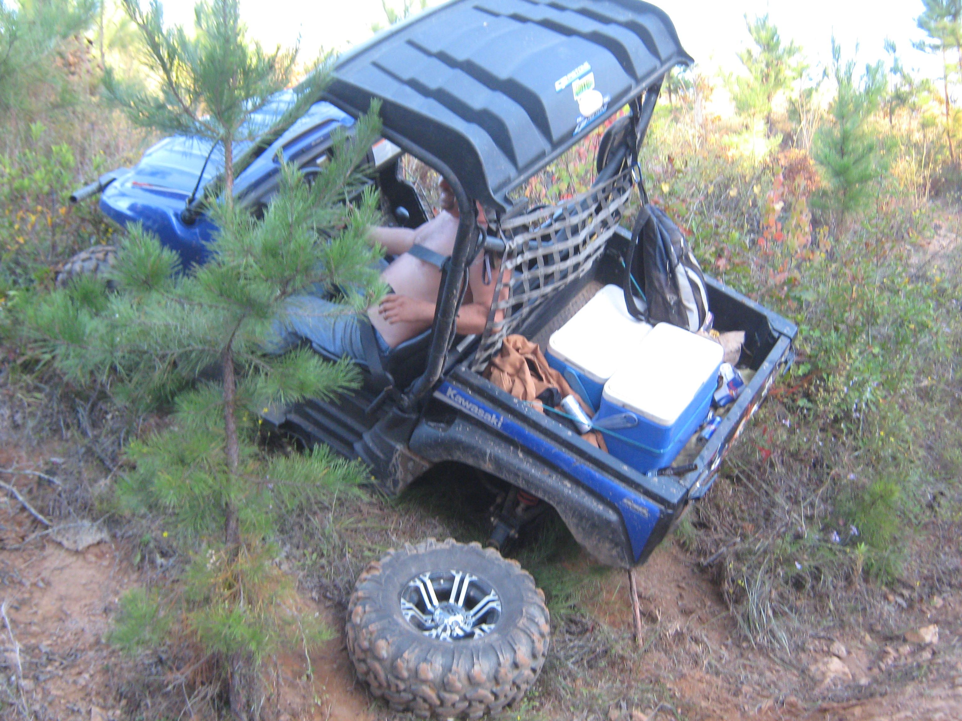

this is what happen s with new hp ;D
