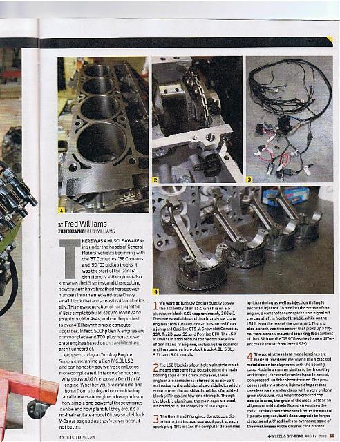

vortec 327s out of an 04ish tahoe i beleive. are they worth a ****? how much do they go for? would anybody be interested in it if it were to come up for sale?
Yes they are worth a **** depending on what you put them in. Price range varies depending on what all you have wiring harness and computer.
There is very many options to make big power out of the ls series engines. The 5.3 is a great engine to start with.:awesomework:
the 5.3 is not worth **** performance wise. It is a great, moderate power, awesome reliability motor, It IS NOT an LS series motor, it is a 3rd gen motor, if you are looking to build serious power start with any of the 6.0 liters perferably the LQ9 which is the hummer/escalade aluminum head 6.0 put the GM performance parts hot cam setup in it, get the msd ignition controller, edelbrock manifold and a nice carb, do this and you will be in the 450-475hp range
Screw that carb ****. You can get aftermarket harness and computer with only 5 wires to hookup, and no emissions to worry about.

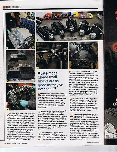

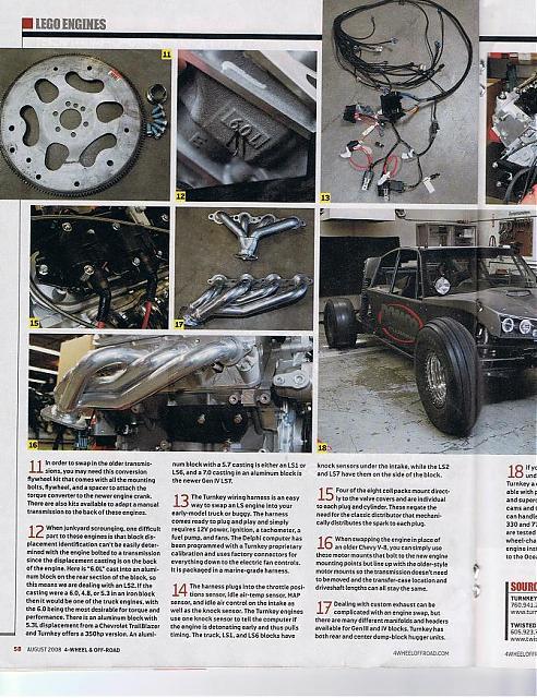

:rolleyes:
If you have good eyes read up.
