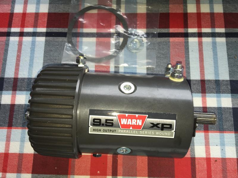

Got the motor today... Amazon shipped it usps... Then they shipped the pinion ups... Go figure... Lol
Should've told em it was going on a 8274... They put the sticker on upside down for my application... Hahaha... Oh well... Functionality not looks right?!?

Waiting on the pinion now.... Simple bolt up... Had to find an extra washer to put the ground onto the outter housing bolt... And bend the flange flat on the mounting bracket for the solenoids so it would slide underneath the finned end cap... But other than that... Super simple.
Pinion arrived... Took about 10 seconds to install... Looks good again... Freespool works fine... I may want to reinforce the back of the winch case... Pulling on the motor front to back I can get a little flex out of the case... Will see if it becomes an issue.., I've also heard of guys reinforcing the right side spool case by adding a rod across the back...
