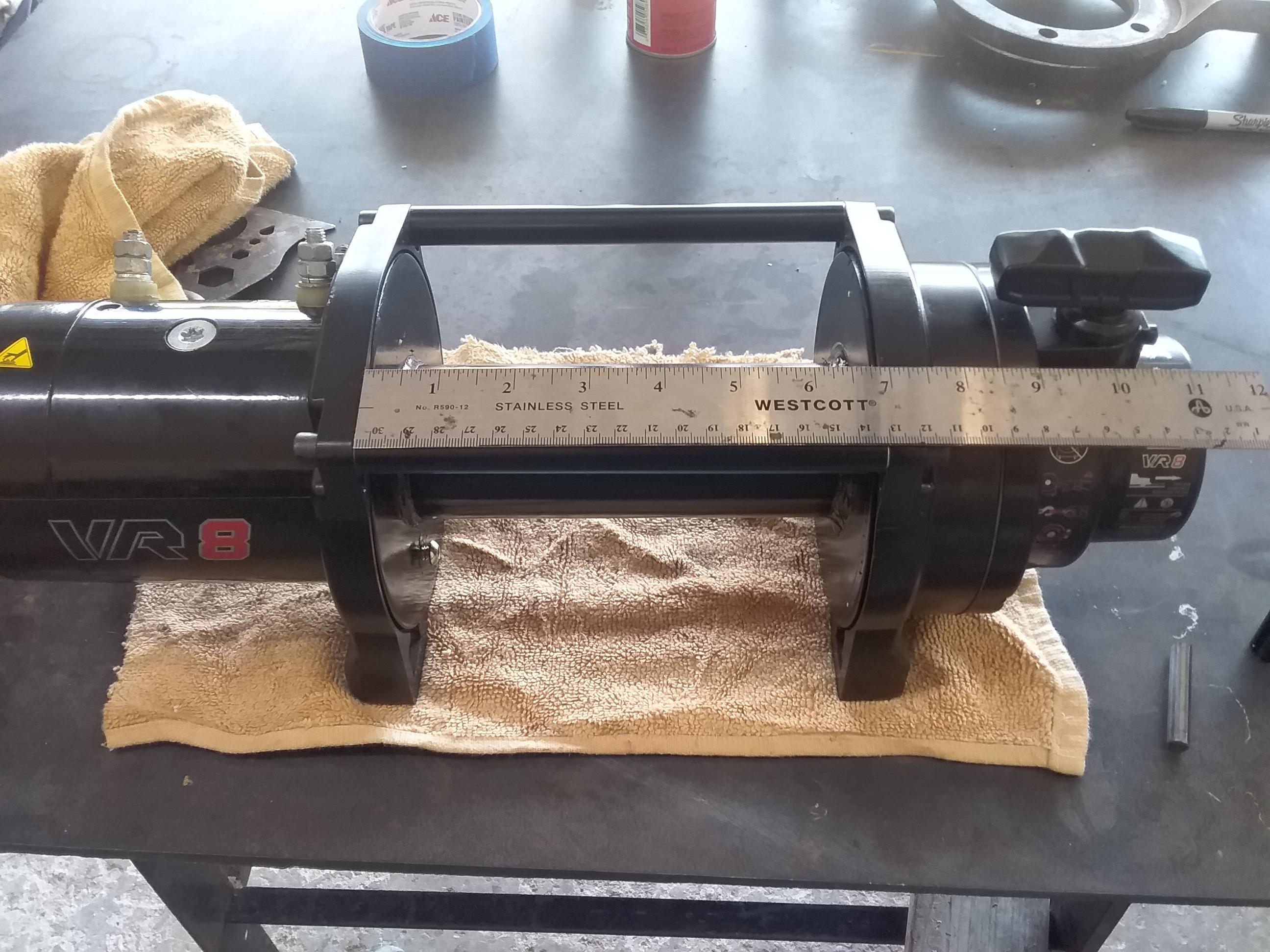

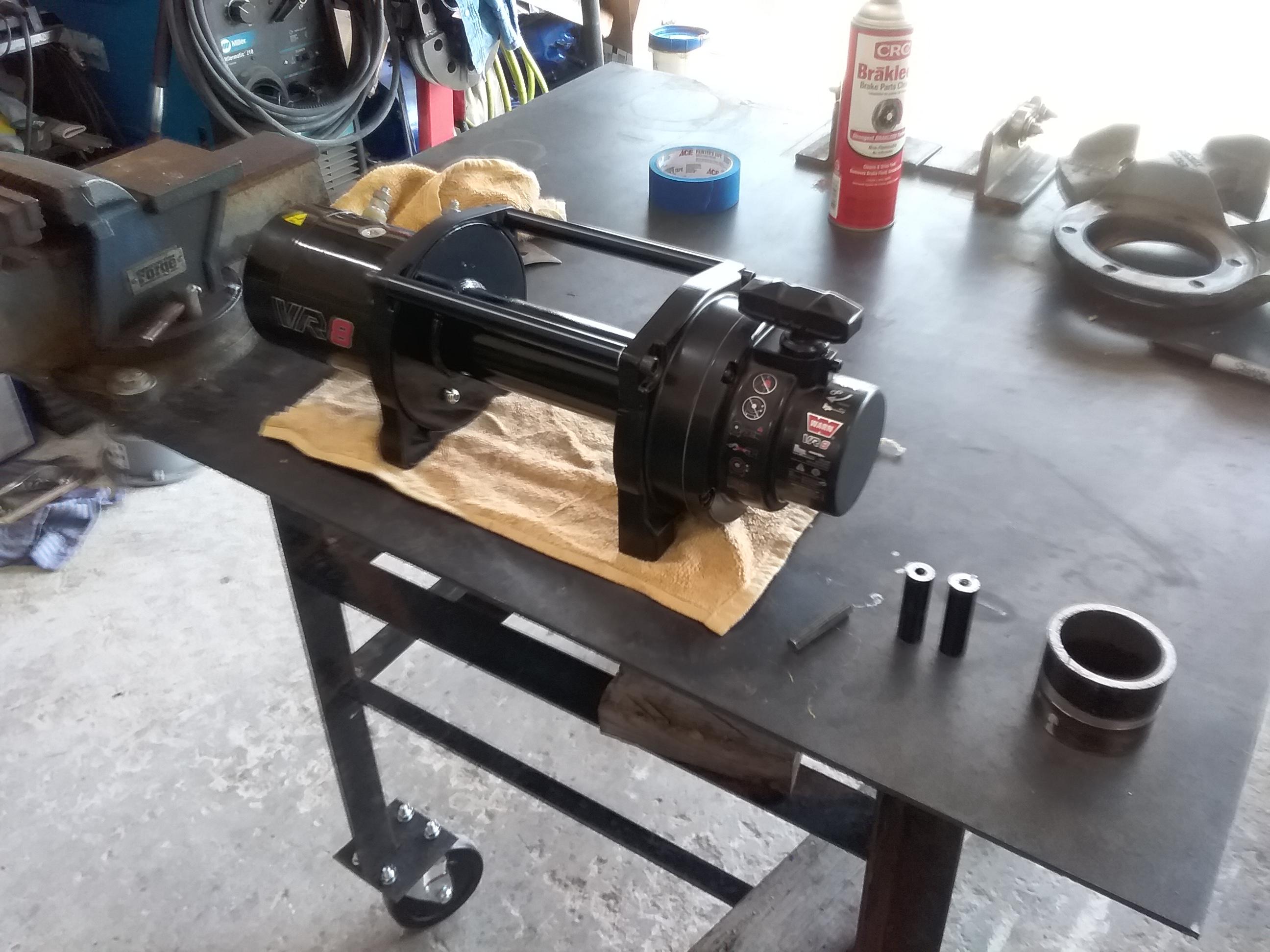

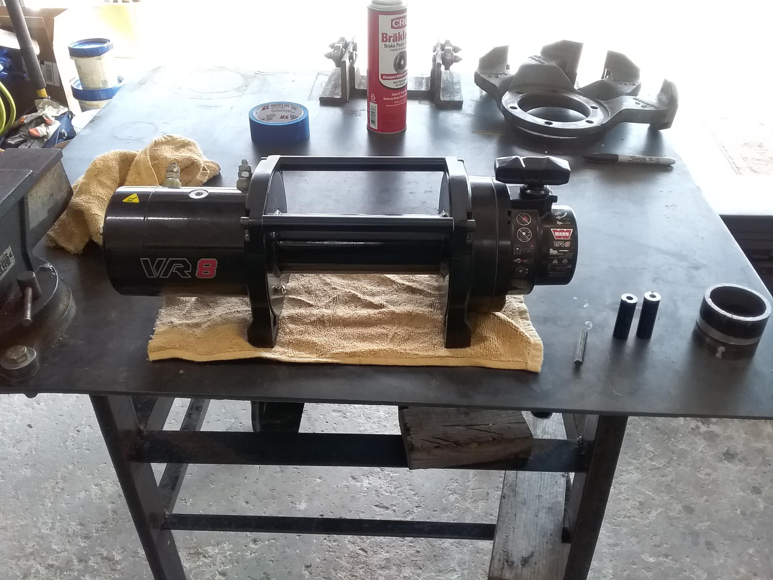

So I got bored today and torn my warn vr8 winch down .reasoning do to a tight fit between the frame rails.
total time to narrow was about an hour or so.
Narrowed up 2"
I machined the weld off the splined hub,then the drum end plate weld off,cut 2" off the tube welded back together.simple to do
I was looking into the rc9.0 but really wanted more then 45ft of cable ,so I bought the vr8 as a experiment. here's how it turned out !
