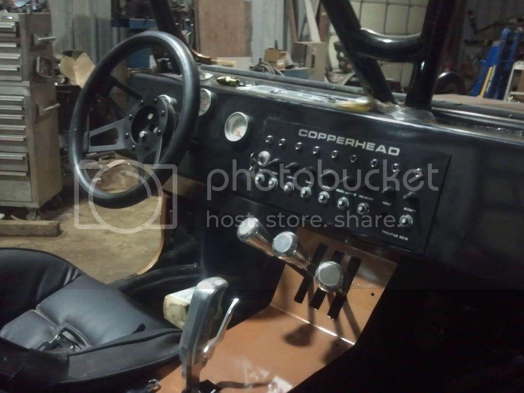

Heres a pic of in the car, you can see the eyelet on the shifter(lower left lever)

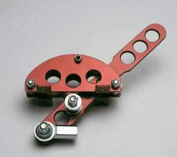

i was looking thru the pics of the essentially off road camaro buggy and noticed it has a cable on the tci circle track shifter.....does anyone have any way to snap some more pics of what the setup looks like inside that console. i have an idea how they did it, but i would like to see it.....so i can copy it :dblthumb: im trying to keep the cable setup in the jeep instead of the rod
This is the only setup we use here around the shop anymore for offroad rigs the feel and quickness of the circle type shifter is perfect for rockbouncing.
We make a kit for these to go cable style. It is a great alternative to the other shifters out on the market... for allot less too.
Jimmy
I took a $260 B&M shifter out of this rig to get rid of the stretchin'-ass always out of adjustment rustin' up fulla mud replace it every season $60 F'n cable.

does that kit allow it to work with a B&M cable also or just TCI stuff.....not sure if there is any difference in the 2?
I send my own cable super heavy duty and with thru eye mounts no slip, quick disconnects and it want chafe through in a week.
