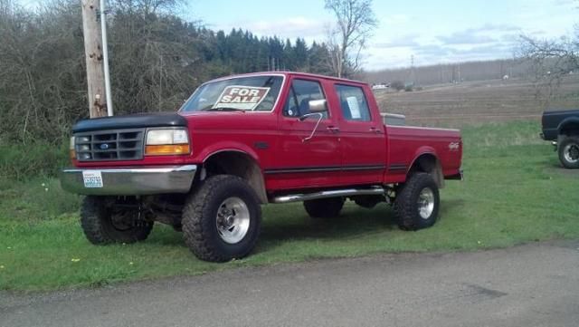

Here is the pickup that may receive the swap.
