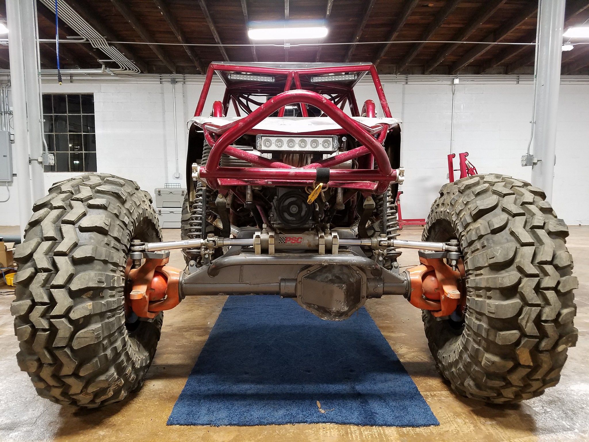

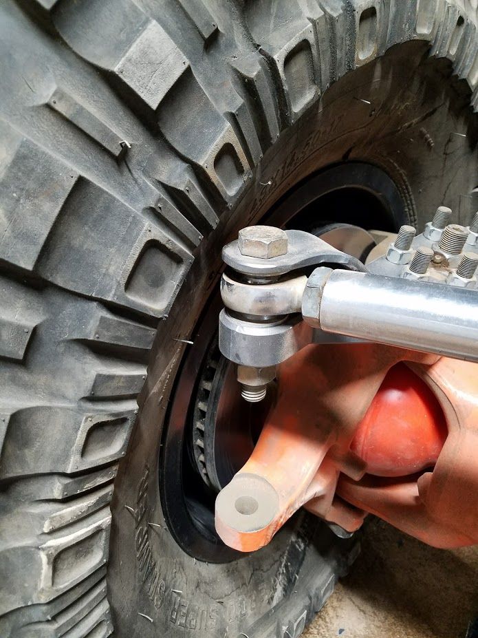

Beerj said:
Looks flashemifyougotem
Any clearance issues with the steering?
I ended up going with the Raceline 17x9.5s w/4" backspacing, got a deal I couldn't pass up. I got a **** hair of clearance at the arm. I'll keep an eye on it and if it seems to be rubbing excessively I will have the arms redesigned to bring the heim more inboard but still have a hole to run a long bolt for double sheer. It's a smooth surface there though and even if they do kiss I don't see it being a big deal. I can steer lock to lock though and the tire just barely kisses the link at full lock if I'm cranking on it. So I'm happy about that. I ended up being 88" wide overall and gained exactly 2" under the pumpkin.
