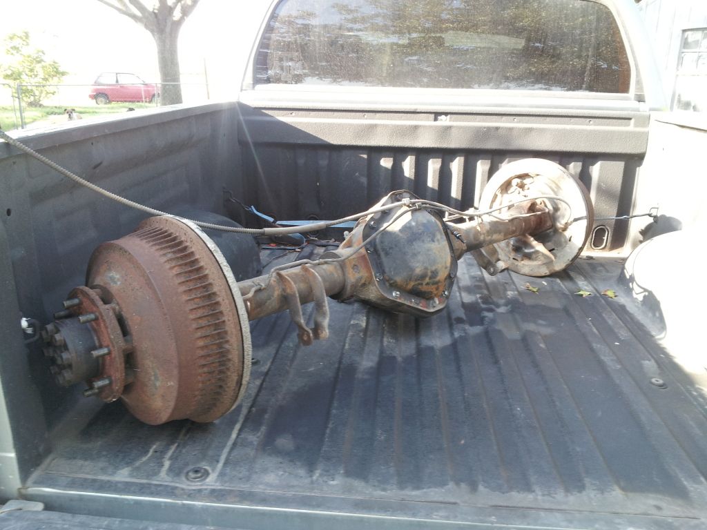

This was posted about in my initial "most desirable 14 bolt center" thread although I didn't realize the significance of it at the time. Some decent tech in that thread, it's worth a read.
http://www.hardlinecrawlers.com/forums/index.php?topic=51637.msg599740#msg599740
I've already done some recon and found that a junkyard just a mile down the road from me has a bunch of these vans. The guy on the phone had his mind blown when I asked what the diameter of the tubes were so I'm just going to go this week and check them out for myself. If anyone knows other models/years to look for post it up. Seems a 14 bolt center with thick casting capable of taking a 4" tube is the ticket. This will allow me to retube with 4" .25 wall tubes, be stronger, and lighter overall than the more common 3.5" 1/2" wall. Not sure on the weight difference but pretty sure I read a thread on pirate where someone did a material analysis on the two and the 4" .25 wall was lighter and significantly more resistant to bending.
Here's a picture from that thread I linked for reference purposes. You can clearly see how thick the center is where the tube presses in. Thanks to the_white_shadow for the info.
