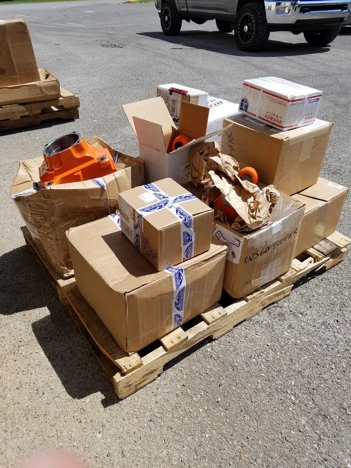

Almost time to stop ordering parts and start assembling this turd. I plan to drop the axle off at the machine shop after labor day to get retubed.
