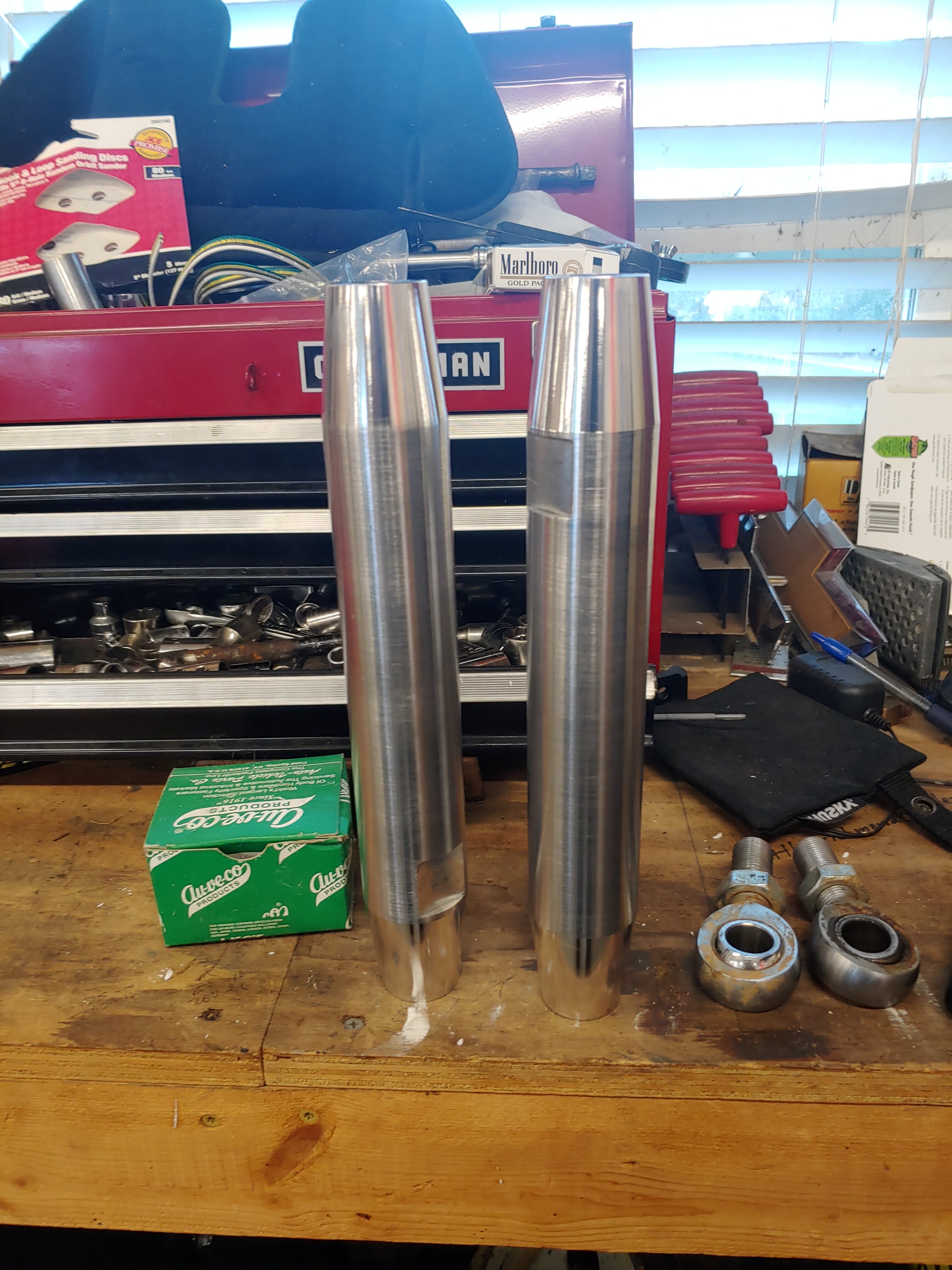

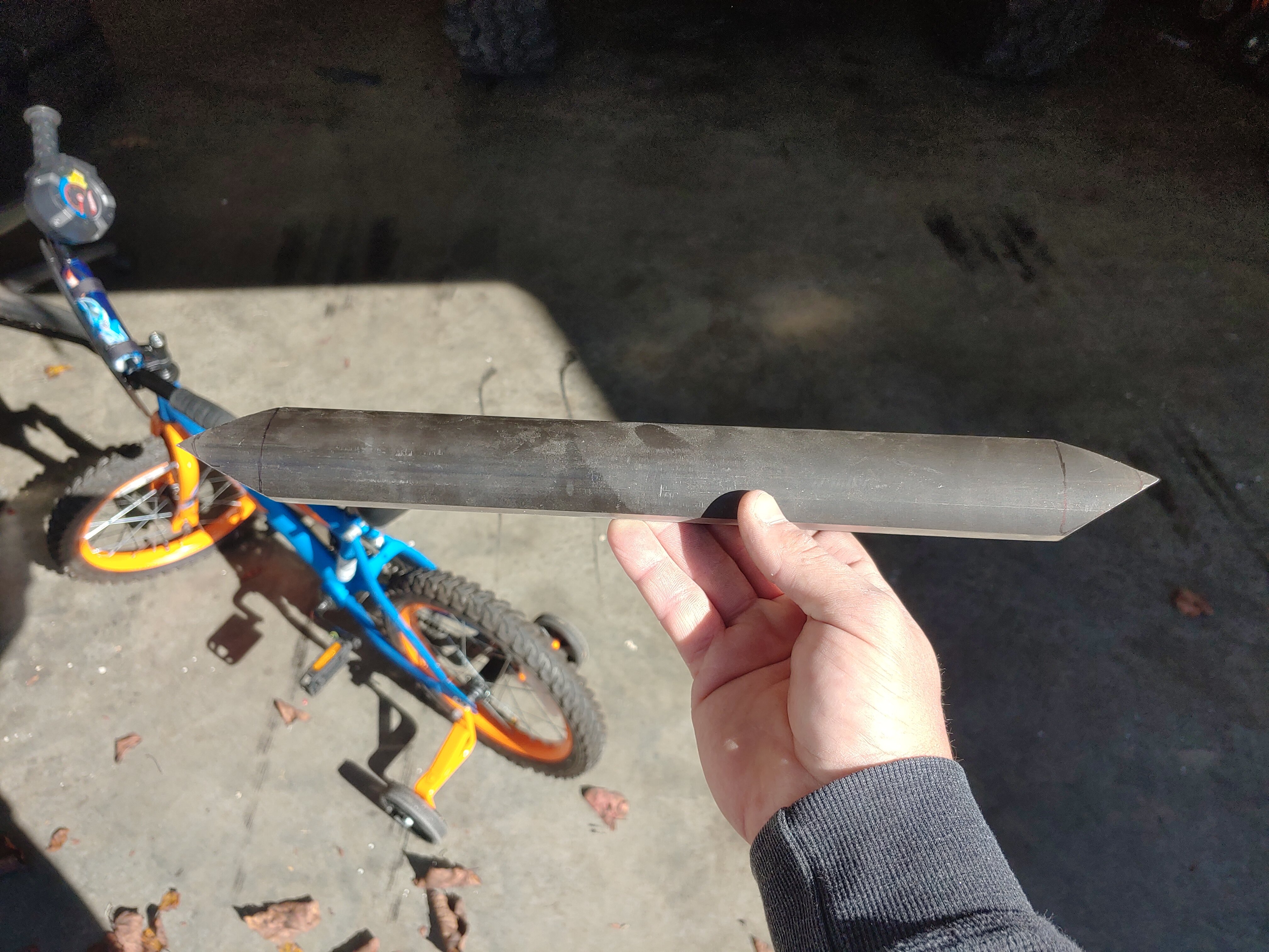

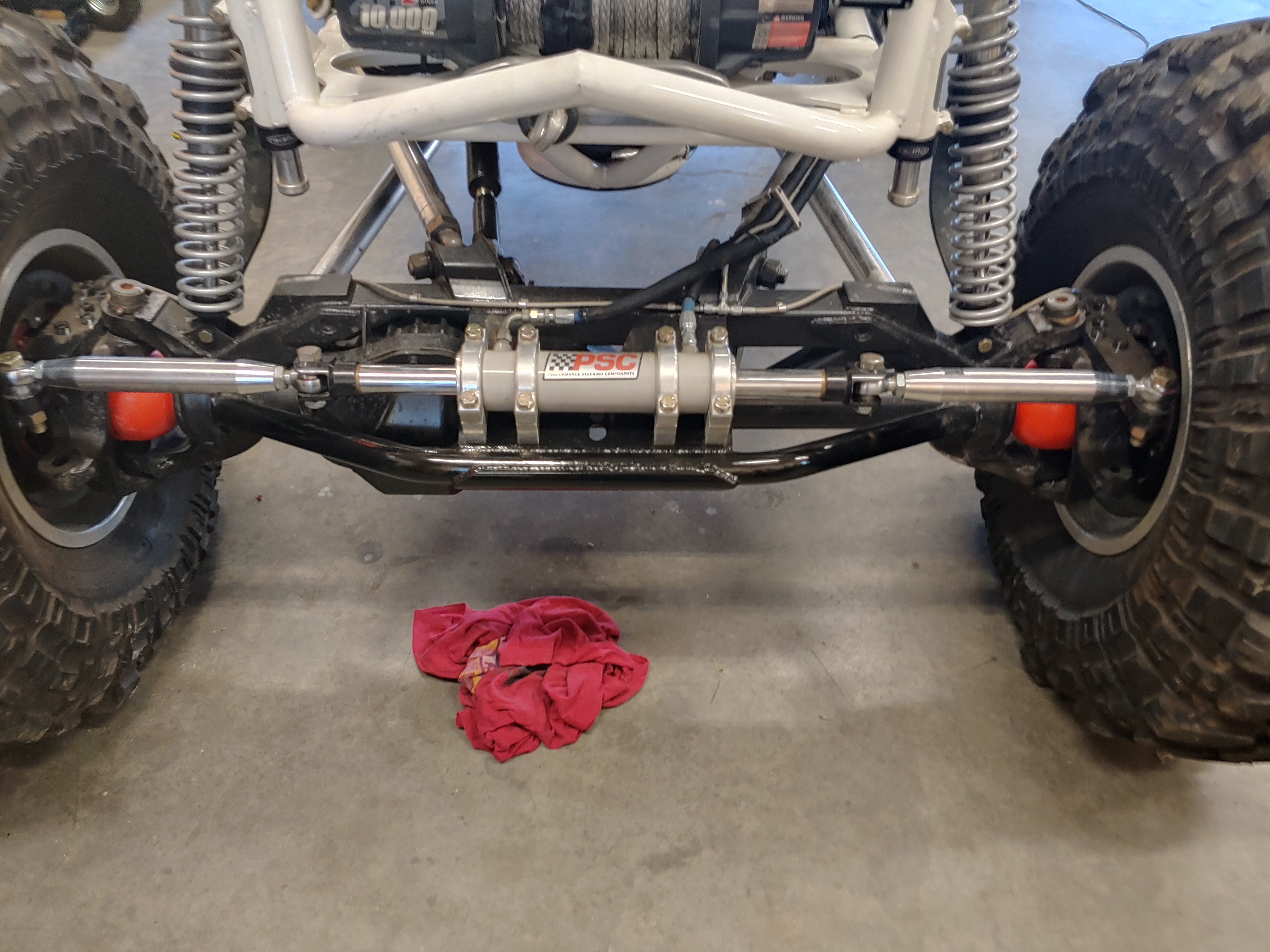

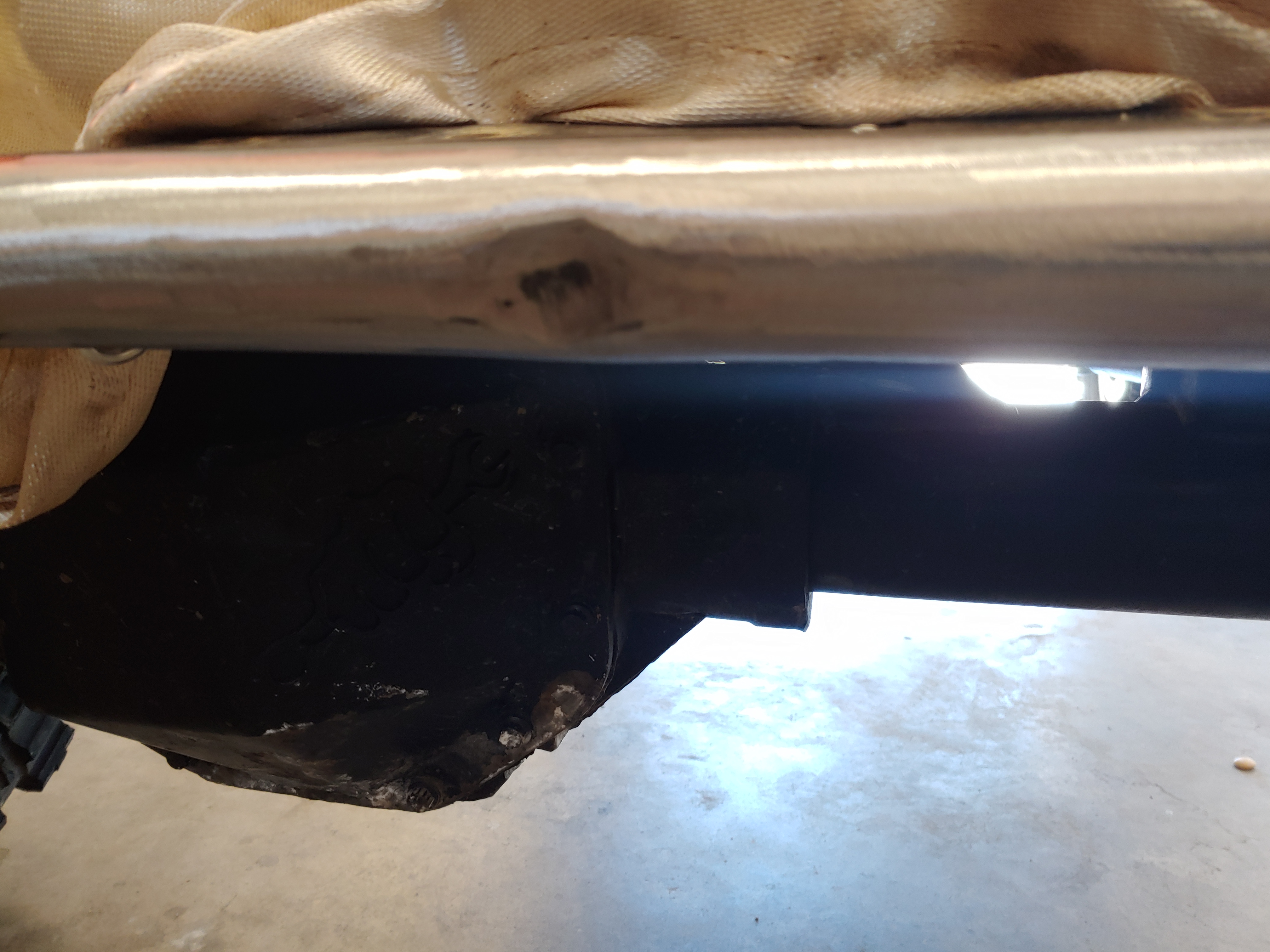

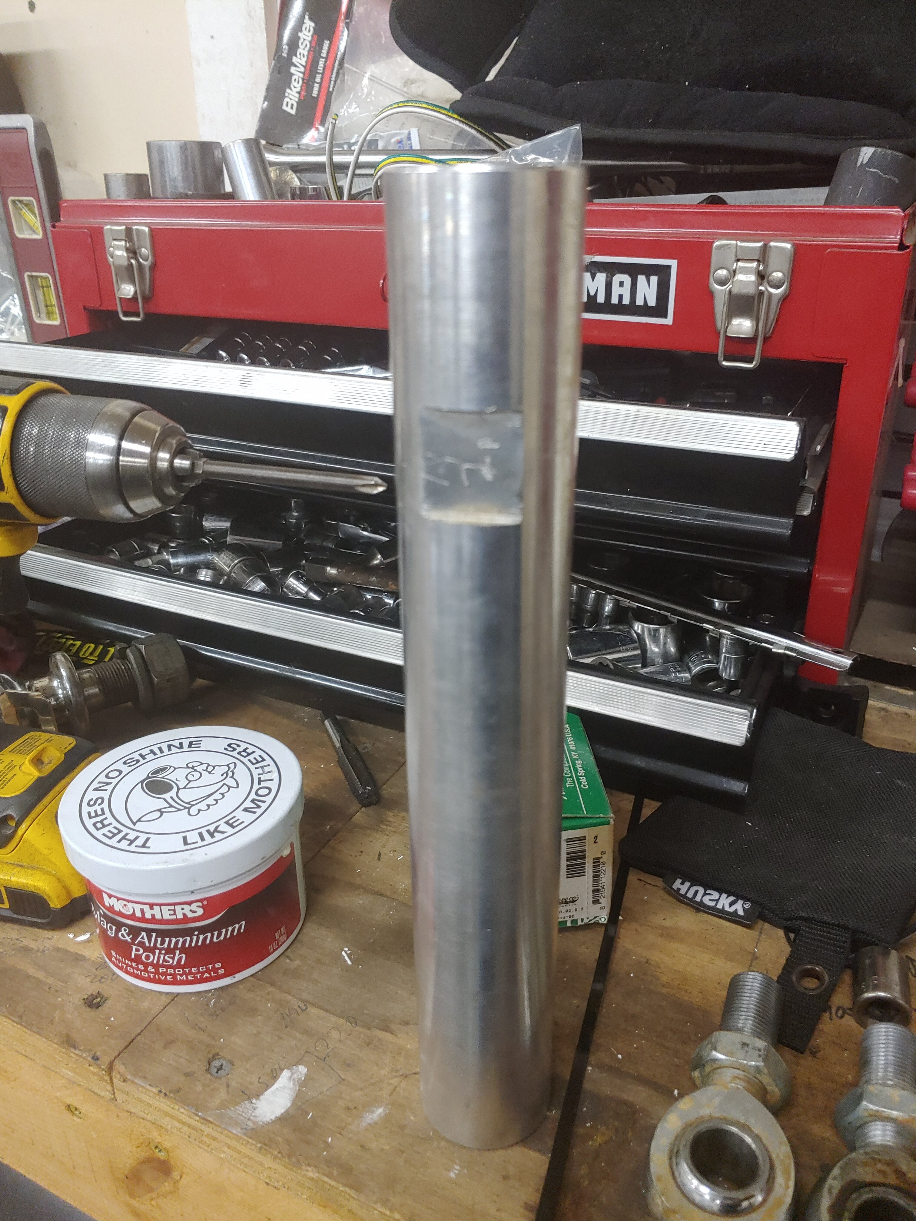

A few of us went riding a few weeks ago and I used the front axle to bust some rocks. In the process I put some dings in the front ram mount. To keep that from happening again, I went and got some 1.750 id .250 Dom. I had a piece machined a piece out of it to scab onto the outside of the 1.750 mount. It turned out pretty good and should not get anymore dents in it. While I had the front end apart I had the tie rods turned down. That way it would no longer be a huge shoulder and now it they are tapered down to the jam nut.
