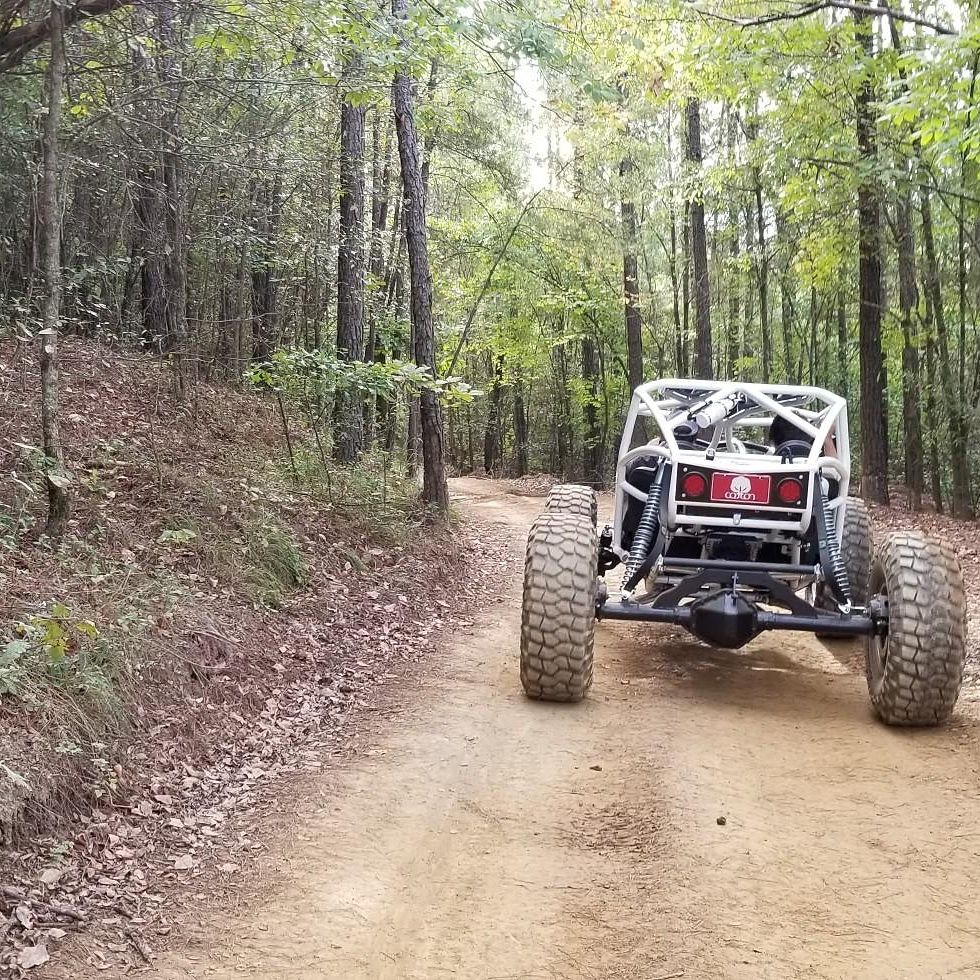

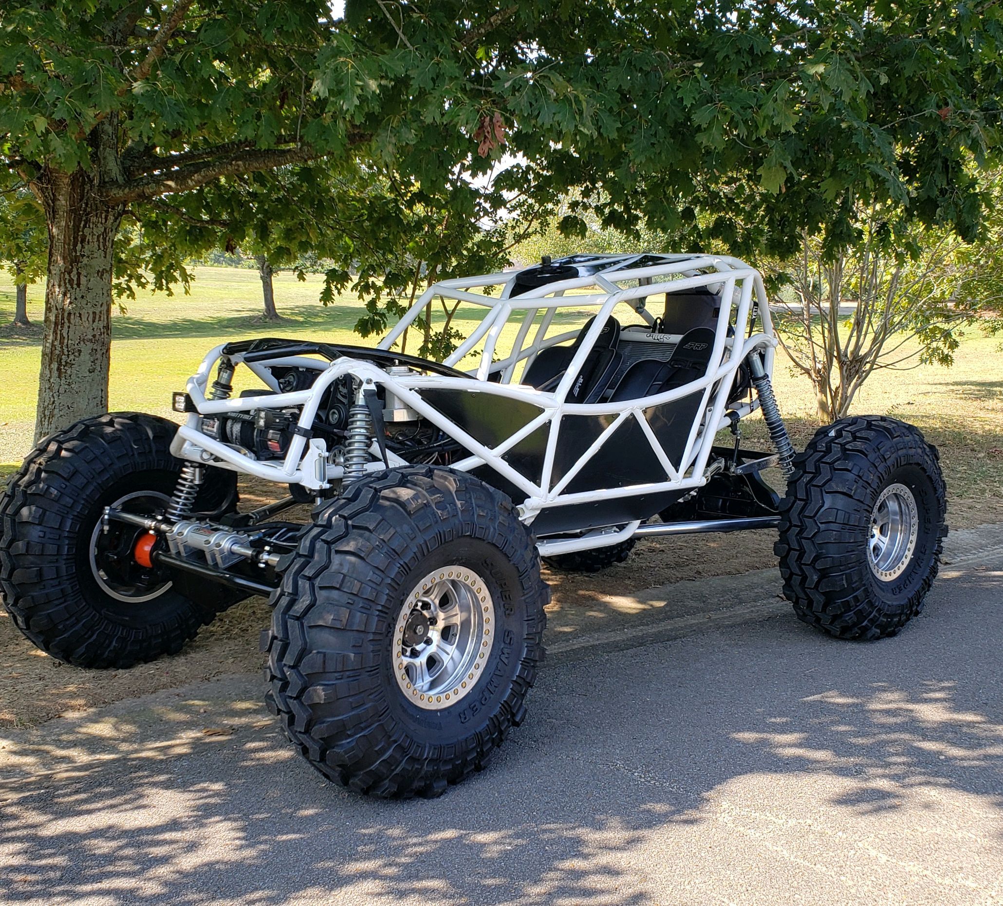

Picture from yesterday.
    972.1 KB

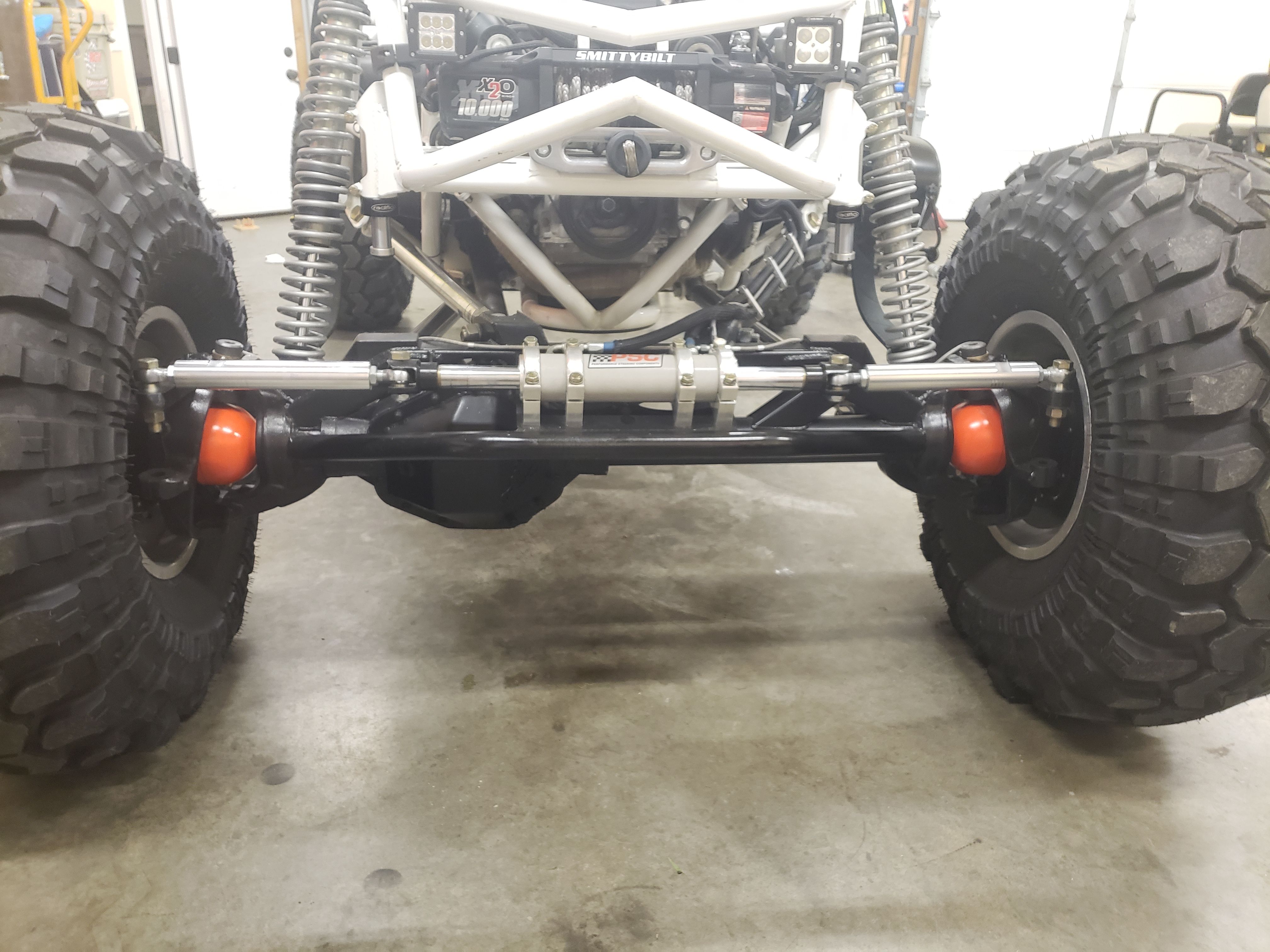

ridered3 said:
Looking good with the new front axle and 43's.
Why the switch from Reds?
Primarily ground clearence and durability. I never had any problems with the sidewalls with the reds. The reds work amazing. That's my only reservation is that these wont work as good as the reds. Honestly, I was always very careful not to go full bore into any jagged rocks with the reds. Hopefully now I can push the buggy a little harder.
Figured it was a clearance issue since you have been a Reds guy for a long time.

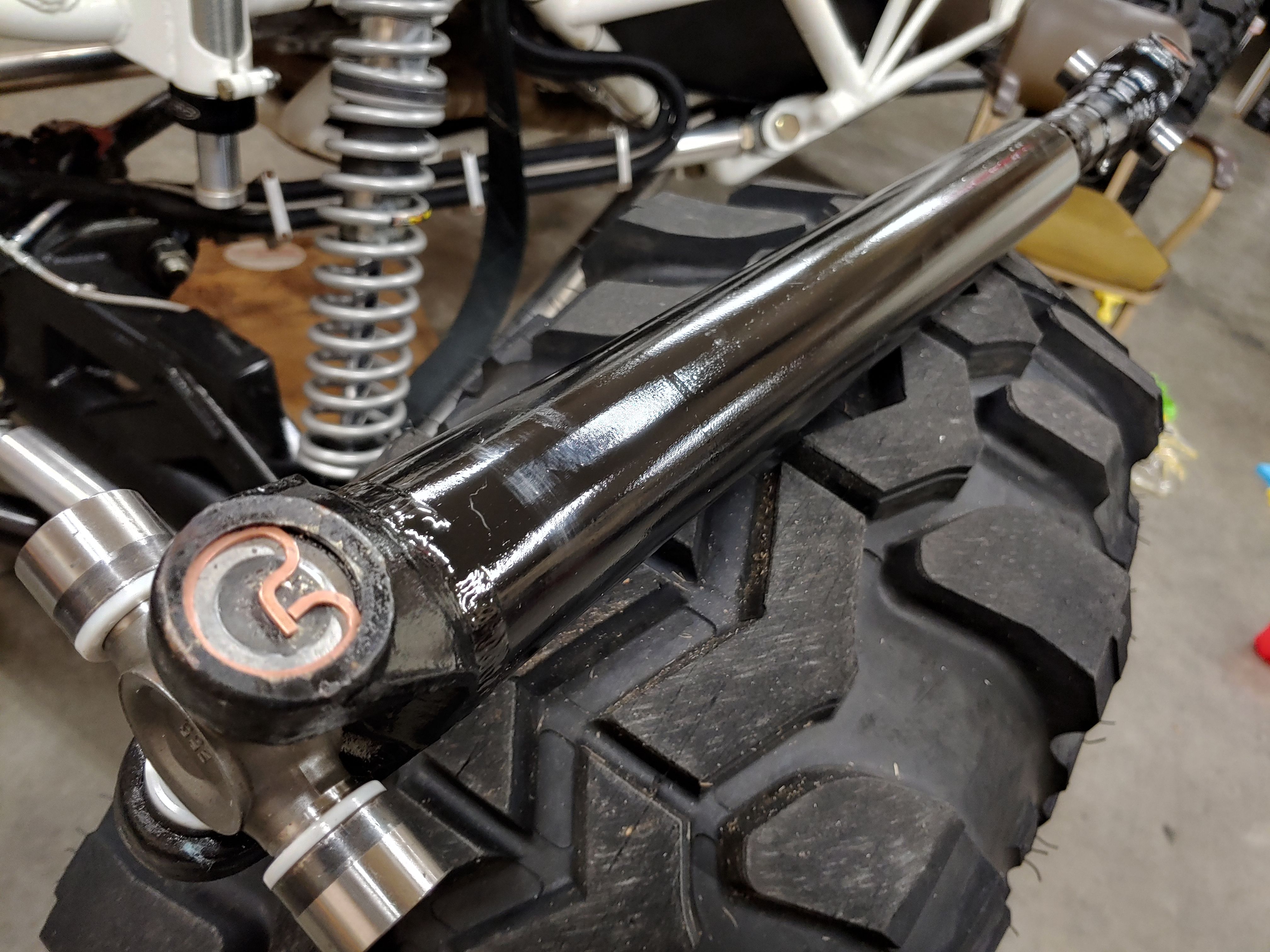

What issue did you run into with the old rear shaft?
No, issues. I just wanted to step up to a 1410. Also the old driveshaft was a thinner wall. It had some minor dents and scratches. Now I can have one long slip driveshaft made as a spare for both front and rear.
Just kind doing like the Jeep. Trying to keep upgrading parts and having the next upgrade planned out in advance. Next performance upgrade is going to put reserviors on the shocks. Creature comfort things will be cooler holder and a sound bar. Who know when they will happen.
Was the old one .120 wall? If so I'm cutting it open and sleeving it. :cool:
