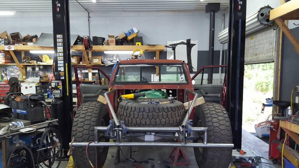

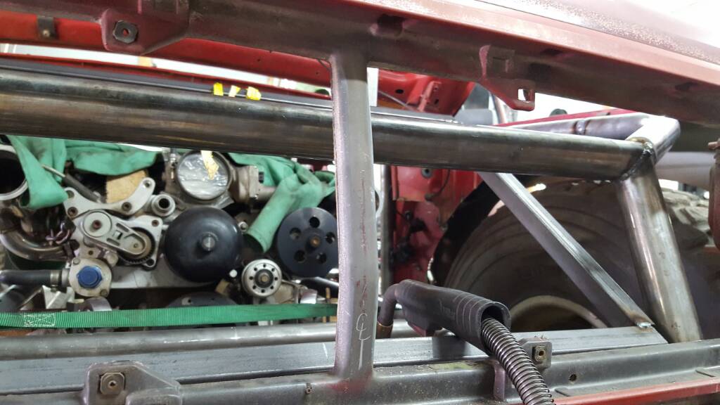

90's throw back....Manche build
More progress pics, but tapatalk won't load this thread for some reason. Can load any other thread but won't connect to this one, and I've reset everything, dunno. I'll post more pics soon as I get this sorted. Thanks guys
Finally got it sorted...

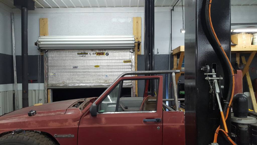

Mo work...
auploads-tapatalk_cdn-com_20160630_993c41a05c544cb96edbe34c7c9ec6b6-jpg.222116
auploads-tapatalk_cdn-com_20160630_a99a407b8a548c41f3e5870fb8b51590-jpg.222117
auploads-tapatalk_cdn-com_20160630_521b1d882e86d3f9efc49efe7da61649-jpg.222118
auploads-tapatalk_cdn-com_20160630_ea4b98b8458bc6d1a830f028b827eb0d-jpg.222119
auploads-tapatalk_cdn-com_20160630_cc71a85737e96618992839193ba2978f-jpg.222120
auploads-tapatalk_cdn-com_20160630_4952944fe259b58367d54c7092518aec-jpg.222121
auploads-tapatalk_cdn-com_20160630_a82300c929a8356f54db604764206bd9-jpg.222122

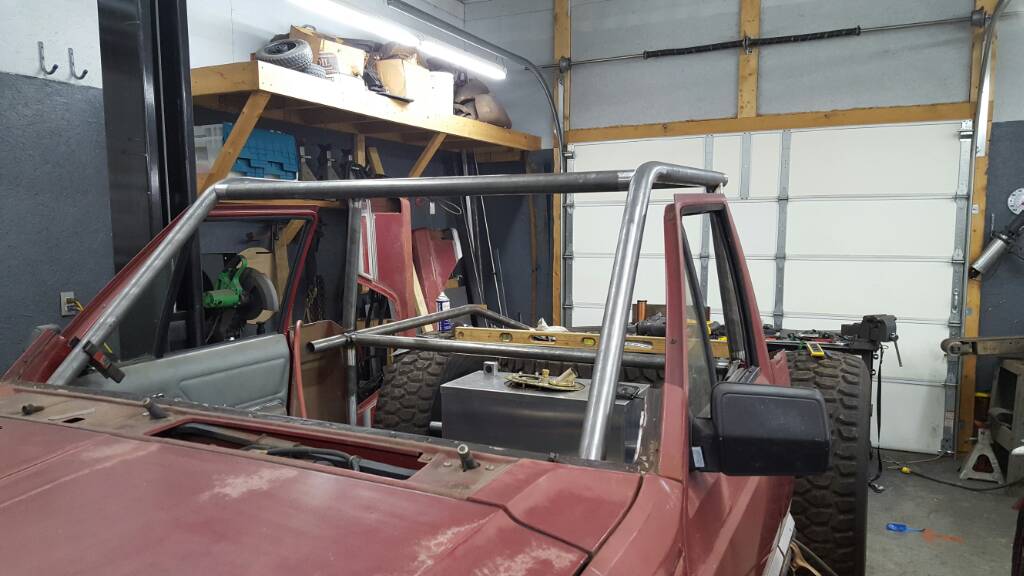

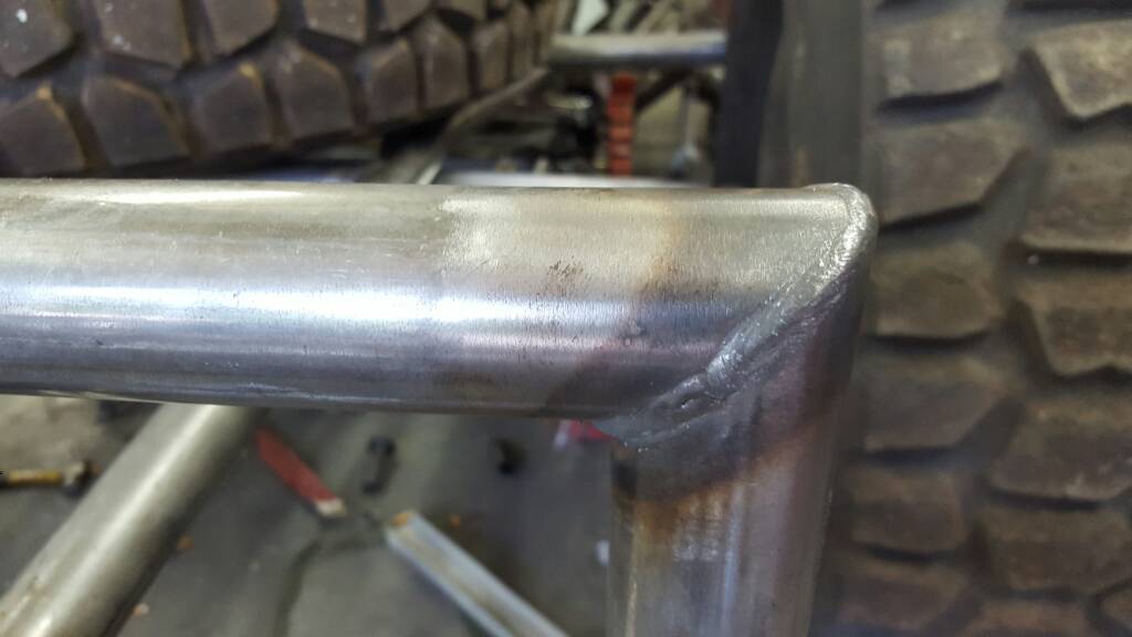

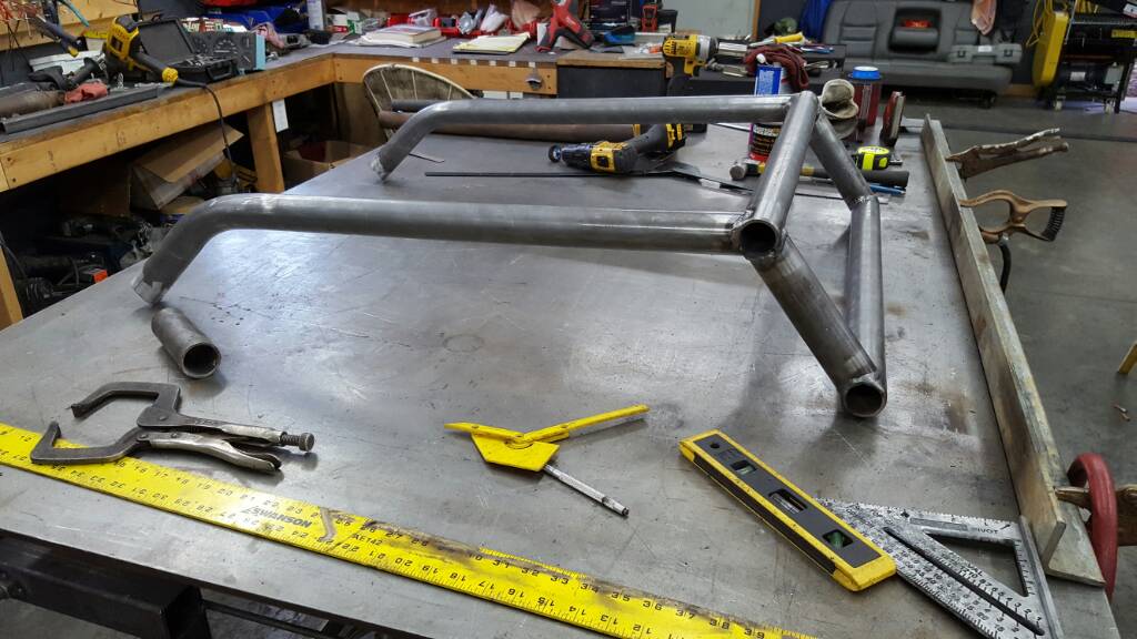

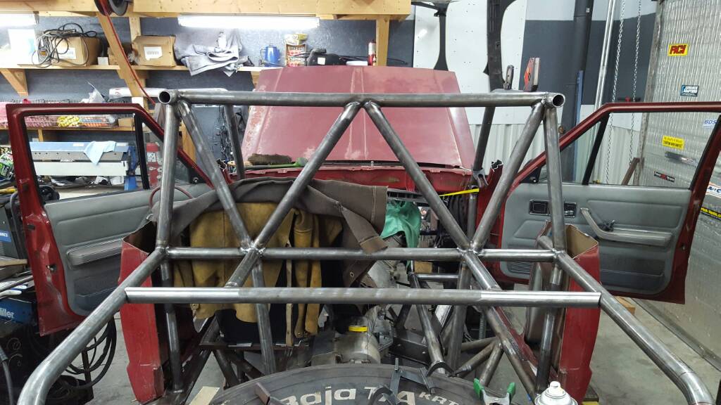

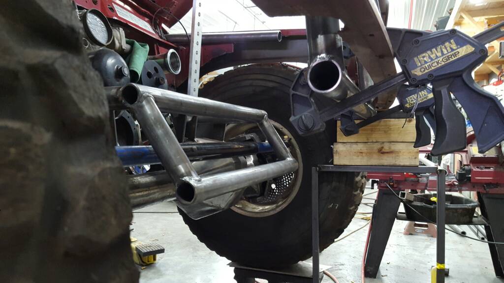

Thanks 5 bros, here's a couple more for you. Tweaked the notches a little bit to get some rake on the beltline.
More tomorrow...

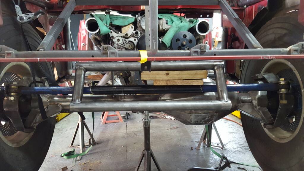

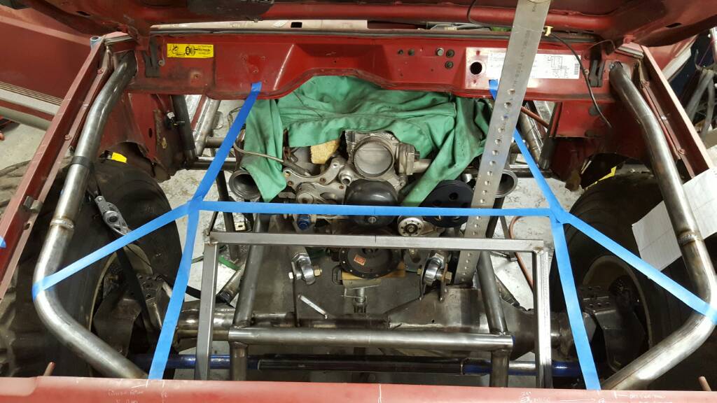

Btw, forgot this little sketch. The winch will be below and behind the radiator. Keeping as much weight a low as possible, and also best possible approach angle.
auploads-tapatalk_cdn-com_20160706_347833498e3b129dddfa93af8c6c06c7-jpg.222710

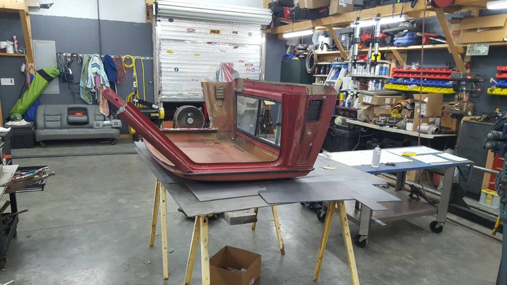

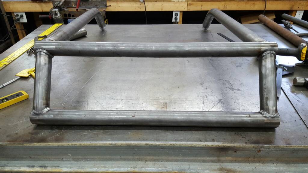

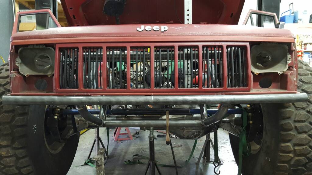

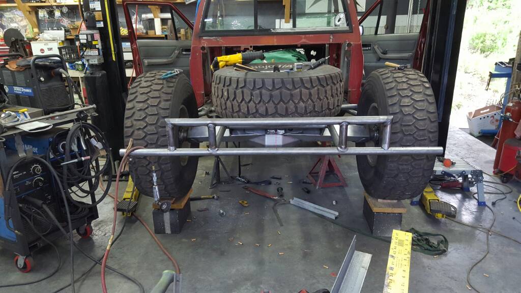

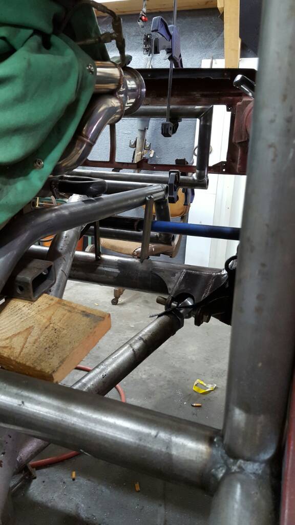

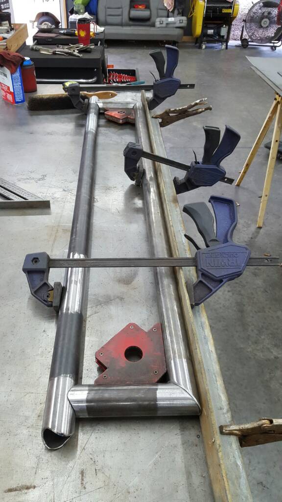

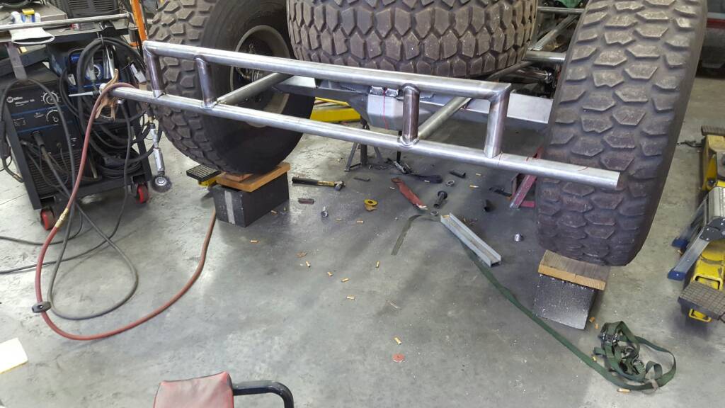

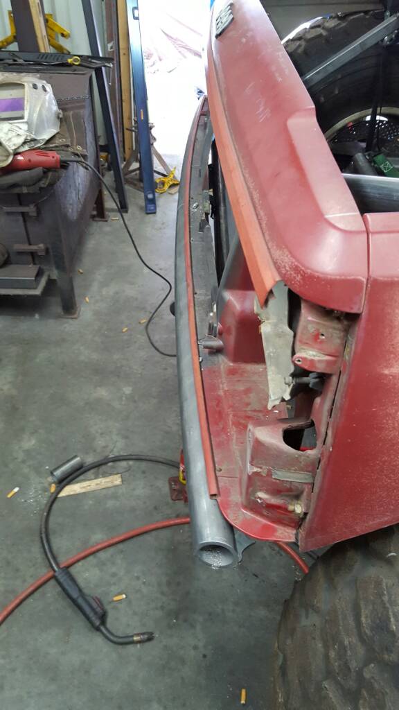

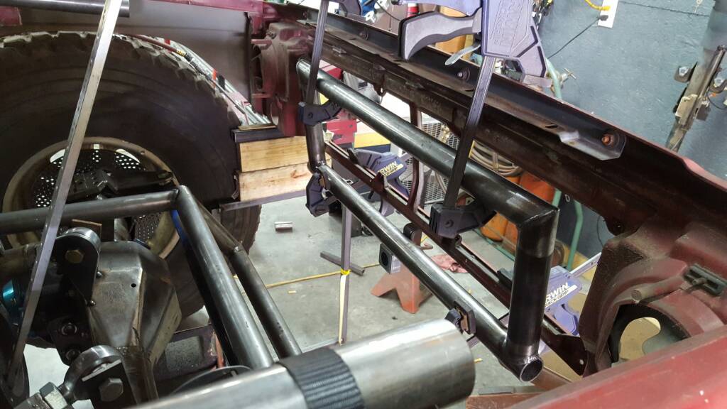

Rolled the bumper today. 1.75-.188.

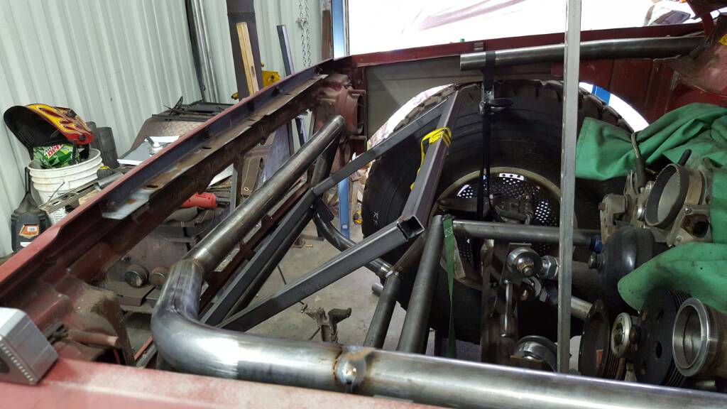

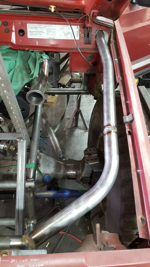

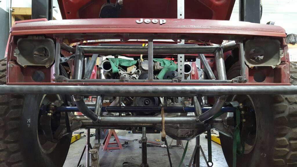

Finished the remainder of the front frame and got one corner tied in.
auploads-tapatalk_cdn-com_20160706_f112995aa3be7d1a5feb717154da6ecf-jpg.222764
auploads-tapatalk_cdn-com_20160706_ad7b277fd72778bad4aea8888c357168-jpg.222765
auploads-tapatalk_cdn-com_20160706_5a762e2da4cd7da6aea3ffa2fa46230c-jpg.222766
auploads-tapatalk_cdn-com_20160706_6a1063e2037f389fb378b760b600a4c3-jpg.222767
auploads-tapatalk_cdn-com_20160706_e33a7a43bdfa84e2201935310f5c2e7b-jpg.222768
auploads-tapatalk_cdn-com_20160706_8ccea37e6c46f1a5995f46cadd6d2a1b-jpg.222769
auploads-tapatalk_cdn-com_20160706_5e192aed665322dbc55efd74968652fa-jpg.222770
auploads-tapatalk_cdn-com_20160706_147f3e385253ed02fff654ad7661db09-jpg.222771
auploads-tapatalk_cdn-com_20160706_35944b7101f30964cc344e69ae4d39cb-jpg.222772
auploads-tapatalk_cdn-com_20160706_b00bc136d39968d48f1d2d04c338d366-jpg.222773

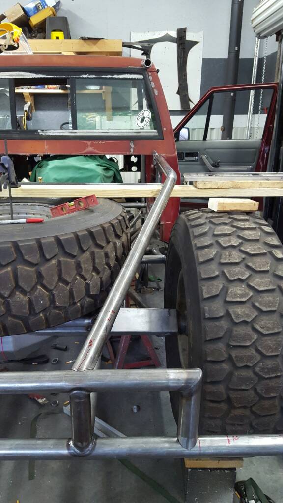

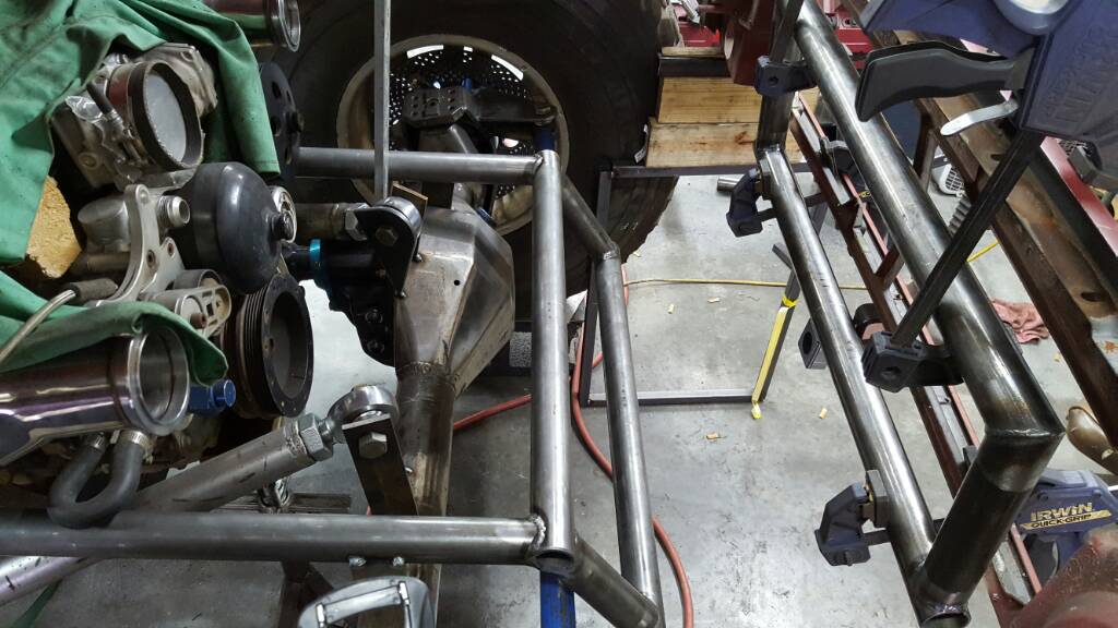

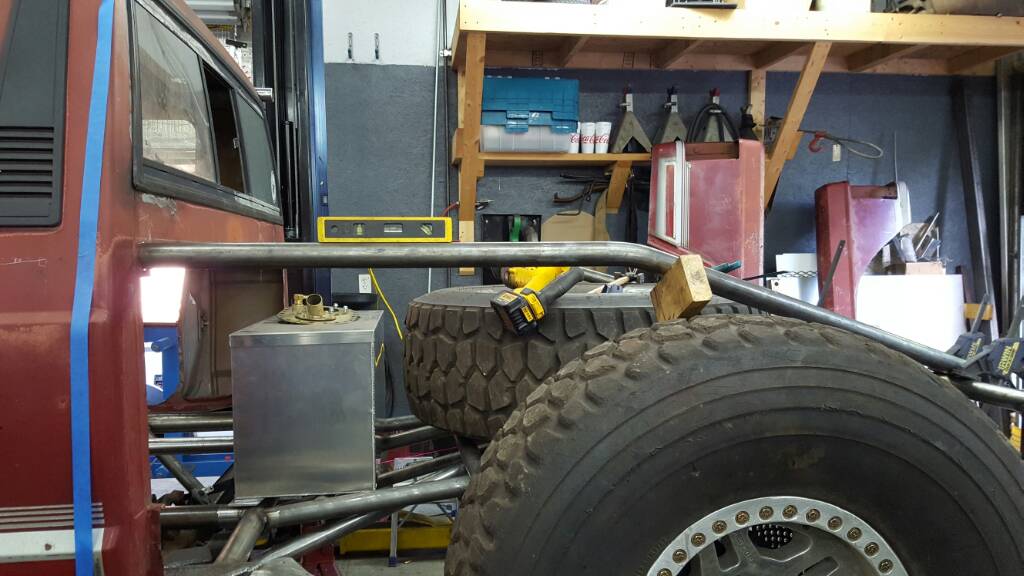

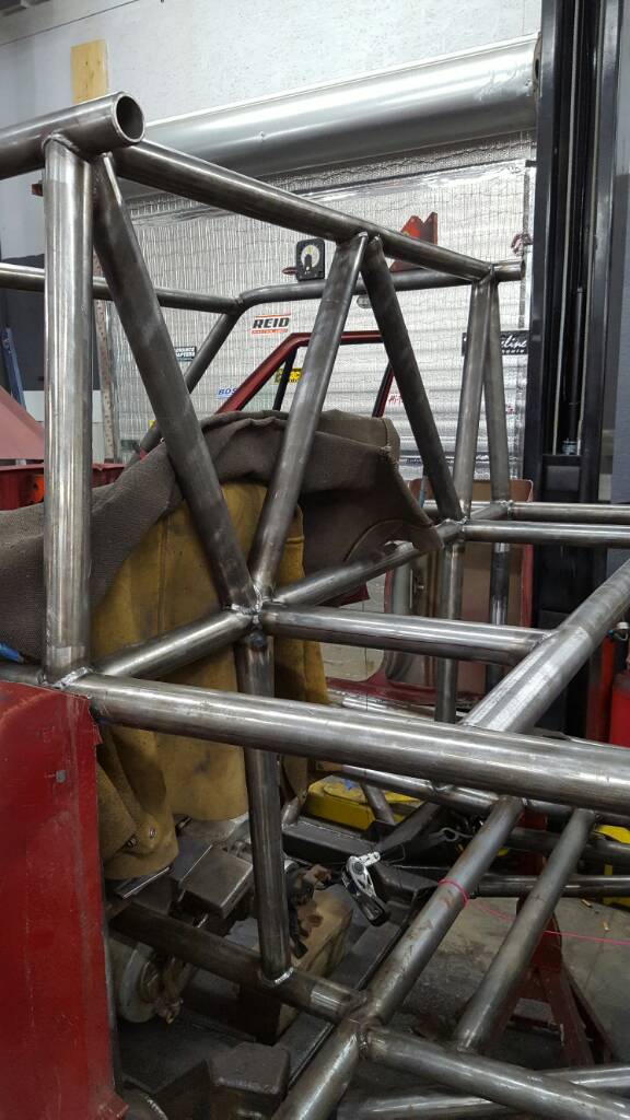

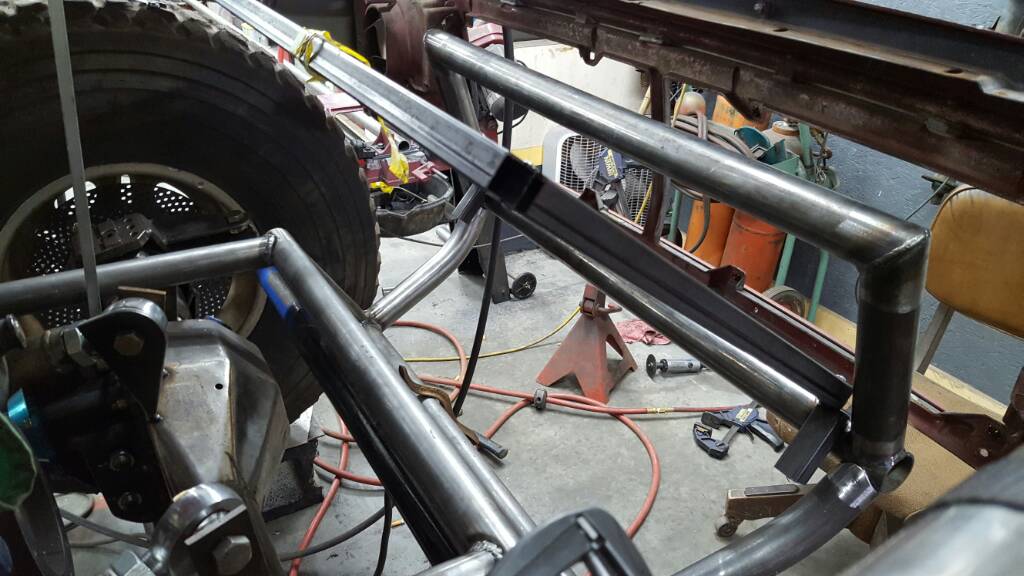

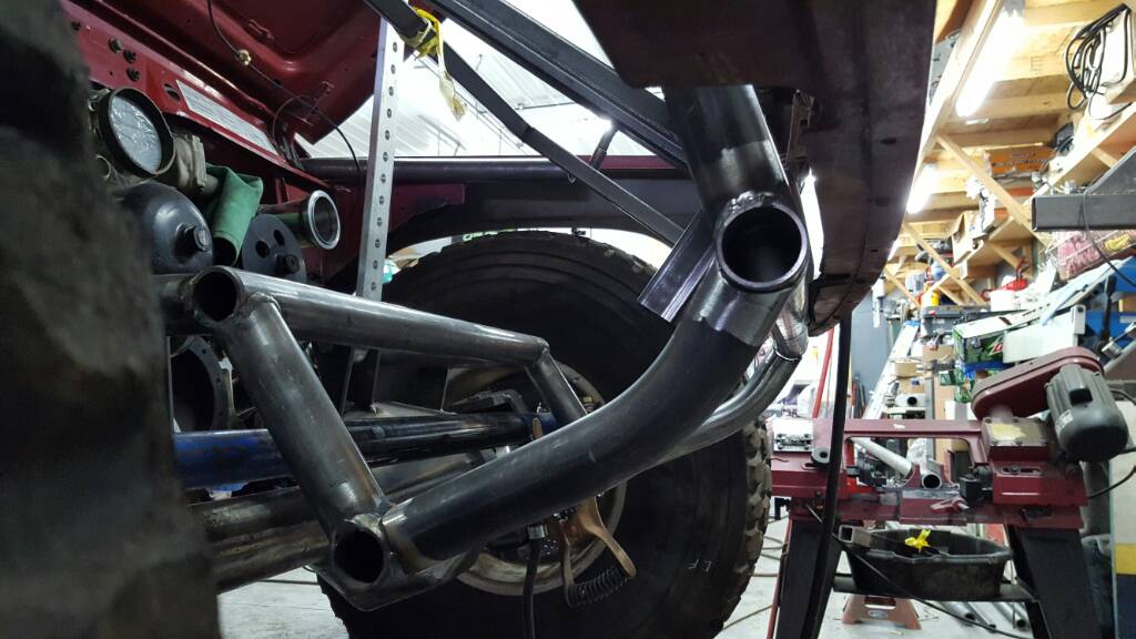

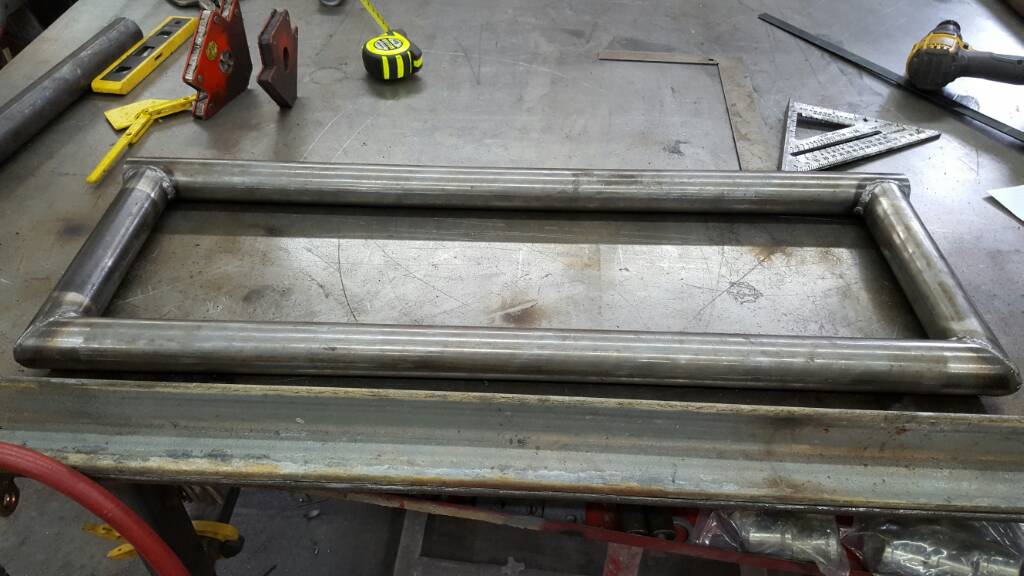

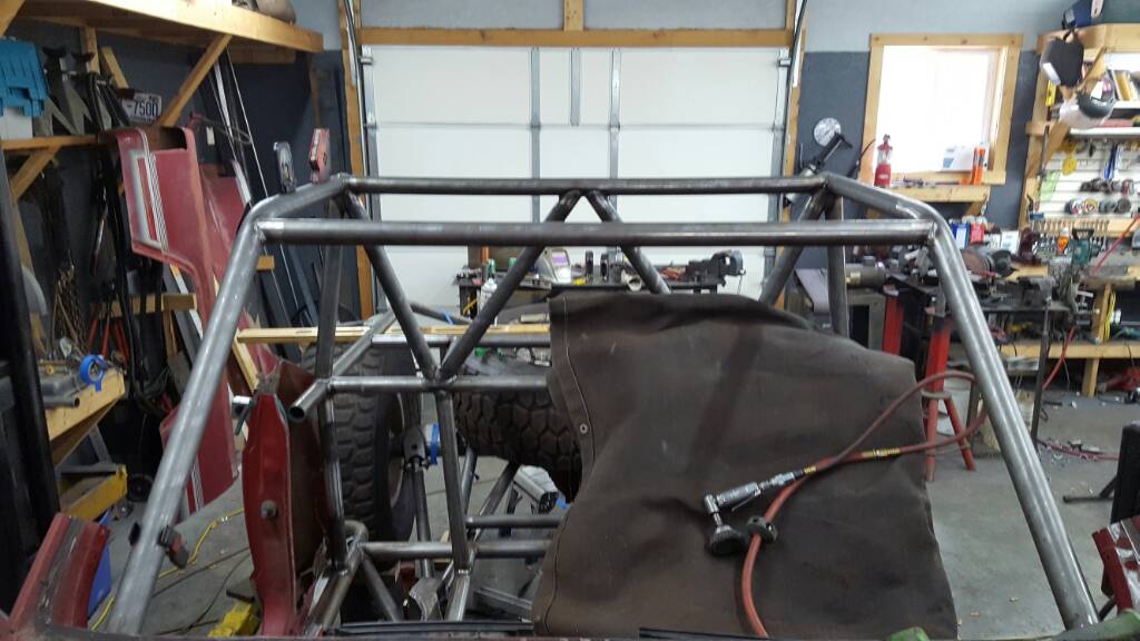

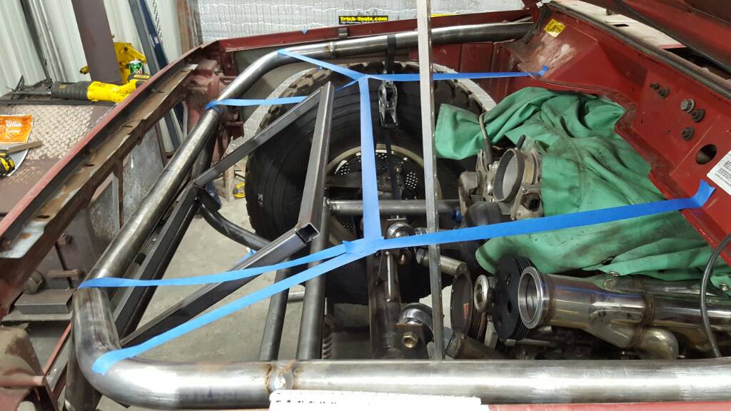

Mo toob...

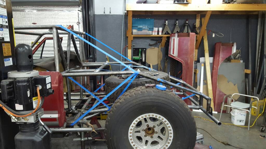

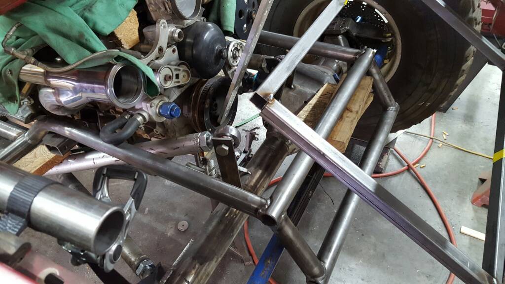

Rear x's almost done...2 more legs.

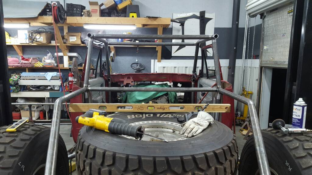

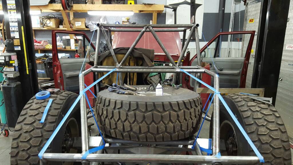

All the tube is cut to finish the cage area, ready to be fit. Also some layout to start cutting the remainder of .120 wall. All the other triangulated lacing will be thinner wall/smaller diameter.
