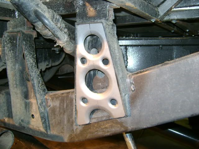

i like that t-case mount/xmember. but, you think it needed 3/8" steel? thats a HEAVY piece. you think 1/2", or even 1/4" would have worked?
nice build.
HAHA
in case you havent checked your tape measure lately, 3/8 is still between 1/4 and 1/2.

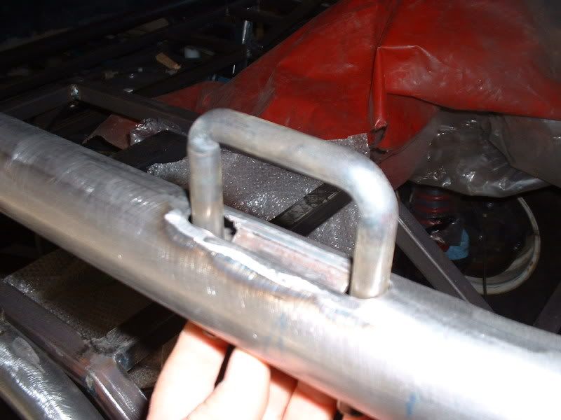

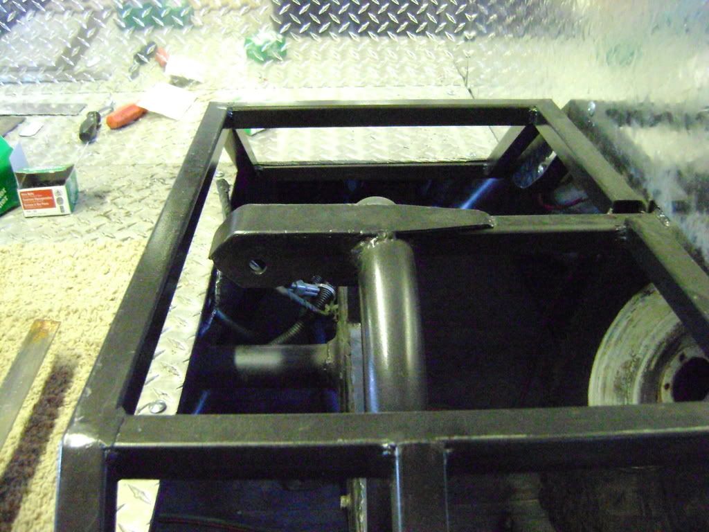

Built a jig to bend some 7/16 cold roll for some flush mount tie downs.

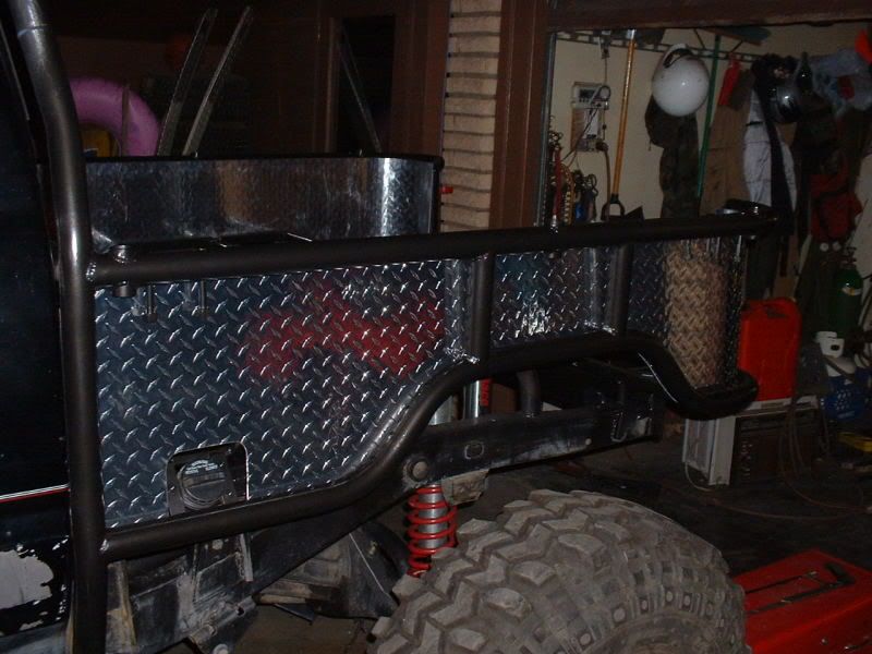

I will post more pics later 2 day with the bed sides done.
Heres 1 teaser pic
Also built a slip roll to radius the diamond plate for the bed sides.

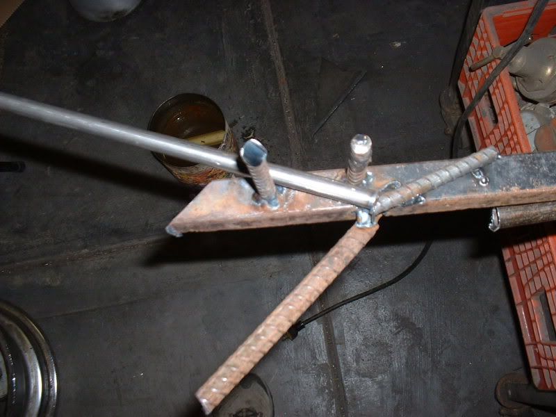

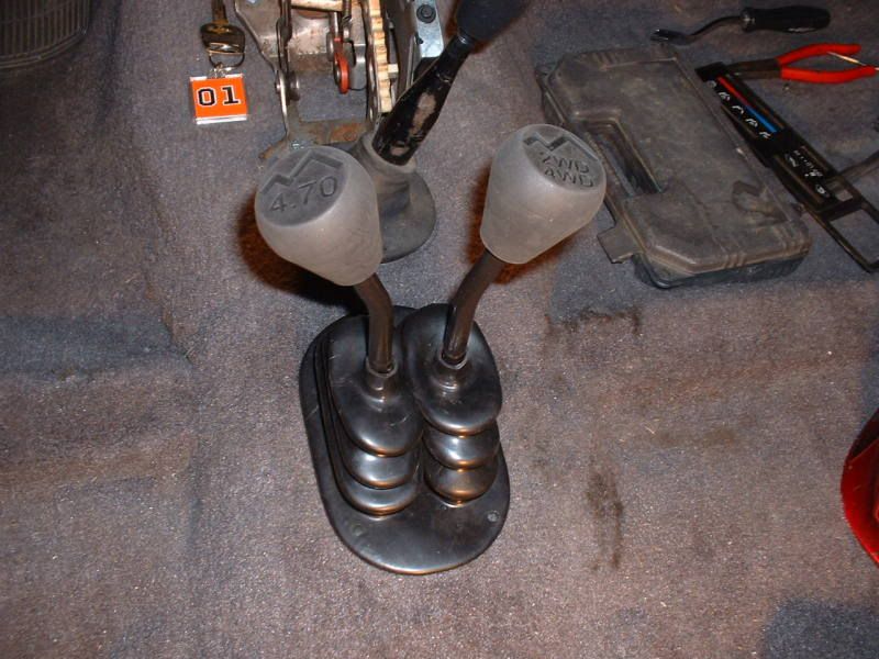

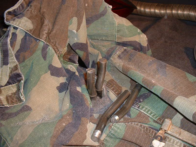

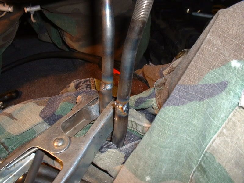

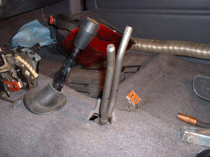

And the twin sticks I got came with standard threads on the ends, so you cant even use toyota shifter knobs (bull****). So after trying to tap them with no luck, I cut them off and welded smaller dia shaft, that I could tap.
I like the knobs labled so anyone can figure it out too.
:mad:
haha. wtf WAS i thinking.
i read 3/8, but was thinking 5/8...for wtfever reason.:looser:
but, yeh, anywayyy...u think 1/4" would have worked.
very cool shifter knobs...whered u get them?
Trailgear. 5$ a peice. :awesomework: Nice looking rig. The bed is blowing my mind.... :masturbanana[1]:

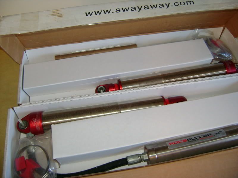

Got some bling,
2.5" SAWs w/ dual coilover kits for $450 shipped. normally about $900 worth of stuff all brand new.
Love Racedezert
damn those fawkers are huge, hope they aren't goin up front:eeek:
other then that this is one bad ass yota:cool: , not tryin to knock you bout your score on the coil overs, but i no this kid has them in the rear of his yota, and there fawkin long and bulky as fawk alittle over kill, just my .02

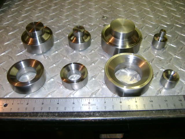

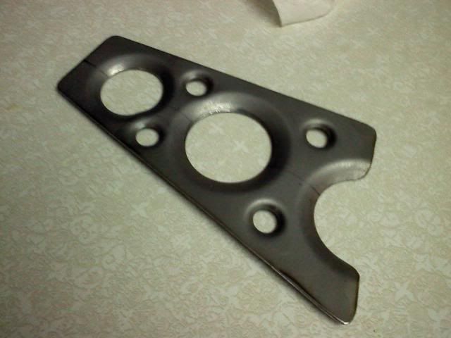

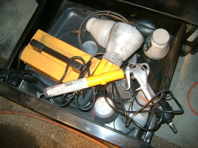

Got some new tools, like a HF powder coater, bad ass, and some dimple dies. Pic of my
oven. It has a additional thermostat wired in to the broil element so you can run the
bake and broil elements at the same time and at 350 deg. Ive done some wheels, beadlock
rings, tools, winch mt, skid plate, Its fast once your set up right. I might do a
video on it sometime. Really I can have a part ready in like 30 min. Dimple dies care
of Barbed Wire Offroad, 4 dies 1/2, 1, 1 1/2, 2" all for 100 bux shipped.

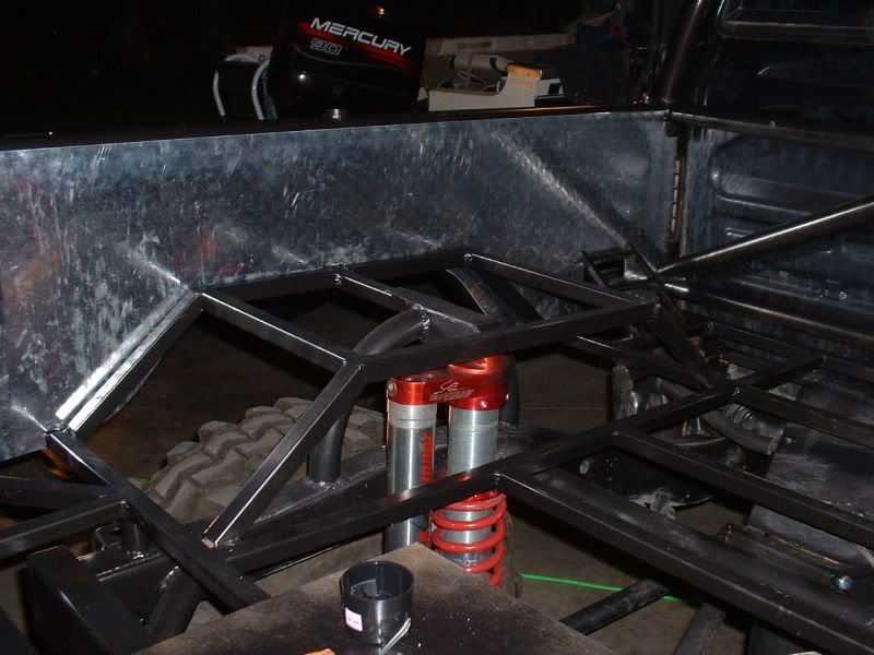

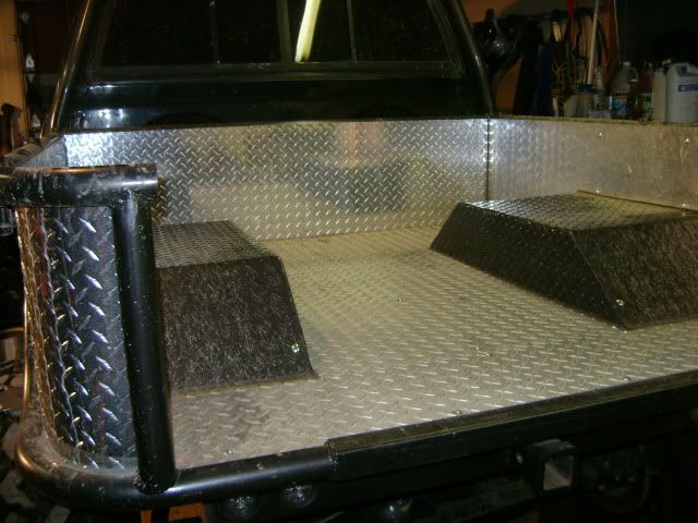

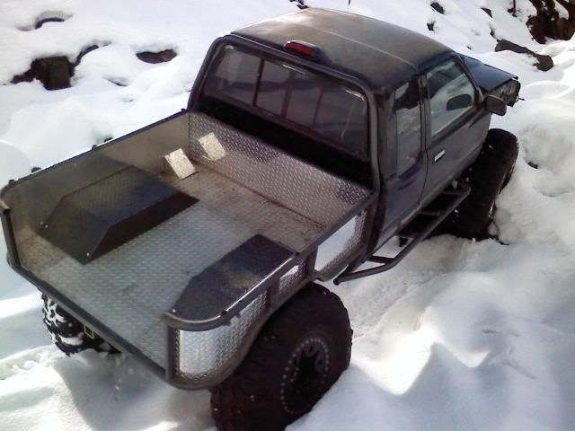

So Bed is mostly complete except for a tailgate, which I do have plans for.

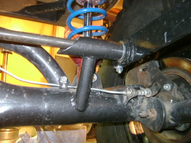

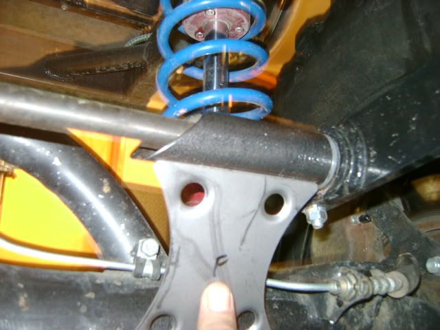

Wanted to go 2" shorter shocks on rear, and got a deal on remote ress in stead of
piggy backs so I had to scrap a lot of the rear shock mts and redo them.

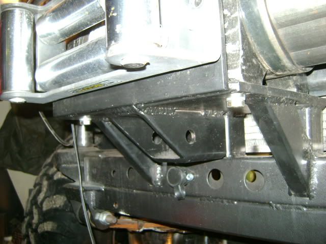

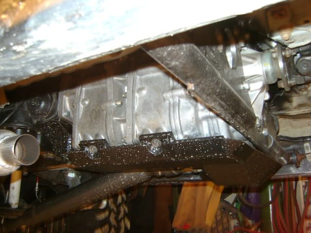

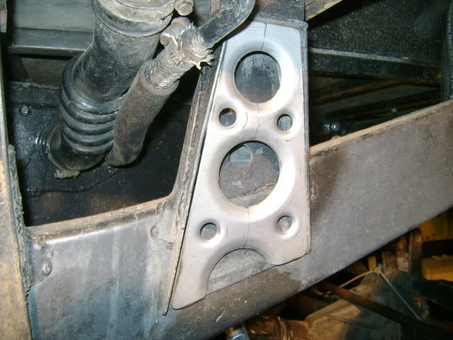

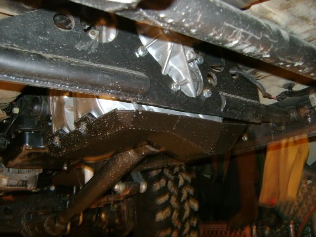

Built a skid plate outta some 3/8 and powder coated it.
Did a winch mount from scratch outta 3/8 plate. Powder coated it before welding it on.
Just ground the areas to be welded to the frame, then touched them up with hammered paint.

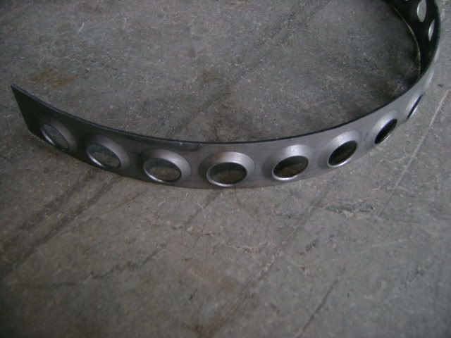

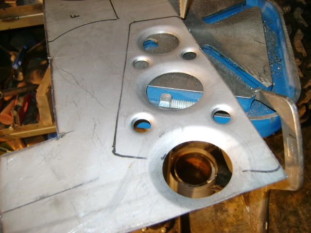

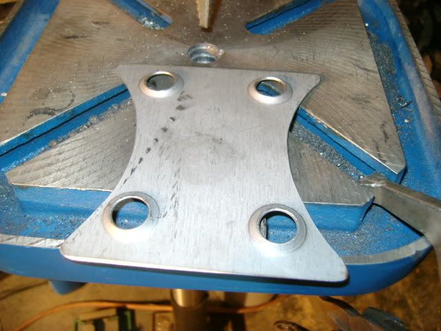

Now for some Dimple Die stuff.

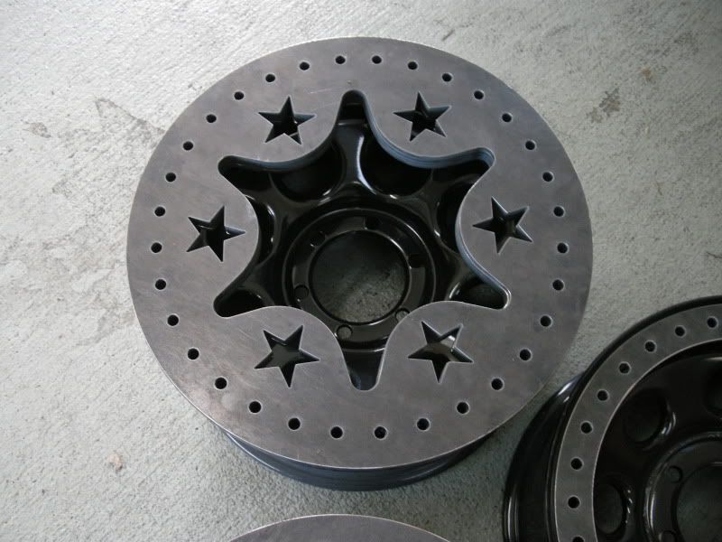

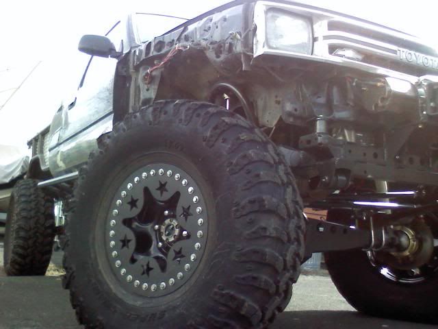

Also traded my 36 SXs for some 39.5 Iroks(thanks Money M.) Stepped up to 17s, had ClarkW cut me some
sick, one off beadlocks, based on a couple ideas I had. Used some 1/2x 1/8 flat
to make some Anti coning rings in my home made slip roll. I think 3/4 would be
better but I would have needed longer hardware.

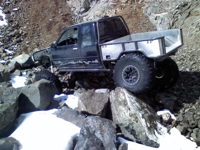

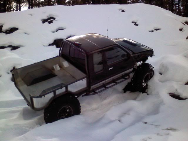

Little place I know.
Still needs work though. got PRPs to mount, cooling issues, bump stops, seat belts. I do have some tube for an EXO too.
