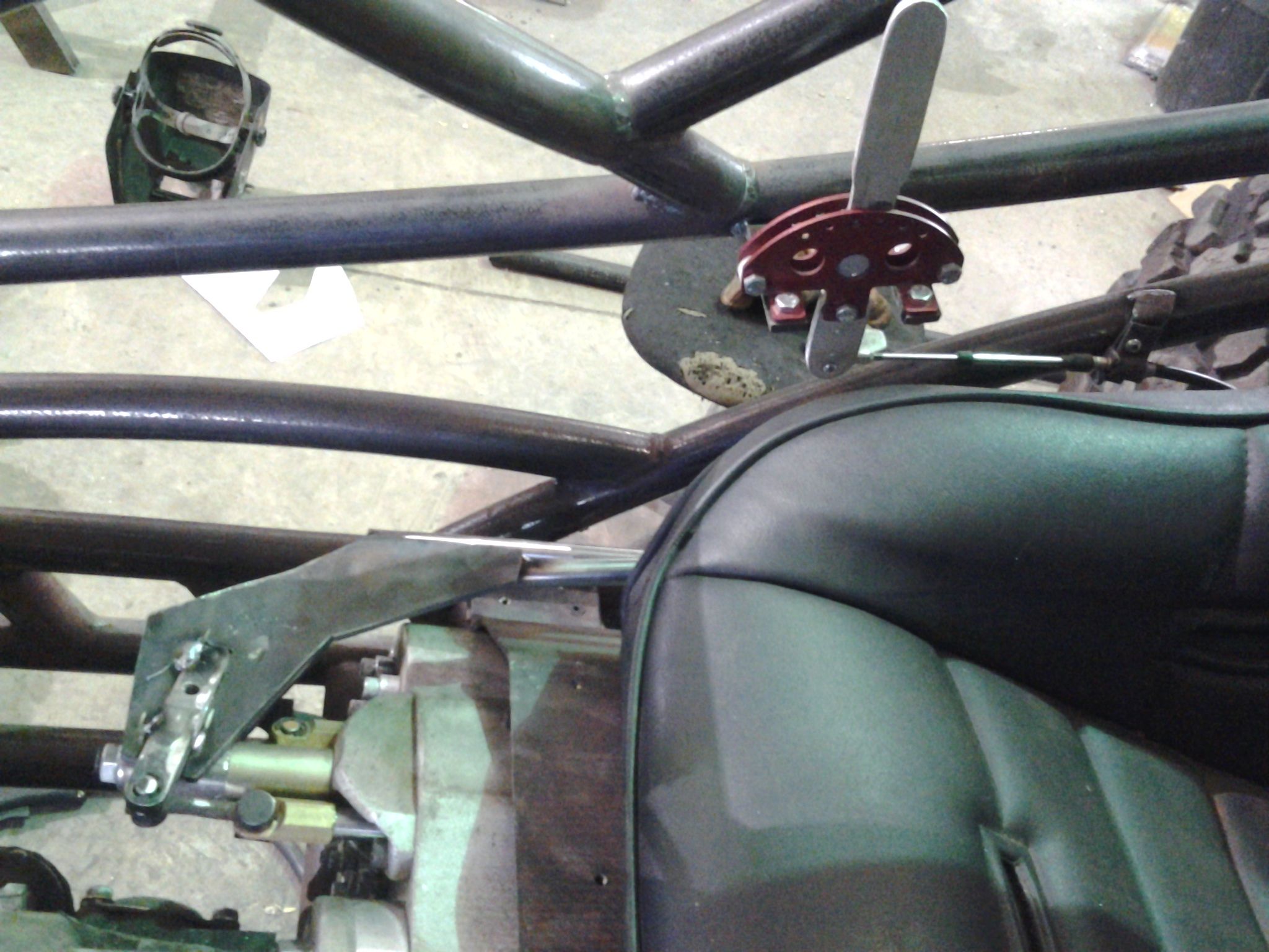

Damn found my build thread on page 4 . Well here is what I did on the shifters . An got a whole bunch of little bitty **** done that nobody cares about

Rokcrler said:
Looks like you push the shifters out and in? How easy are they to shift?
if you mean how easy it is to move them its really easy . This way siting in the seat all I got to do is move my hand down an shift . An nothing is in the way in front of me

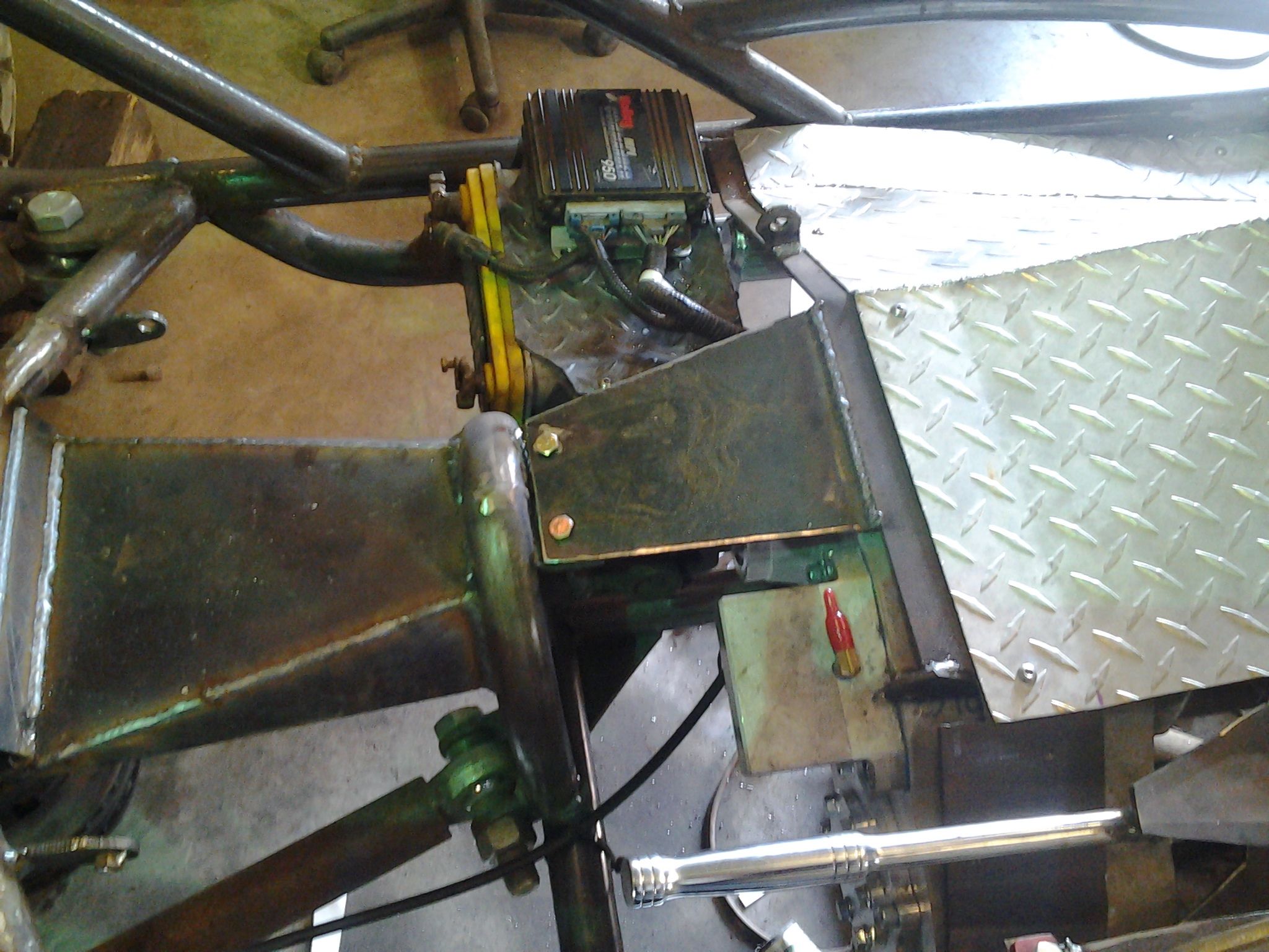

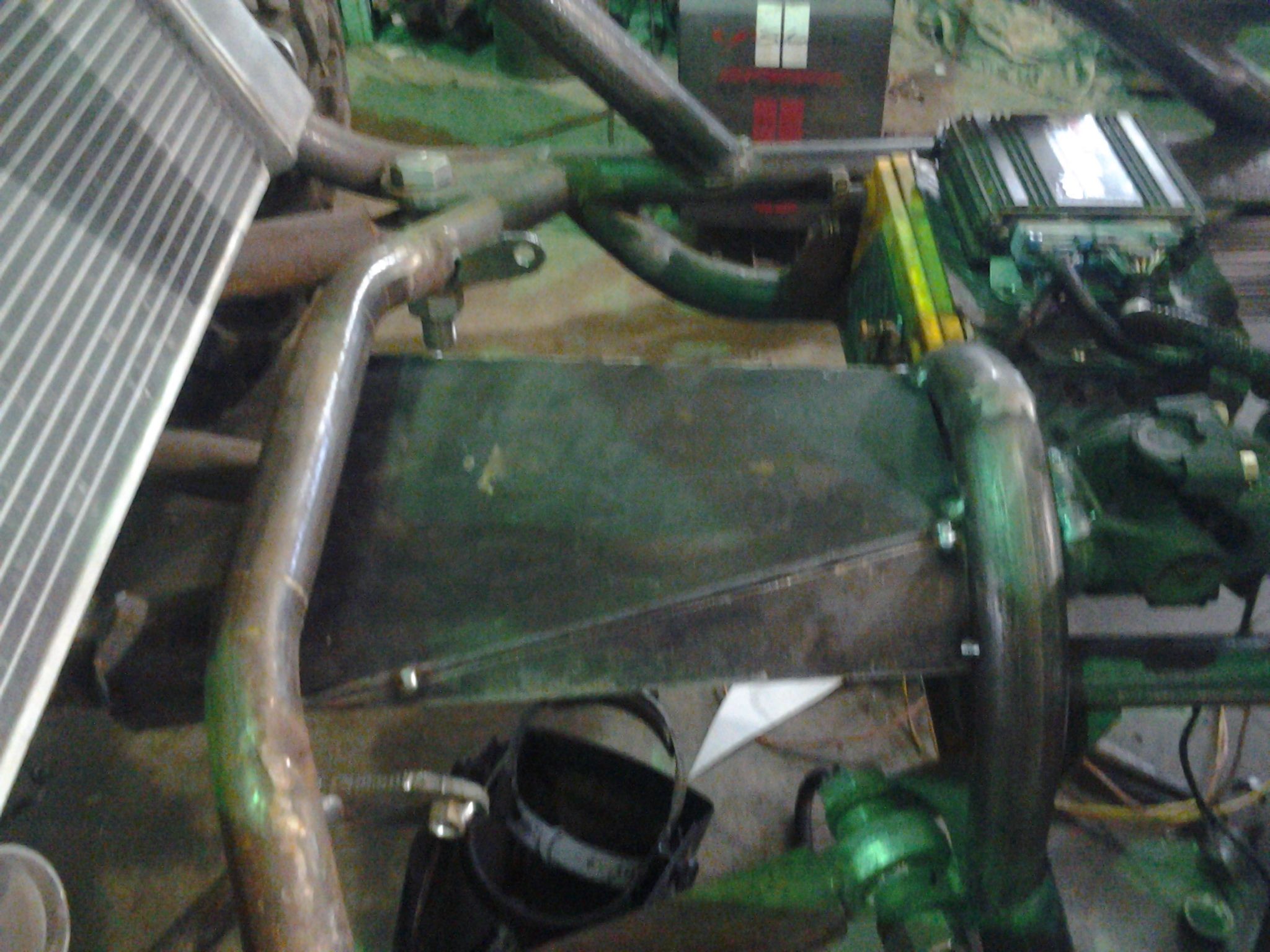

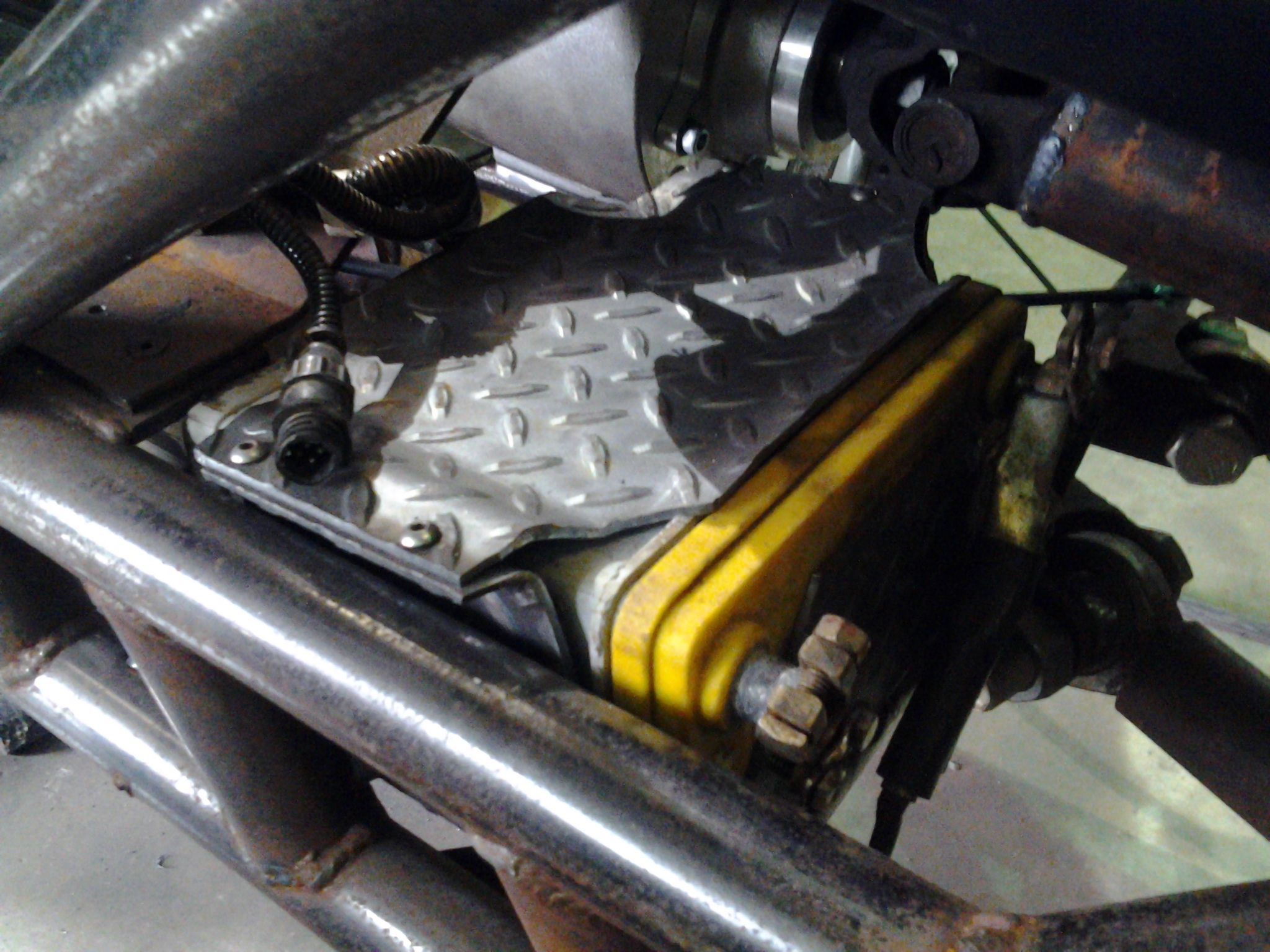

Ok so one seater that means drive shaft wright under seat comes apart me got problems.
So I built a new drive shaft out of 3/16 tube an put the slip at the axle end an built a drive shaft hoop an then plated from my seat crossmember to the hoop with some 1/4 in Ar 500 impact plate .that should take care of it
If anybody has a better way let me know

I would make sure you cover all your seating area I had a teacher in high school that was a NHRA driver before going into teaching that had a drive line come apart under him and let's just say you don't want that happening to you he just about died from it and still walks with a limp and has problems from it!
I would say cover joints and all just in case.
Oh by the way this thing looks awesome!
Tks bud! I will that's kinda what I was thincking I will post up what I come up with . I do need the rest to be able to un bolt because of being able to get the t case out with out to much anger
Ok I got something in mind .shouldn't be a problem maby I can get it done today an I will post some pictures .

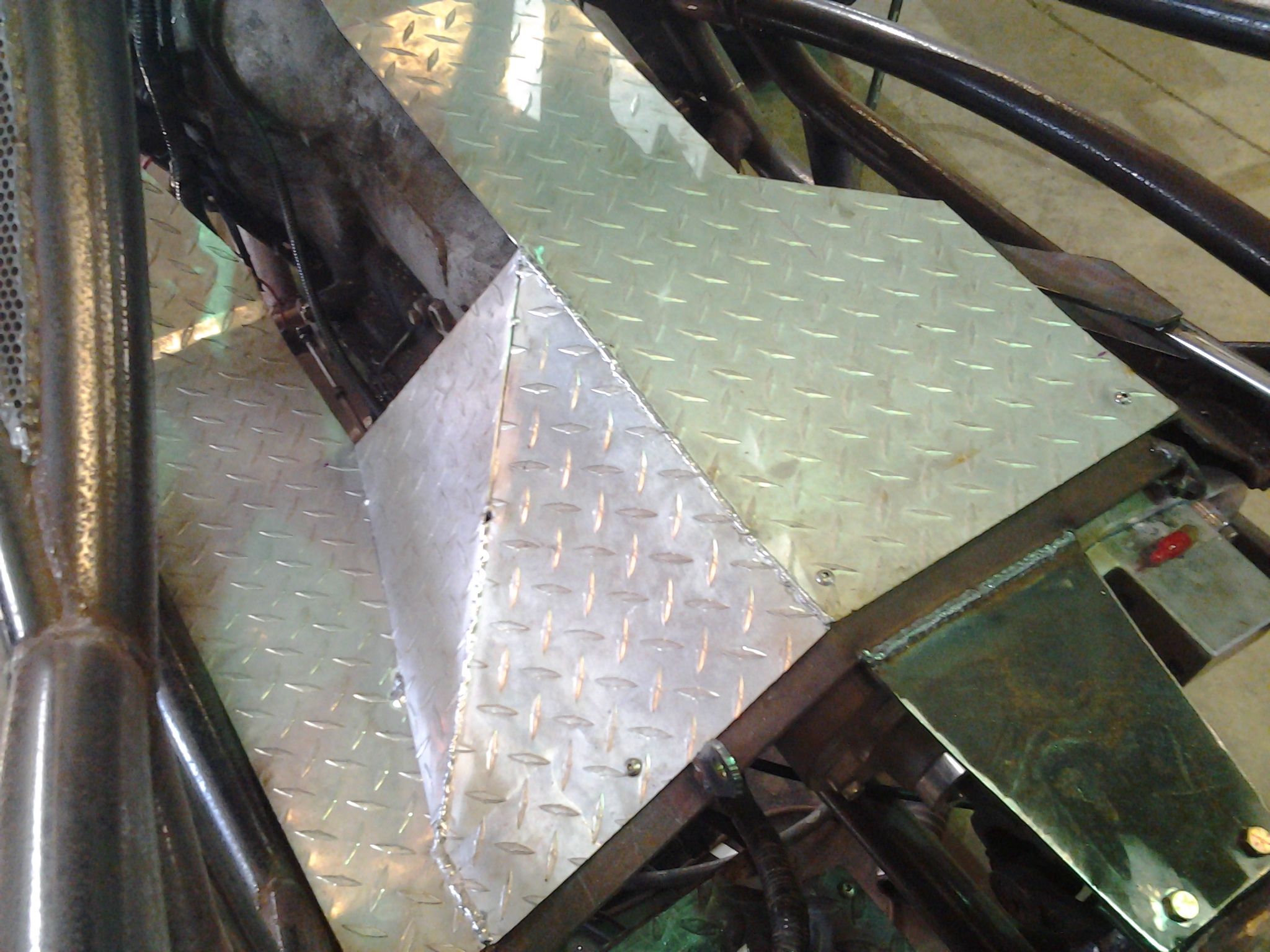

Ok I thinck this will work the cross member that the front side is welded to comes out .also got started on a floor an got some water plumbing done

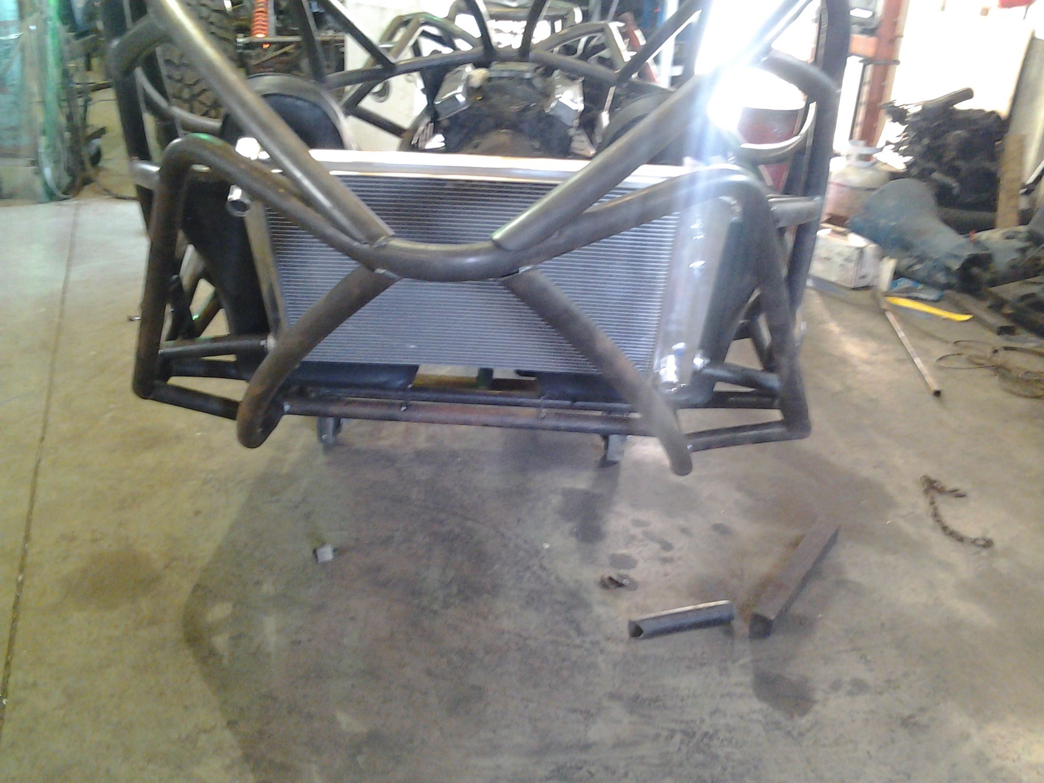

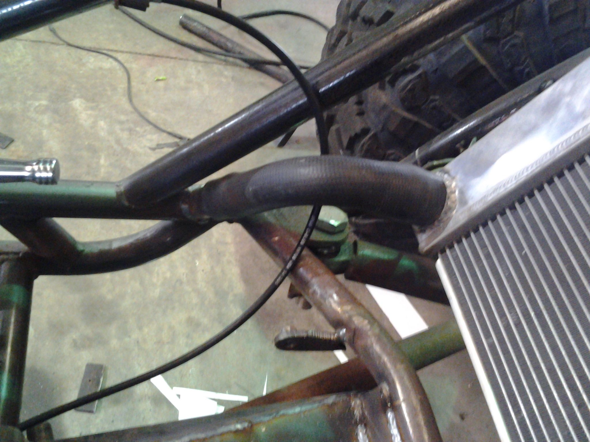

I also got a radiator mounted an the motor guard built on a chassis I built last week
