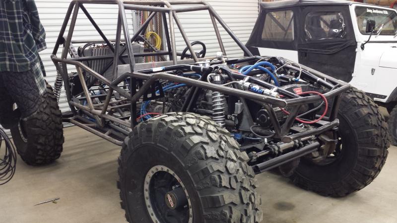

This belongs to matt (did a bunch of work on his old TJ) and has been sitting untouched for far too long. Its a BNS chassis.
Has LS1/TH400/Atlas with 60's. Besides needing wiring there is a bunch of small stuff that needs to be addressed but all the big stuff is in place. Matt is a super cool guy and looking forward to getting this done so he can get out and have fun with it..

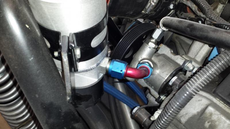

Still evaluating the rig and probably going to take an area at a time. This is the first issue I saw. The res tank is mounted to the chassis with a 90 degree fitting to the pump--thats not going to last long..
So the hose looks to be 1/2" so I will need to order some -8 fittings. Now since its p/s do I need to use special hose? All the kits I have used I always used the hose that came with it.

When I worked parts we sold regular fuel line and what we called H hose. It was all Weatherhead but the H was rated for oils. Any hose shops hold have it if the local parts house doesnt.

Napa can make you any sort of high pressure hose you need. That's where we used to get a lot of our hydraulic lines made when I was driving for JL
Ok so looking at using some Aeroquip fittings with AQP sockless hose

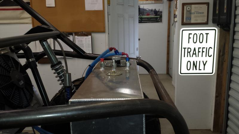

So this is one thi g thst is bugging me..

This.
I would skin around it in 16 gauge steel with removable/accessible panels so no part of the cell or fittings/lines/filler were exposed.
Unfortunately thing gauge steel isn't going to protect it from what I fear. Its kinda in the hit zone--from rolling over of laying on its back. Something thin tin won't protect it from.
That's what I thought you were looking at as was I.
It would help with a framework of 3/4" tube.
I also look at that & see how much it would help to move all fittings & lines to the front wall of the cell. That would be more work but also be alot safer than on top.
A guy could also make a custom cell to the rig, that would be the best option.
My preferred option for sure is to dump that fuel cell. There is a bunch of room for a lay down style but......... Just trying to work within what we have...
It will work--just not "how" I would have done it if ya know what I am saying :awesomework:
A spare tire mounted over that would protect it. Or cut off the front tube work and put a radiator in front.

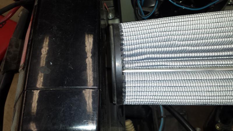

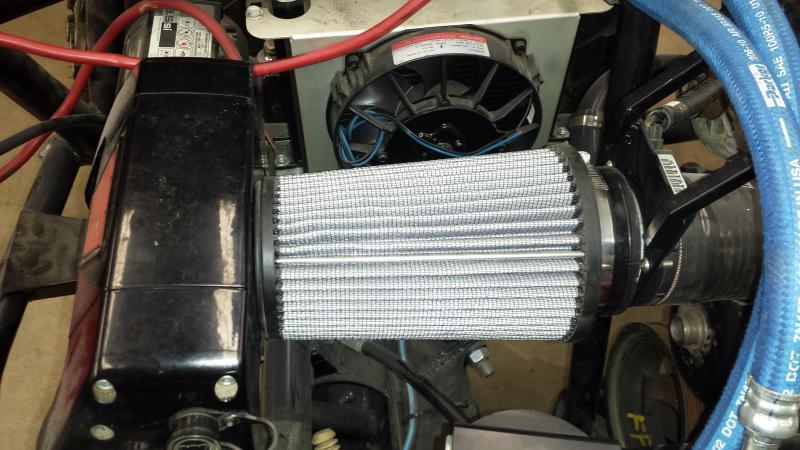

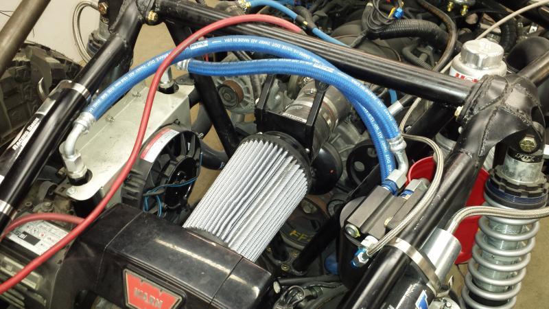

So I got the from brace installed (goes between shock towers and down to the motor skid plate) and got the maf and found the air filter. Well its right up against the winch. Ya thats not going to work.
    81.5 KB
    66.2 KB
So I ended up spacing the maf back 1/4" (there is a brace that goes from the maf to the x-brace) and had to trim the inlet hose. Got a better amount of room from the winch now. I ended up redoing it again (pic not shown) and now have 1/2".

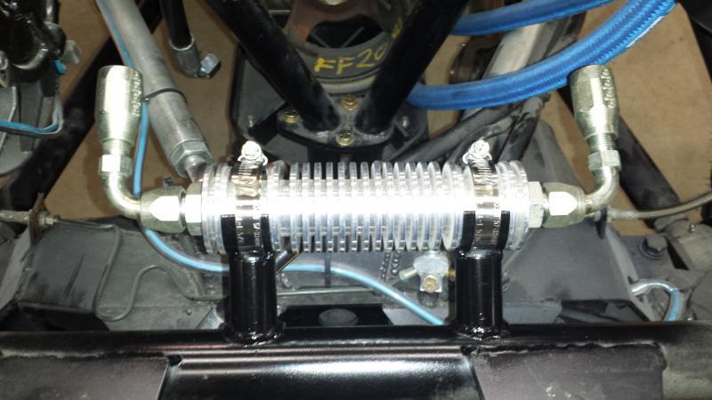

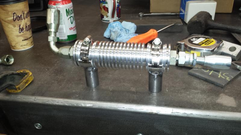

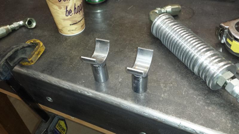

So the p/s cooler was just draped in front of the motor with no sort of mounts in any of the stuff I had. I could either order the howe polly mounts(looks like the same type used on reservoirs for a coilover) or a weld on style. I went ahead and made some mounts that would stand the cooler off the front crossbar on the chassis.
    52.1 KB
    51.5 KB
Got it welded in and painted. The hoses from the orbital and the res tank are crimped and both the 90's are turned wrong and too long. I will be using field fittings at the end.

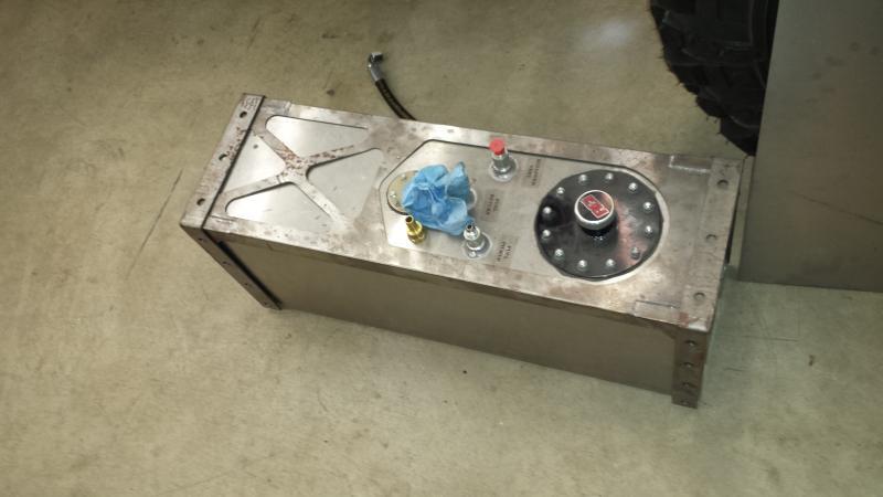

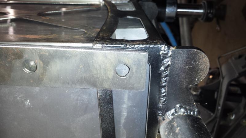

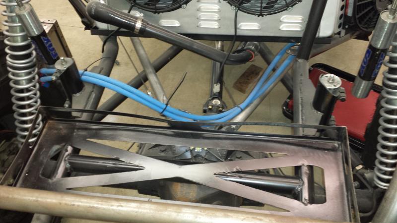

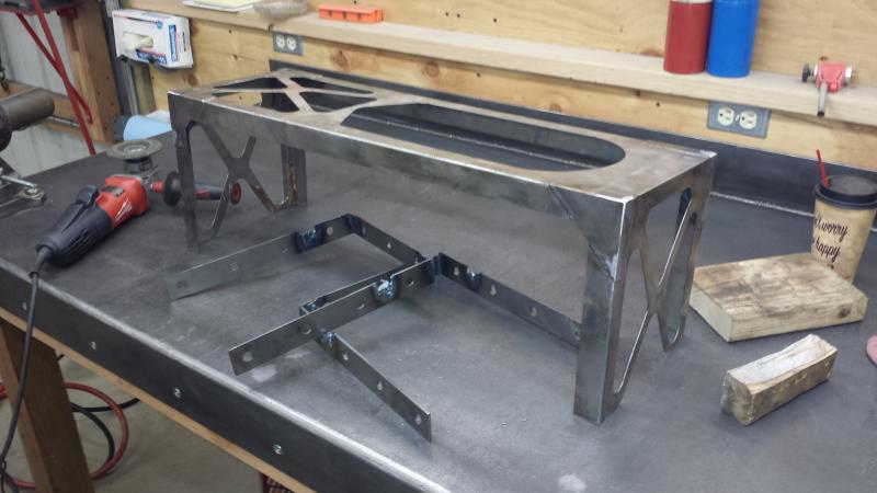

So while I am waiting for hose/fittings to show its time to look at the fuel cell. It was kinda sitting in place. The straps that are there to hold it down--well they don't quite make it to where that need to be..
    44.5 KB
So pulled it all out and cut the straps off the tank hold down assy..
    59.7 KB
    35.1 KB
    45.9 KB
