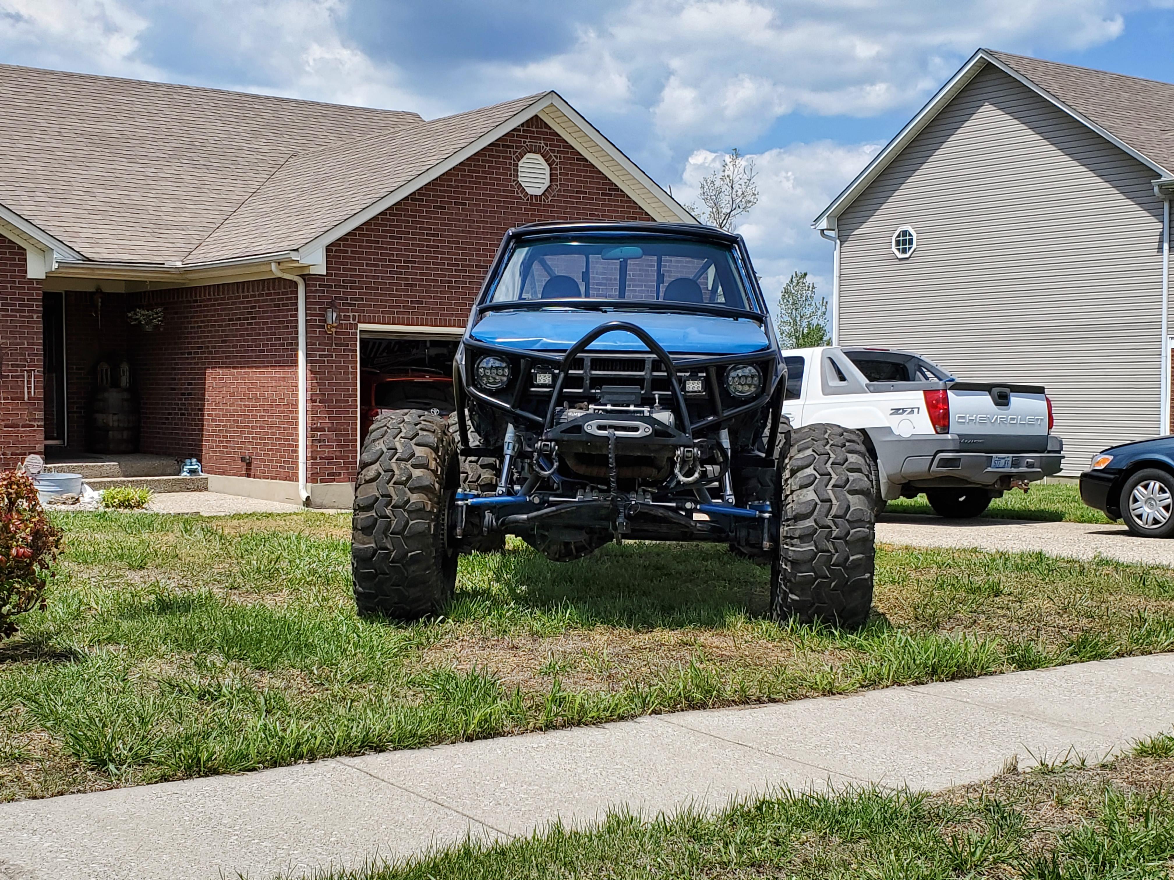

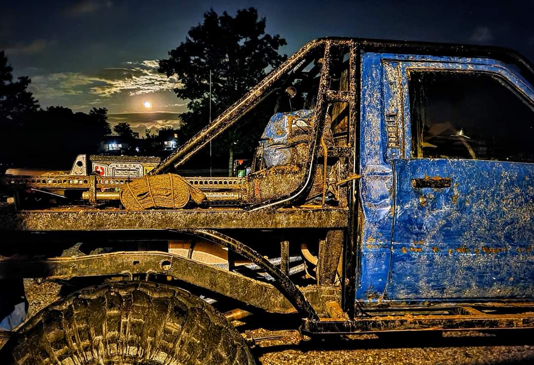

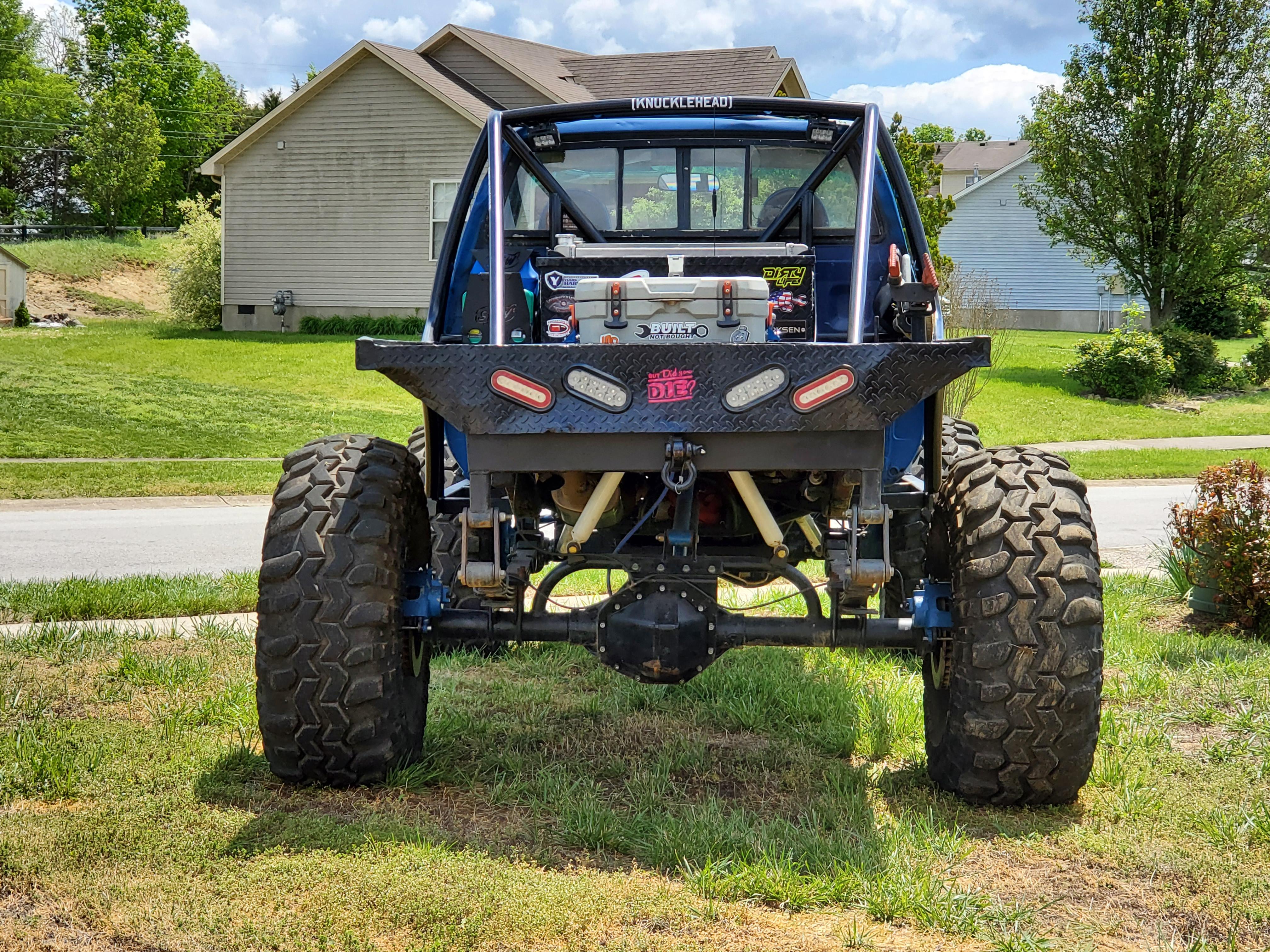

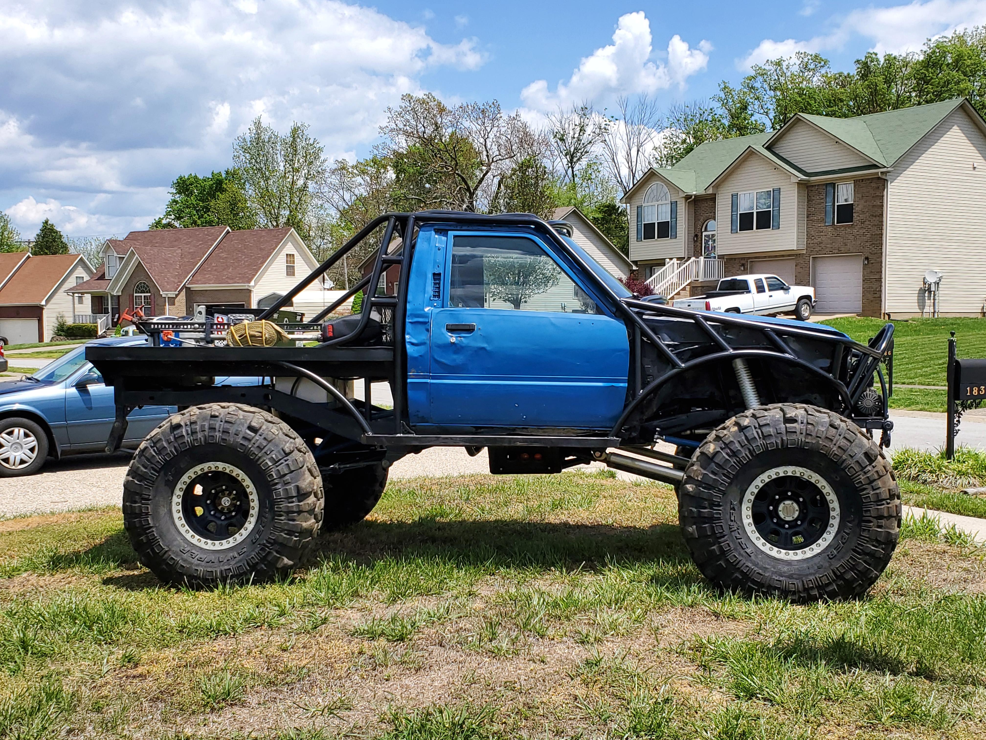

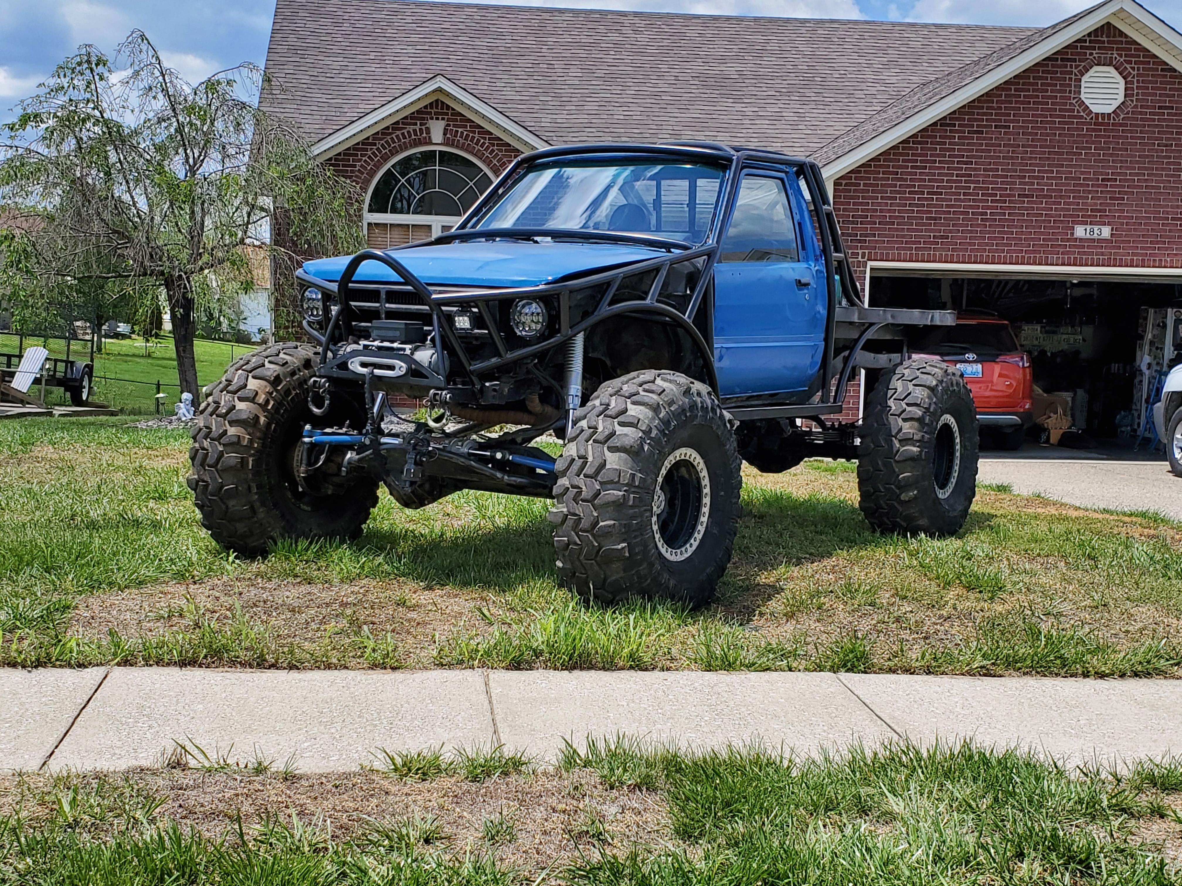

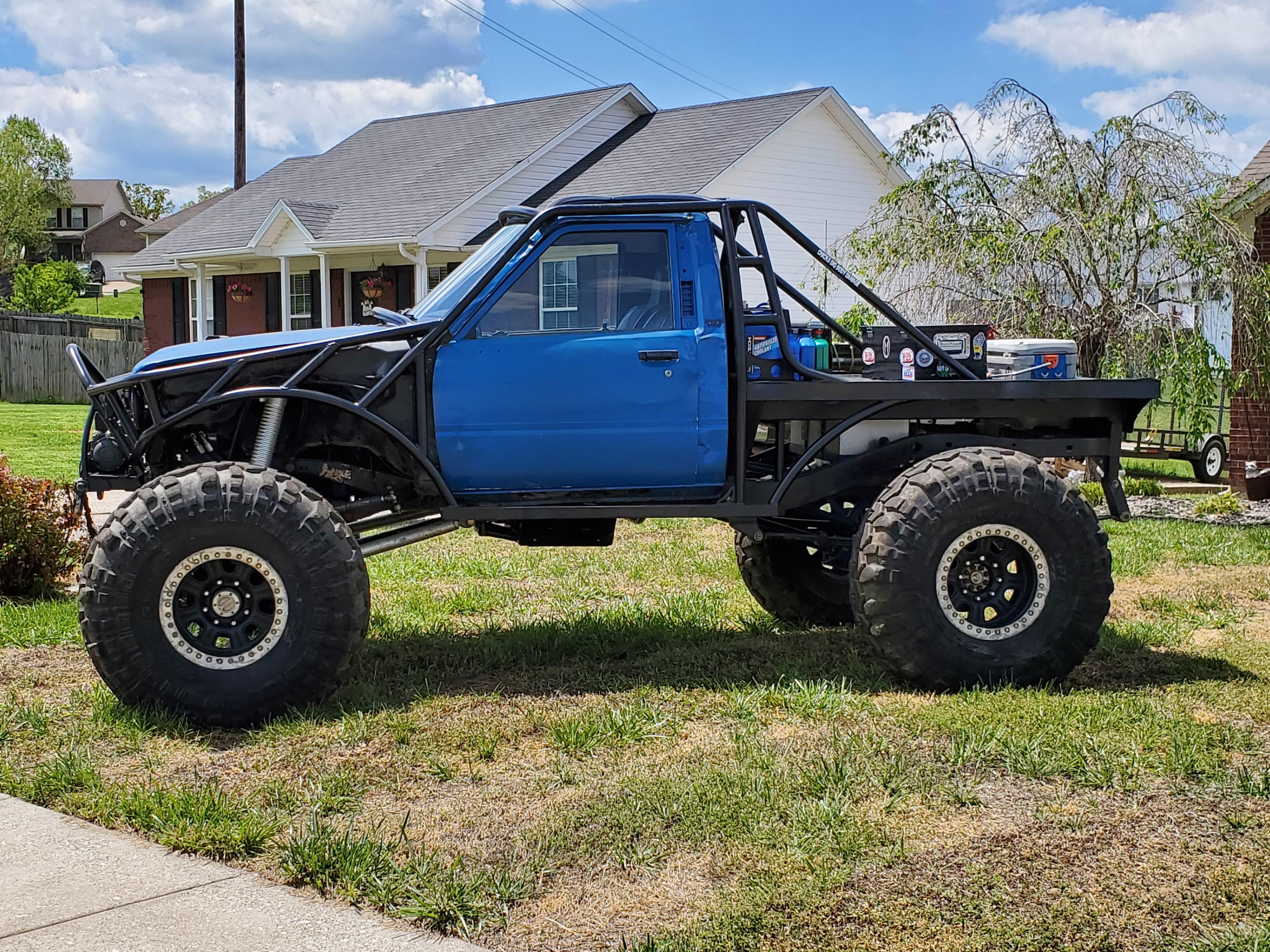

Cage rebuild is complete. I've spent the last few weeks getting a bunch of little stuff wrapped up. I remounted the lights and radiator. Plumbed, wired, and mounted the new Derale trans cooler. Switched out the old bulky plastic toolbox for a more low profile aluminum box. Recessed the cooler in to the bed about 8 inches. I used to carry extra fluids in the old box but this time I bought a fluid carrier from Sinister Fabworx and mounted it just behind the cab. Going with the smaller toolbox and dropping the cooler into the bed really helped with my sight lines when looking backwards. I also installed an in-cab winch control panel from 12voltguy and installed a new windshield.
All in all, I am really pleased with the end result and you can hardly tell the truck was ever rolled from a distance.:rolf: You can still see the A pillar damage if you look for it and I had to fill in some gaps around the windshield with sealer in order for it to sealed.
Haven't been on the trail since I rolled it in October. Gonna head to Windrock this weekend and shake the cobwebs off.

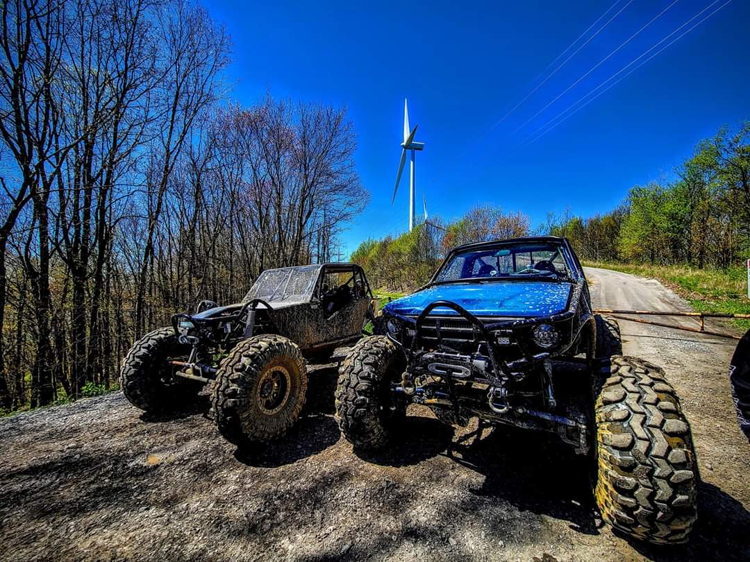

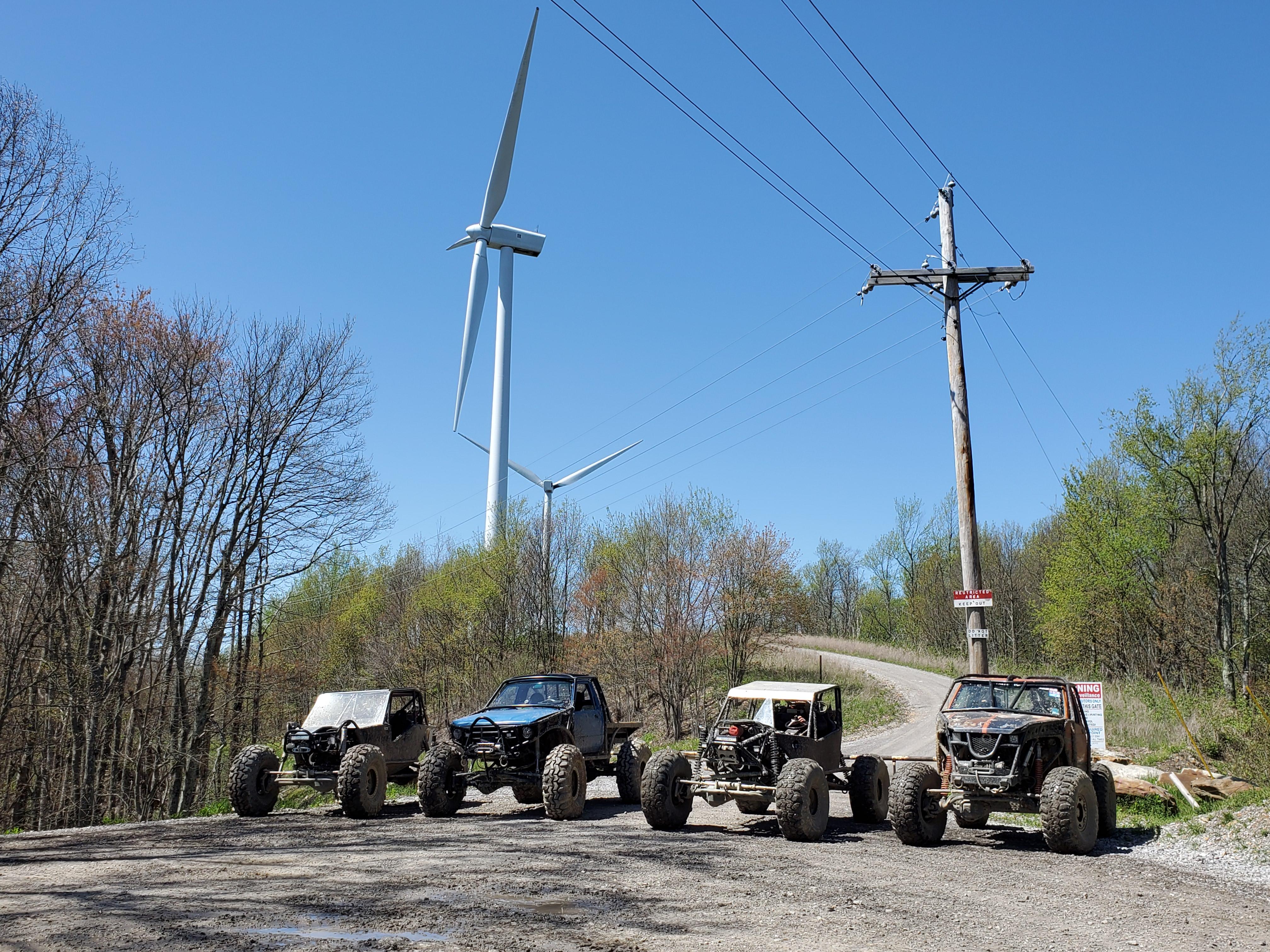

Great! Expensive as **** but great. We suffered through tons of rain on Friday but made the best of it. Saturday was beautiful weather wise and I was able to mark Rail Trail off my list since last time I was there we weren't able to run it. I did break a spicer joint in my front axle just after finishing Rail. I rode around the rest of the day in 2wd watching the other folks in the group run some of the easier to access rock trails.

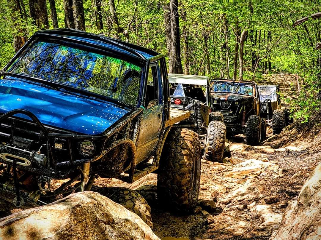

Here are a few pics from the trip.

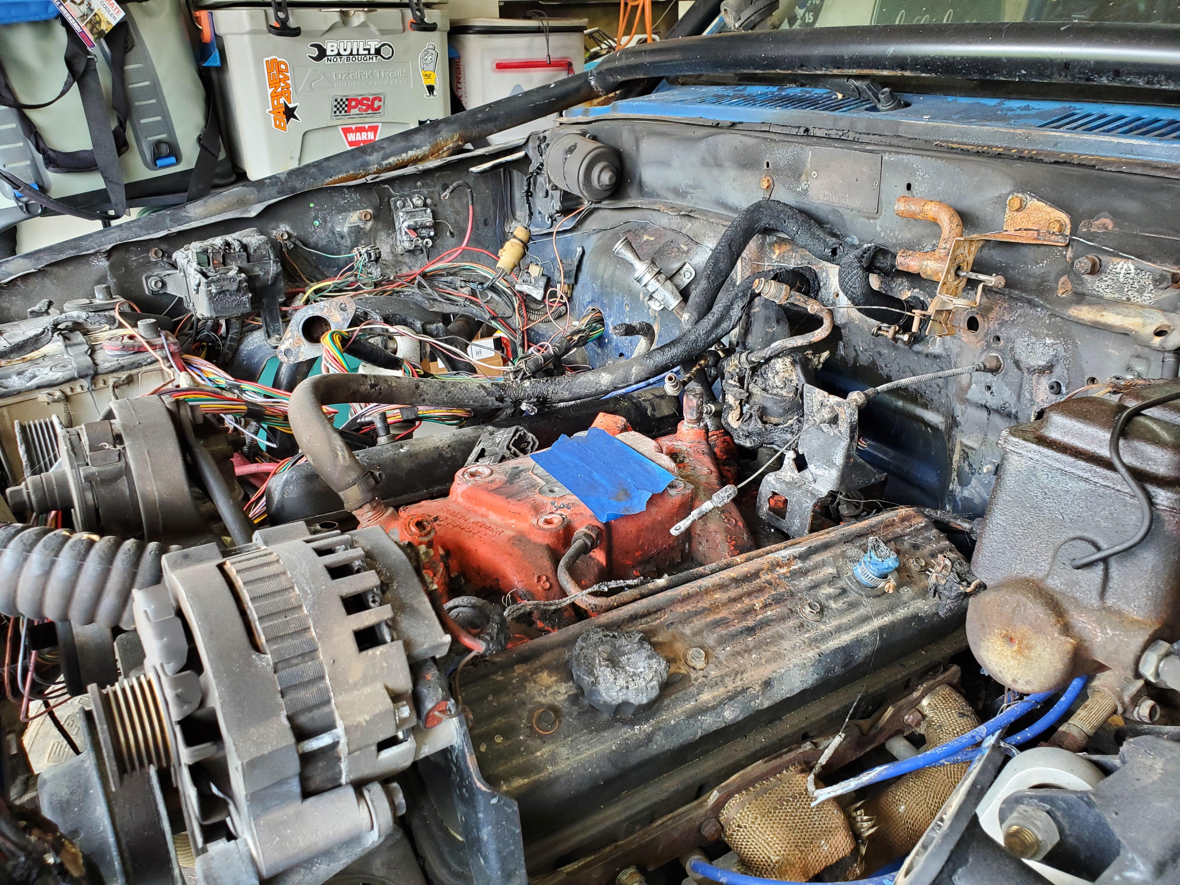

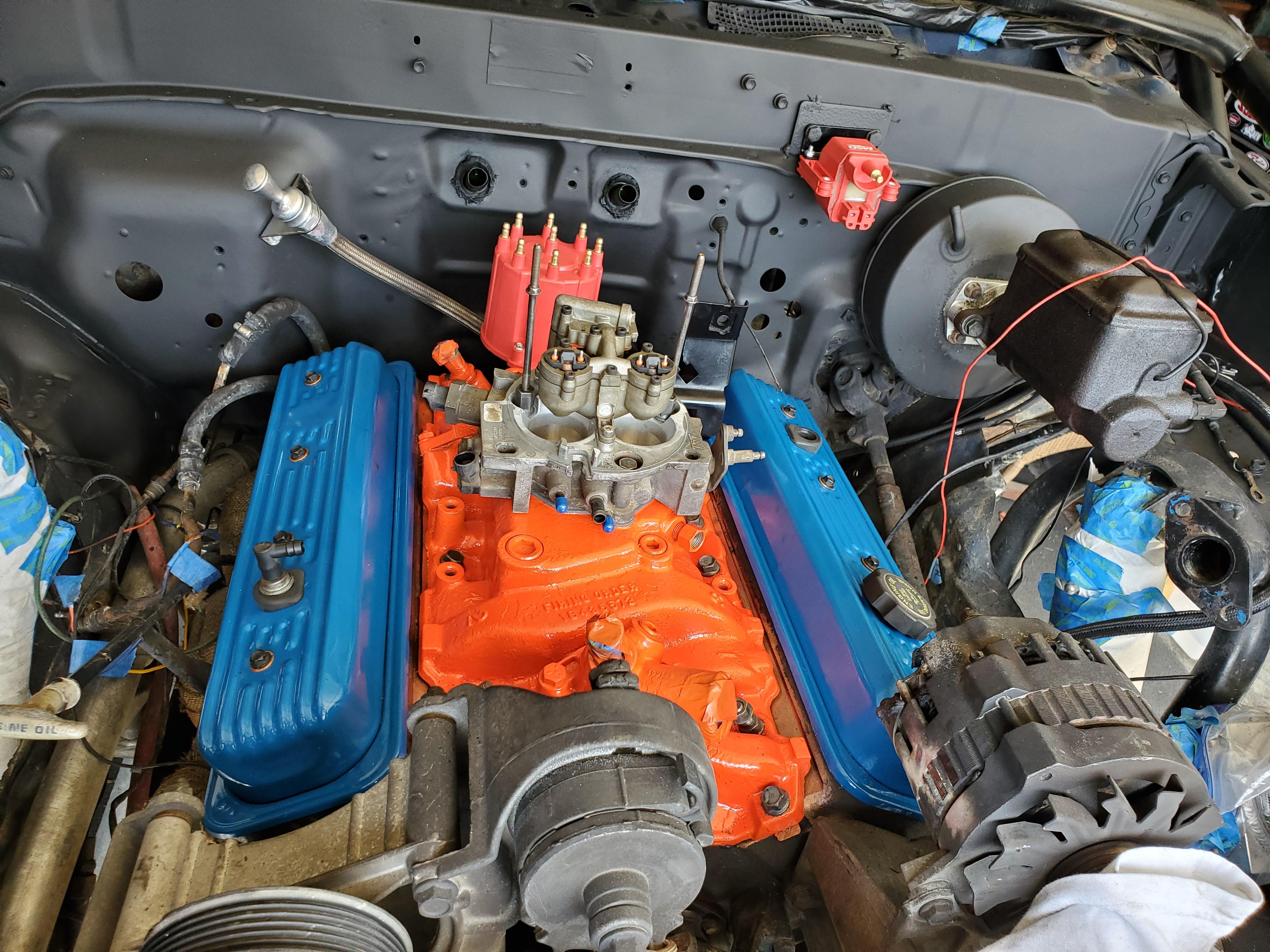

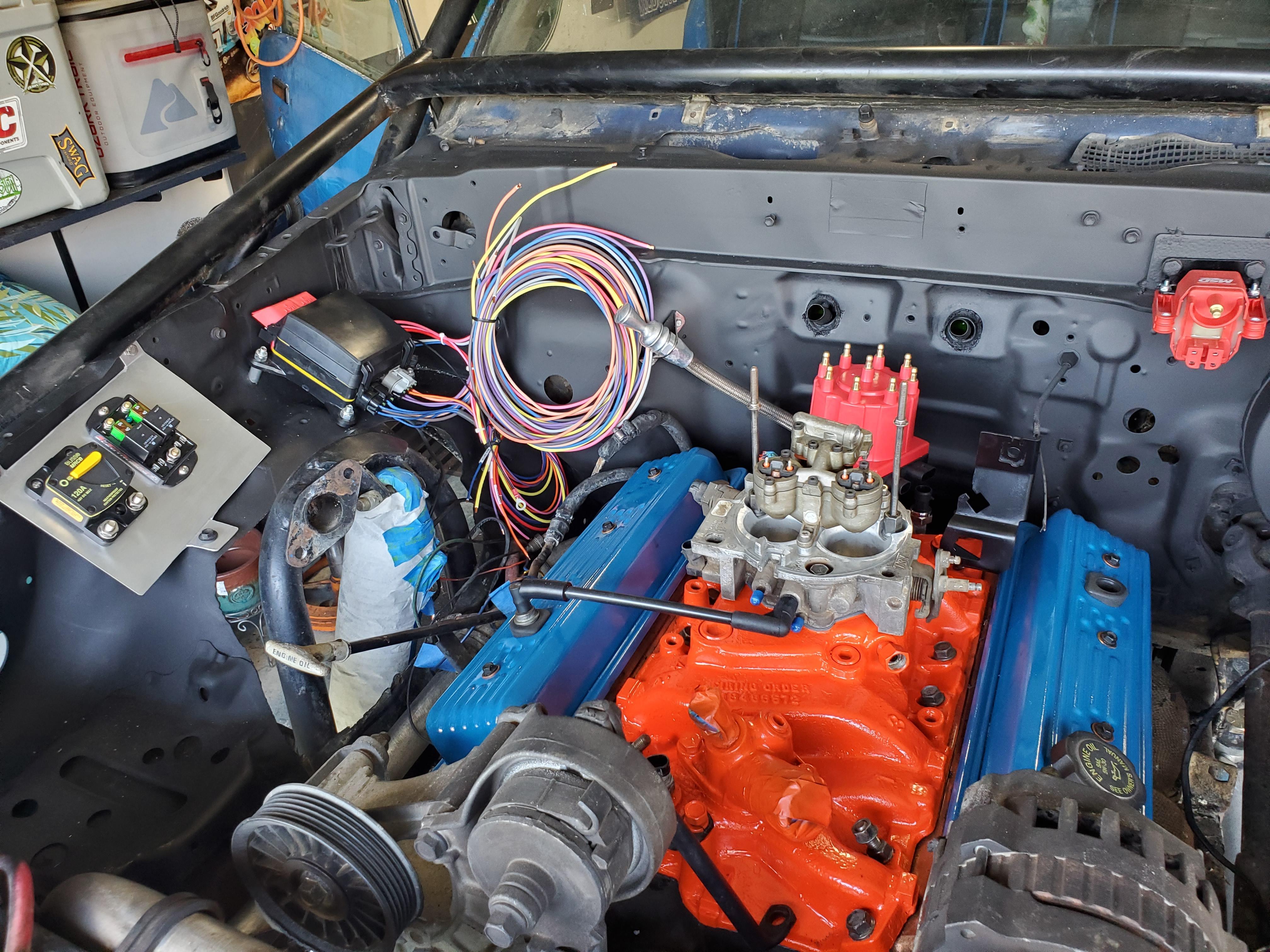

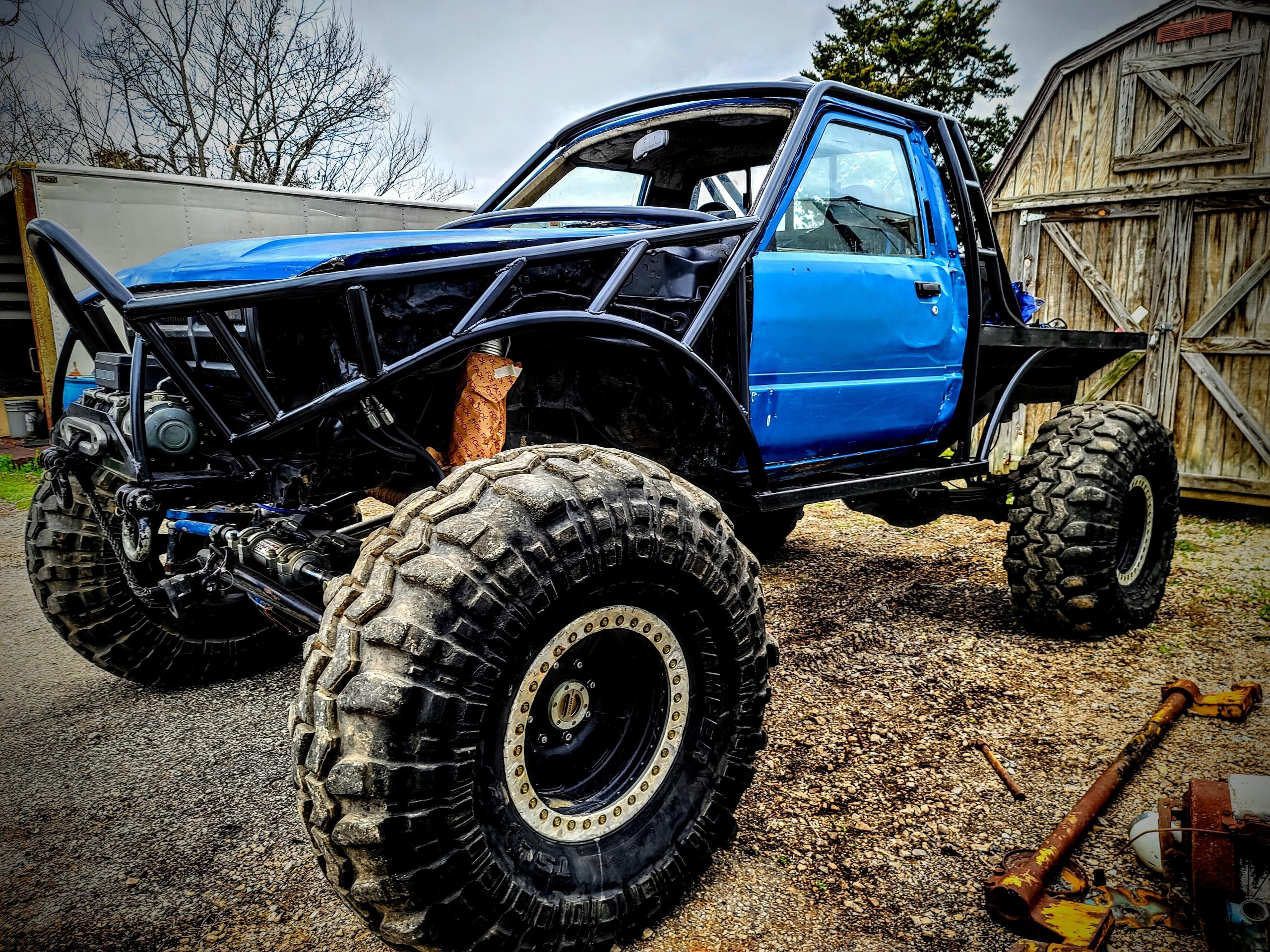

Not long after my trip to Windrock last spring, I had a crazy engine fire that started out of no where. I had shut the engine off after loading my truck on my trailer. Strapped the entire rig down, walked in to the shop to grab my spare tire, walked back out to the truck to flames rolling from under the hood. Melted everything plastic or rubber that was under the hood. Completely trashed anything wiring related. The only plumbing that was salvageable was the steering lines. I think the only reason they survived was because they were so low in the engine compartment. Not real sure on the cause but I am leaning towards a ****ty oil filled K&N air filter catching on fire after a back fire in to the throttle body(never heard a backfire). It's the only thing I can think of and it was obvious most of the heat was concentrated around the throttle body. That may be just because that's where the fuel was. Luckily I had several fire extinguishers close by and we were able to get it extinguished quickly.

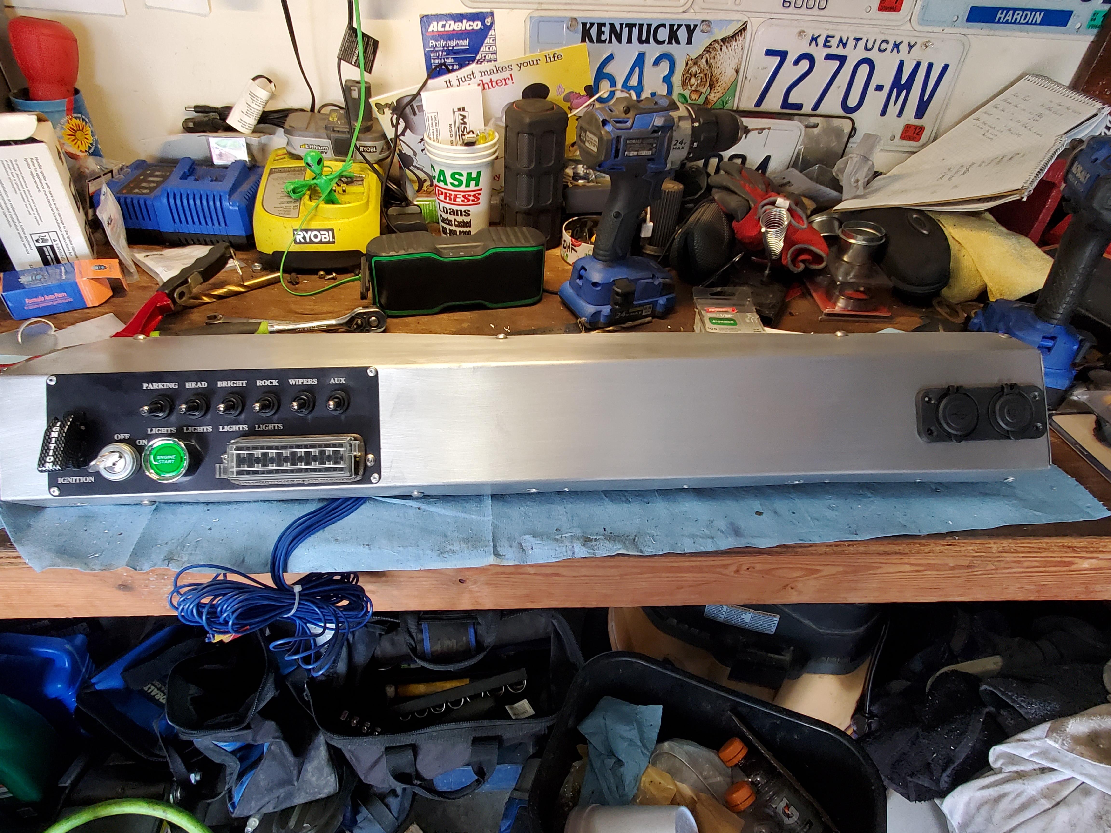

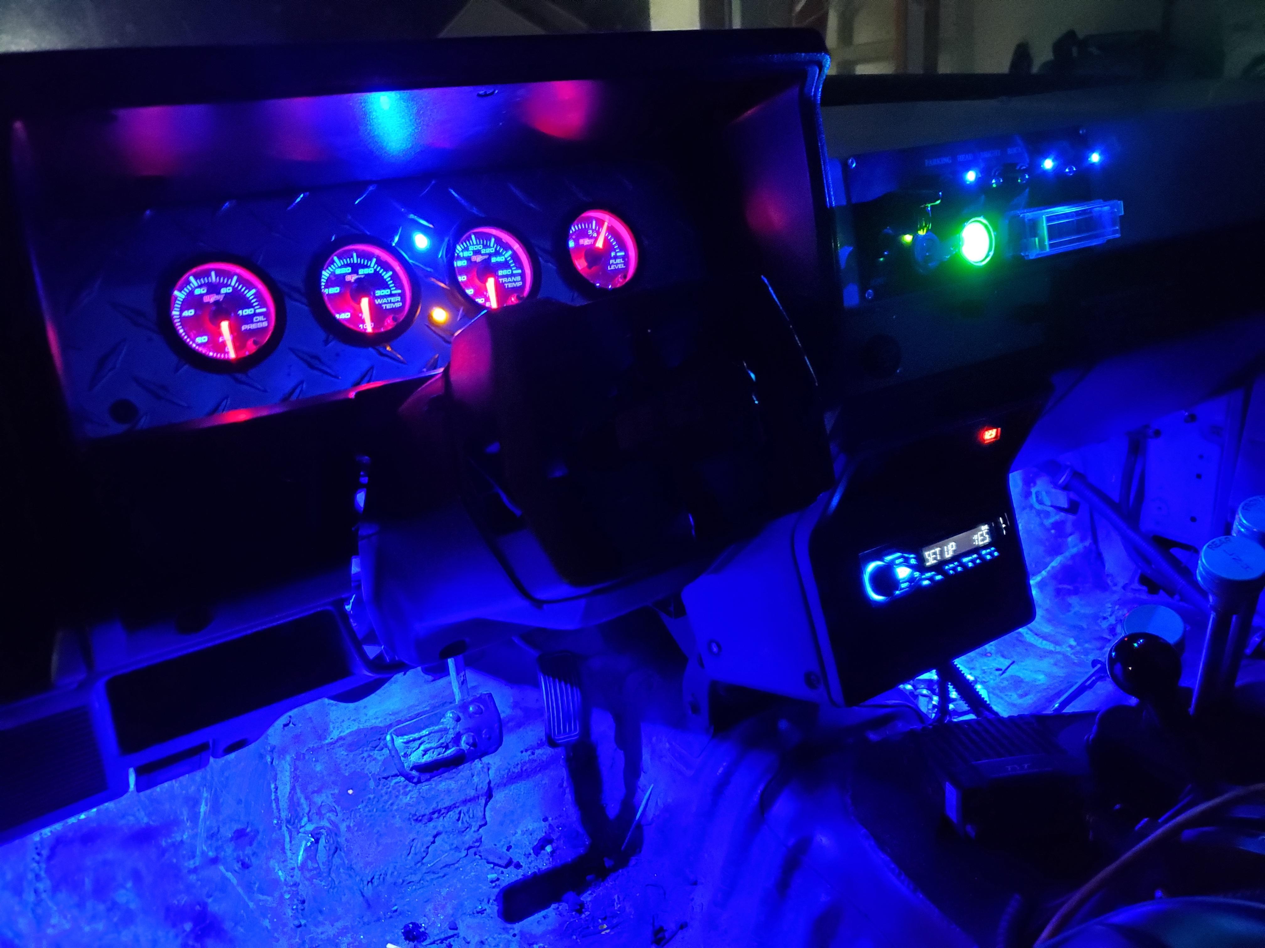

I am including some pics of before and after the fire. I stripped all of the toyota wiring from the truck and rewired the entire thing. I used a fuse/circuit box from BustedKnuckle and a custom switch panel from 12volt guy. I also wrapped the factory dash pad with aluminum and added some auxiliary power ports for phones, tablets, and other accessories.
