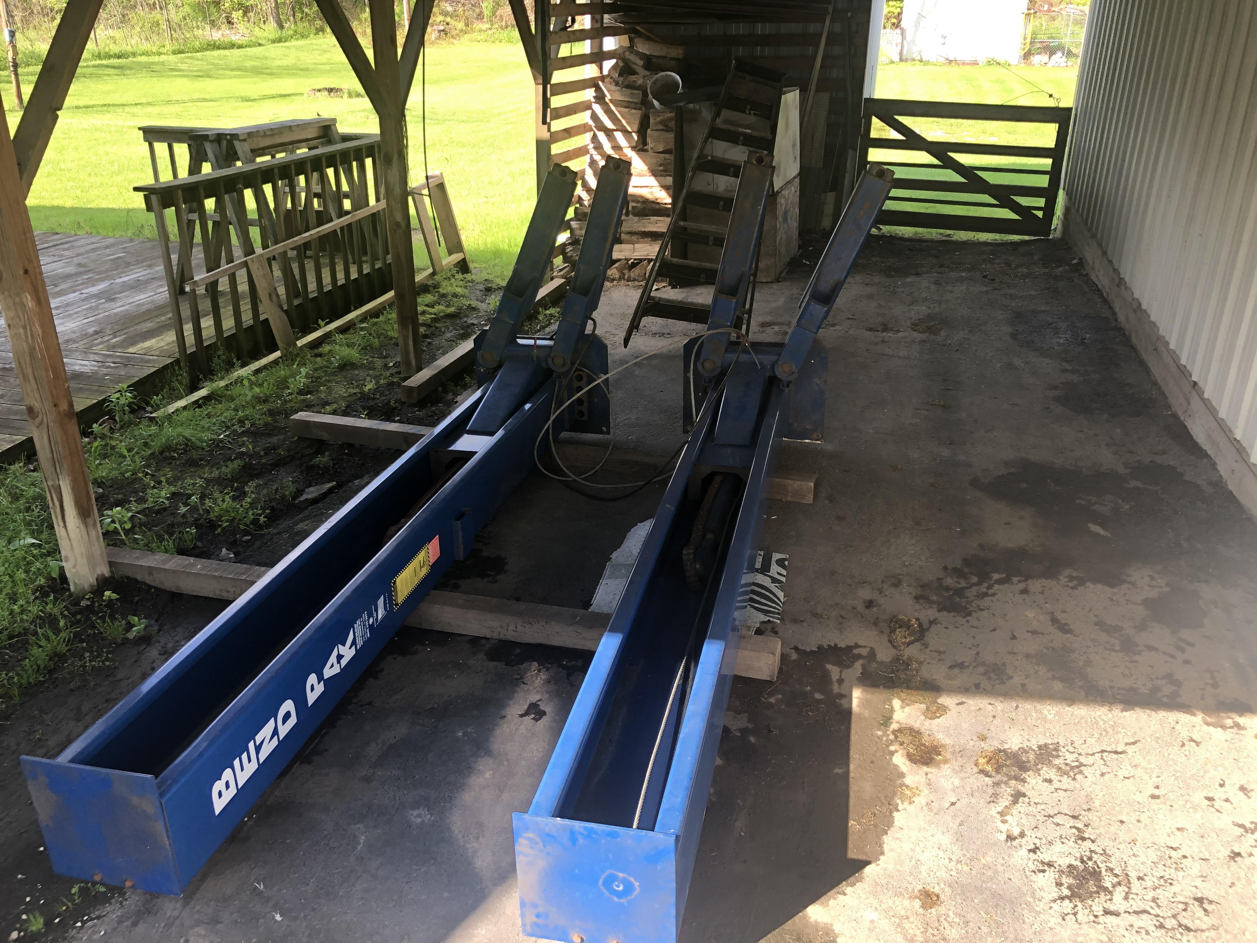

I gave 500 bucks for this gently used 9k unit
