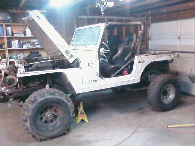

14 bolt is in, kinda. It's just temporary and will stay this way while I work on pulling the front axle and getting the 60 under there. :redneck:
I'm going to stick with the XJ leafs in the rear, but I'm going to re-do the shackle mounts (lower) and french the front of the leafs up into the frame like crashy did on Six-Nine's YJ build.

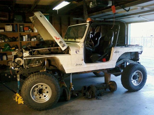

New wheel base!

Front axle is out... now the dilemma is whether to keep the front fenders (such as they are) or scrap them. I like having the inner fenderwell, I got lots of **** to relocated if I ditch them... but it would make working on the thing so much easier, since I have to run all new brake lines and make new shock hoops up front and such.
I'm going to drink another rum and coke and think about it for an hour, then I'm going to go ahead and start ripping the fenders off I think. :awesomework:
