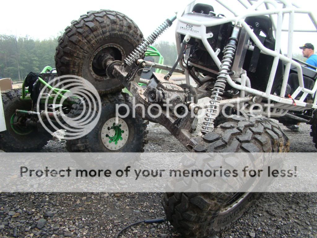

What's a good up travel number that everyone tries to shoot for? Front and rear. I'm running 16 in coil overs all the way around.
Do you run bump stops up front?yankster said:I have a full tube, rockwell buggy and it's set up 50/50. Flexes great and bounces good as well.
yankster said:Yes. 4" bumps with about an inch gap at ride height.
Neal3000 said:How does that equal 50% uptravel?
TBItoy said:His shocks may have more "flex travel" than "bump travel".
If that makes sense
Yea thanks for the info. This is all new to me.Elliott said:Get you some 2" bumps or your bumps are going to fight your Valving in your coilovers. Meaning that there is a difference in the Valving you need if you were compressing just your coil overs or compressing a coil over and a bump. It will make it a little easier to tune the coil overs for regular use and only using the bumps for what their intended for ( slowing the suspension down when its getting bottomed out).You can make it work with it always riding on the bumps, but if you give it more clearance by using 2" bumps it's just a little easier.Just something to think about.
