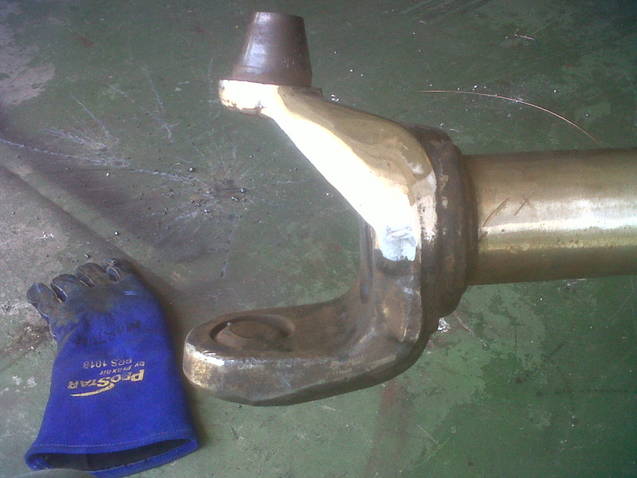

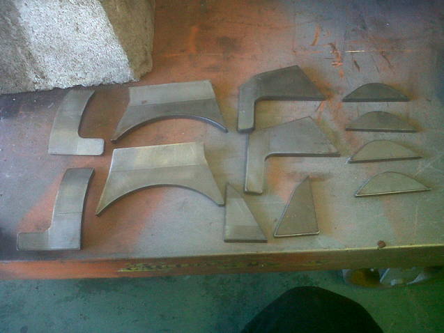

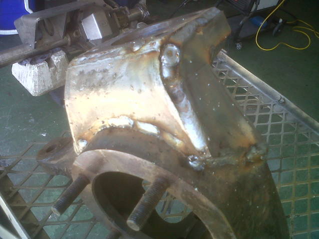

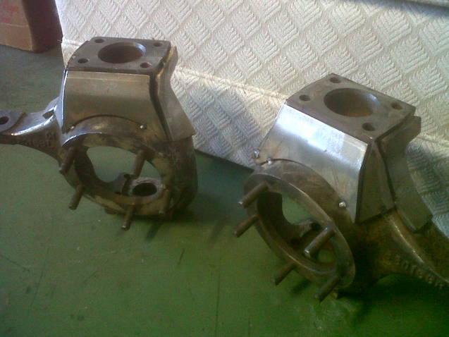

Also got a gusset kit for the knuckles. I can't swing for the reids right now but these should hold for a while. I had to do these in stages, since they are cast.. I preheated them in the oven at 500 degrees and then heated them almost to glowing red with the torch before welding them up (on the highest setting) then put them back in the oven and slowly turned down the heat and cooled them over a few hours time.

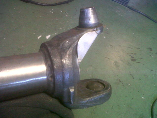

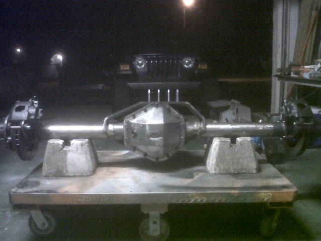

Also gusseted the inner "C" on the axle tube to add strength..
Inner C gusset... tacked into place and then ground and "filled" several times for a smooth transition

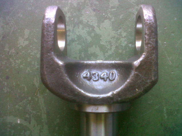

Started collecting my Chromo shafts for the 60. When I bought it one side had yukon chromos (short side inner/outer 30/35 spline) but the long side was completely stock. So I just purchased one more Yukon outer stub and next month will get the long side to complete the package.

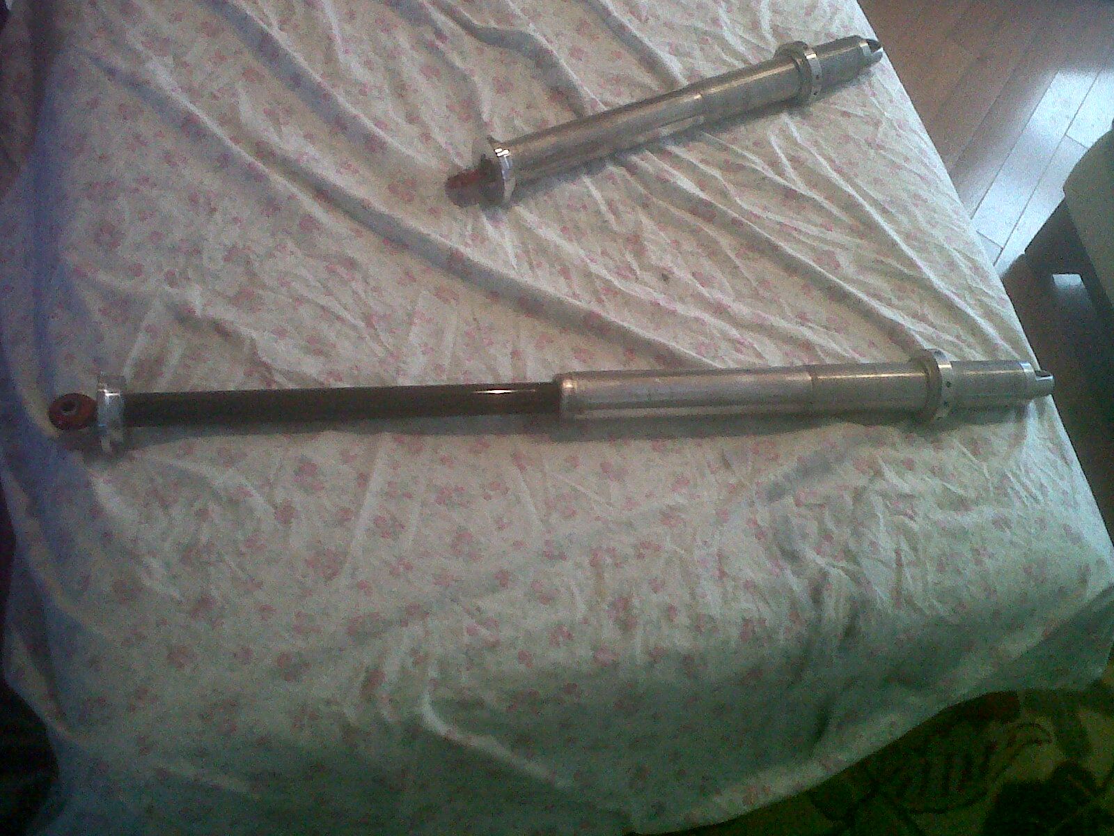

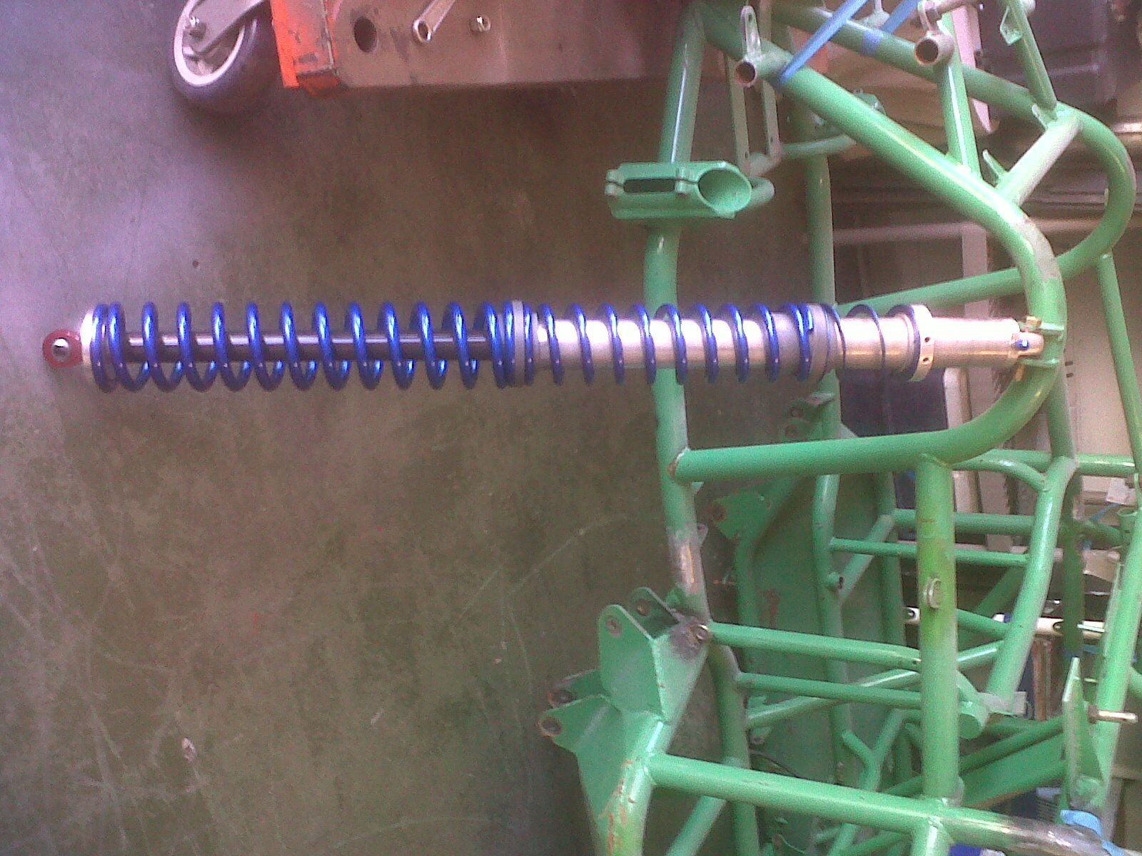

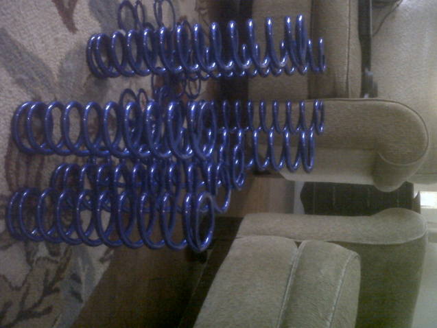

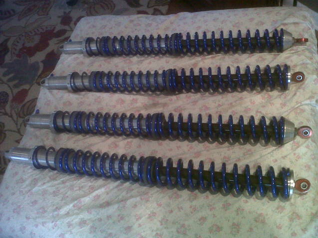

Got the springs for the 16" TK1 coilovers back from the powder coater's today. They are QA1 coils 150/200 spring rates. They were pretty rusty and just plain crusty.. I assembled them in the living room, It's starting to get muggy in the garage here in FL. Going to have the same company possibly powder coat the chassis when I'm ready in a hammered typed finish..time and money will tell :dunno: Anyways on to the pics

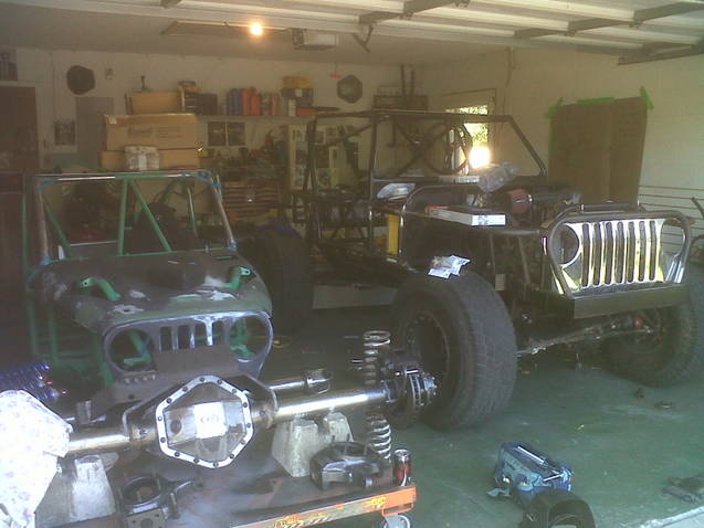

Rolled my buddy Mike's buggy into the garage today and started working on it to get ready for ECORS B class July 4th weekend. We welded in the shock hoops, started on the PSC full hydro, and started lowering the seats for more head room with helmets. These tires and wheels are just rollers. Will have krawlers/walkers on race day :dblthumb: Will let you know how we made out after the race! The green monster will get pushed to the side for about a month but after the race we will get back on it hard.

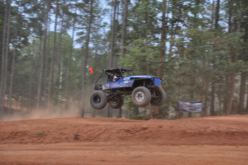

Well, were back from the race and had a blast! Mike placed 3rd in B class his first time out.. :****: The race was 6 laps and each lap was 5 miles long, I totally get the "endurance" thing now. The best way to describe being a co-dawg is its like being on a dusty roller-coaster for about an hour and a half. ;D Anyways, here's a few pics...congrats Mike!

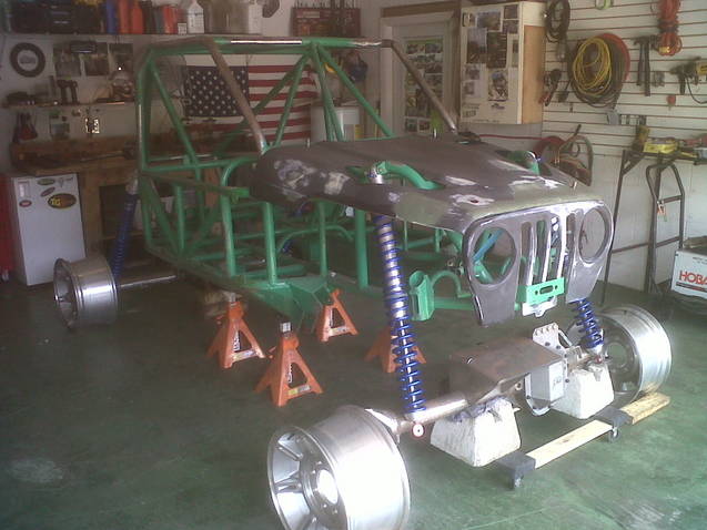

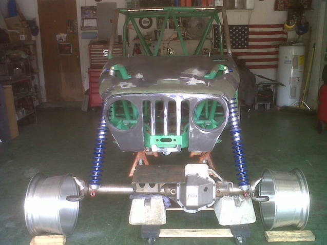

Ok, with the racer gone and the garage cleaned up, I started the layout to see where I want to set my wheelbase and to start building links. Bringing this build back to life!

I had it at about 107-108 and it was perfect. Its pretty nimble and small... i would try to keep it under 110 to keep the breakover angle decent.
however i just noticed...
I would be a bit concerned with that truss/steering mount on the axle. You would be hard pressed to have decent ride height and uptravel with that thing on there. I can get you some pictures of how it was on mine...but the axle and chassis were designed so the axle would go up into the chassis right there. there was no truss on top of mine. The steering went in front of the axle (on a long tube bent around the front). The upper link mounts BARELY went up inside the chassis in the front. It sat pretty damn low and had about 6 inches up before full bump.
Let me know if you have any questions on how it was setup.
