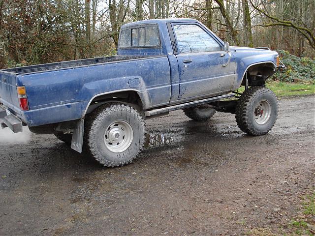

Its going to ride firm, not flex much. I didnt want it to flex much up front, I just didnt want to buy long shocks, deal with tierod overlap, front slipyoke falling out, bumpsteer, etc. So many problems pop up when big travel is the goal.
With it being locked up at both ends it will go eveywhere I need it to go and it will still handle GREAT when my girl is pimping it around town! It will mostly see snow, sand, mud, moderate trails. Its a purpose built machine, being EXTREME is not its purpose:cheer: plus the rear will flex pretty good with no real downfall other than the cab following the front axle.

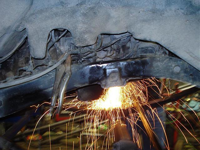

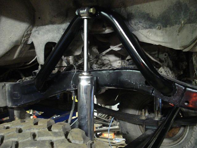

Got the shock mounts removed in preperation for some shock hoops.

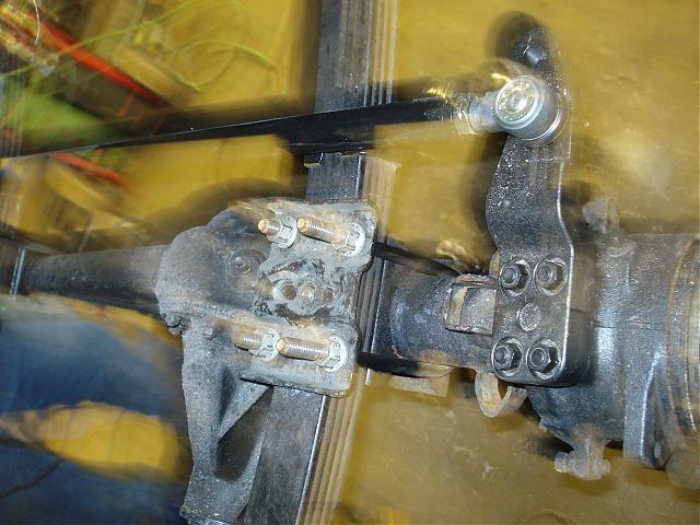

Put my new hysteer kit from Trail Gear (odie) first.

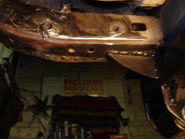

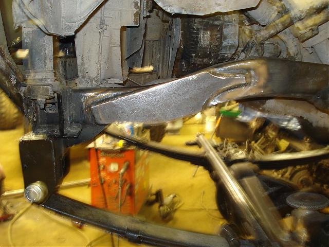

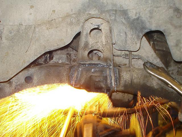

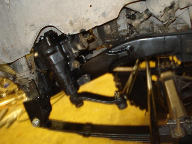

Threw a plate on the frame for an IFS steering box next. Sleved the frame through both sides with some 3/4 DOM. Used stock box toyota bolts. I mounted the box a couple inches further foward than it needed to be in case I ever go to a longer spring in the future (no crisscross TRE).:D
finnished steering box, mounted.

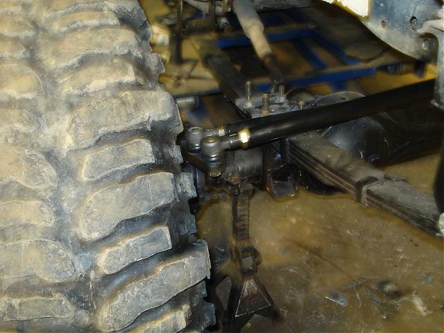

Another of the Ubolt flip plates and Ubolts and Hysteer. The plates I used came from the wrecking yard off of f150-f350s of many years, broncos too. The Ubolts are off of ther same rig, super hard, impossible to booger the threads.

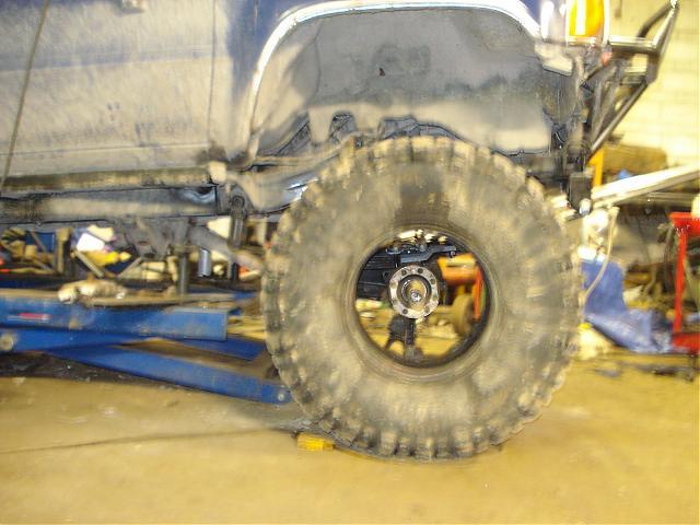

I can thank Mr.Dirty for ending my tire search.:cheer: :awesomework: :beer:
A little bigger than I was thinking, but they are perfect. 37x13.5x15. I am going to mount them up on some bead locks I picked up, just need to weld them and mount them!:;
Looks like I am going to need to run a set of 30 spliners now that Im not spinnin 33s! The boggers are gonna look killer on the truck.:awesomework:

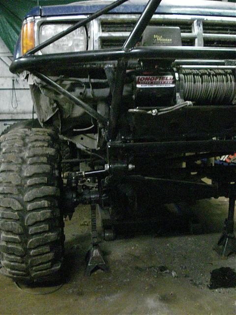

Got the front wrapped up yesterday. Installed the front vented rotors, calipers, hubs, shockhoops, shocks, new spring pins, tightened it all up. Moved the brakeline tab down the frame rail a bit. I forgot the camera, so youl have to use your imagination!:beer: :beer:
