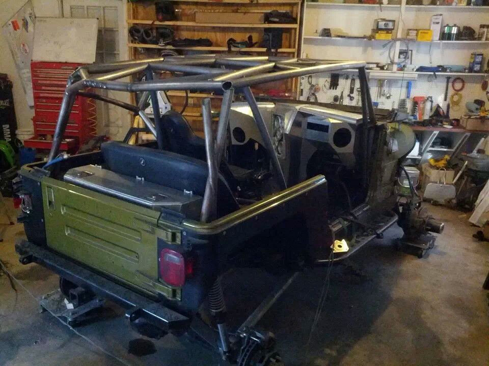

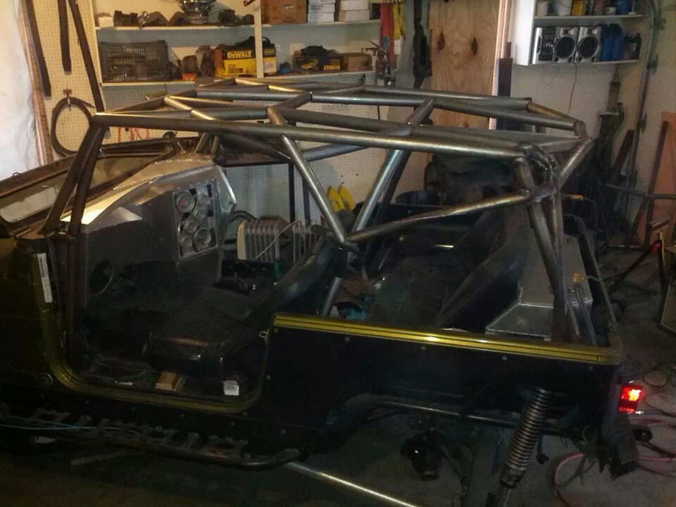

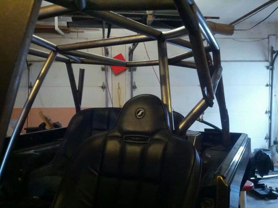

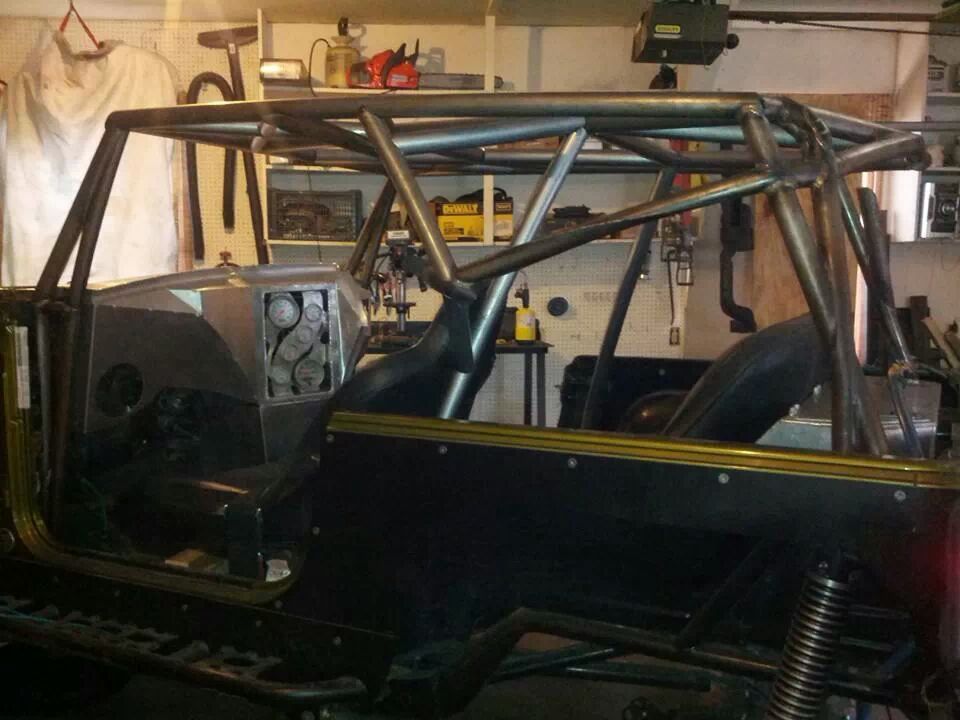

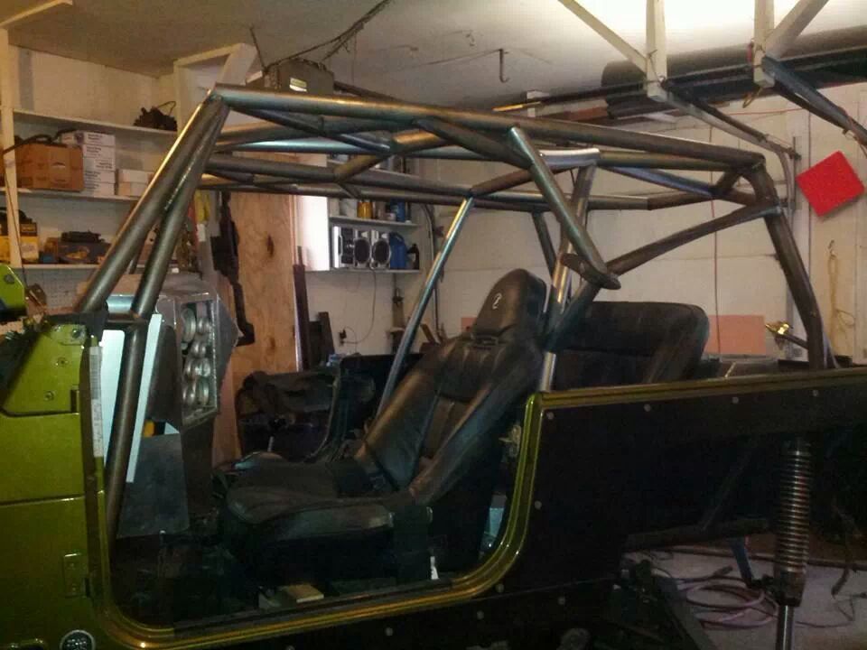

Its startin to come together. Man that seems like alot of fab work for a jeep though? I agree on the shock angle. You want them as straight up and down as you can get them with the travel direction of the axle perpendicular with lower link.
bee513 said:
how do you get more travel? A 4 link gets shorter as it drops down. the rear will move towards the cab(tub). so you would get less travel out of the shock
This is done to allow more travel out of the shocks while not cutting the tub, keeping the ride height low. VERTICAL POSITION.

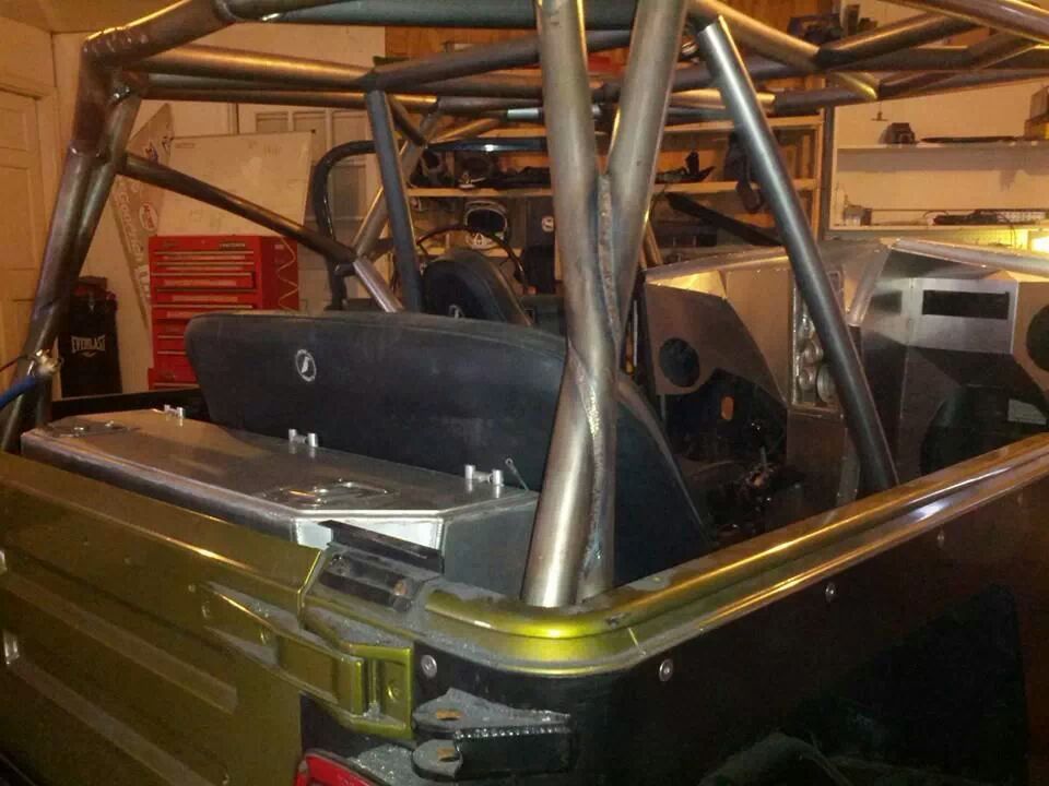

Dynamite Design said:
I couldn't narrow down which chapter of the suspension novel to explain, so I will just say PJ built it just about at good as it could be built under a jeep tub. The force of the compression is traveling straight into the cage. If it was mounted straight up the jeep would either sit higher or have less up travel. I tuned the shocks for the mounted position, so that is the performance advantage, along with the chassis reliability that PJ formed.
As far as I am concerned with the travel, it looks to me like the shock is mounted perpendicular with the angle of the lower link. Therefore giving you basically 1 to 1 motion ratio and total control.
Thanks David. I know you understand suspensions. I think the owner will vouch for the performance of the suspension. We had a choice to make and i decided to make it tie in to the cage, and not go through the body considering it was still going to be street driven often. It still sits pretty low for a full body tj and it drives great on the street and the trails. I have used the reverse mounting of shocks in the past with good results. Sometimes to make room for wide rear bench seats, its the only option.
