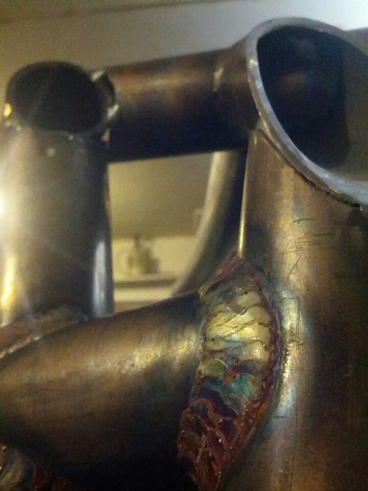

Ok we get it.... You can walk the cup with a tig welder. Why are you not cleaning the tubes to be welded? There is so much **** in there that you can see it in your pics. Also what's the thought process of making the weld so big around some of the tubes? Its like 1" on my computer screen. You obviously have a decent skill set, just wondering why you wouldn't take the extra steps to make it right. Your argument for them welds being on a trophy truck is pretty lame, can you give some examples of something that has that much weld? Here is probably the best documented build and you don't see anything that looks like your stacking mig welds, http://www.race-dezert.com/forum/showthread.php/31417-Something-New!! I was always taught that a weld needs to be no larger than the thinnest material. Looks like a bad use of time, materials and consumables all of which I would guess the customer would be paying for.
The tubes are super clean. The **** you are talking about is a drawback from not welding for 2 years. Seems like you know all the right ways to do things.... I'd love to see you do better.
I feel no need to justify my work, and get in a interweb **** swinging contest. I guess by "clean" I mean more than just getting the grease and oil off the tube. If you were to quickly clean the tube with a flap disc, expansion wheel, scotchbrite pad etc. A lot of that dirt will not be present thus not coming to the top and contaminating your weld. Like I said you do a good job, but a few simple steps can make a good weld be a great weld in know time. Sorry if you took offence, I will go back to pointing out Christmas ornaments..
So now I understand your talking about the outside surface of the tubing. If I had to explain my thought process on it, I would say that I don't want to see any type of sanding marks on the material. If I had to chose from what someone was picking apart, I definatly wouldn't want them to say, man, all those places you sanded and grinded on this cage make it look like you messed up a lot. The raw fabrication is what I want this jeep to show.
Not wanting sanding/grind marks is understandable but I think what sledneck is gettin at is that a few simple although sometimes tedious steps make a huge difference in weld appearance and quality. You got skills for sure tho
