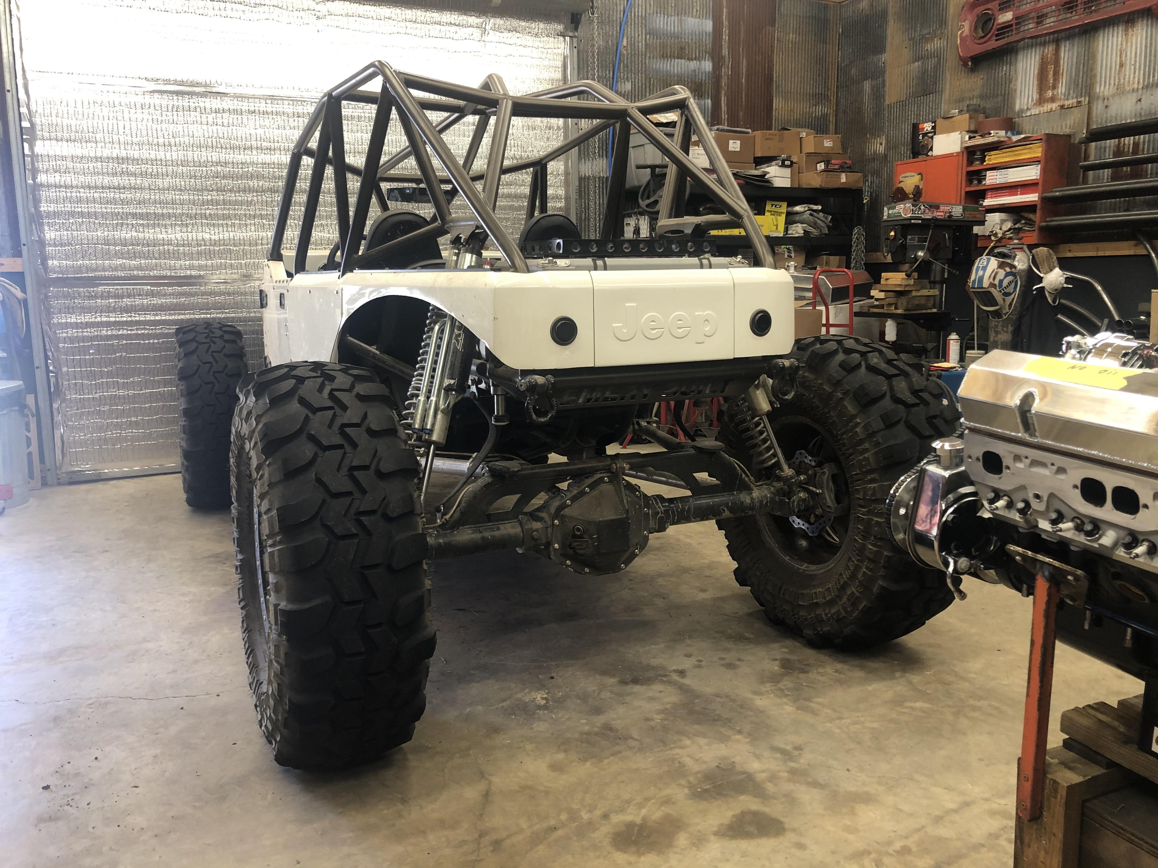

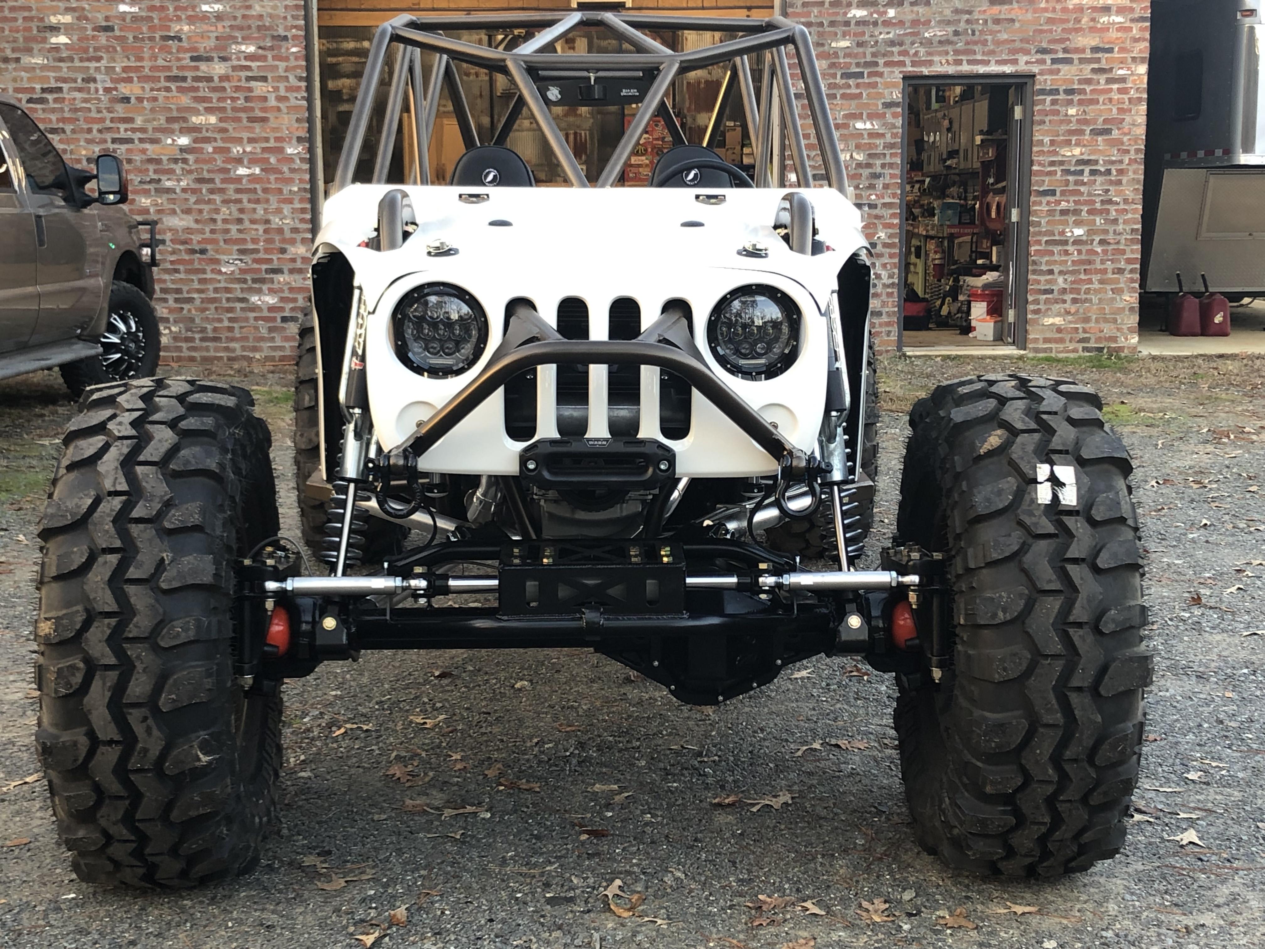

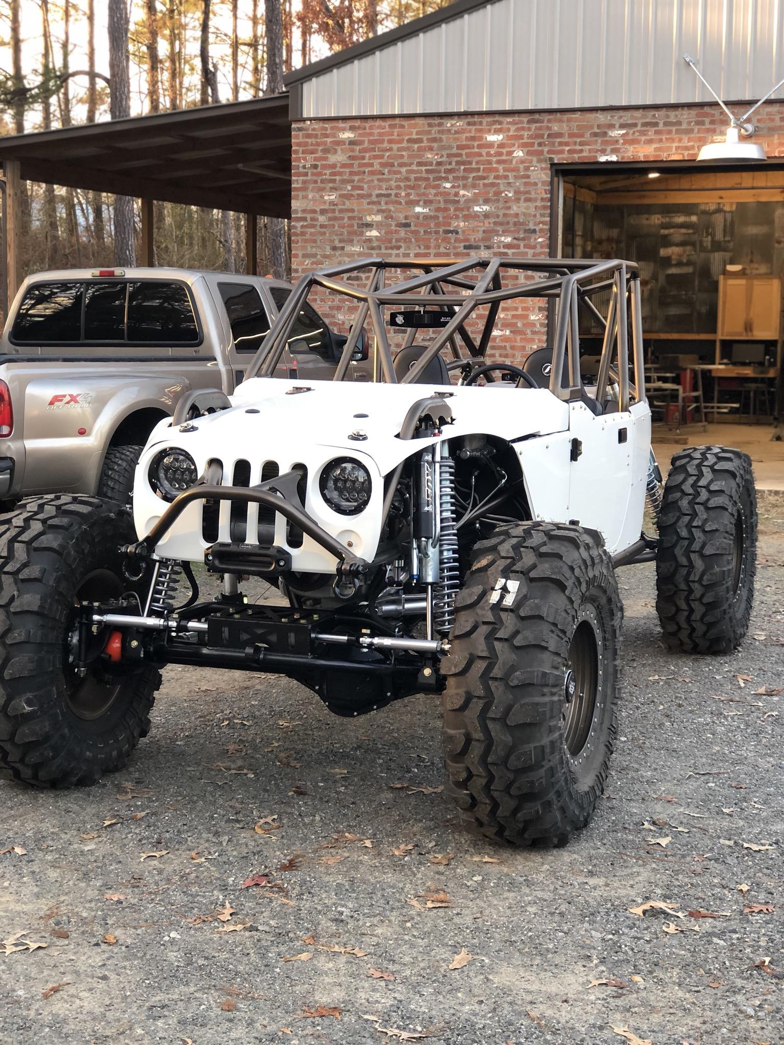

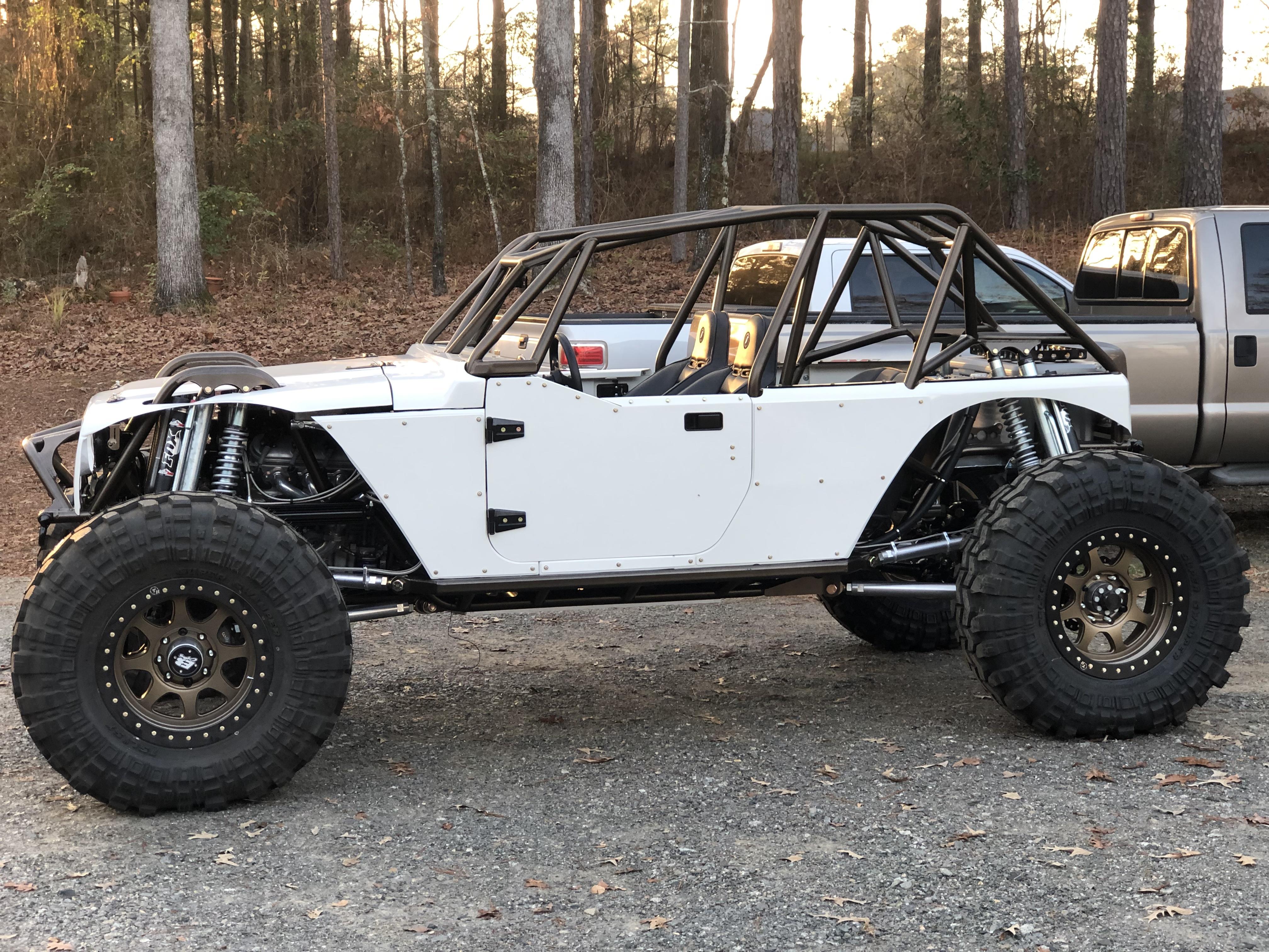

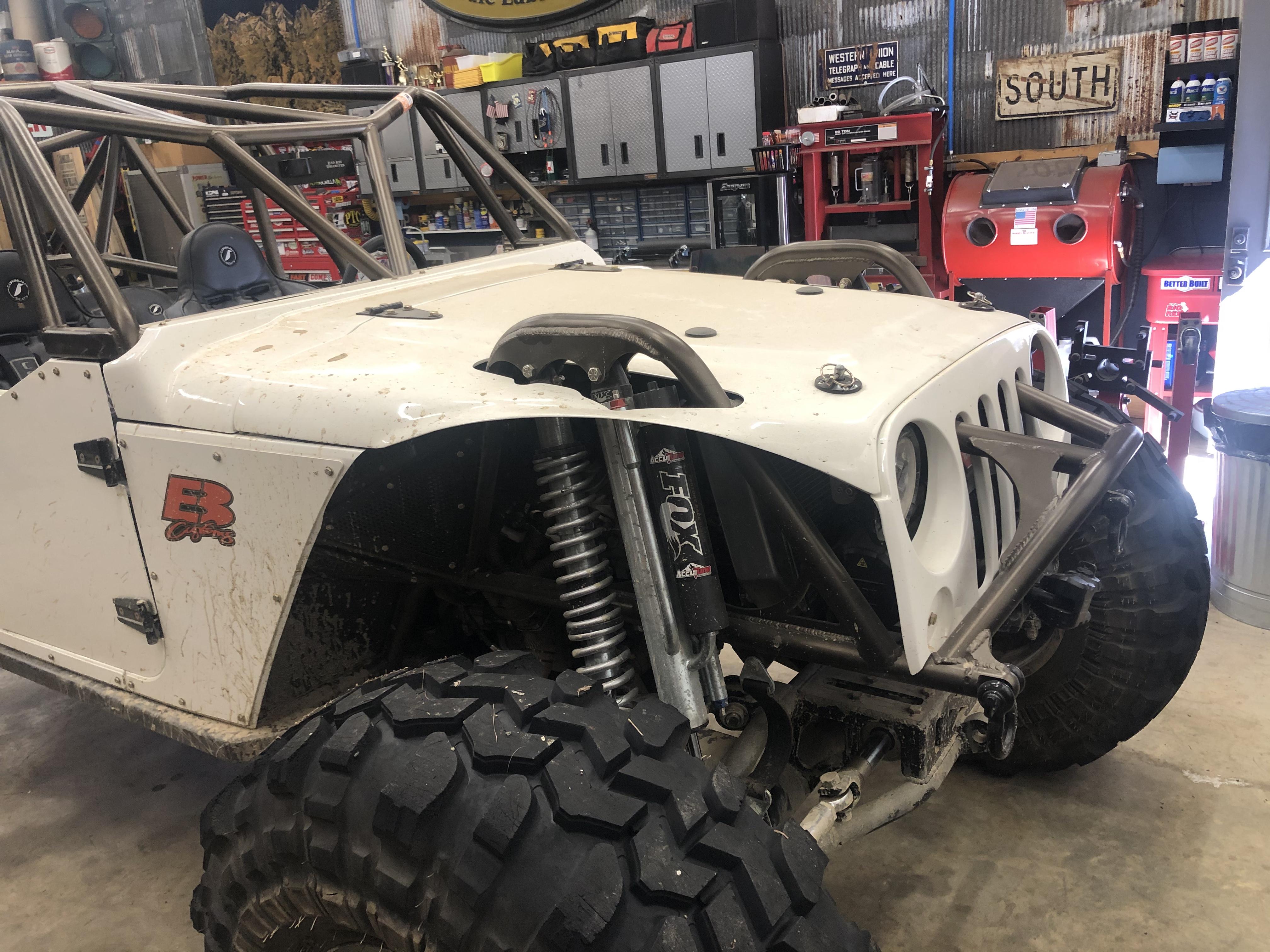

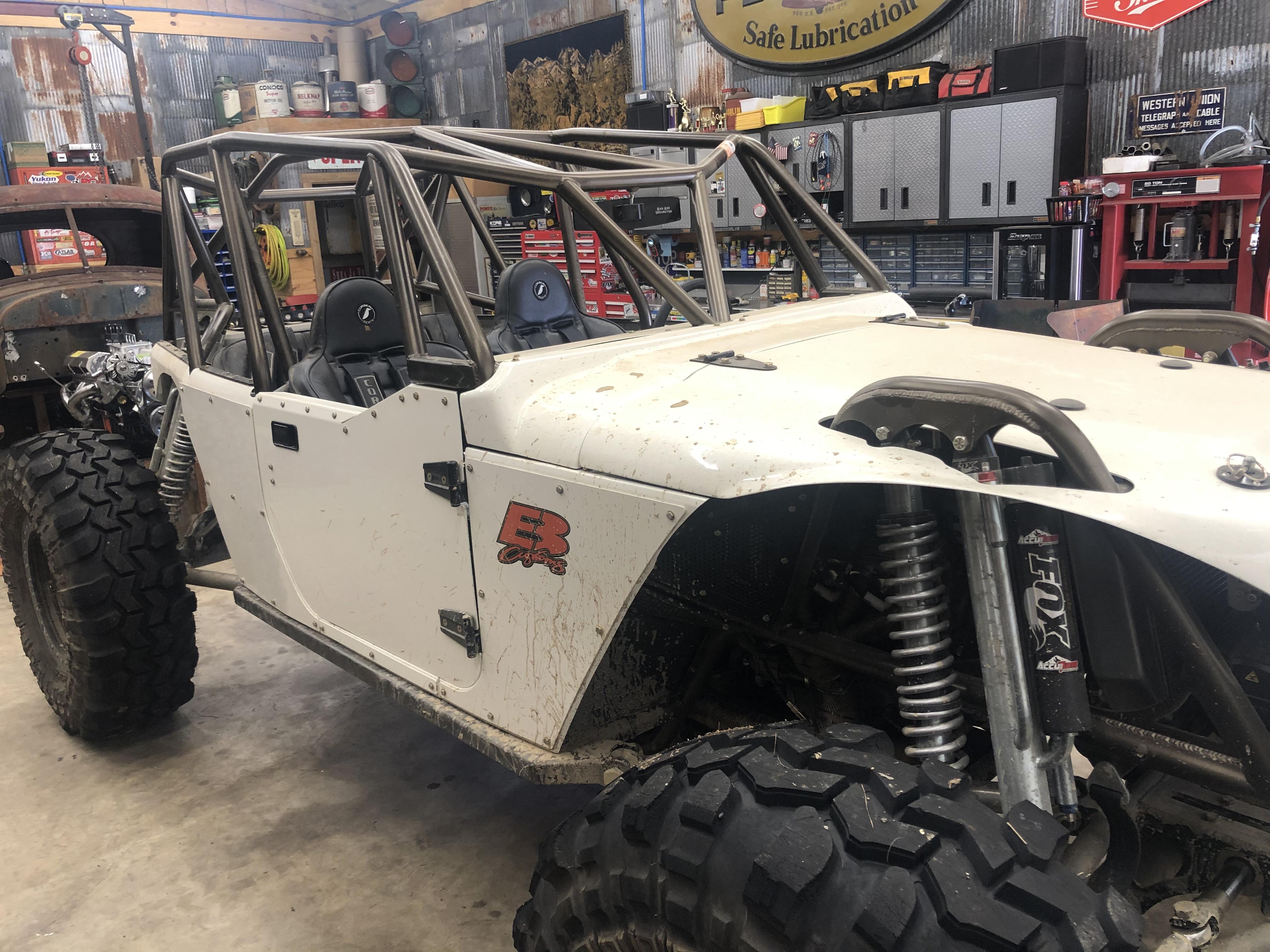

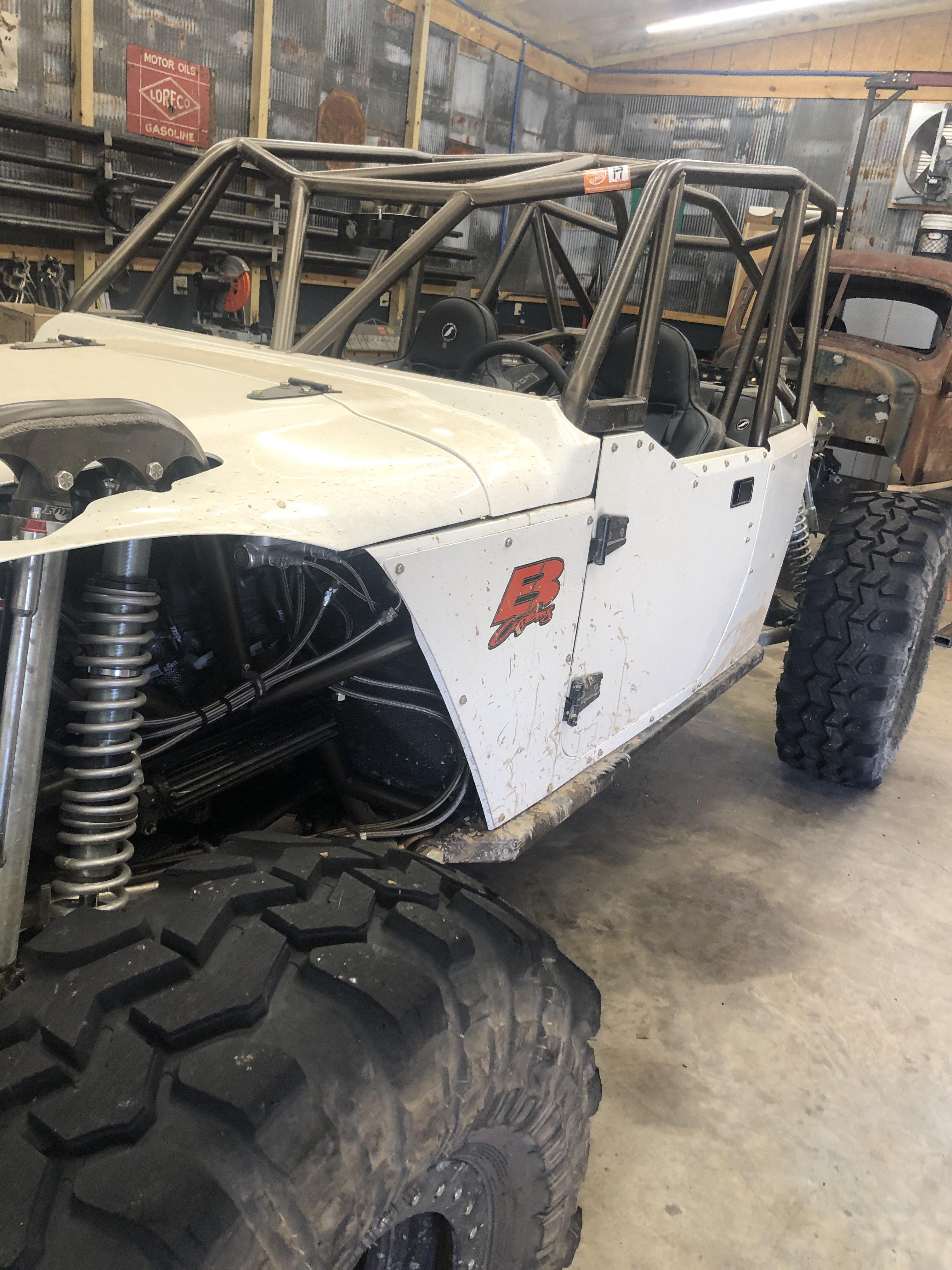

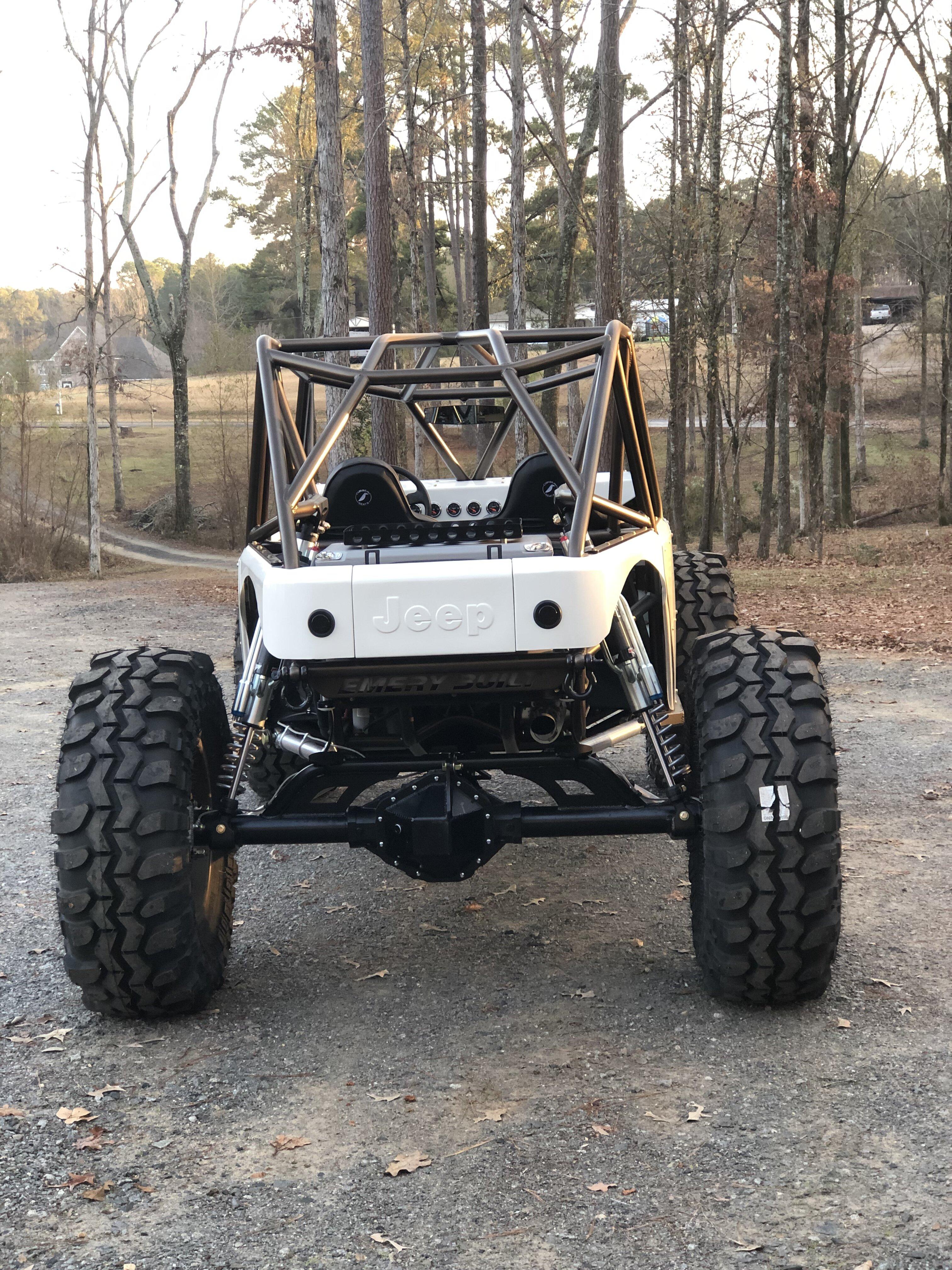

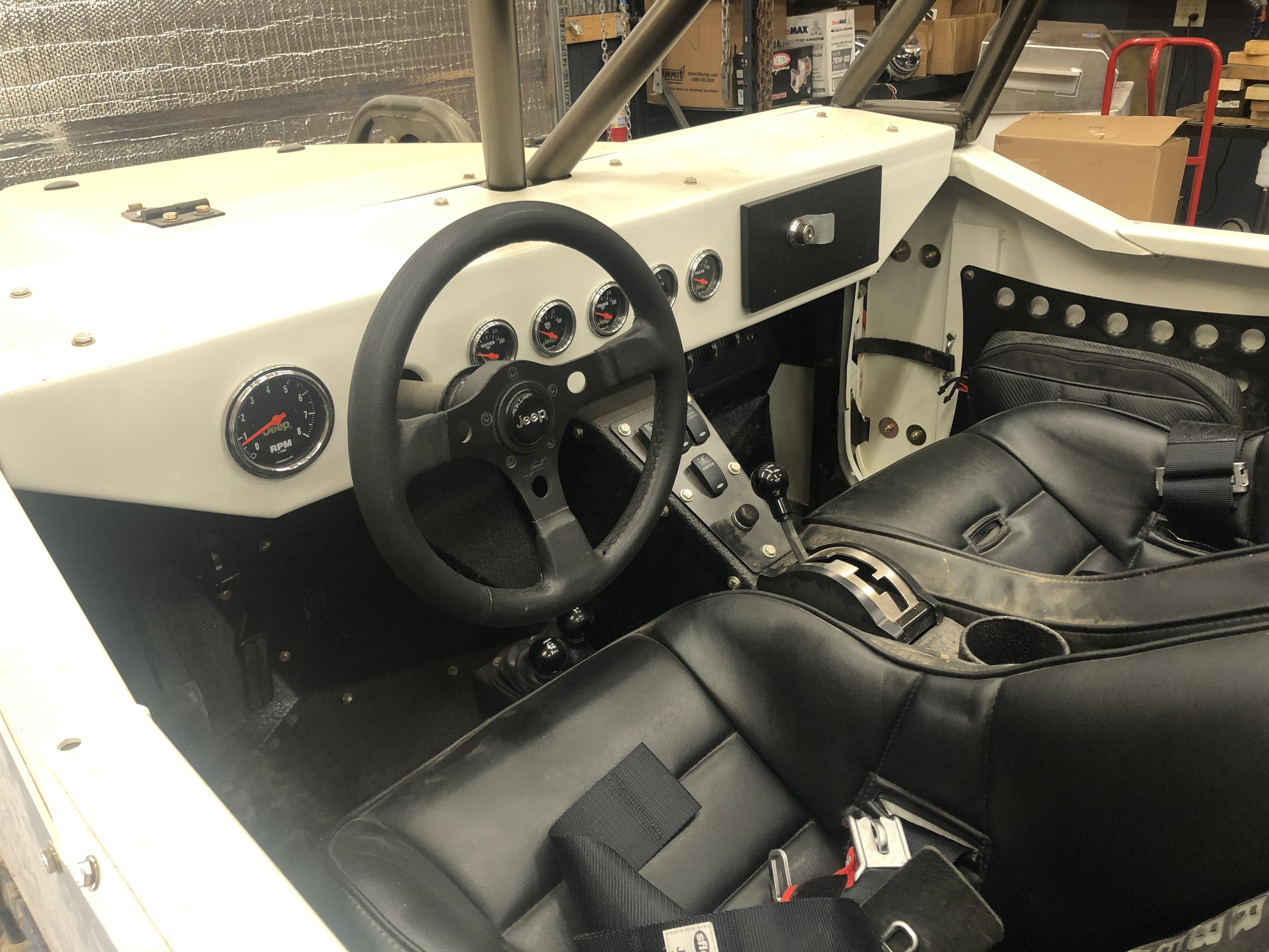

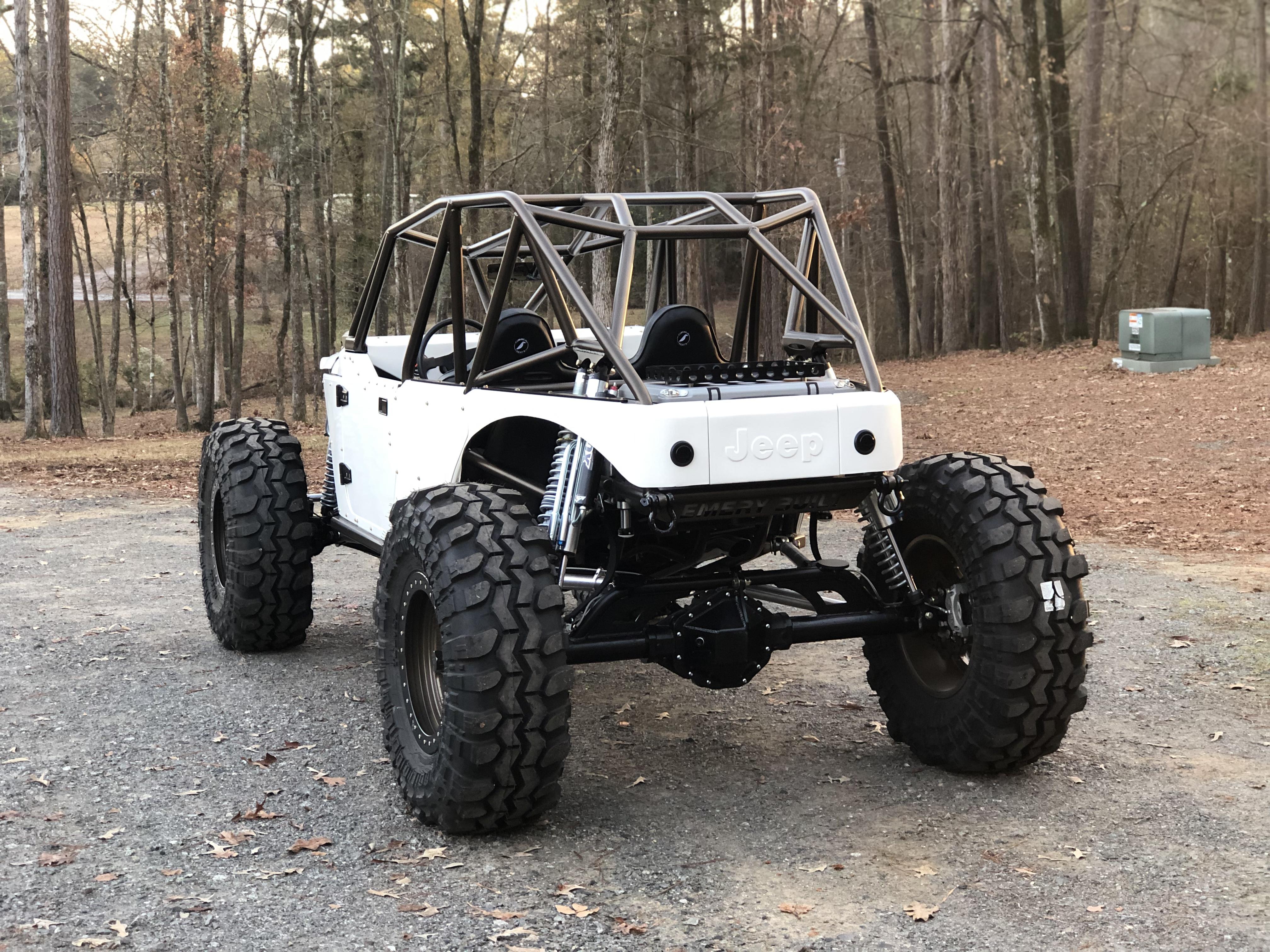

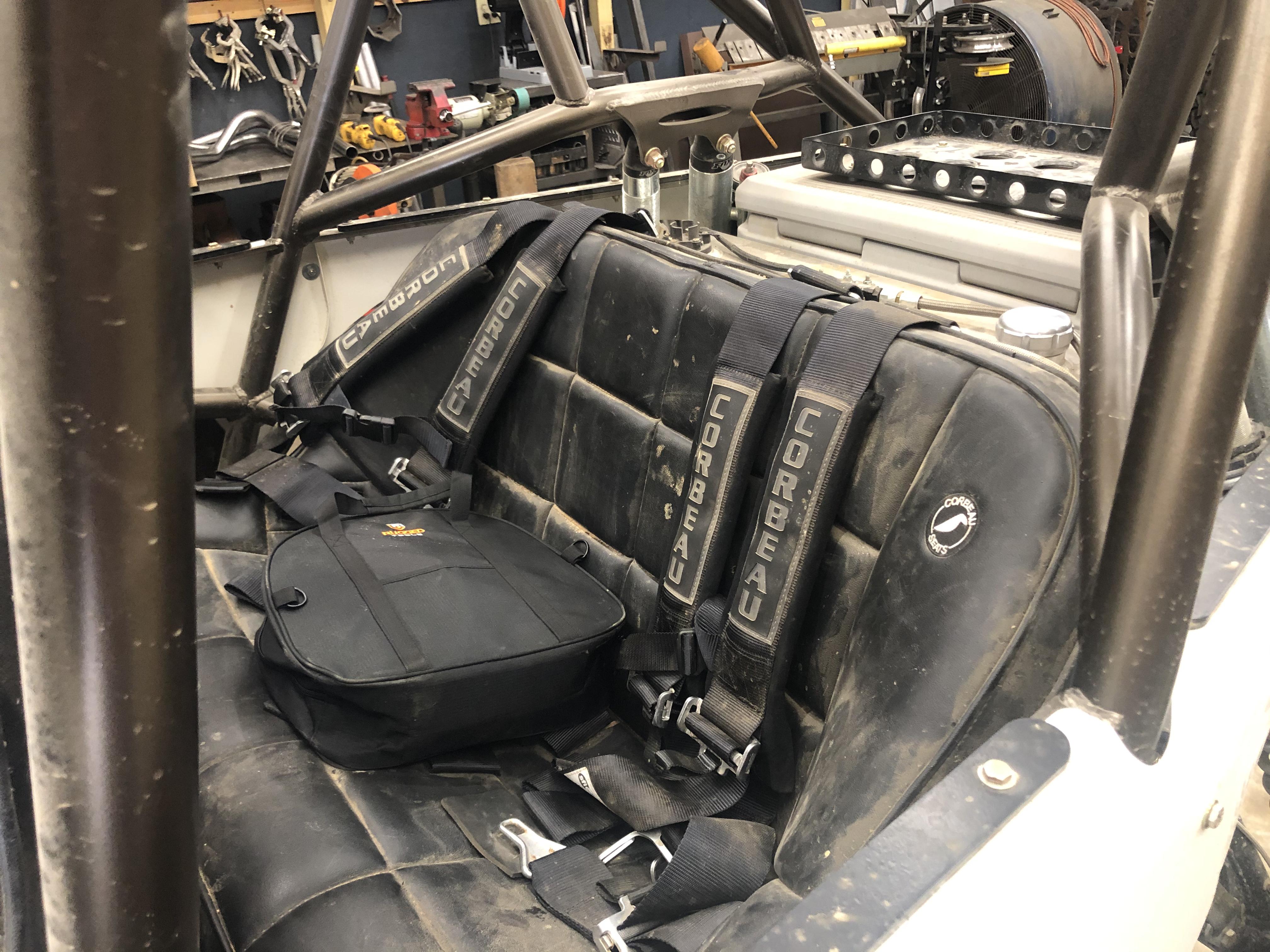

Almost done. Been a long time coming. Here's some pics from this weekend for those not on social media.

I've prowled this website for years and I have always thought you have done an incredible job. On par with any professional shop I've seen (I'm no expert). Would love to see you build a full tube chassis tacoma. Would love to see your take on how to bob the bed and exo.
sick, as always.. I'm gonna do my best to own one of your rigs one of these days , just gotta let everyone knock the new off of them so I can afford one ;)

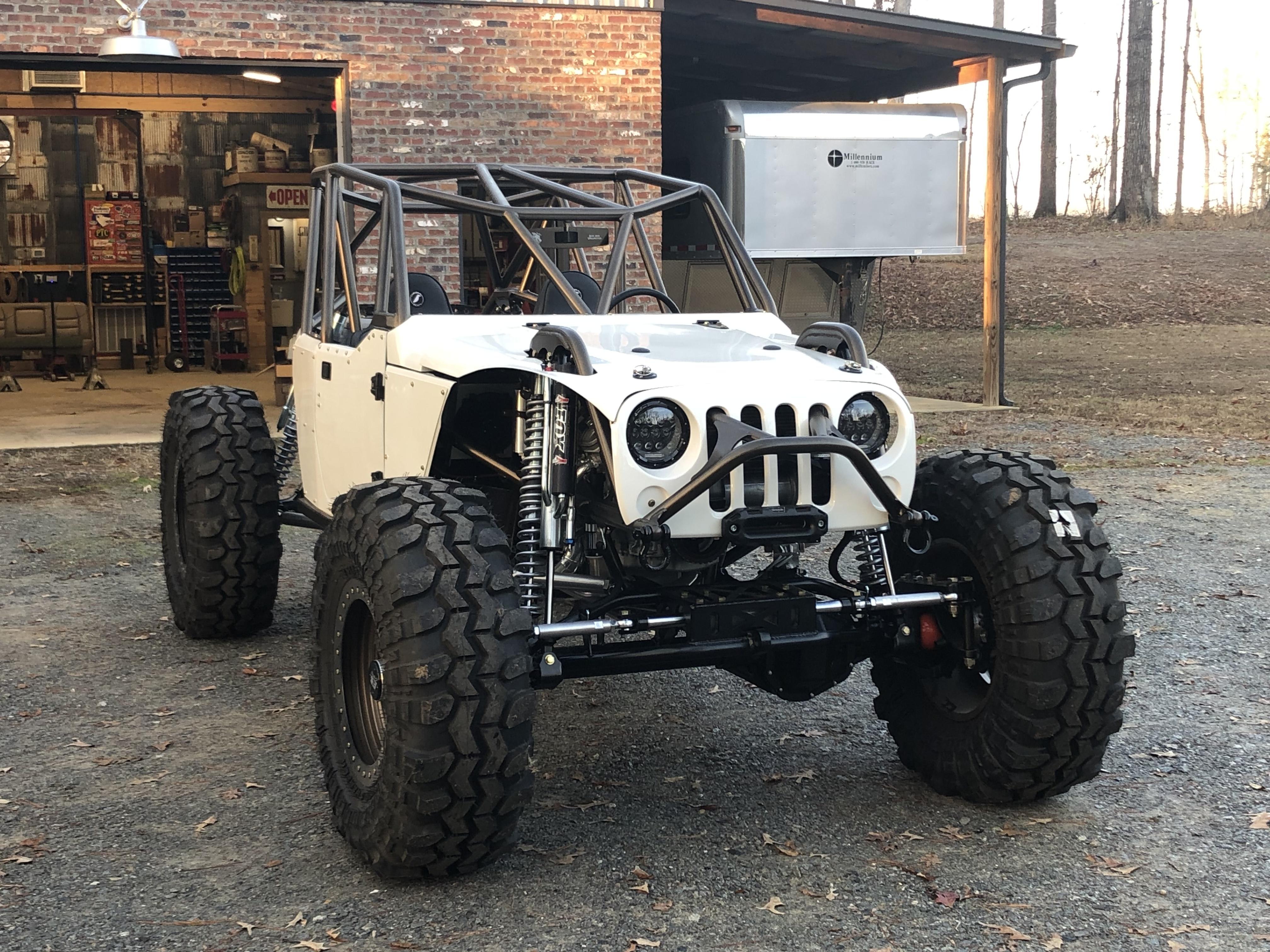

Got any updates on the JK6?

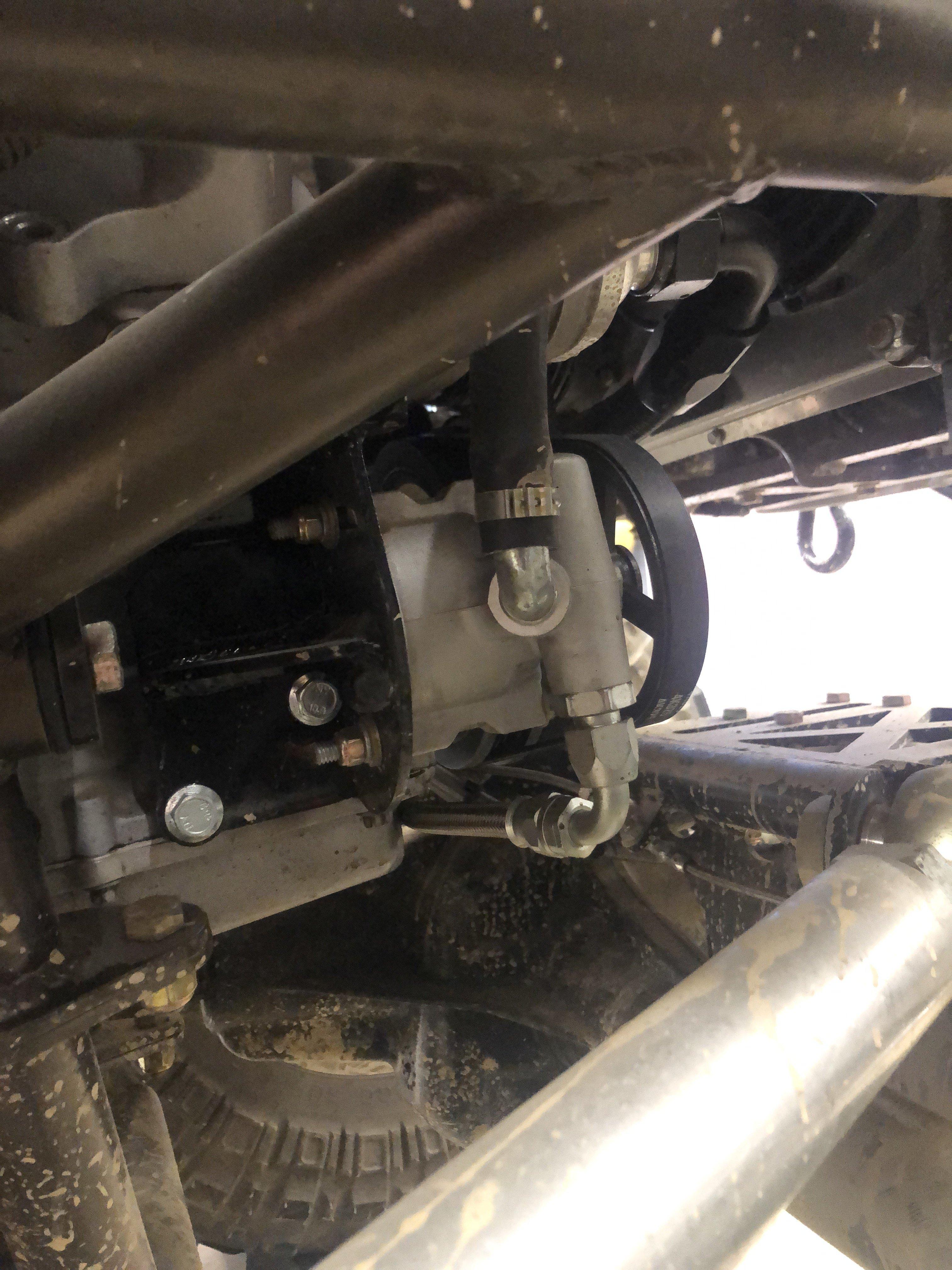

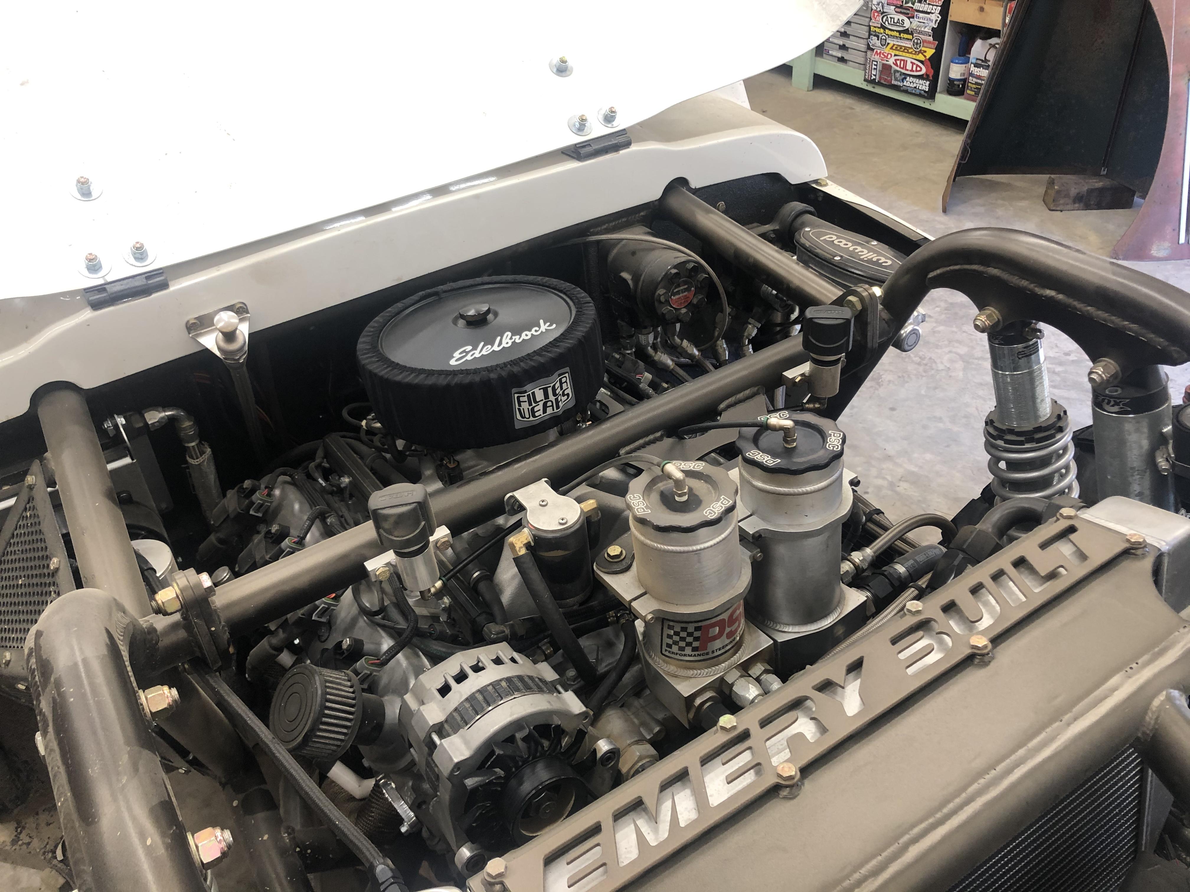

Well, I finished it last year. On its maiden voyage it dropped oil pressure and the motor had to go back to the machine shop. Turned out to be a cam bearing walked out and was rubbing the lifter.
Since the motor was back out, I swapped the FiTech for Edelbrock Pro Flo, changed the headers to Sanderson and redid the exhaust, changed mufflers and added a second pump for the hydro boost.
I've wheeled it once (maybe twice?) since then.
It's been sitting in the trailer for the past several months. Got it out during the snowstorm. Battery was dead and tires almost flat.
It's sitting in the shop now, waiting to get wired for a battery charger before it goes back in the trailer.

That's a rough first outing!
