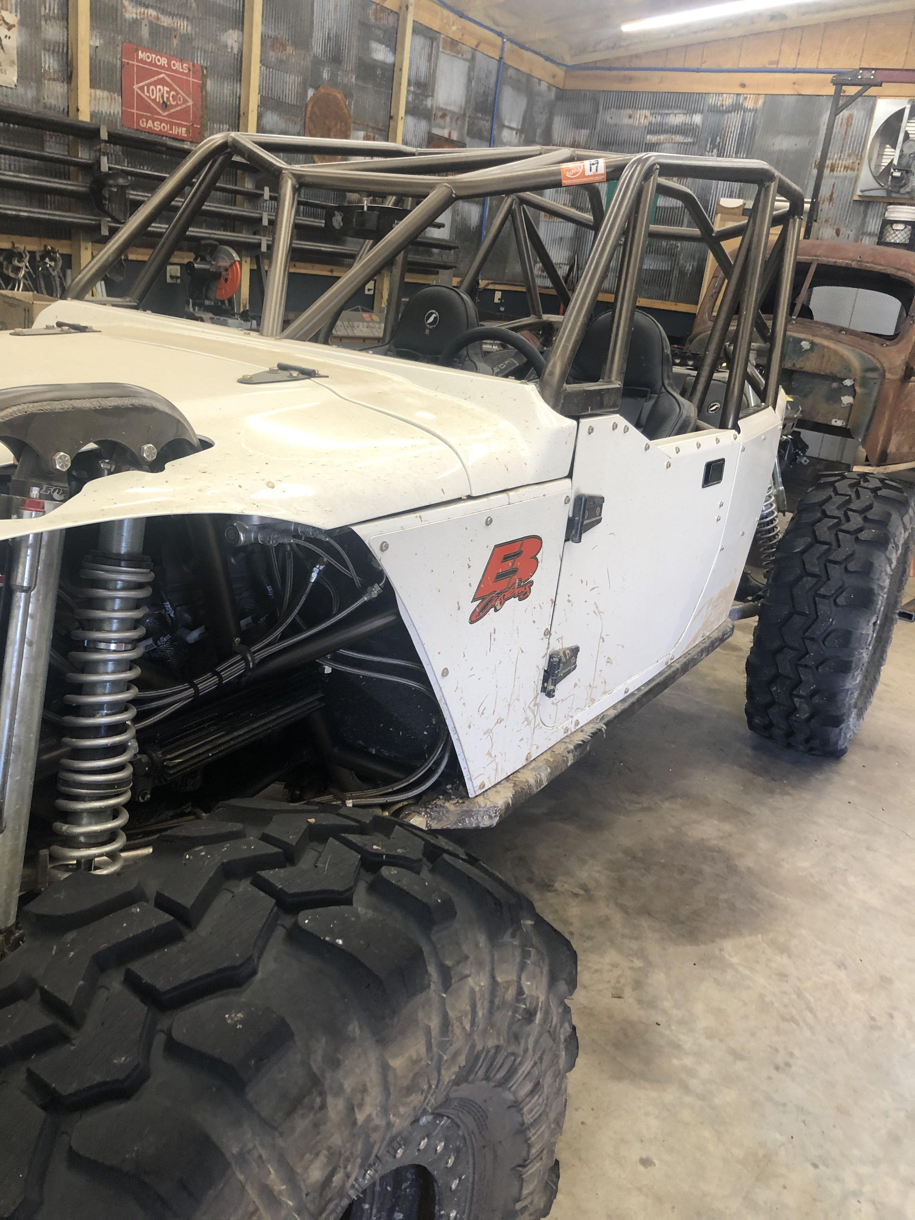

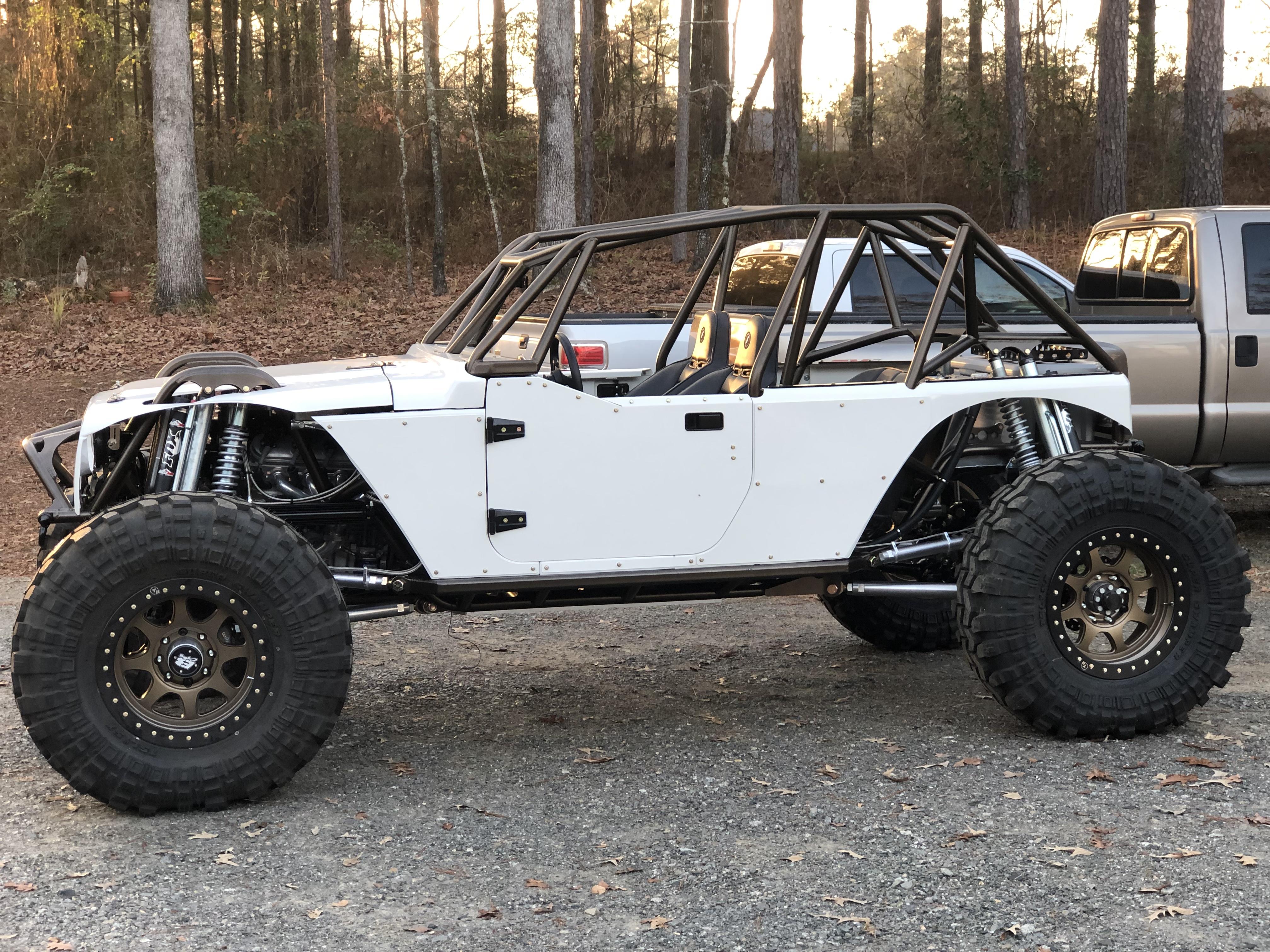

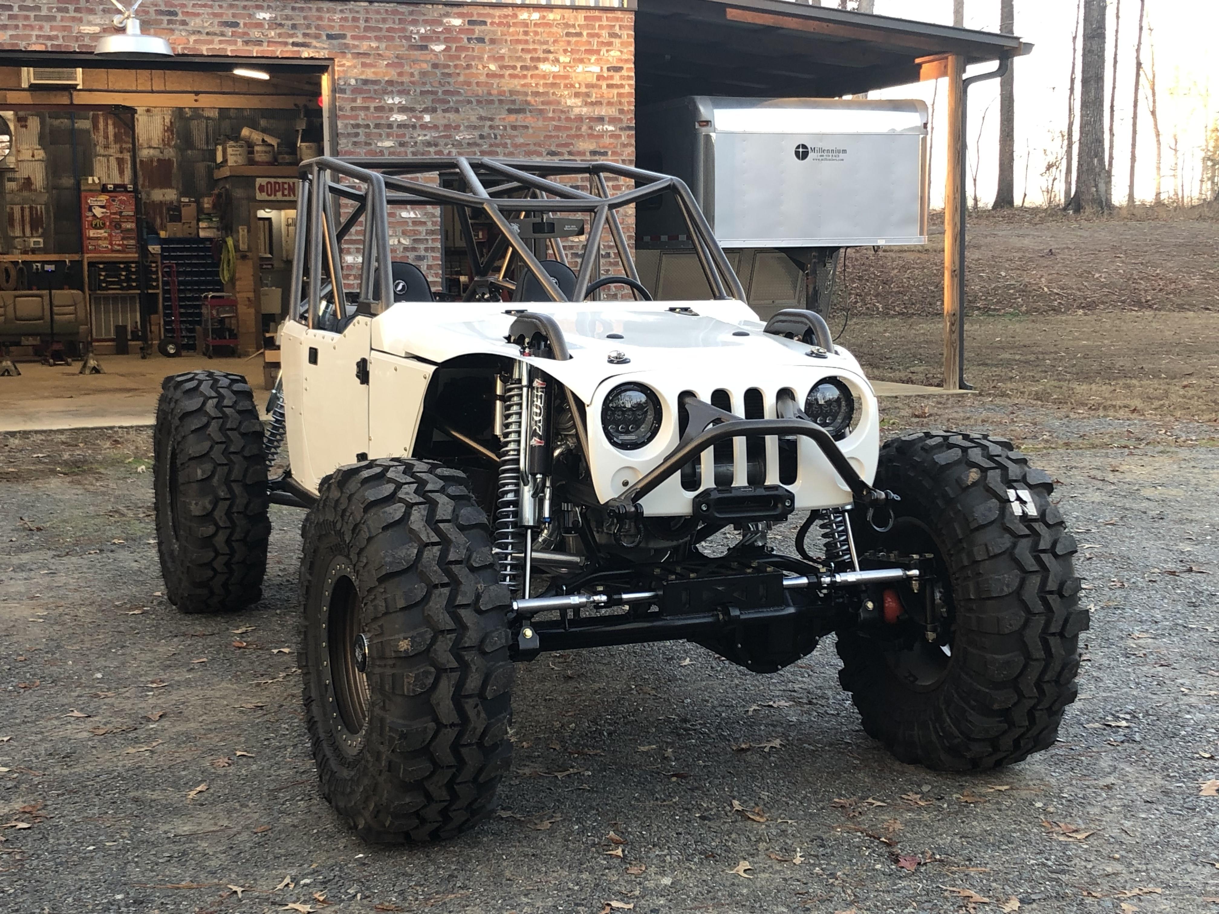

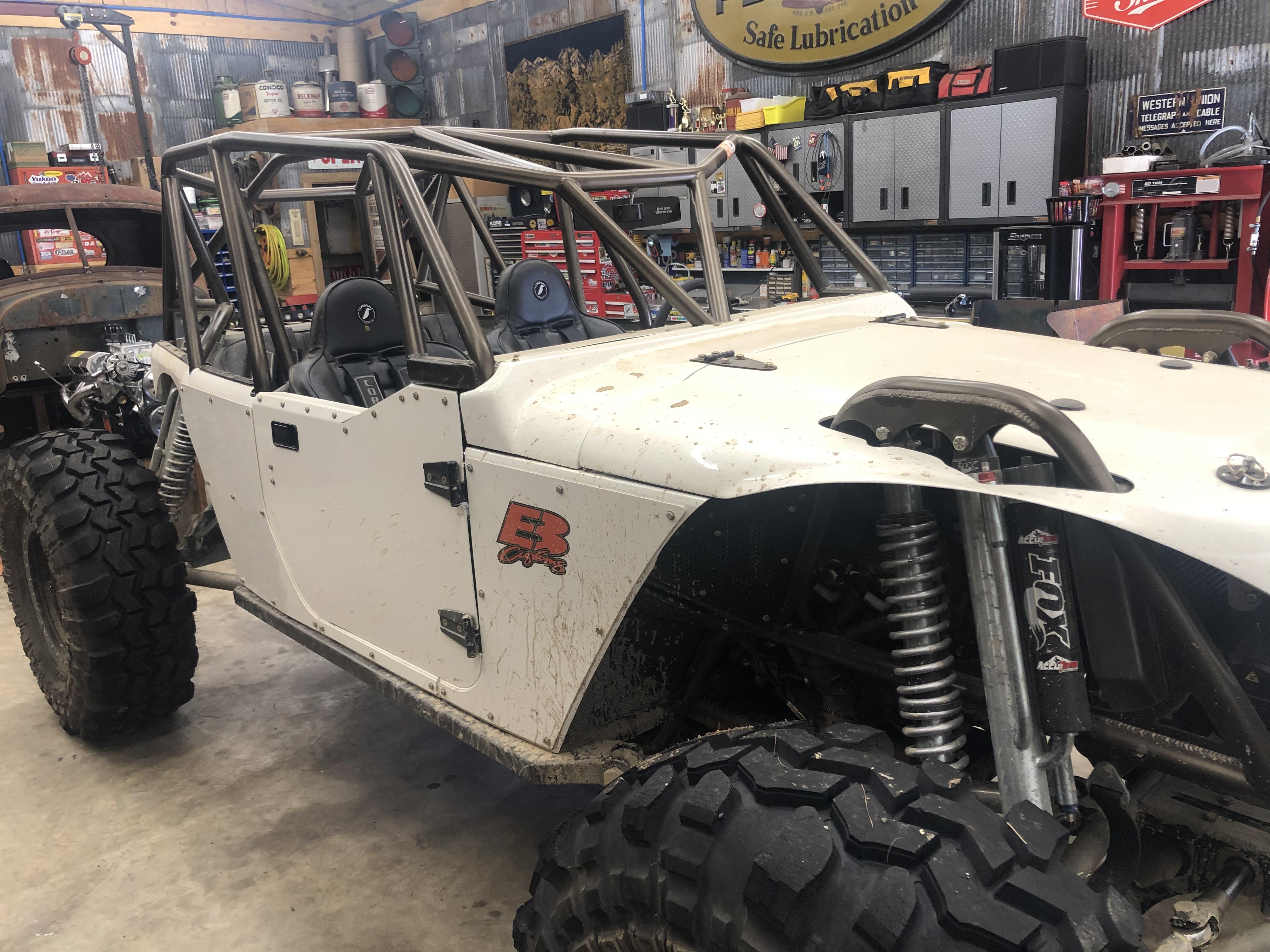

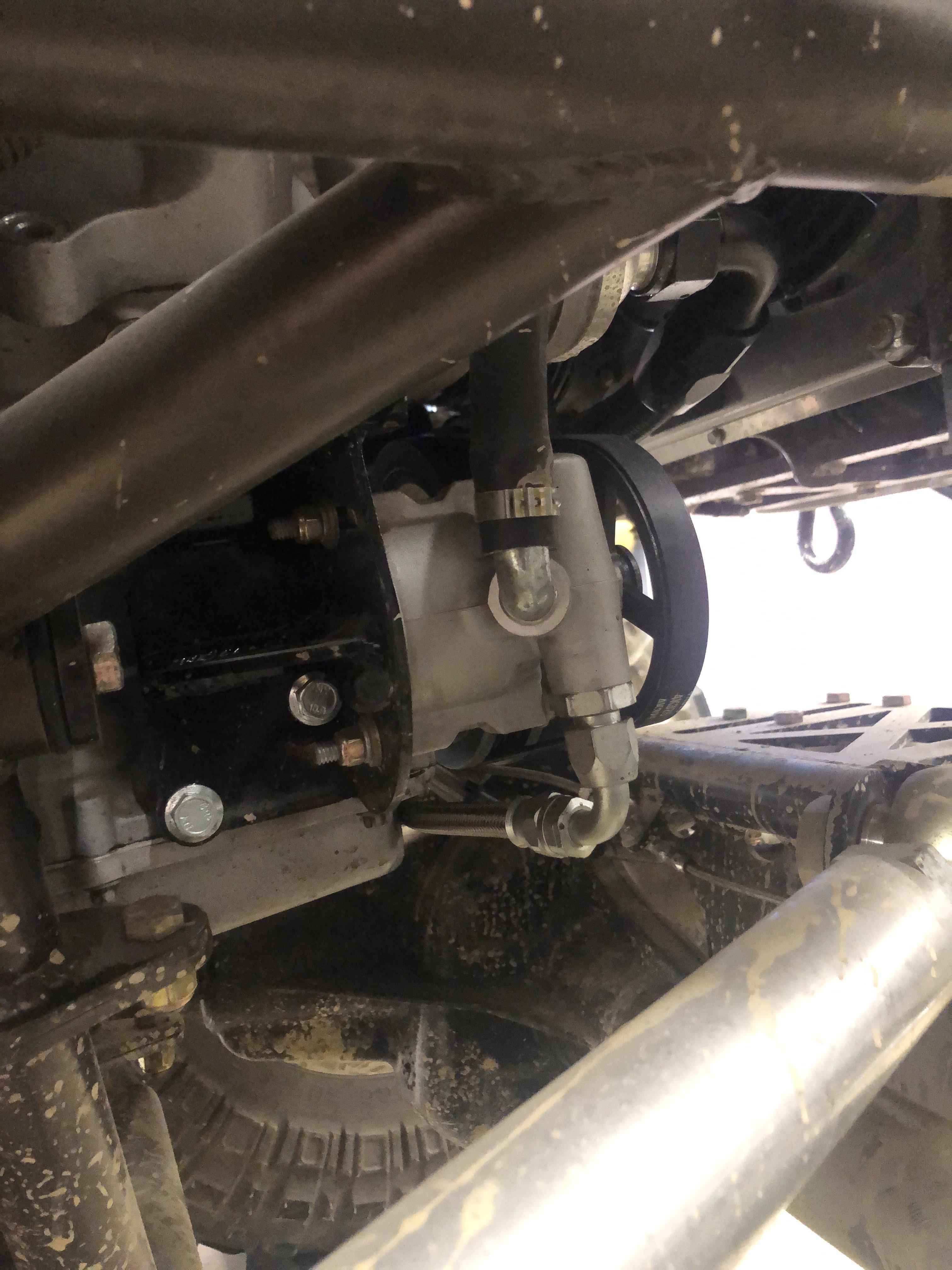

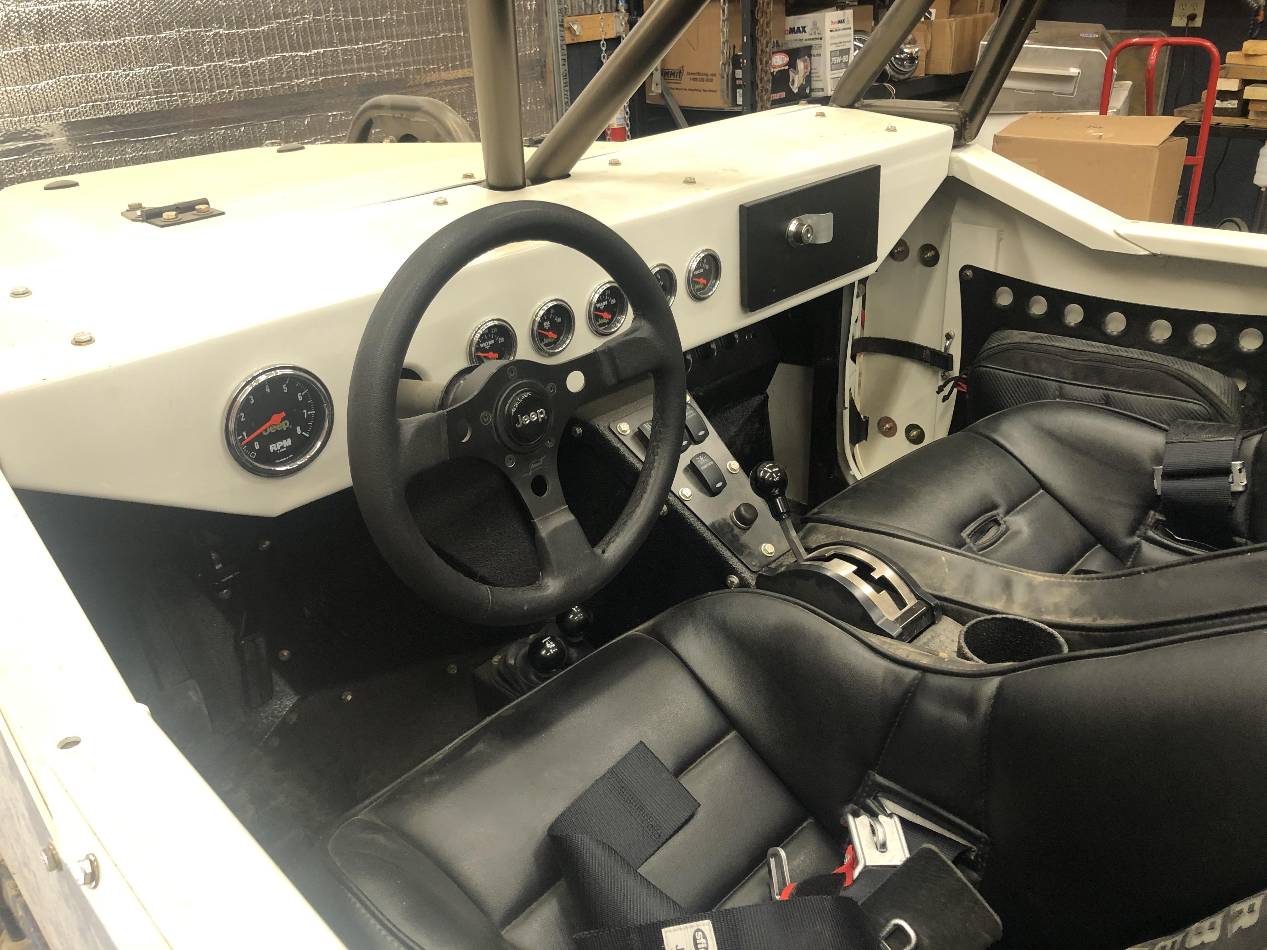

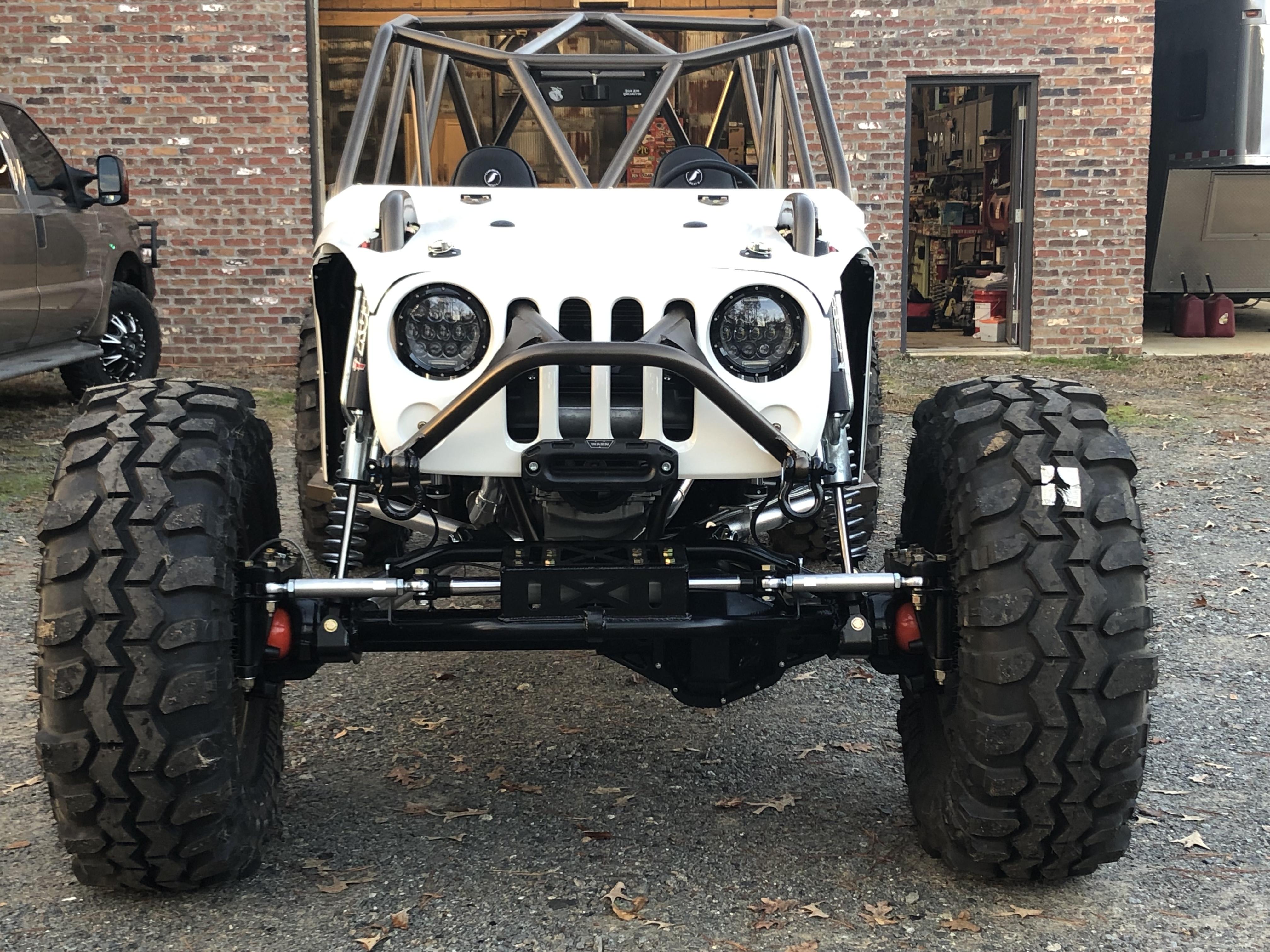

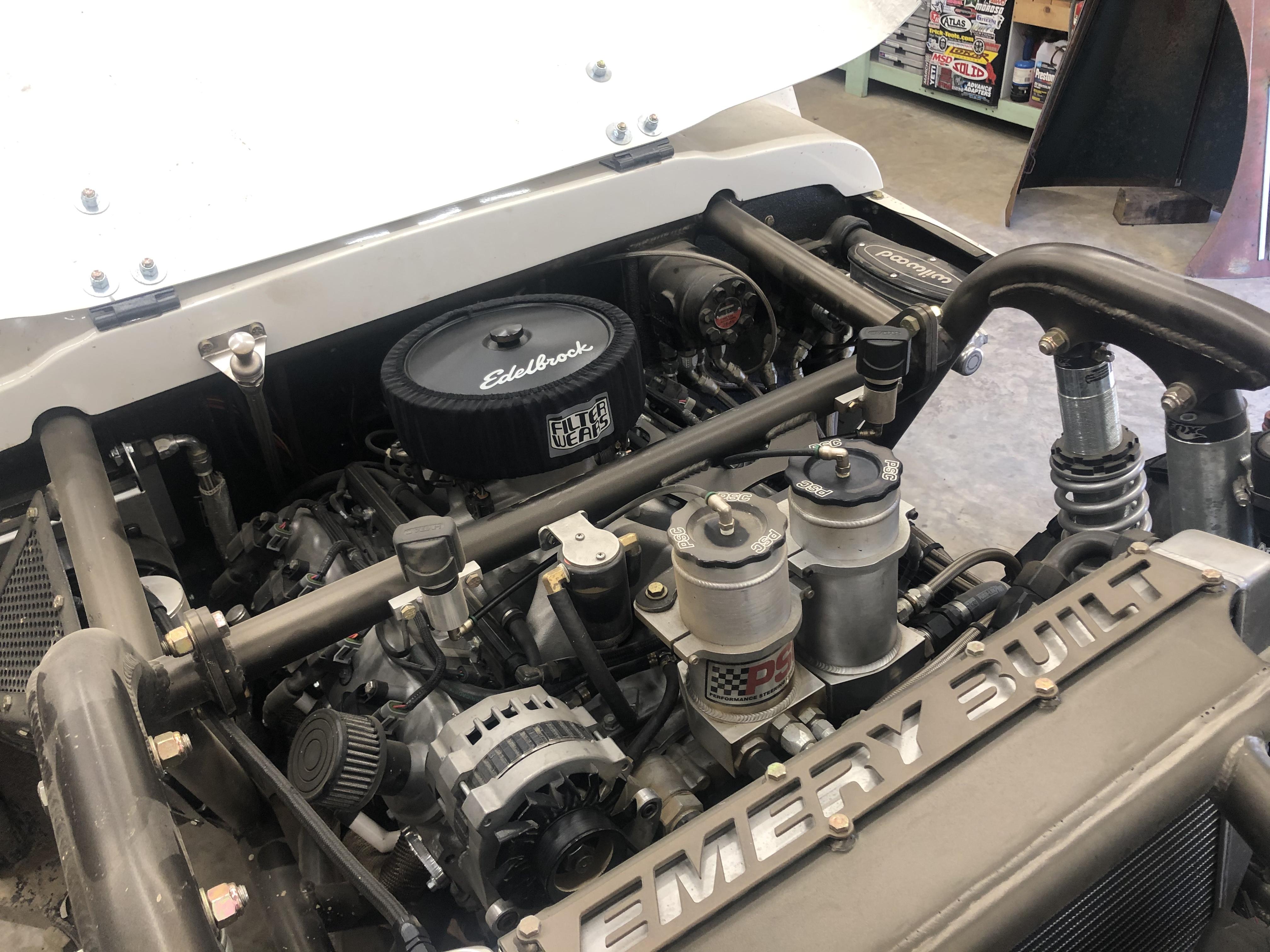

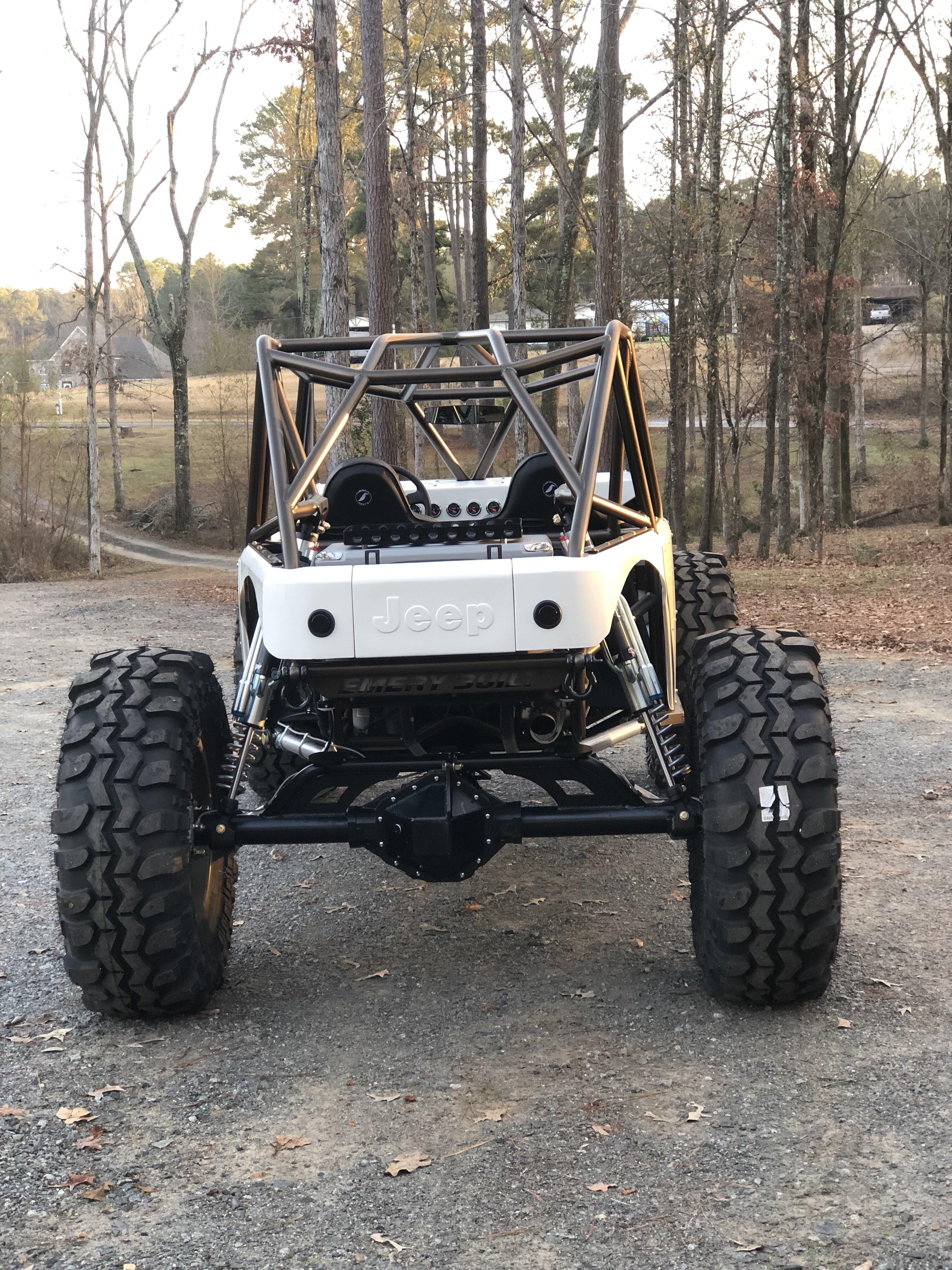

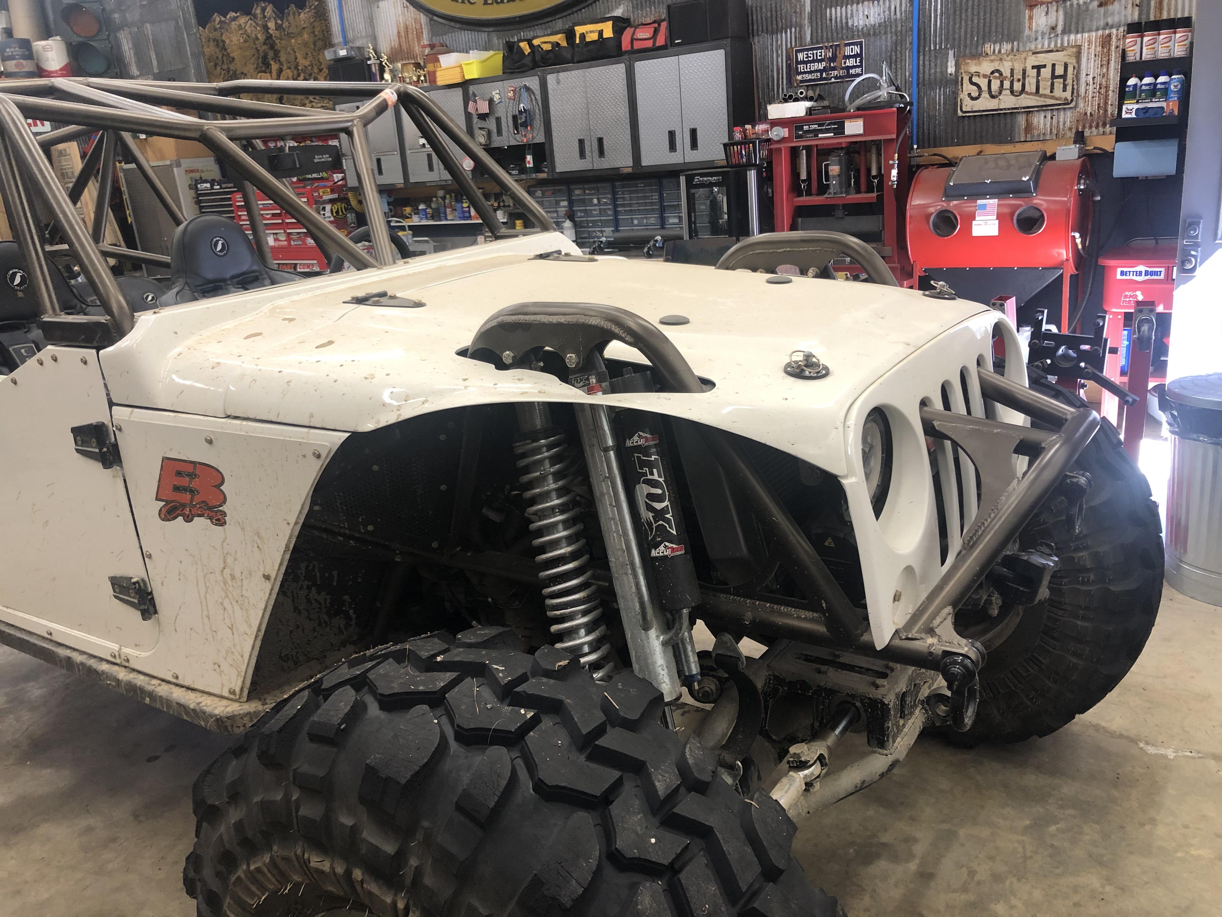

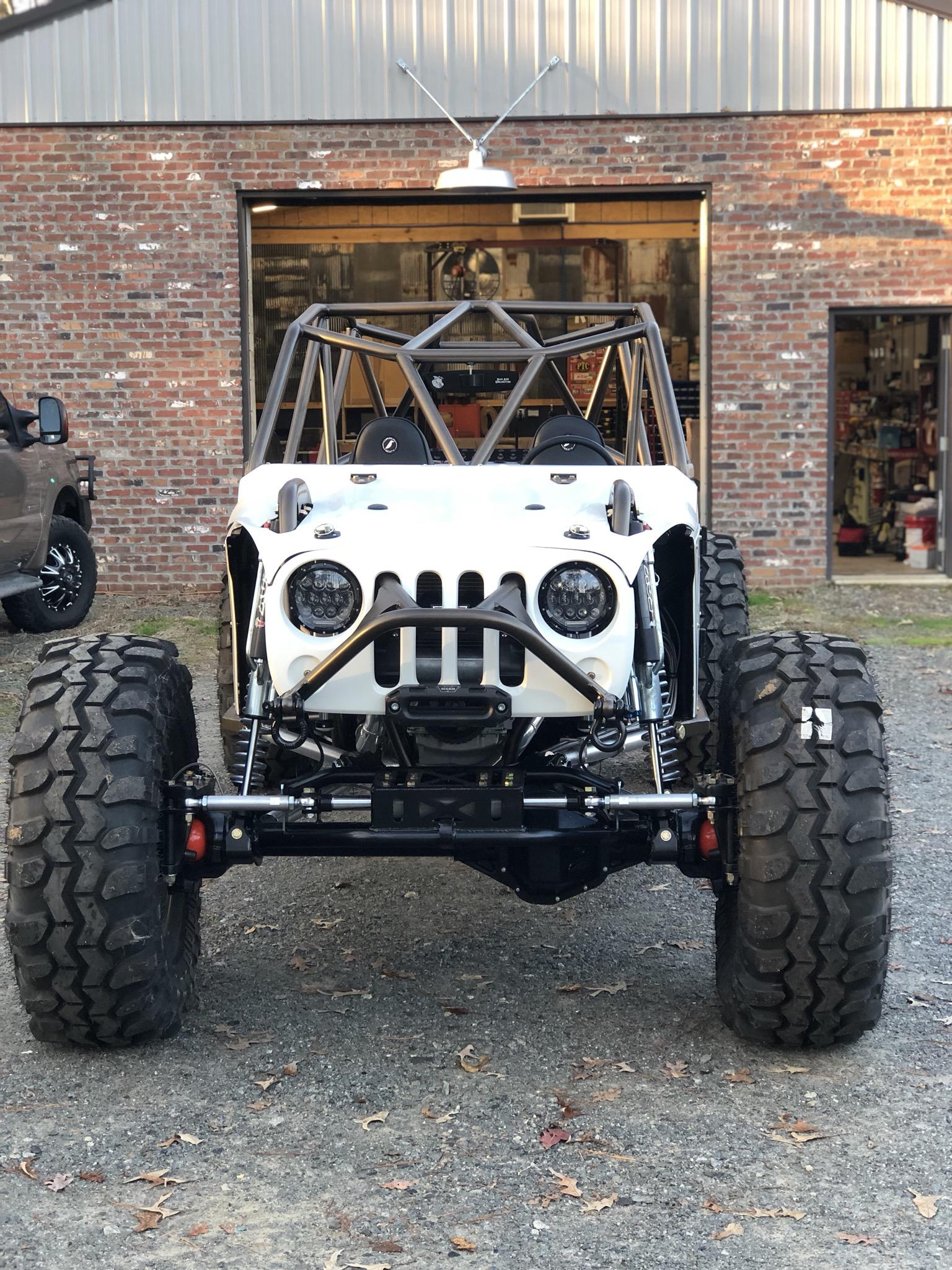

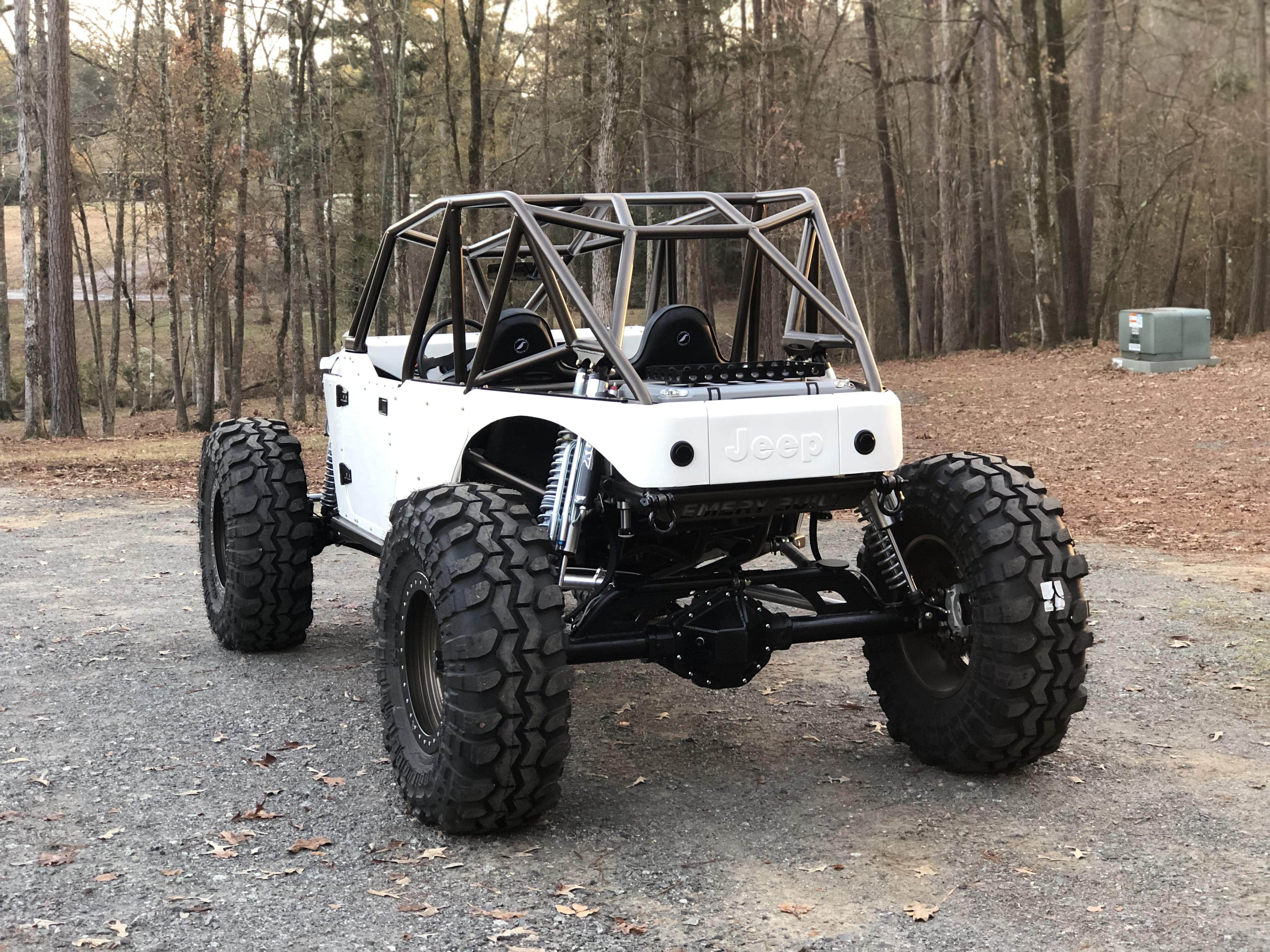

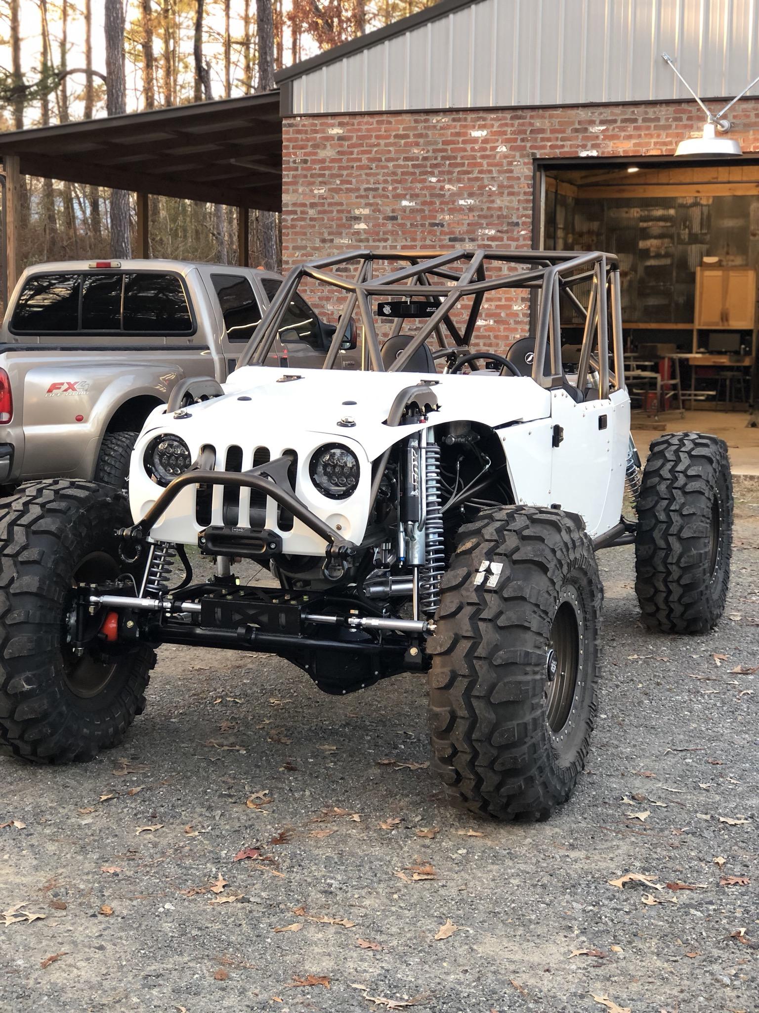

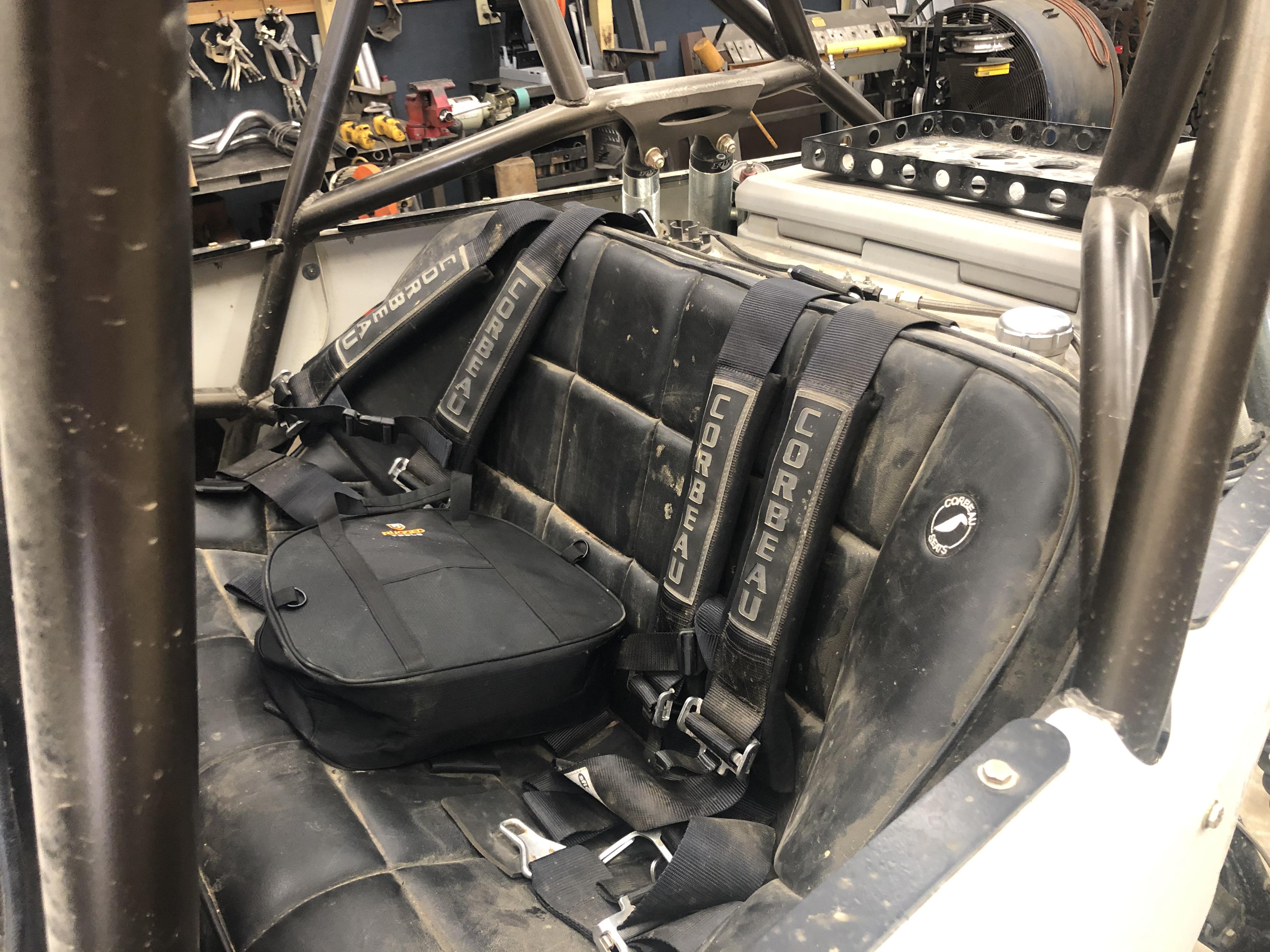

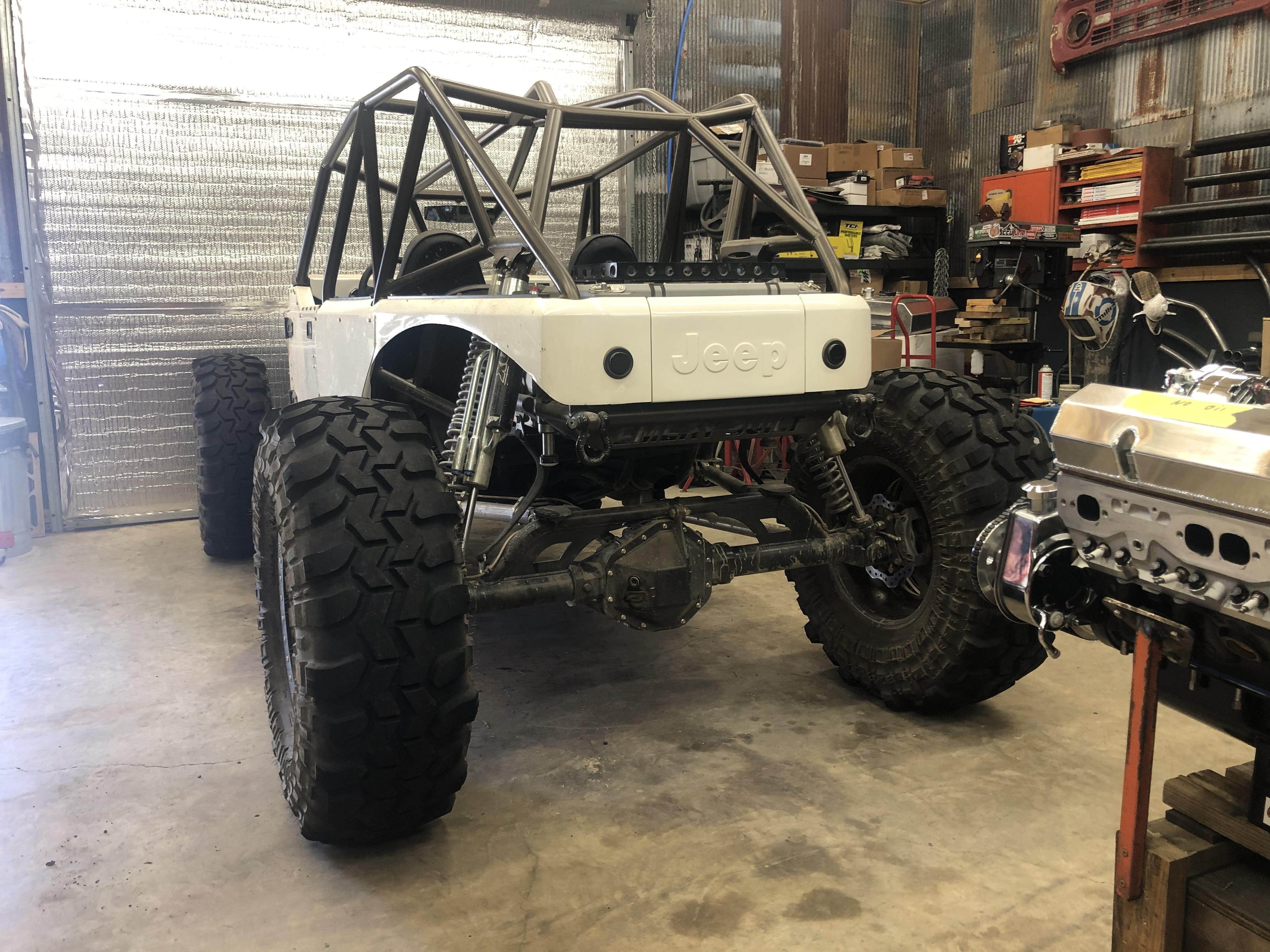

Finally got Photobucket to act right long enough to upload some pics. I did build some aluminum armor and changed some stuff on the chassis since the last update. Basically just trying to finish welding everything up and get it to powder and paint.
A few more random pics.

I got the FiTech Ultimate LS Kit this go round. That’s their composite intake you see in that picture above.

Glad to see any update on this build and hard to believe that's a "Jeep JK".
