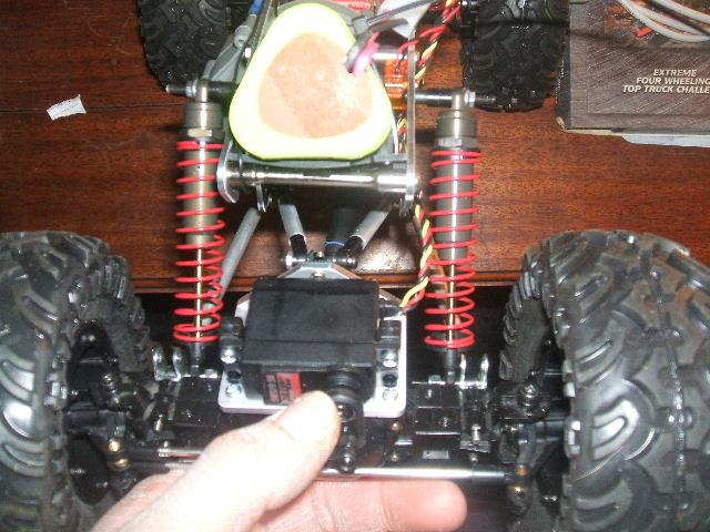

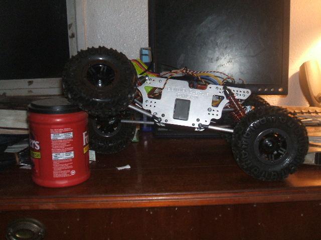

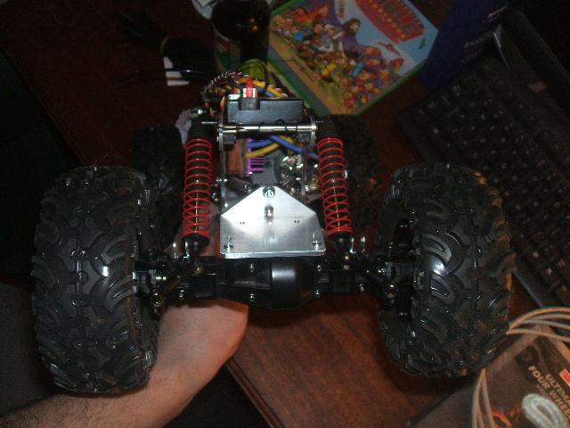

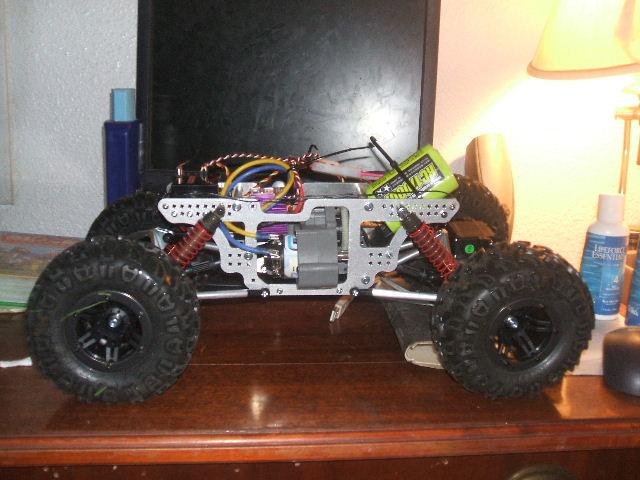

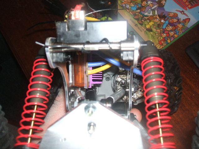

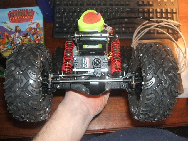

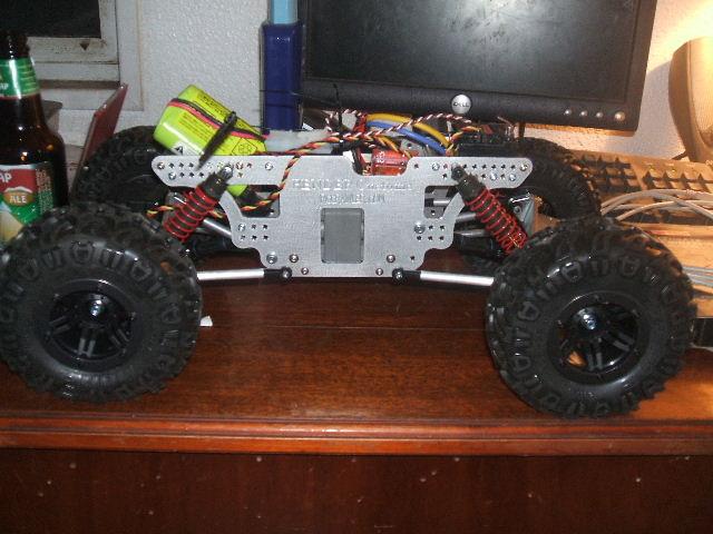

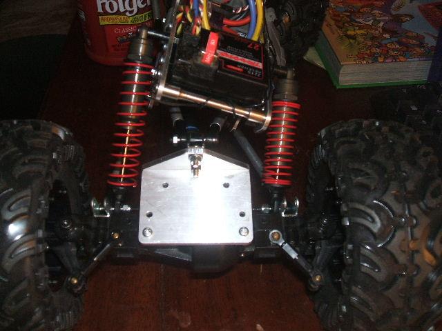

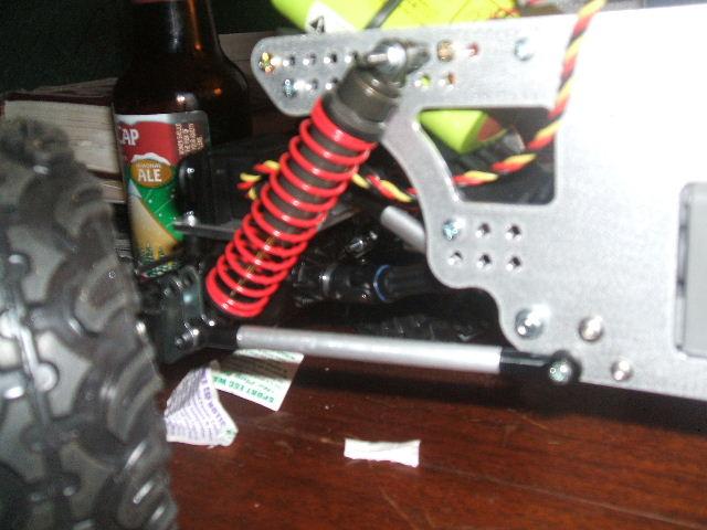

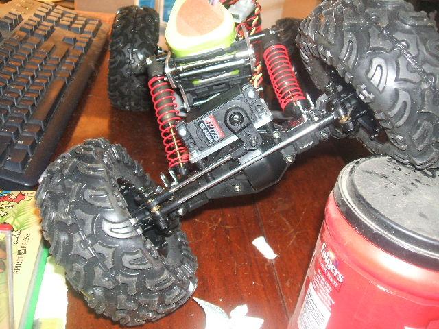

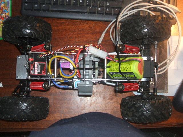

friday evening CRASH helped me get my truck further along, then saturday, our brother in law Jason, helped by giving me the last little bit of all thread that I needed to finish my links, which CRASH made for me< and here aresome pictures of the finished product including the following parts:
SW2 CHASSIS, PEDE TRANNY(fully locked), TLT AXLES(fully locked), NOVAK ROOSTER CRAWLER ESC, TRAXXAS TQ3 TRANSMITTER AND RECIEVER, JATO DRIVESHAFTS, INTEGY 55 TURN LATHE MOTOR, AND 48 PITCH SPUR AND PINIONS( I want to say that we used the 87 tooth spur, and the 14 tooth pinion,)
and so far in the little testing that I have done it seems to have sufficient wheelspeed, and VERY little torque twist with the way that CRASH set the suspension up, I think that it will do just fine at the next comp, if I can go(work sometimes gets in the way)

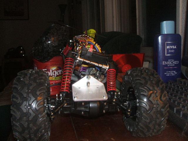

last couple, now I just need to figure out which body to go with, I did like the mini cooper body that I saw at the comp, but am not sure what the rules are about body size and such
