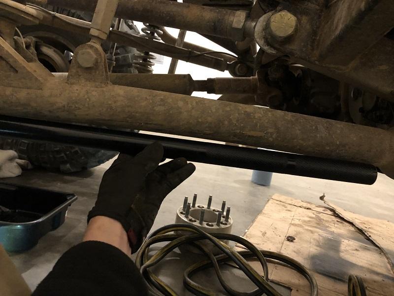

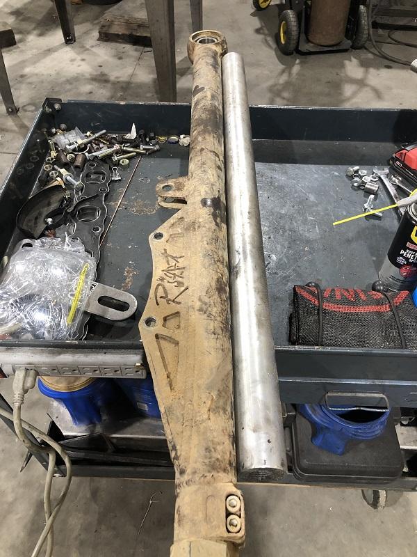

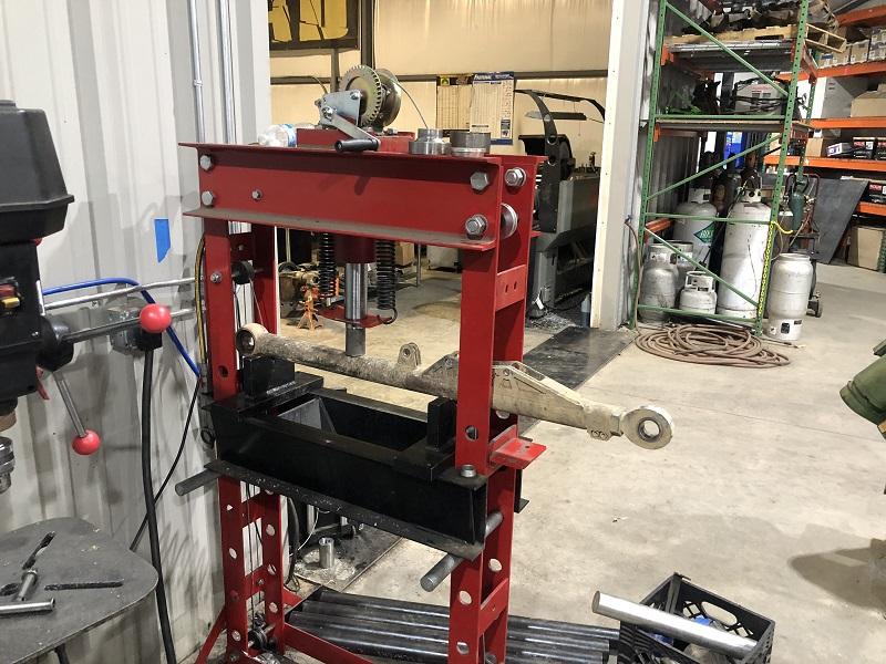

When going over everything after the last ride, I realized my fancy trailing arm weren't real happy...
Turns out I managed to bend both of them, which I think is pretty impressive... They are 2.5x.250 DOM with a full 2" 7075 AL slug inside.
After discussion with Jake, it turns out I welded the shock mounts backwards which left a long unsupported piece of tubing. Oops...
IMG 3910
BKOR let me borrow the big press to try to straighten them back and it took all she had to do so.
IMG 3911
I did as good of a job as I could.
Massive thanks to Jake to let me use his equipment, I couldn't have done it with the stuff I have at home.
IMG 3912

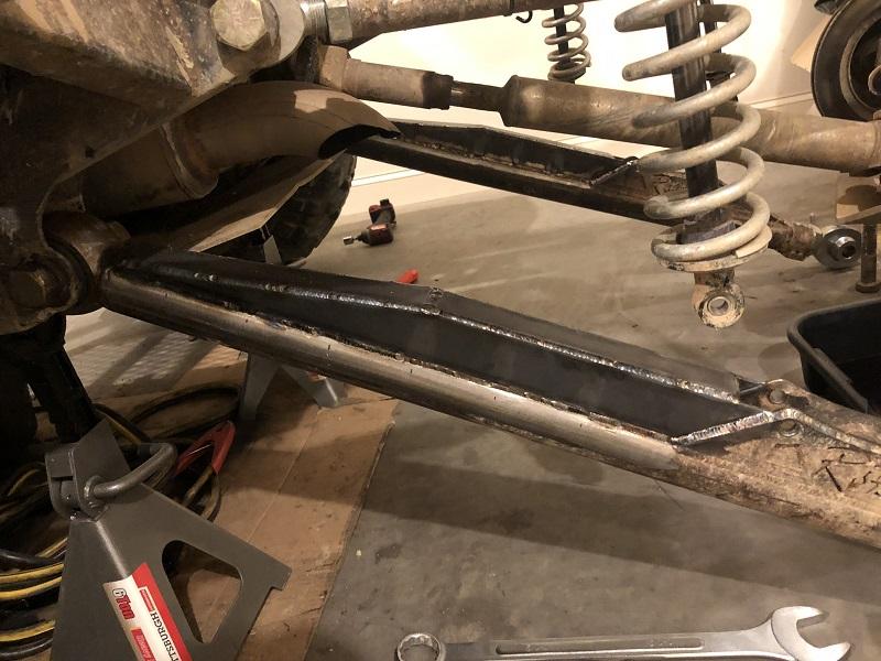

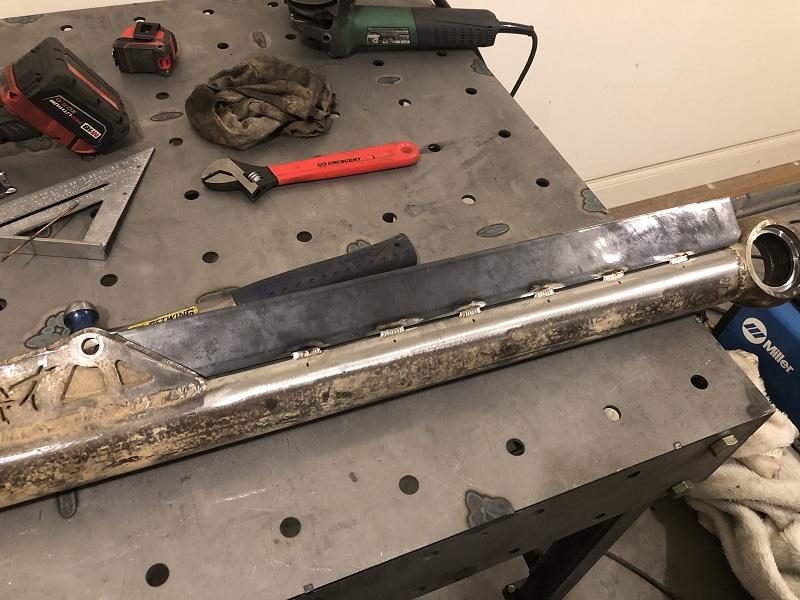

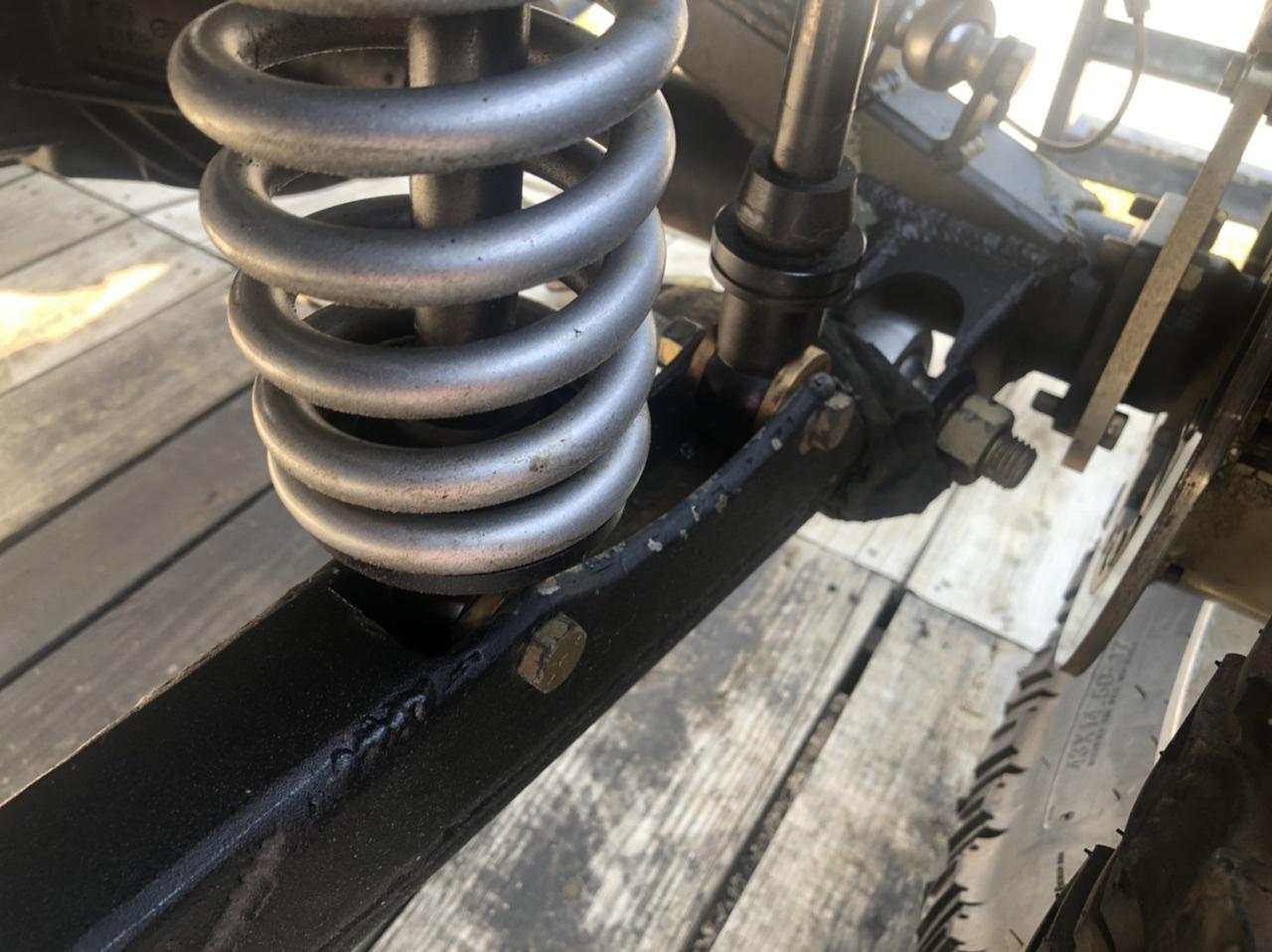

Then I started trussing/boxing so I don't have the same problem again.
IMG 4056

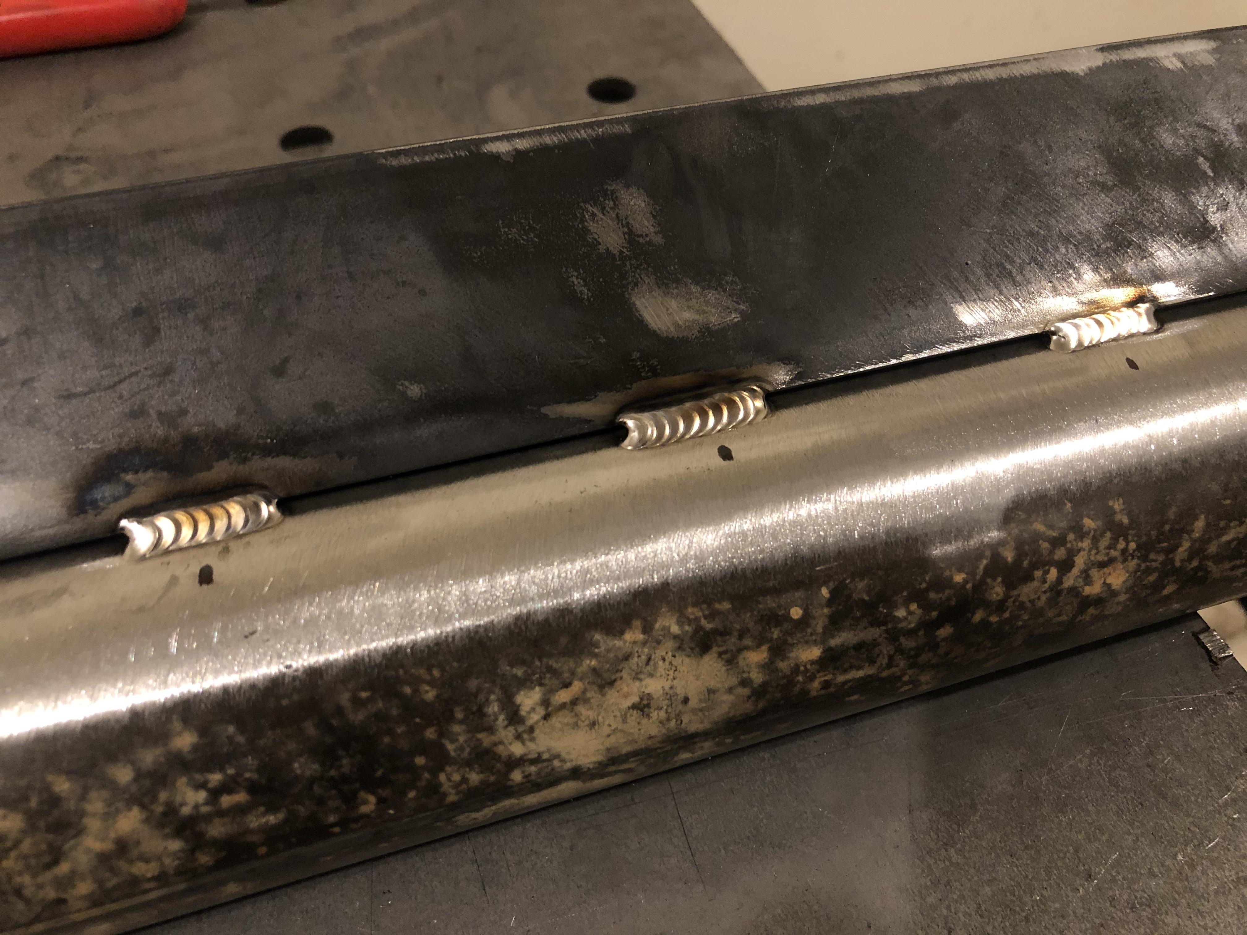

TIG welded everything for the heck of it. Took me wayyyyy too long but I enjoy the process.
Nice weld pic below, I didn't post the crappy ones but they're here :LOL:
IMG 4059

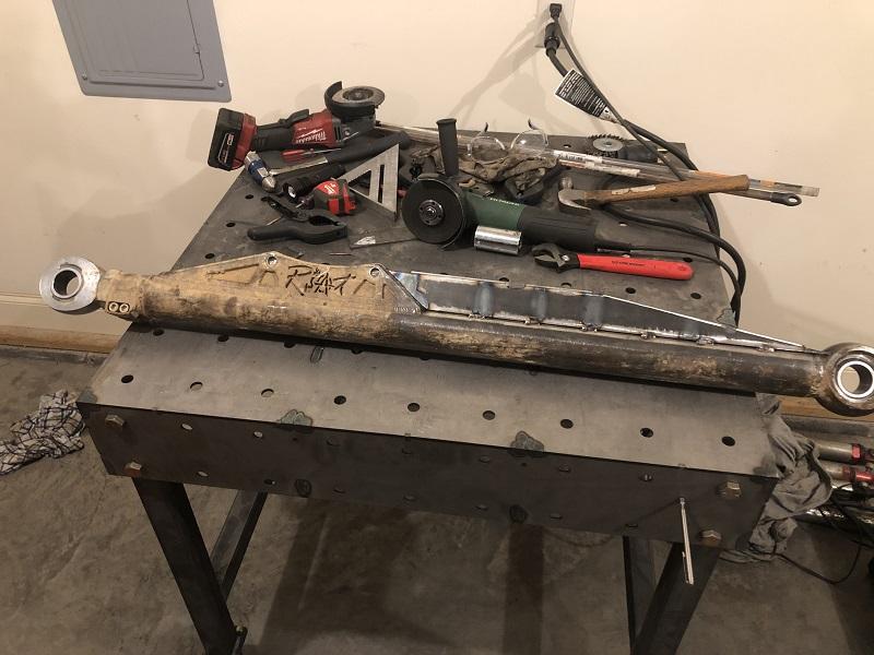

What the arm looks like after reinforcement. You can see the HAZ from the inside welds of the structure.
IMG 4060
Done and installed.
IMG 4172

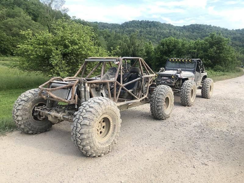

Last week, my buddy Marvin (who owns the Youtube channel Flex, Rocks and Rollovers) hit me up. He was going for a day ride up to Tackett Creek on Saturday and offered me to go with him. Since I wanted an easy test day and just to get back in the woods, this was the perfect opportunity.
Plus Marvin is a great dude and it has been a moment since spending time with him.
He picked me up on the way. Love this Jeepster. I spent some sweat equity on it when it was built and I'm glad to see it kicking ass on the regular.
IMG 4232
And we had a great day out in the woods. So good that I didn't even take my phone out of my pocket all day and didn't take any pics except this one when we were done.
IMG 4238
There will be an episode on his channel I'm sure.

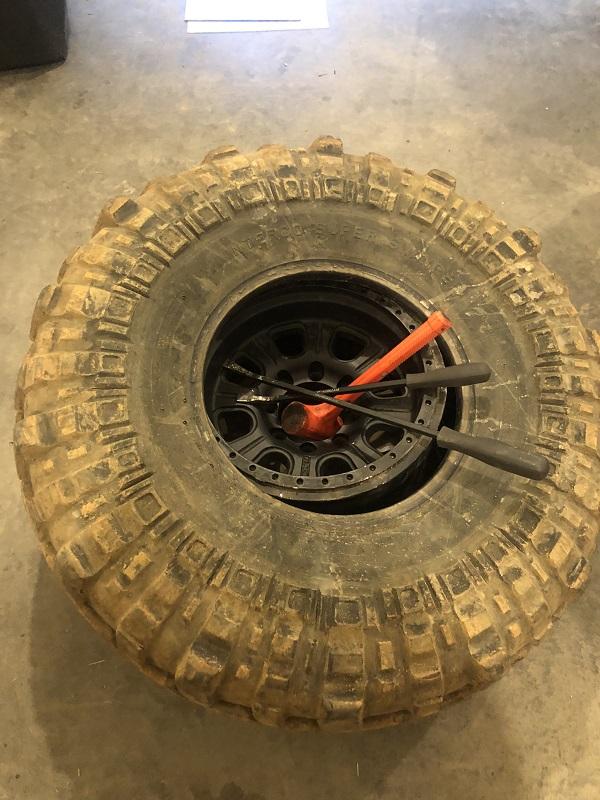

Outside of wheeling, I also managed to locate a good used 43 sticky tire so I could mount it on my extra wheel and finally have a spare.
A million thanks to Lori for it !

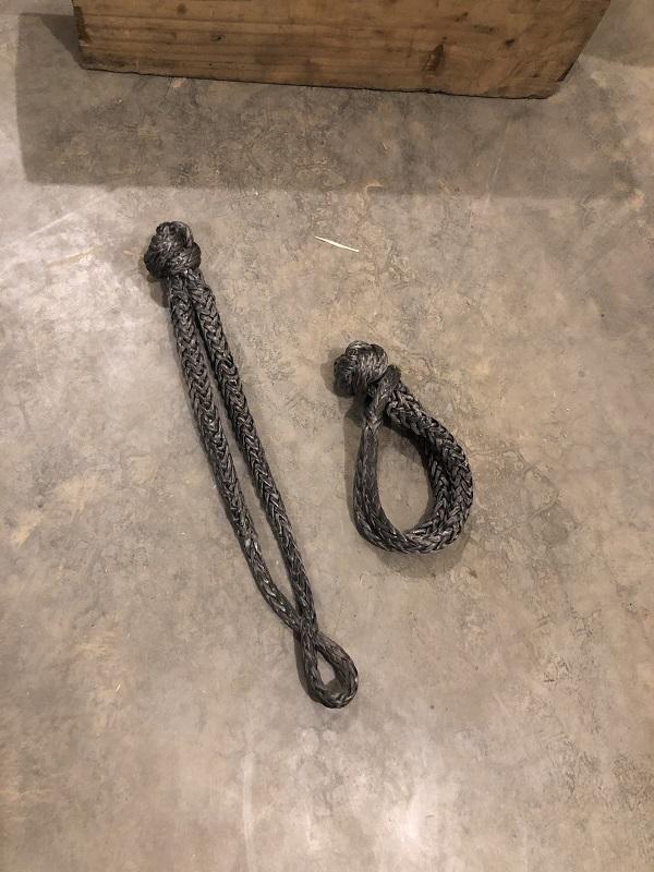

And made some more soft shackles, it's a good time burner and a very useful thing to have.
IMG 3865

Unfortunately, bending trailing arms with your previous shock mount design is all too common. Even with the slugged aluminum it's just not enough for the added stress. It wouldn't have mattered which way you had that mount set up.
Running a full length "back bone" is a must IMO. Glad to see that it was an easy fix.
Thanks Chris, I'm glad I was able to bring them back and fix them.
For the next ones I'll look into HT 4130 material and definitely have a back bone from the start.
I'm also not a huge fan of the TMR wobble stoppers that are cureently on my arms and would go back to regular heims on the chassis side and use some shock eye spacers as a wobble control method..
Jason's rig was done as such and I liked the bronze bushings he had made.

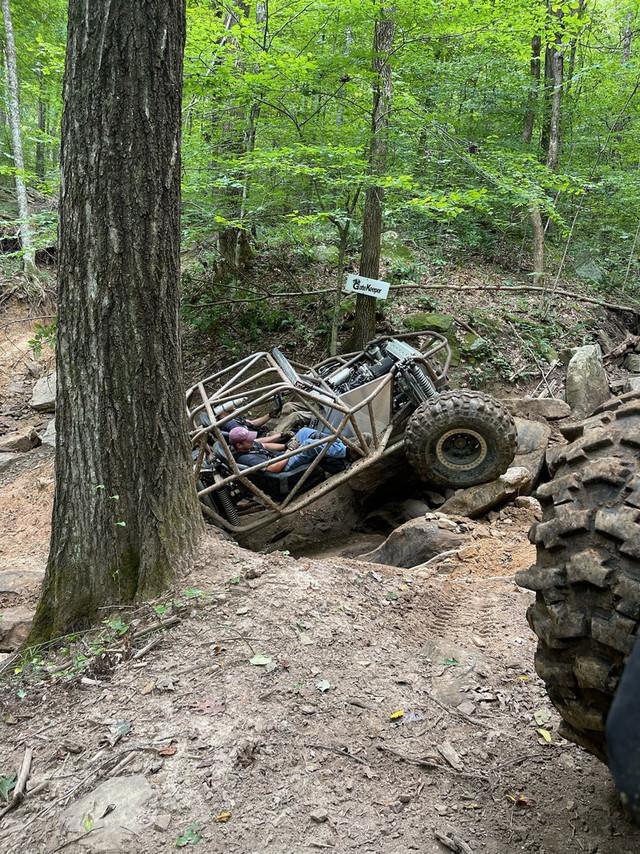

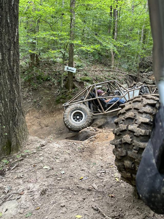

We ended up on gatekeeper and what ever the top half is called at dark sunday night when it started raining. That **** got real slick real quick, but 30mins of ray rowing reverse to neutral drop we made it to the top..only to miss the exit and end up stuck on that big tree laying across the right side. :driving:
Ohhhh yeah, Mouthwash is the upper portion. It's probably my favorite trail in the park.
I got lucky on gatekeeper and we hit it when it was dry. If it's wet you better have the line picked from the bottom and never stop.
Mouthwash is a good one. Gatekeeper puts mine in a bind that i'm just not willing to do.
You had the line. A couple inches to the left and it was butter.
Next time I'll be all wadded up and you'll walk it like it's nothing.
This sport is stupid :LOL:
