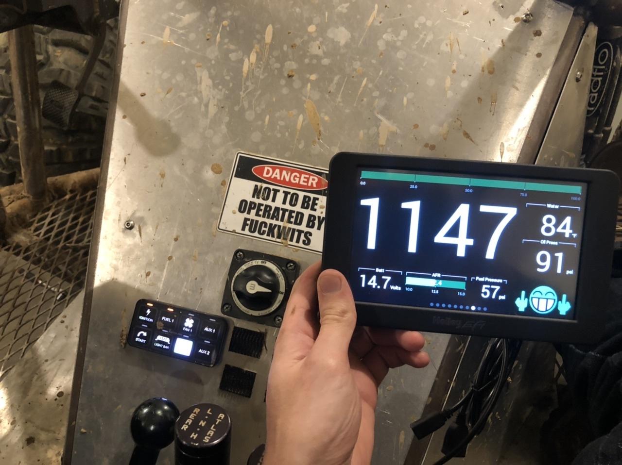

How have these displays been holding up to the weather and cleaning? About to start a motorcycle build with Holley injection and would rather have all the gauges on one of those.
Bebop
Jan 27, 2013
1,640
Mine is brand new so I don't really know.
I know of 1 person that killed his, but at the same time I know of a ton of racers that had good luck with it. I would totally trust it for a motorcycle. Just remember its big.

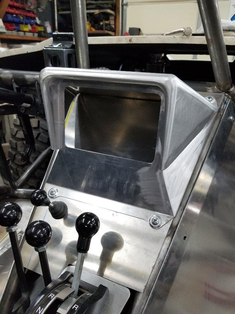

I plan to make a mount that has a removable piece of lexan in front of it, with an O-Ring in order to protect it from the bulk of the crap flying around and the pressure washing.
Zjman
Oct 22, 2014
1,981
For a cheap bling dash ya can get a used or refurbished surface tablet and download the Holley software and get can to usb cable and have a bling dash. Plus ya can tune with it. I have one so I may run it when it’s dry out
Bebop
Jan 27, 2013
1,640
Yep, I think @RustyC had a nice thread going here at some point.
This dash let's me do more stuff than just display data, it also is an external datalogger, has GPS speed, adds 10 programmable I/Os to the ECU via CANBus, let's you use virtual switches and it doesn't require any external wiring, which is nice.
Getting the tablet mwthod to look nice or seal properly will be tough IMO.
I also bought this dash on black friday which made it more reasonable.
I'm definitely not @mcutler but this is what I envision :
