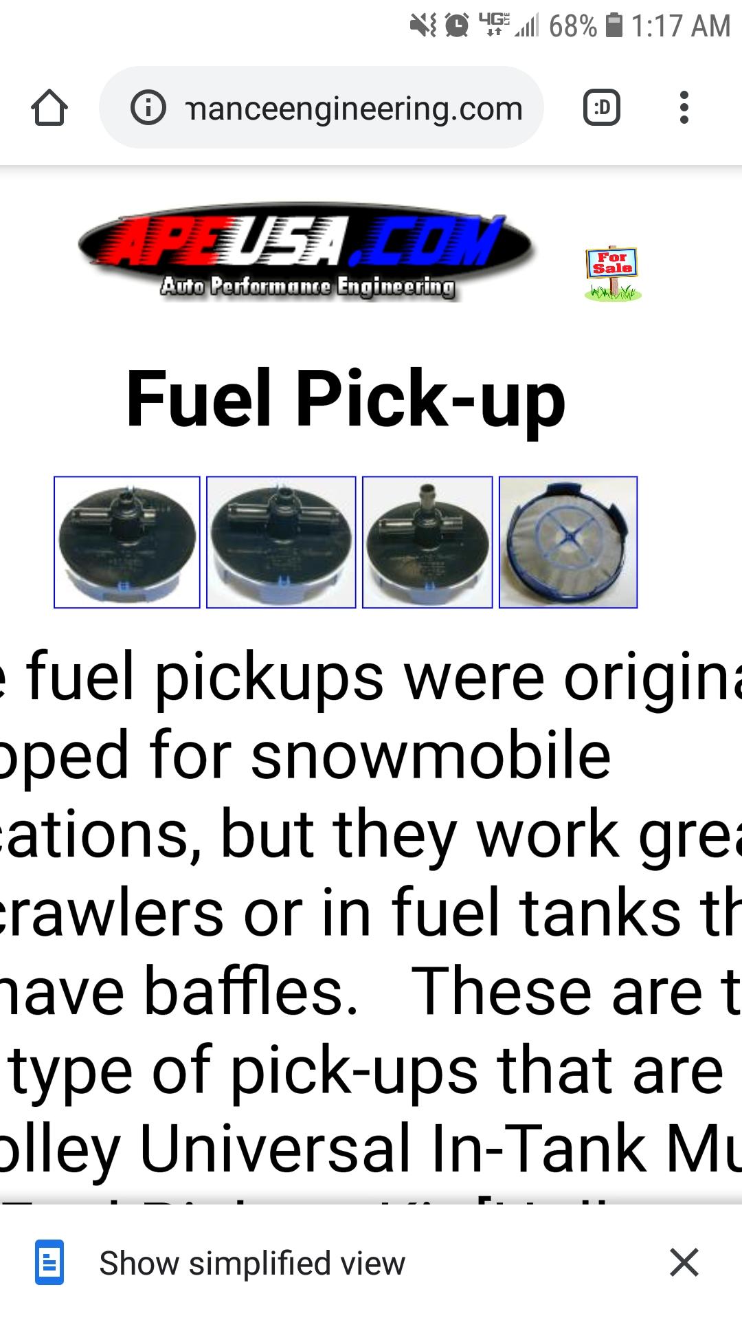

I had a tank like yours. I put a bulkhead fitting in the bottom. Connected it to steel line on the inside of the tank and then ran the line to the middle of the tank. I then put a t in and ran steel line to each side of the tank. I connected the ends to a fuel pick up on each side. This seemed to work pretty good. See the attached picture for the type of pickup I used.
Another vote for the hydramat. If you've never seen it, look up demonstrations on the youtubes. Pretty slick for sure.
