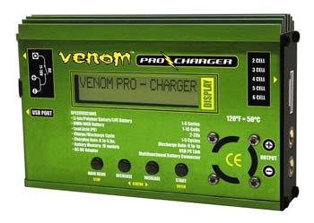

Is this the charger you have??
Are you sure you have it set for Lithium Polymer and NOT Lithium Ion??
That Lipo you have should charge up in about a hour or so maybe a little more. 7.4 2000 battery should be charged at 2 amps max.
