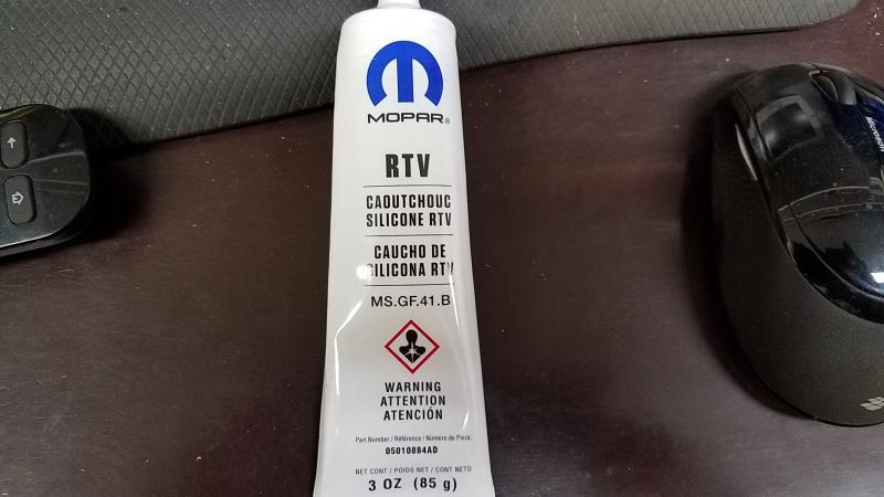

So here is what I plan on using. This is sealer designed for tranny pans used on the late model 6.7 cummins..
