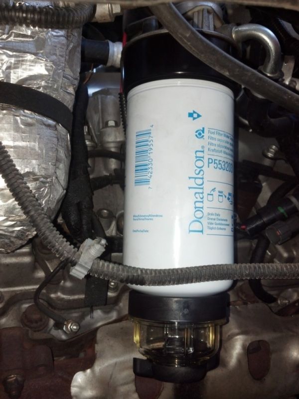

A great idea. Better filtering and cheaper filters. What's not the love? But unless you have a lift pump, don't run the Cat filter, as it doesn't stop water. Instead, use this Donaldson filter. Make sure you buy the Nicktane adapter. Many of the others have had problems.
http://nicktane.com/osc/
