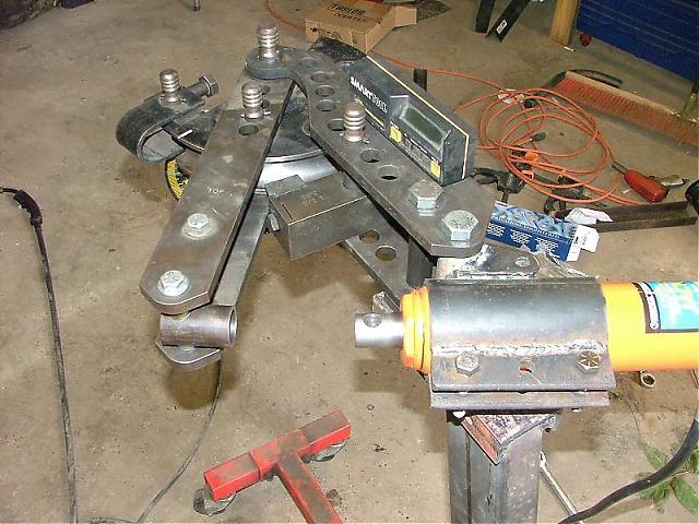

I copied this design, works good and is moveable around the shop. IIRC 3" sch 40 pipe is a very tight fit over the HF style ram. A set of casters are also in the future for easy movement around the shop.
FYI, if you use this style, make sure the ram is far enough back for the two arms to close.
