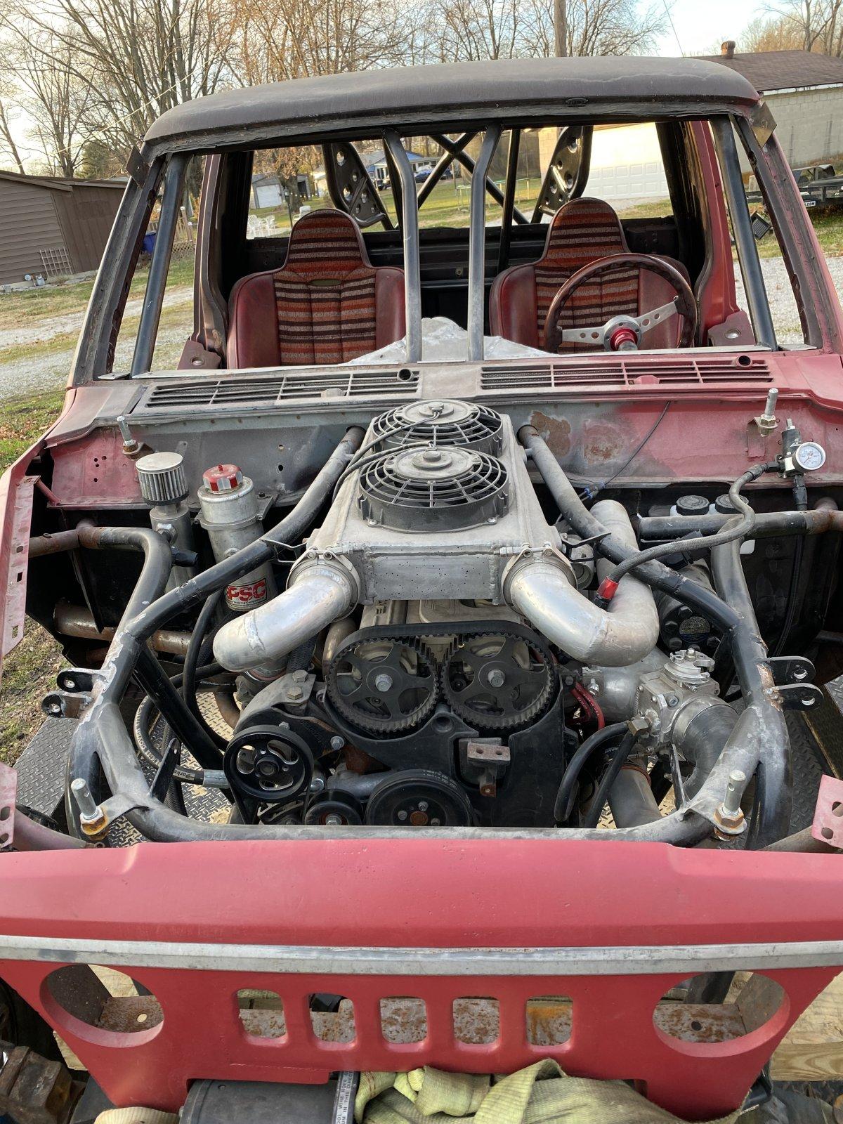

Here's some more pictures after I got it home and started going over it better to make a list of what all needed to be done.
Lots of welding to finish, come up with some different front lower link mounts, different ram mount, something different with the hood/engine cage, coilover mounte, wiring, plumbing etc..

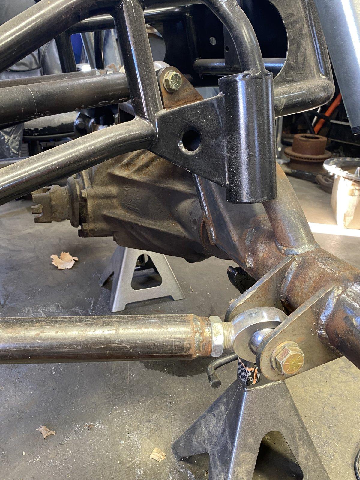

I figured I would just start in the back and work my way forward. I went ahead and welded out the link tabs on the rear axle.

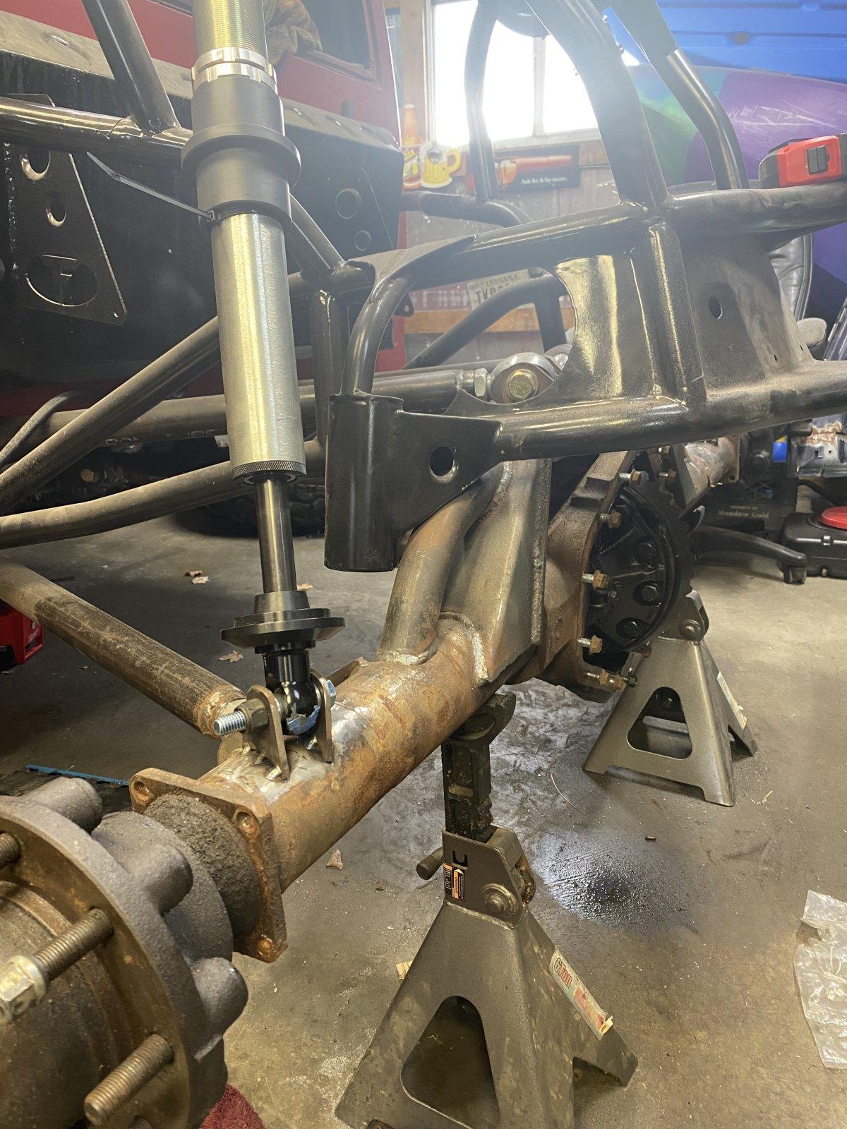

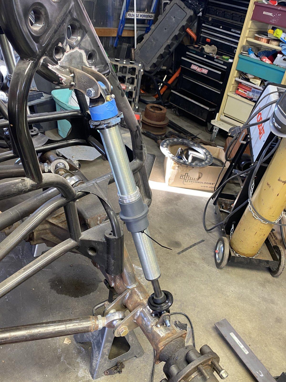

Next I had a few days off for Covid and made some tabs and mounted the coilovers after finishing the honeydo's around the house. After going through a couple boxes that came with the truck, I found the exact tabs I made in the bottom of one .
One of the previous owners added these tubes to the truss so I couldn't fully collapse the shock. I don't think they're needed so I'm going to cut them off and should be able to have the shock fully collapsed. I'll build some pads for bump stop later. They're still on the list to buy.

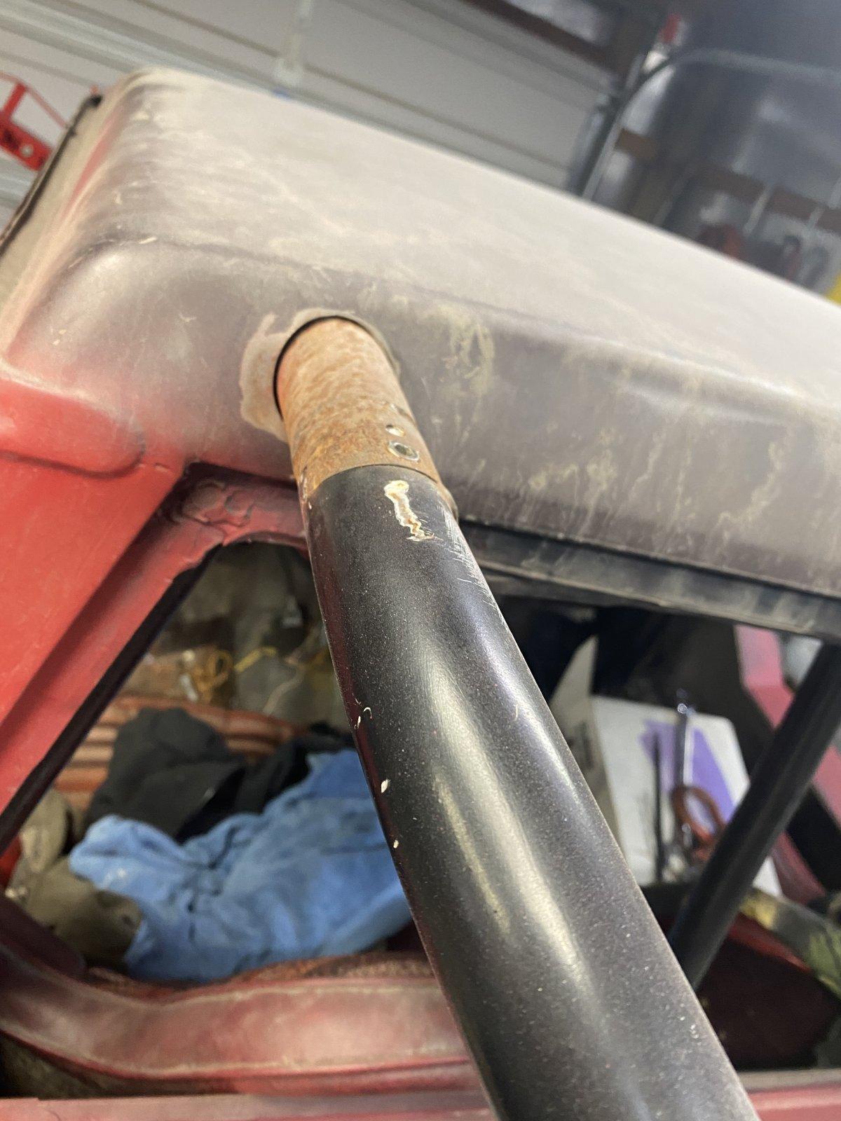

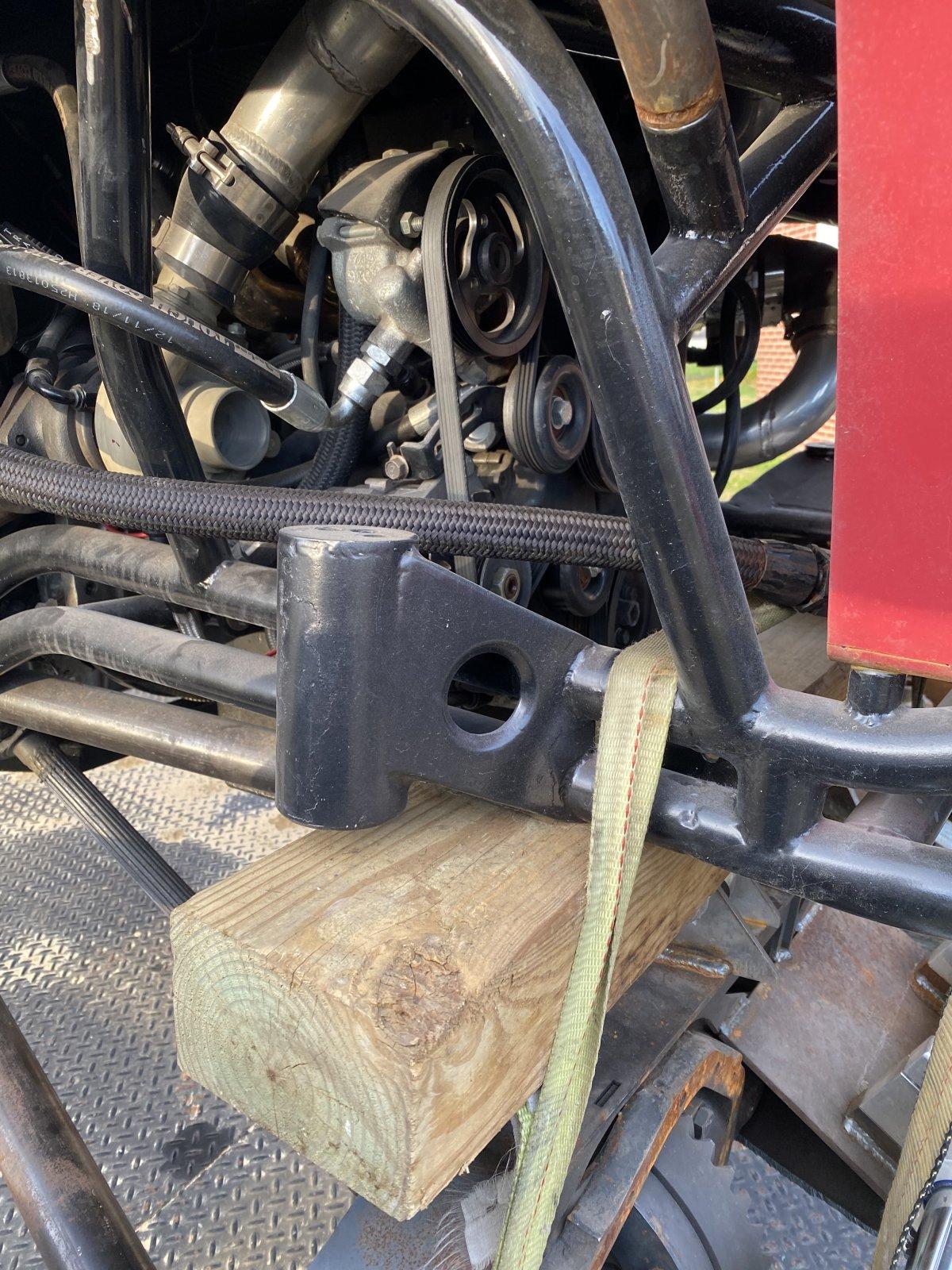

The chassis has these bungs everywhere so that you can remove the cab easily. It was a cool idea originally I think, but I have a feeling once this thing starts getting beat on it would never go back together if you took it apart. Right now I plan to just weld them all up. What do you guys think?
those engineered connections are great as long as everything is perfect. I have used them in a couple of locations and you are correct in that once the chassis or part gets tweeked then they require a ton of work to remove and reinstall. I say weld them up.
X2. I doubt you will remove the cab that often, once the build is finished. If you need to, cut the tube, and then slug it when you put it back together. If you put bracing in the other 2 directions on each side of that joint, it might help it stay aligned longer, but you will likely add a ton more tubing, if its possible at all.
