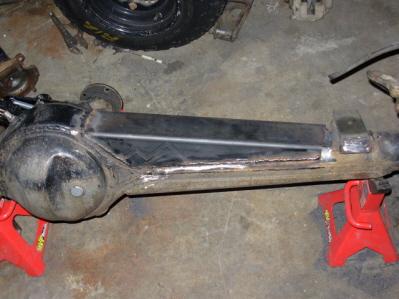

lil yota is getting new legs
got the axle trussed:clappy:

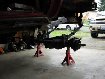

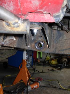

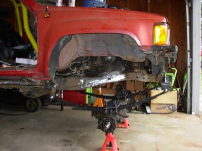

6 hours and an 18 pac. still need to finish weld the front hanger but wanted to check the shackle angle fisrt and it turned out perfect and moved it foward 3/4 of an inch
the shackle hanger were a biotch cause the frame was full of Arizona dirt wich turns into concrete when it is heated, I had to find out the hard but finnaly made it through:clappy:
Nice! So you just jigged the frame for the rear shackle hanger, but moved the spring mount forward to get the angle you wanted, correct? Getting closer!

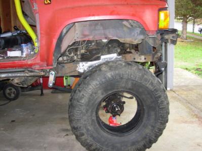

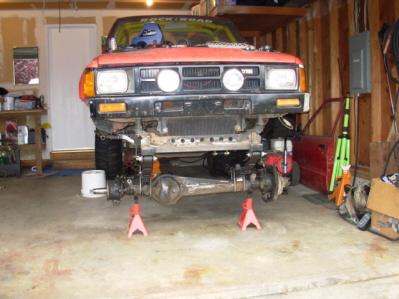

got the axle hung and sized up the tire
~T.J.
yup pretty simple, i was suprised out how easy this swap was, should have done it a long time ago
