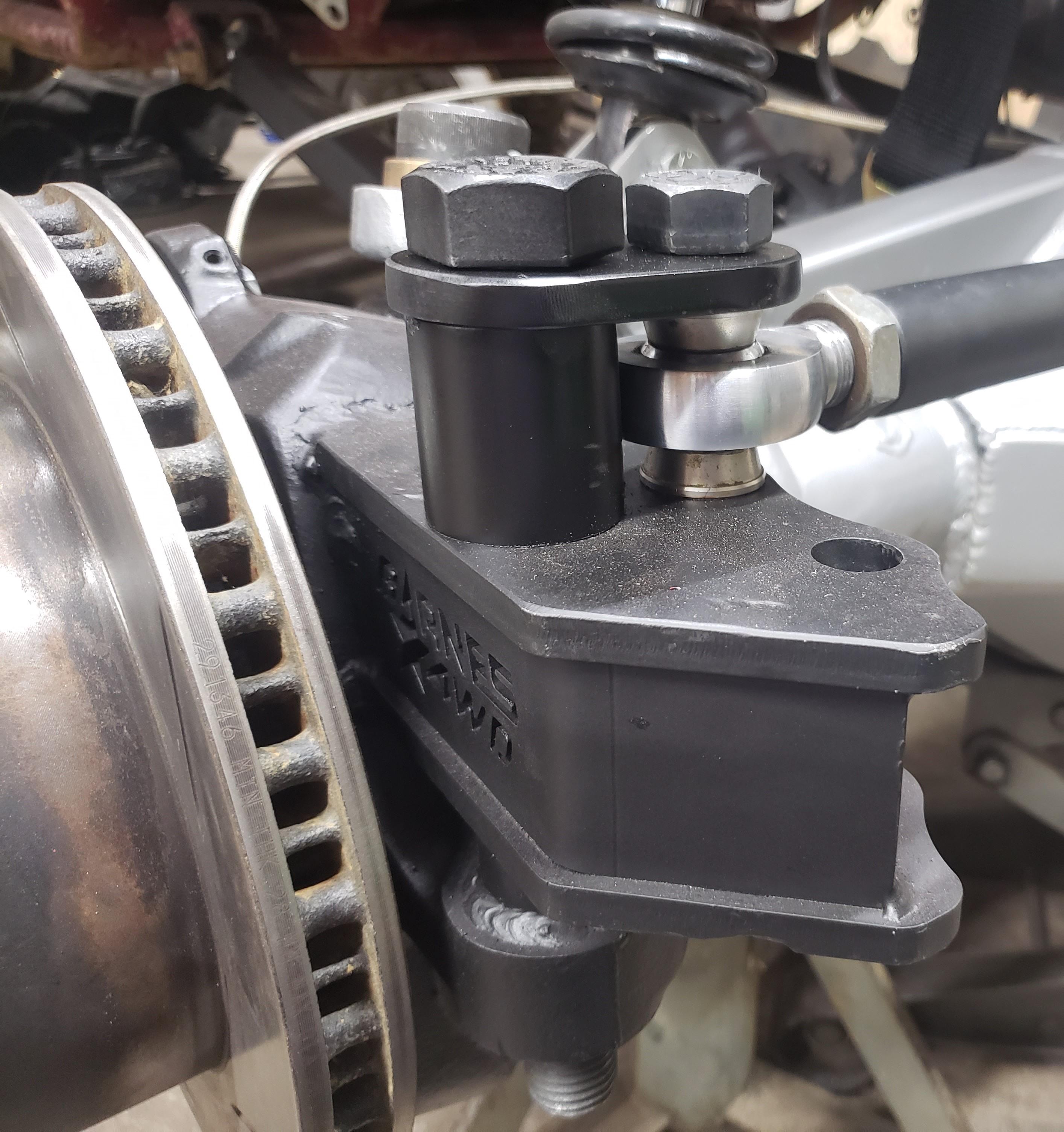

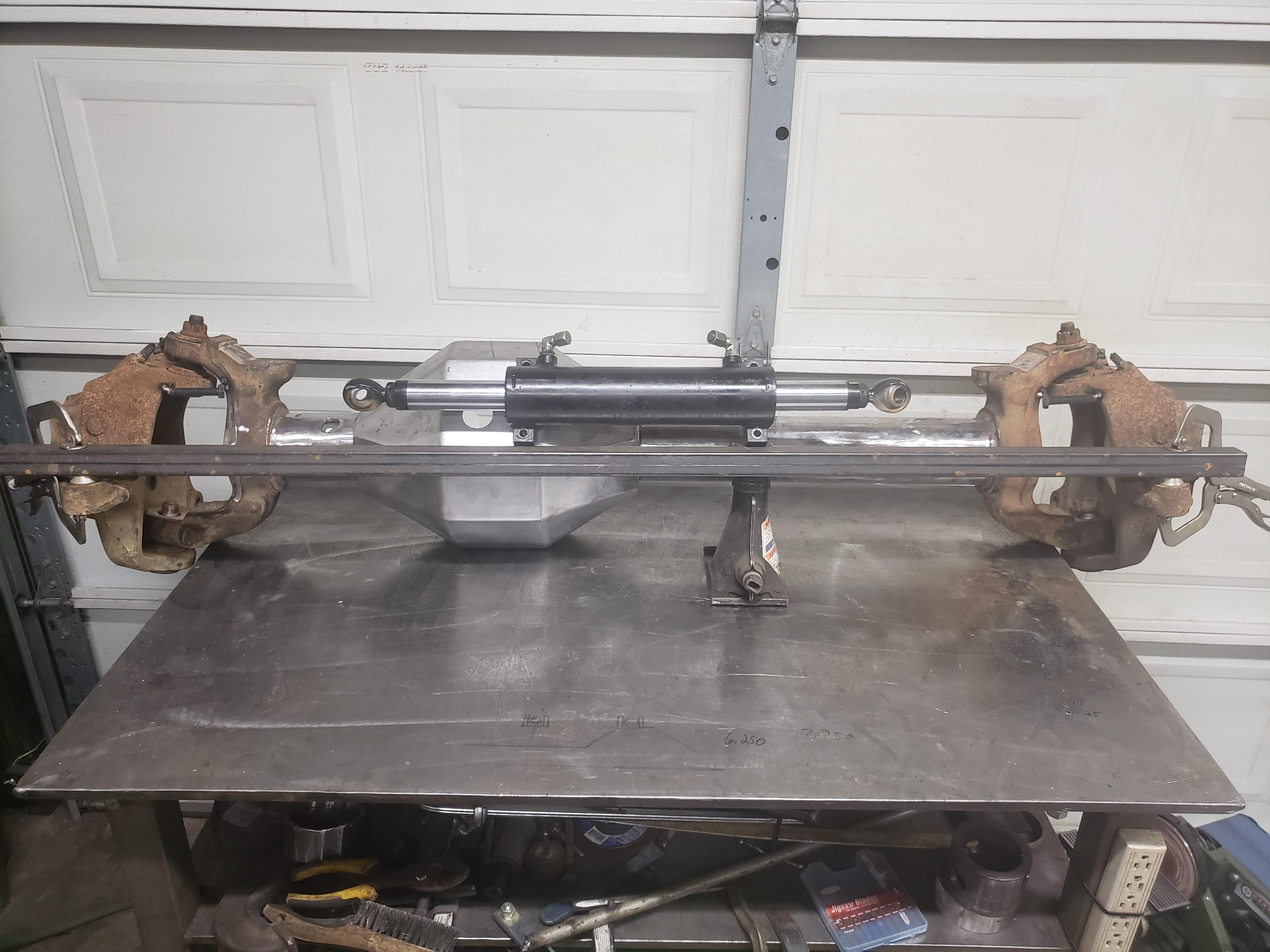

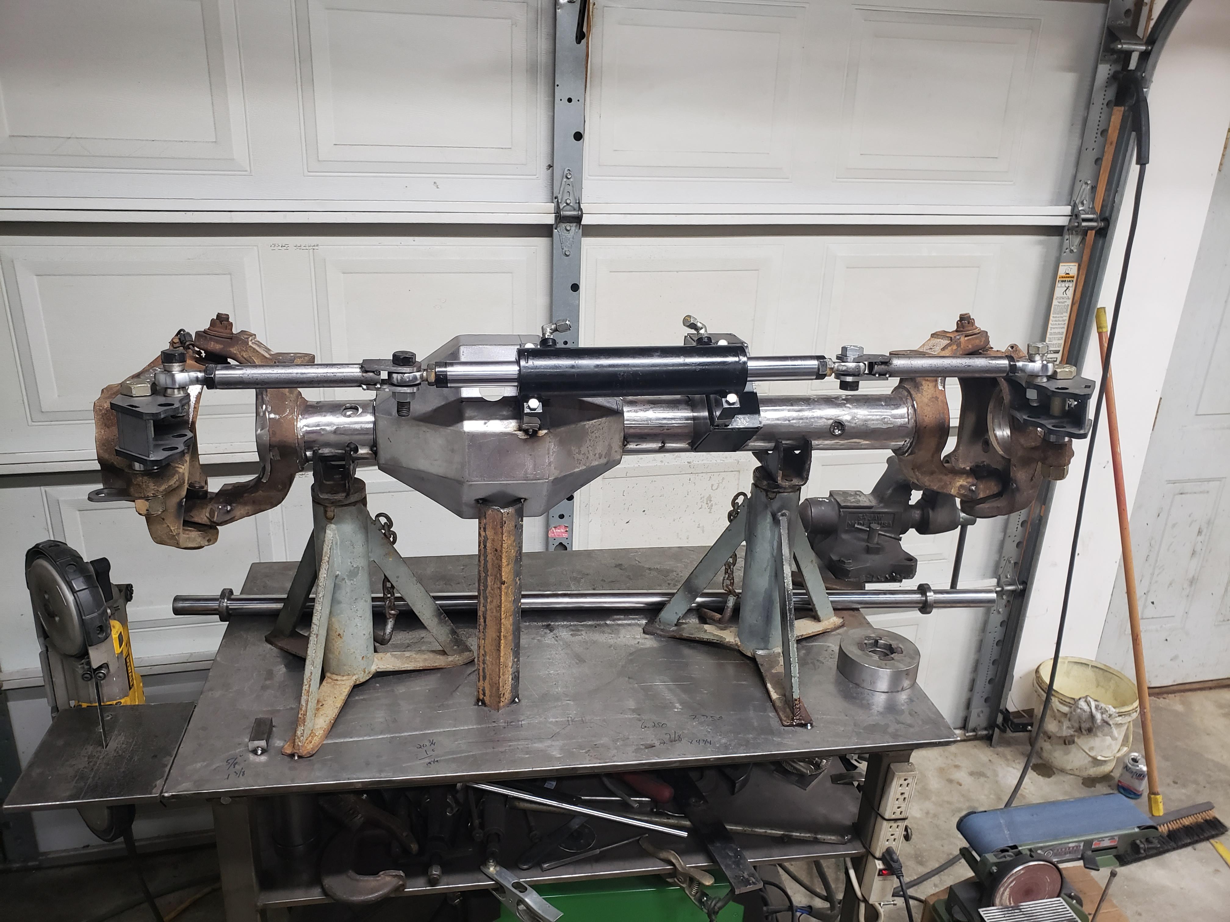

Let me try to get things back on track. Steering yeah it helps to have that. Was hoping to use the oem steering in double shear but that put the cylinder lower than I wanted. Ended up ordering a set of weld on steering arms and still ended up higher but it has worked out.
RustyC
Dec 15, 2010
1,220
To get the cylinder to mount where it fit best, the tie rods ended up on top of the high steer arms. I knew I wanted them in double shear so I cut out a couple of tabs, spacers and sourced 2 longer 1" bolts that pass through the whole assembly. It's not going to win any awards for beauty but if works.
