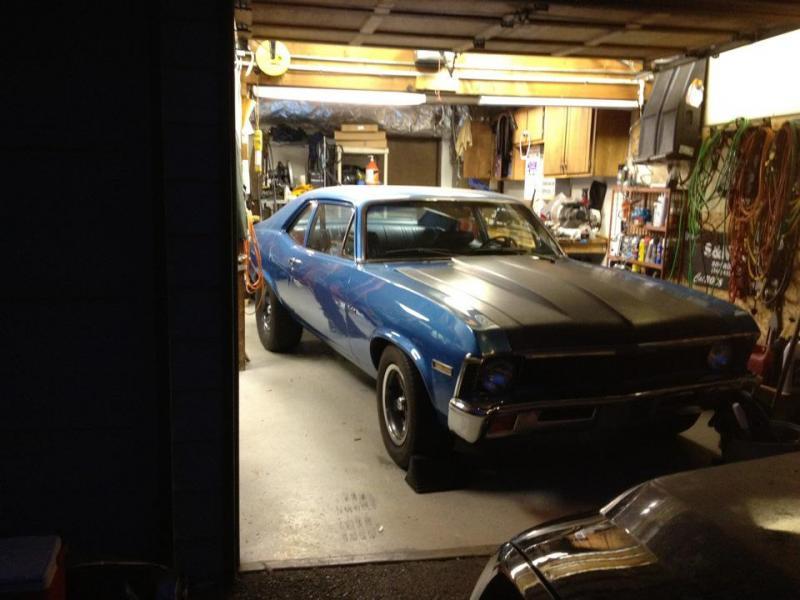

I should be back on the road this week end:cool:Well finally got the D60 narrowed and under the car, it is tight with 275 MT/ET's but I think it will work well. Went from a 26" tire to a 29" so the car has a bit of a rake, I think I like it. Dana 60 narrowed to 59-5/8",3.73, power loc,Dutchman 30spline axle,1/2x20 3" screw in studs, disc brake and a girdle cover.:redneck:
Looks sweet. Looks like your setting it up for 1/4 mile. What kind of time does it run?
That is a great Nova, more details!!!!!!. You wouldn't have a 12 bolt laying around for that thing would you?
Never had it on the track. If it will hook it should be in the mid 11's. Before the rear end swap and tires it was like driving on ice.:redneck:
No 12 bolt, had a 8.5 that just sold to fund the 60. The car is pretty basic, SB383 alum head, MSD ign, big cam and carb, TH350 w/ 2500 stall,dana 60 3.73 gear. Comes in around 425+hp at the crank, need to get it back on a dyno. The first dyno run the carb was pissed and my full advance was coming in about 400 RPM late and the A/F ratio was a little jacked. So there is more tweaking to do to get the full potential out of it, but it is still a kick in the ass to drive.:cool:
