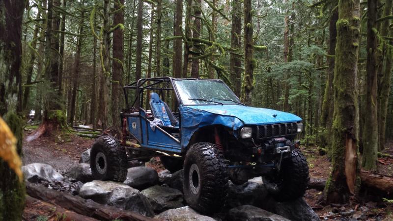

My own toy thang.....

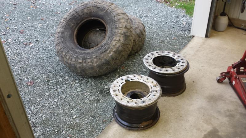

After WAY too long--new meats...
attachment.php

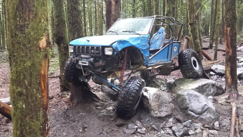

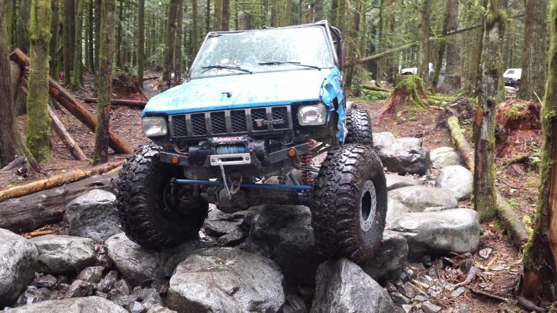

My old skool TR's are beat to FAWK but still holding up and---air :fawkdancesmiley:

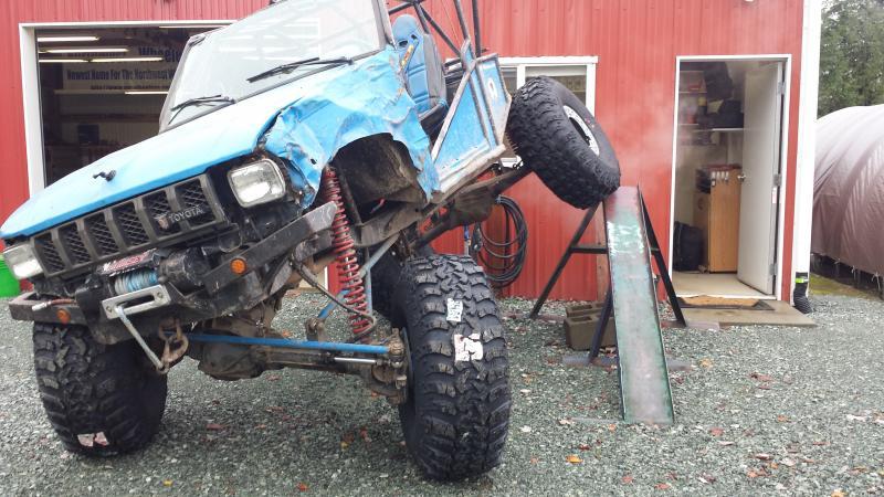

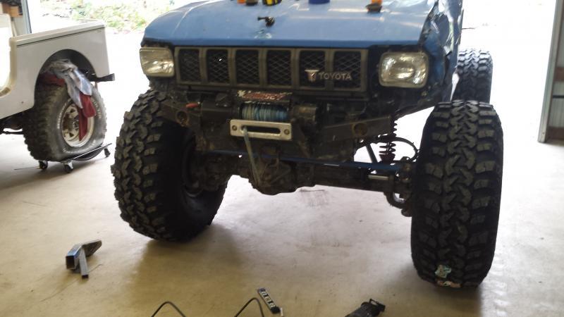

Back when I built the rig I had the d44. When I built the pro-rock 60 I didn't change the link lengths so the front got pushed forward and the 38's barely rubber the front bumper cross support. I knew there would be a clearance issue. I am glad I got my ramp moved from the other shop..

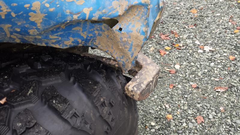

Time for an end of my bat wing bumper... I also had to lop off some of the fender and the area outside the headlamp.
Now this is all temp as the front will be getting redone in phase 2 of the rebuild.

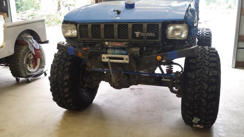

I had one that I could never go under 12psi or it would just burp all the air the rest were 8psi before they burped...
I will say I was extremely pleased with the new meats..

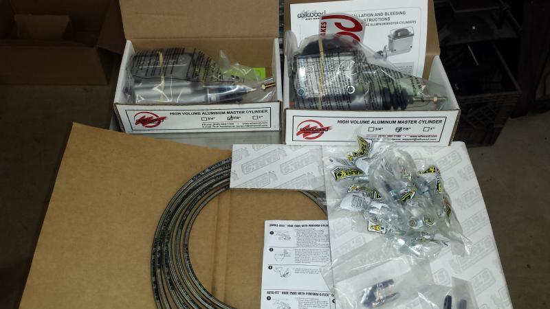

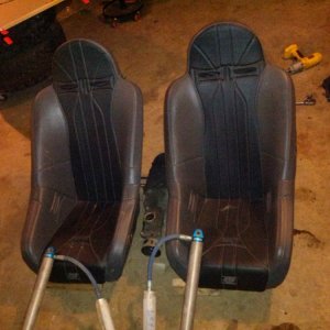

So I am prepping for phase 1 of the rebuild which will be focusing on safety.
I ordered 2 new PRP seats.
I will be reworking the cage and going with a tin top.
New windshield.
I still gotta look at new belts as mine are showing signs of age.
Looks very good!
What size are the new Iroks?
I like the twin Wilwoods.
Soak the seals in brake fluid for a few days though as I have had three new Wilwood masters in the last two years that wouldn't build pressure.
