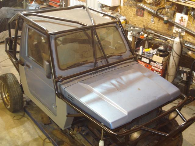

Everybody is intitled to an opinion and here is mine. I have been looking at this for a few days now and finally decided I really dont like it. Maybe its cause Im a sami guy and kinda have my own style. It sets to tall.....the tube work doesnt flow together well. The stock b pillar dead ends .Im also not a fan of exo cages.....really dont like them on a sami. But if tyler is happy with it thats all that matters . :awesomework:

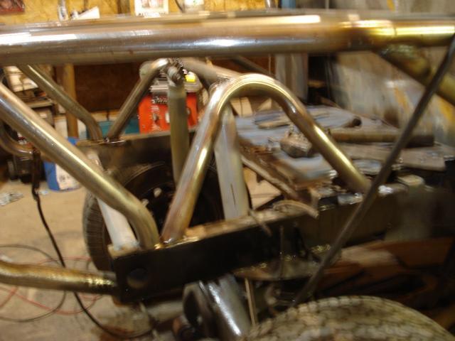

I didnt like the rear at all. The owner wantedshock mounts that went to the stock roll bar hoop. Then later decided he wanted to cage it up. Well the cage looked like it was not very well thought out in the rear. I talked to Tyler about this and he said he didnt mind and was happy with it.:rolleyes:
Well I wasnt.:eeek: Brians comment was the icing on the cake, I called Tyler and told him I was gonna be changing things a little in the rear. He was OK with it and has been very patient.:cheer:
I ripped out the stock roll bar and uprights the shocks were mounted on. I tried to tie them in severall different ways with no luck, so I just gutted it all inside the rear portion and did it the way it should have been instead of "added too".:beer:

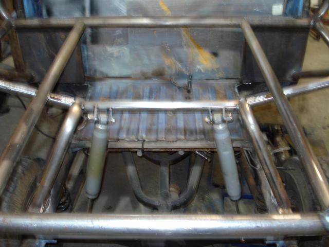

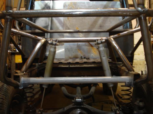

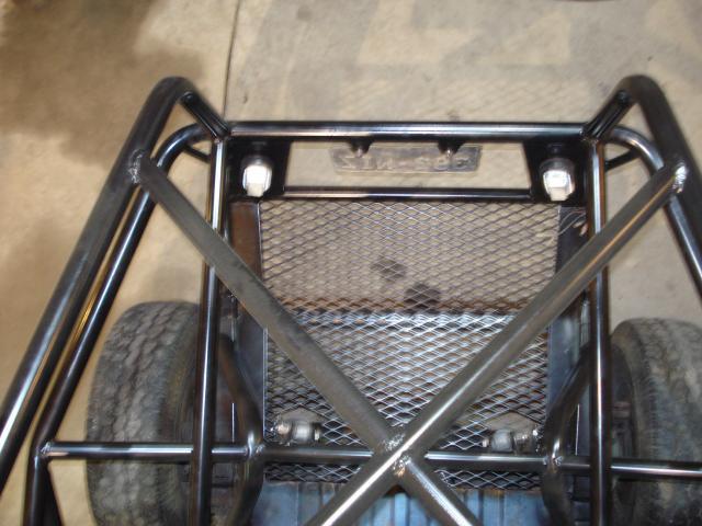

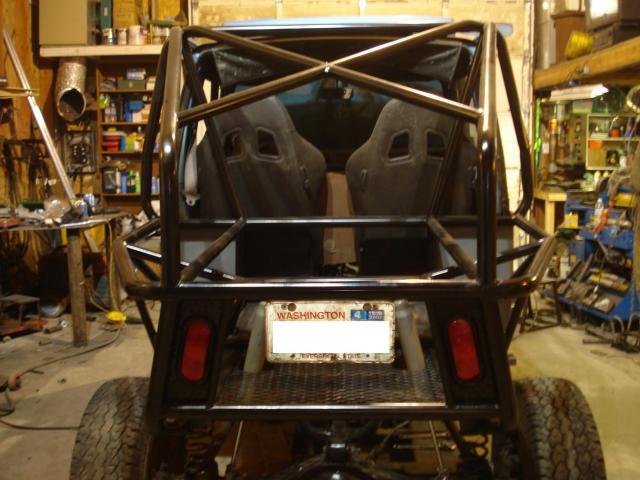

Some pics of the "NEW" rear!:beer:

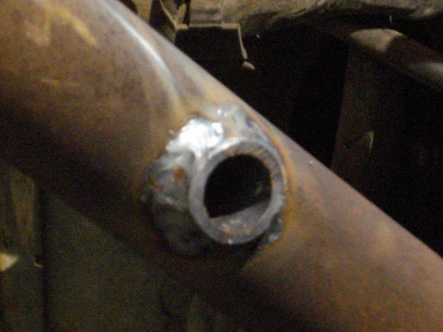

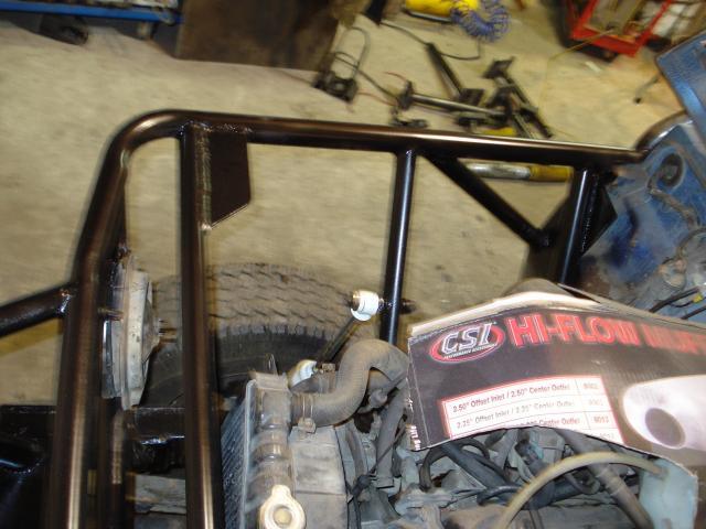

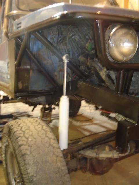

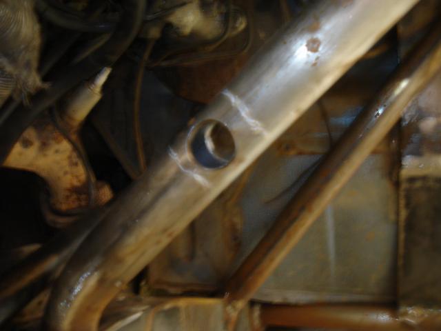

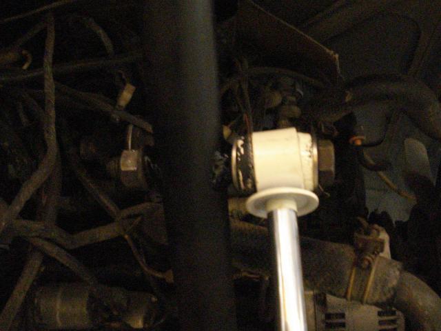

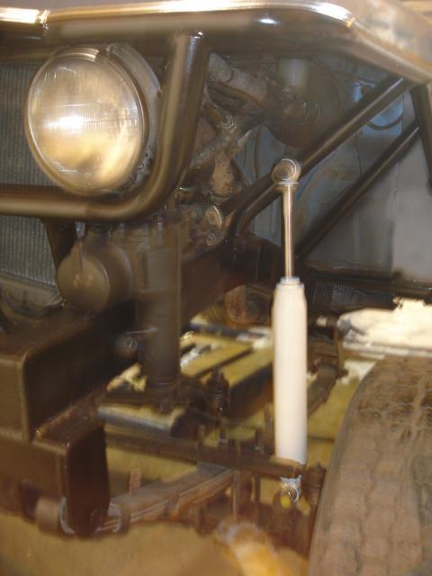

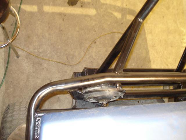

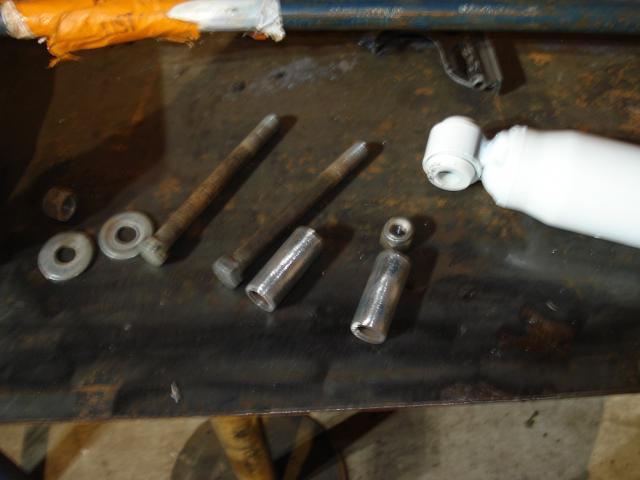

Front shock mounts.
I cut some holes with the hole saw and sleeved them with some tubing for the upper shock mount bolts to go through. Nothing to hitec:cool:
last ones of front shocks, finnished.:cheer:

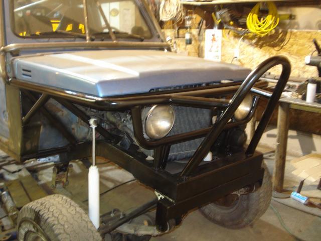

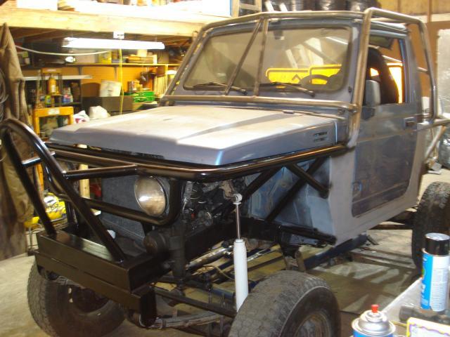

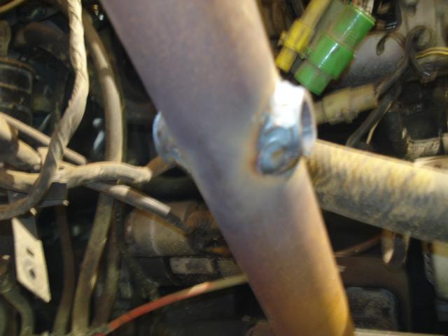

Tyler wanted a tube under the hood and a couple tabs to mount some hood pins too.

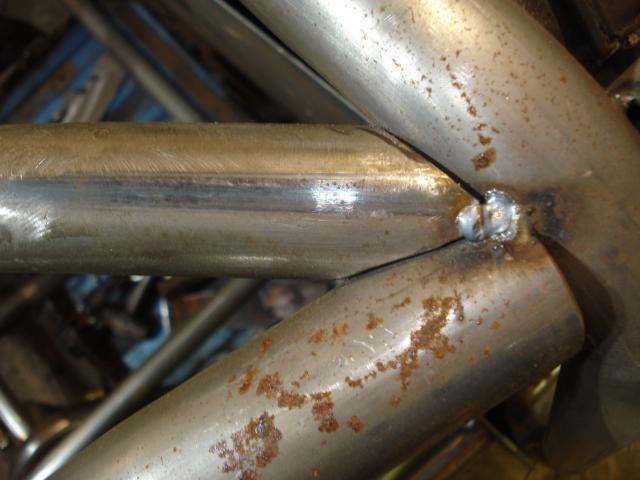

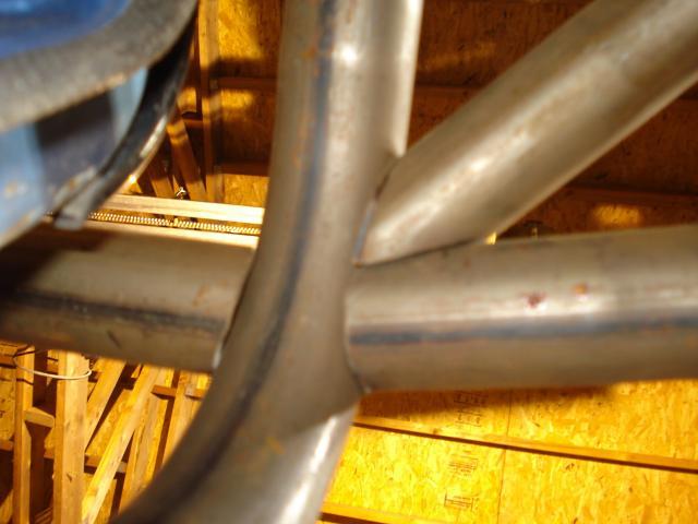

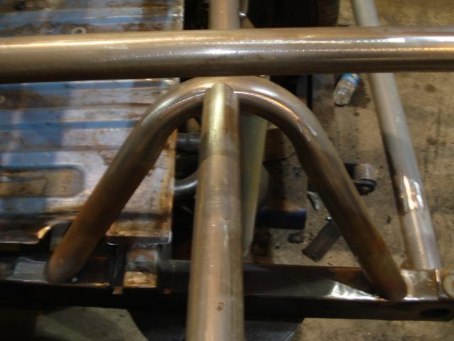

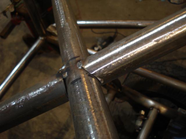

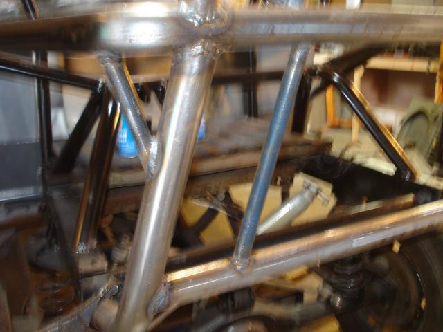

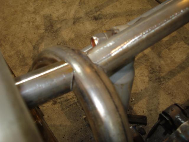

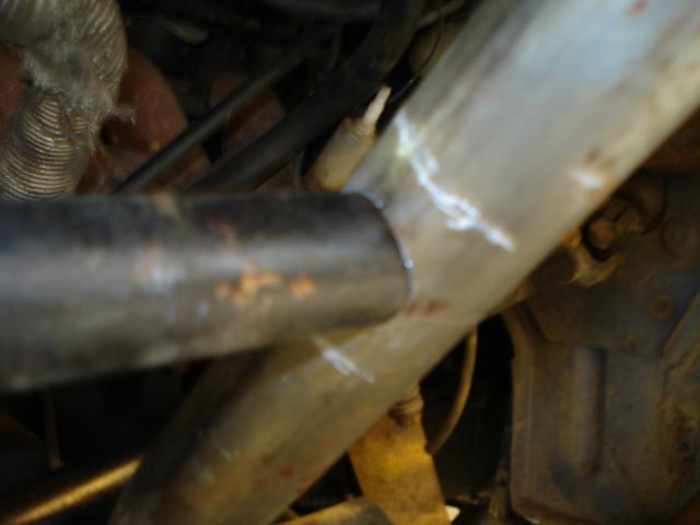

Misc tube fit/notch pics:beer:

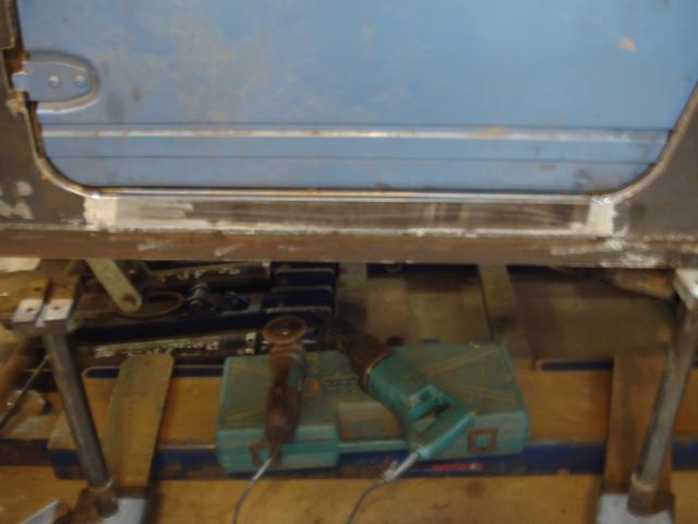

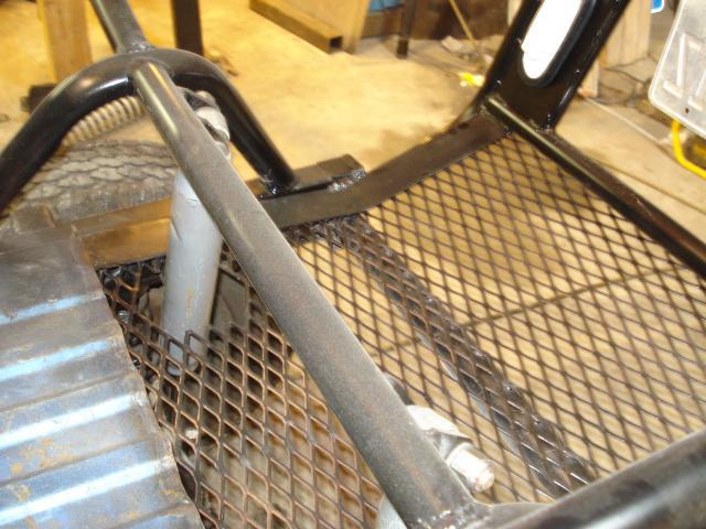

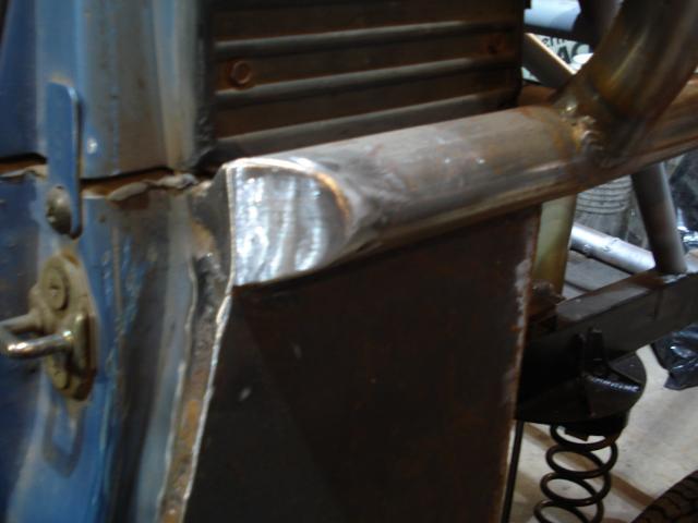

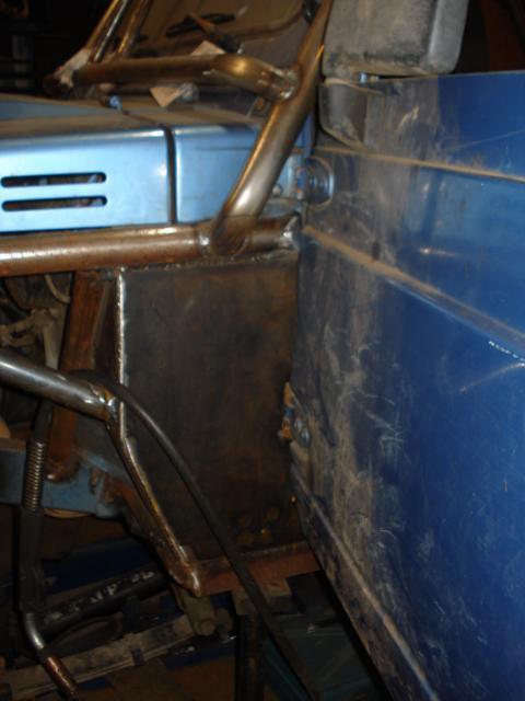

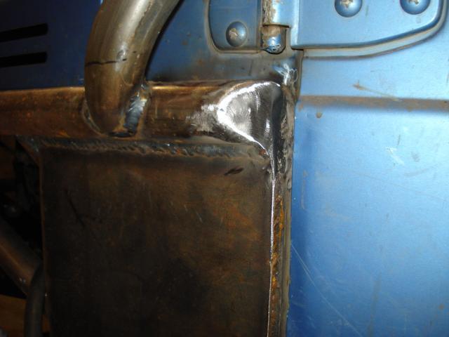

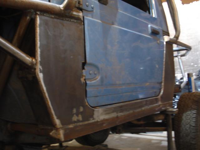

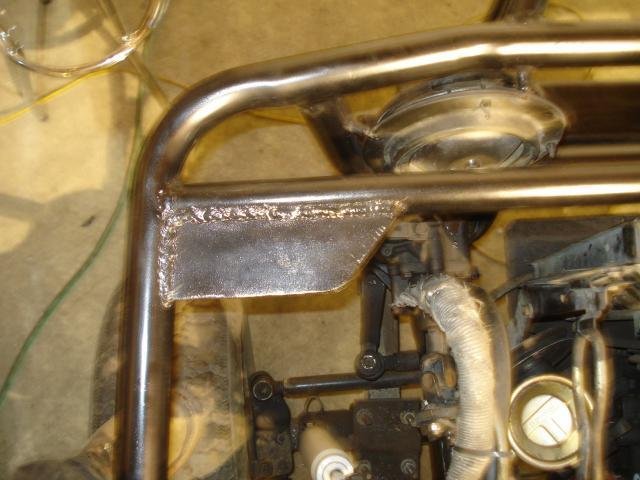

Got the tubes capped by the doors so they poen a full 90 degrees and are still removeable. I also finnished up the plating on the rocker area.:cheer:

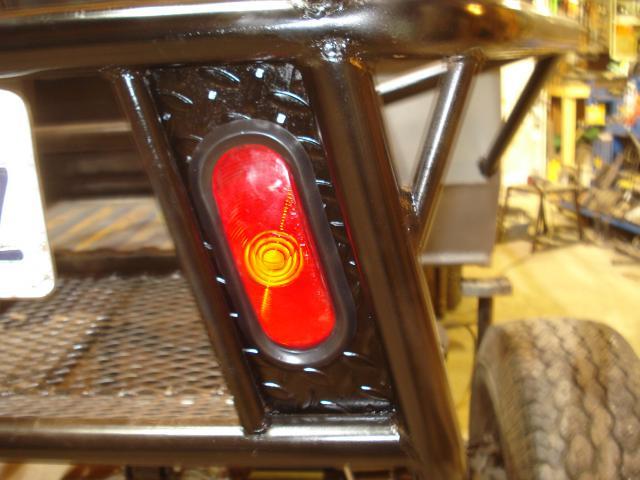

Tail lights. A few pics of the lights and cooler/tool area!:awesomework:

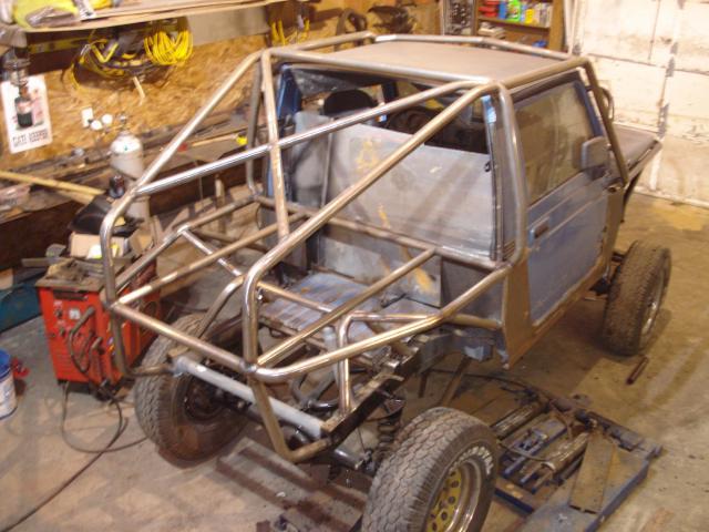

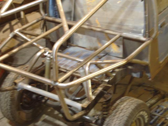

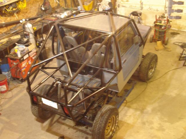

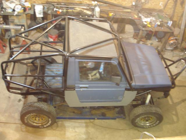

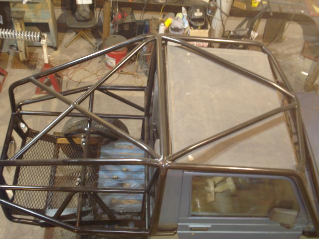

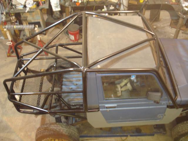

random shots of cage.

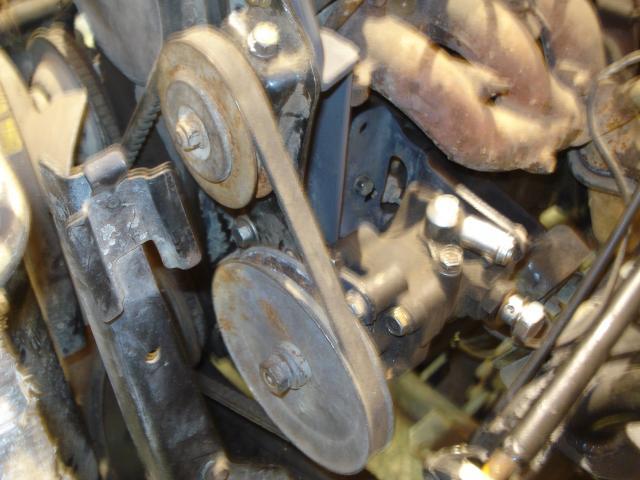

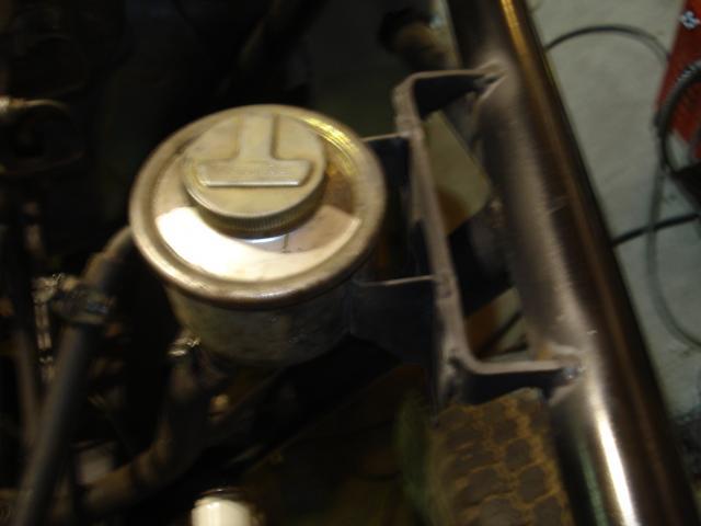

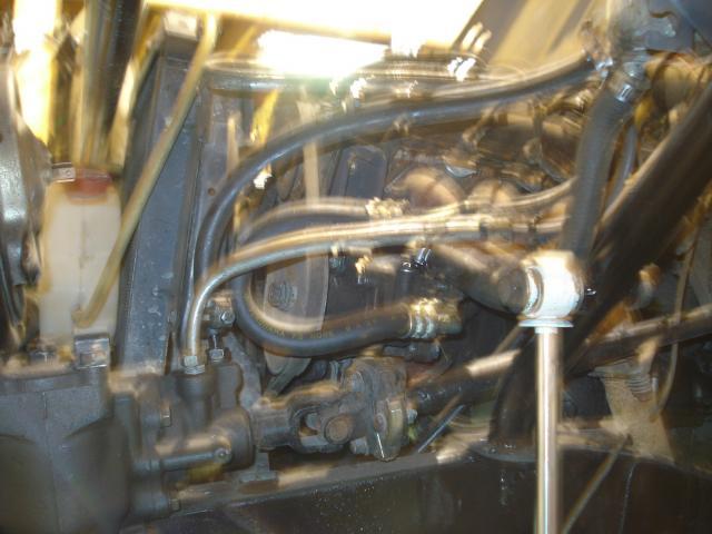

Heres a couple of the toyota power steerin mount and idler. One of resi too.
