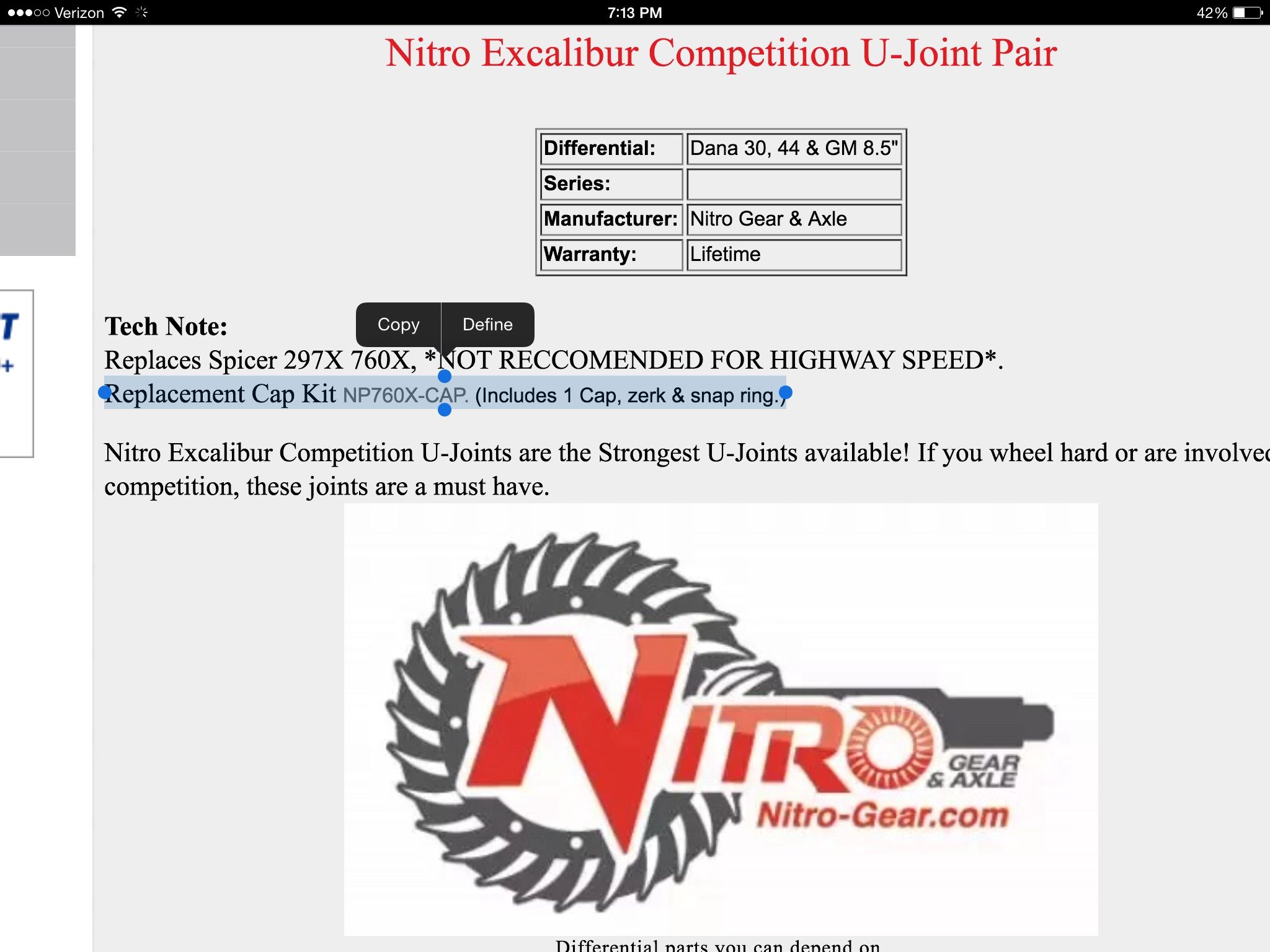

May be a dumb question but hey never know. I have these joints in my front axles and while doing some work today noticed that one of the caps on the joint was missing. Does anyone know if I can buy just the caps and clips or do I have to replace the whole joint. Hate to spend $200 for just needing a cap. Thanks for the help

East coast gear supply is a big Nitro dealer, good people and fast shipping, they are in NC
Ordered a whole kit today. I got four caps coming but only need the one. If they are in before next weekend I will have them at Hawk pride if anyone needs an extra cap.
