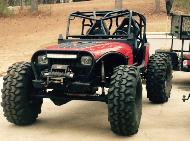

14" stx's all 4 corners.. Bottom chamber anywhere from 120- 140.. And the top, whatever it takes to get the ride height I want. Usually around 240ish I believe. I go higher then let some out after cycling suspension. I run mine kinda low also. I know they say the best performance is with half of the shaft showing, I have tried it and haven't seen any better performance. Just higher ride height that I wanted.. I adjust mine a lot. Certain parks I change it.. Lower for mostly hill killin and raise it a lil for more rock obsticles. Either way I've never been disappointed.. Here it is with my 40's ..

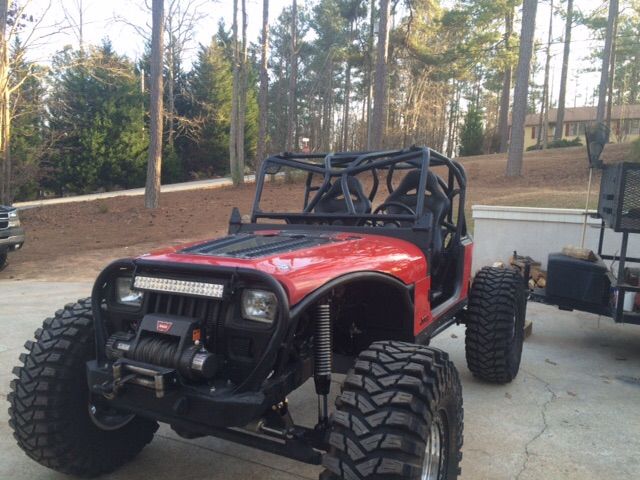

I have an 05 TJ, D60's front and rear, 5.38 gears, Atlas, 350 RamJet sitting on 14" ORI's all corners. I have the front lower set at 180 and the rear lowers at 170 and have 7" of chrome showing for all four.

Very nice! I've never put that much pressure in my lower chambers.. I'm a try it and see what it feels like. Sometimes I think 140 is too stiff? Then I read some people run and 80 to 100 in the lowers!! And can imagine they would bottom out pretty often.. That's a nice jeep.

I only went that high because I had a bad torque converter and while setting idle my jeep would try and drive through the brakes and would twist like crazy. so I juiced the struts up to counter the twist lol, but when crawling the rocks it just seemed to handle really good so I left them there. I started with a 100 in the bottom at all four but at that pressure I was getting extreme body roll. So then I set them at 150 and the jeep felt pretty good at that point but I was still getting a little twisting sitting there with my brakes on. I have since replaced the torque converter with a higher stall and the twisting issues have gone away. I may take my struts back down to 150 in the front and 160 in the rear.
And your jeep looks cool also.
