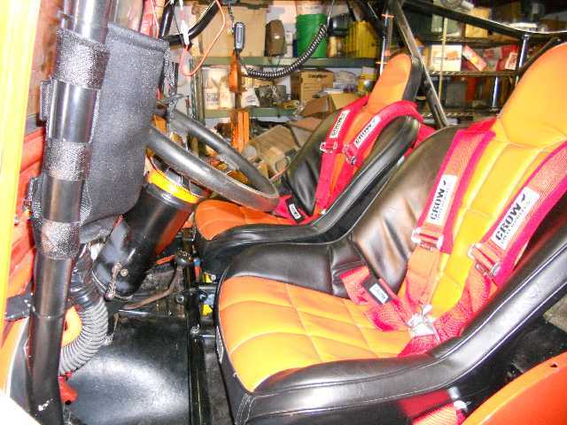

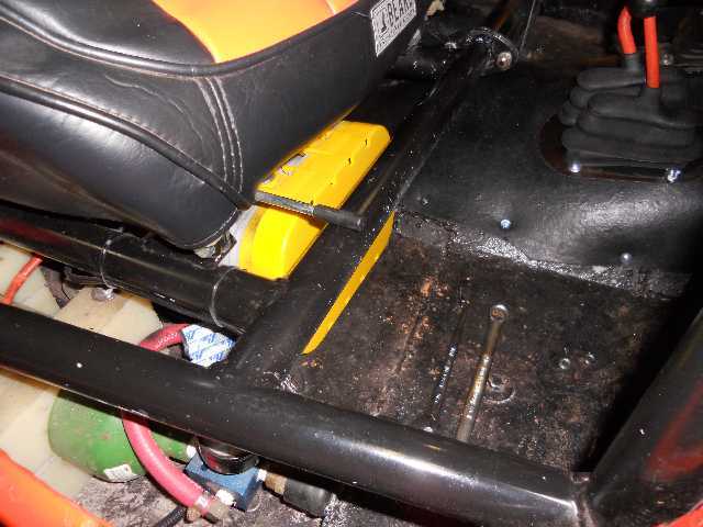

It only took about 4 hours or so but the seat mounts are about finished
Should have the cage 100% finished today :cheer:

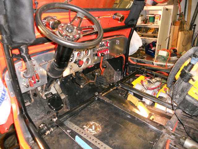

Bit more done

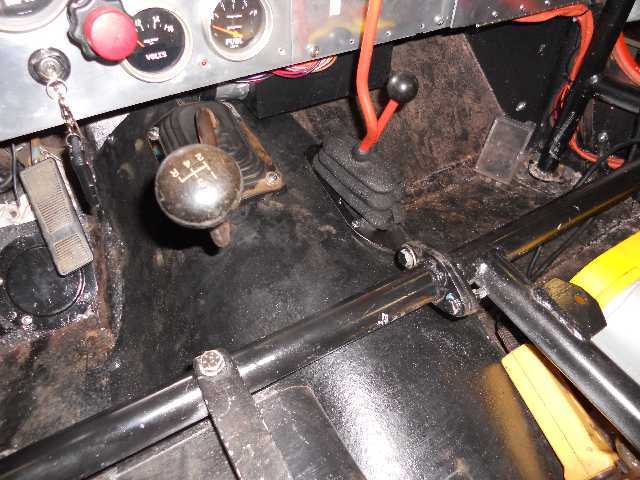

Jim is putting a heater in the rig and wanted to make sure he had defrost. He had a great idea to use the dash bar as the vent. He said he would drill those holes for it later but I knew it would have been a pain in the ass so I went ahead and did it before I welded the tube in:

Just a little FYI you would have been better off using a pvc vent tube over the steel. the steel is a huge heat sink and will suck the hot air away. I know from other jeepers from my side. the plastic works better! Nice build though!
Probably so, but if this doesn't work he isn't out anything. :awesomework: He could just put a hose pib on it, drop the windshield and have a portable sprinkler :cheer:

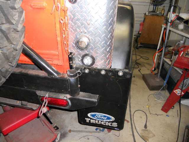

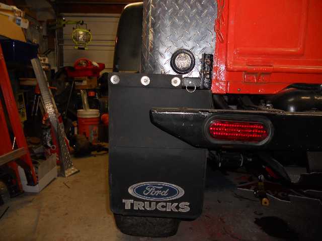

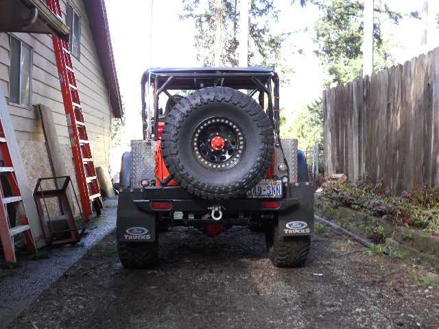

Also got started on the tire carrier:
Now we have one tire rack:
Jim even got a piece of the my old Toyota :booo:
The start of the hub mount. Pick a circle any circle :haha:
Hate when this happens
All better ****ies
Hub mount finished up:
Test fitted the tire and about popped a nut. It even spins :haha:
Finished up by making the pins to keep it open and shut :awesomework: Put little cables on the pins so they can't get missed placed at the wrong time.
