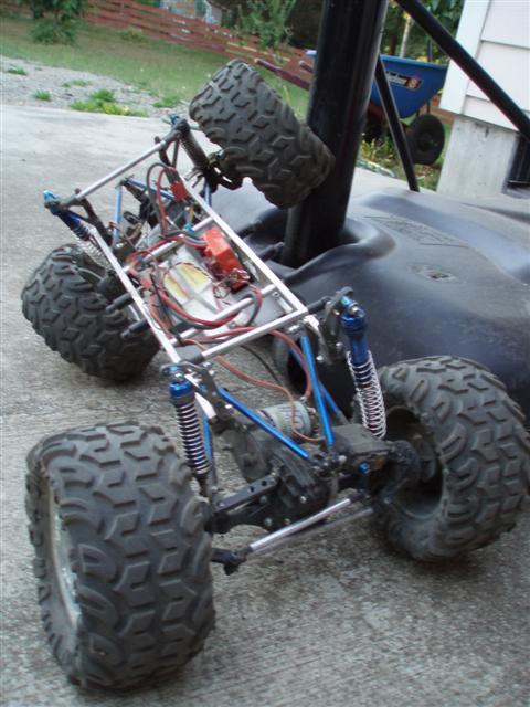

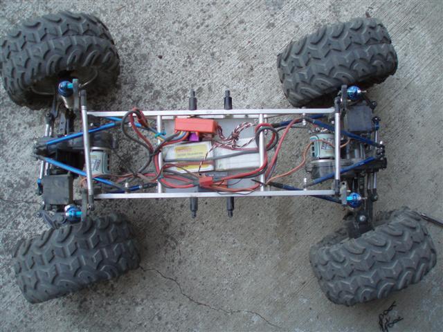

That's funny, I was thinking of starting a pics thread, logged in, there it was. Amazing! Here are some shots of my Clod. It started as a 2.2, so there are some shots of it in that configuration, and the "grown up" setup that it's currently in.
Specs:
JB Locked axles
Integy 55 turn motors
Super Rooster
Losi LST tires
RPM Stable Maxx chrome wheels dyed black
Wheel adapter / widners by Ace
Airtronics M8 Radio
Hitec 645MG Servos
NN Chasis from thecrawlerstore.com
Losi XXXT rear shocks and springs
Here is how it looked after the initial build
Body off shot
After the first set of upgrades
And the current configuration

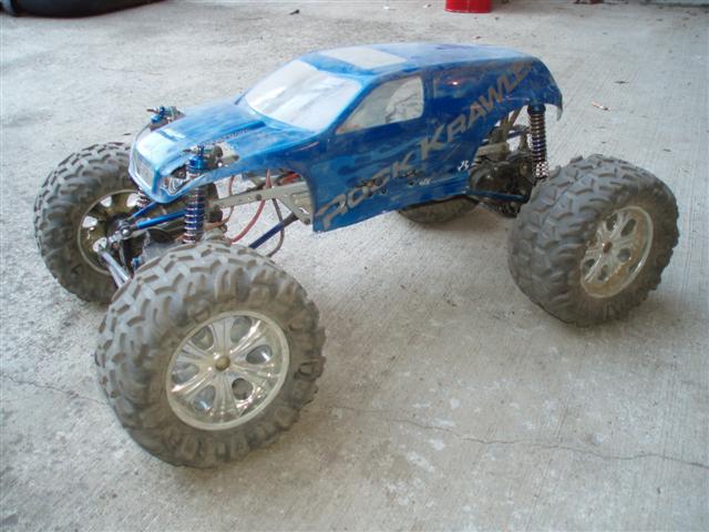

Here's a pic of my TLT crawler. Actually it's my daughters, but she let me borrow it for goldendale. I haven't built mine yet, so I'm doing some serious testing on hers. I just put a set of masher2k's on it this week. Wow what a difference. Red Rocks suck.
SW2
65 turn integy
17/84 gearing
8 cell batteries
GM VR4 ESC
Maxx shafts
Masher2ks Stadium Blitzer wheels
Pede tranny
JR 125 servo[142 oz.in.@6volt]
Crawler store wideners

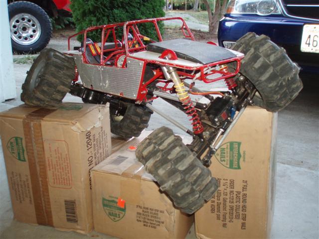

Here my stuff
The Wagon:
Clod axles
55 t motors
custom links
JR servo's
super rooster 2
Spectrum reciever
unknown shocks:crappy mounts
ETC...
DAN DIBBLE REPLICA:
!!!!!!BUY ME!!!!!!
MOGS:My Next build
E-maxx diffs
Teracrusher knuckles
Tamiya prop joints/solid stock shafts(originally had cut down e-maxx drivelines/they broke about every 20 sec.)
Don't know who originally made them.

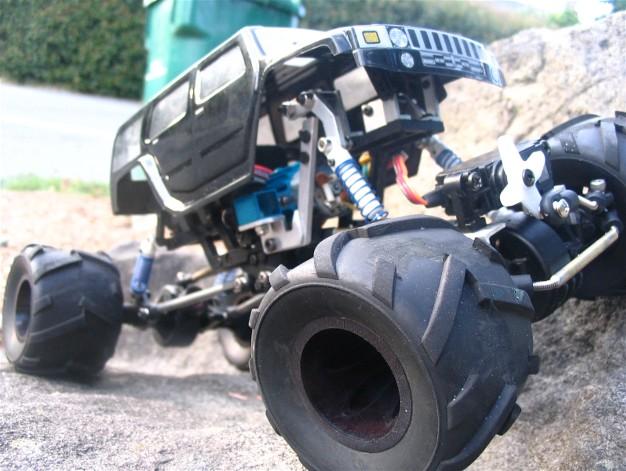

Here is my fleet, for the most part. They are all VMG's. The black Hummer I built for my father-in-law, so it isn't really mine. The red and black one I call my son's and the Dodge Dakota is my main truck. It gets all the best goodies.
Thay all have MPI gear reductions, custom 3-links suspensions, bearings, custom steering mounts and extended drive shafts, including all the chassis mods needed to make it all work. Any aluminum you see was made by hand using my drill press, band saw, hand file, digital micrometer and Dremel.
The Hummer is what I would consider my stock truck. It is the fourth I've built, it represents the minimum mods I make to turn a VMG into a crawler. It has narrowed wheels and modified stock tires. Steering is an HS81-MG. Novak Spy, Losi AM radio, this one utilizes actual battery packs.
The SUV body one has an extreme stretch on the front, about twice as much as the rear. It has cells strapped in all over the chassis to keep the CG low, and hard wires into a pack. It runs MLST wheels and tires on VMG wheels as adaptors. It's got a Futaba MC230CR esc and an MN48 steering servo.

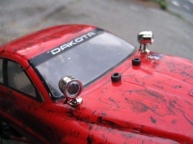

Now for my baby. Obviously a poser shot, there is no electronics or drivetrain installed at this time, as it's going through a redesign where it's getting a new MLST transmission transplant. The lights there are metal, work, and meant for RC boats! It runs a Spy as well, and a similar battery configuration as the last one. It was 4 wheel steering, which was awesome for crawling, but would never track straight, so I swapped back in a straight axle. It's got heavily modified Stampede wheels to get the most possible offset and ProLine Dirt Hawgs. The body is a discontinued Pro-Line Dakota RT body, I wish I could find one or ten more of them! It also has old-school Venom oil shocks and super weak springs. Articulation is perfect and it'll crawl damn near anything.

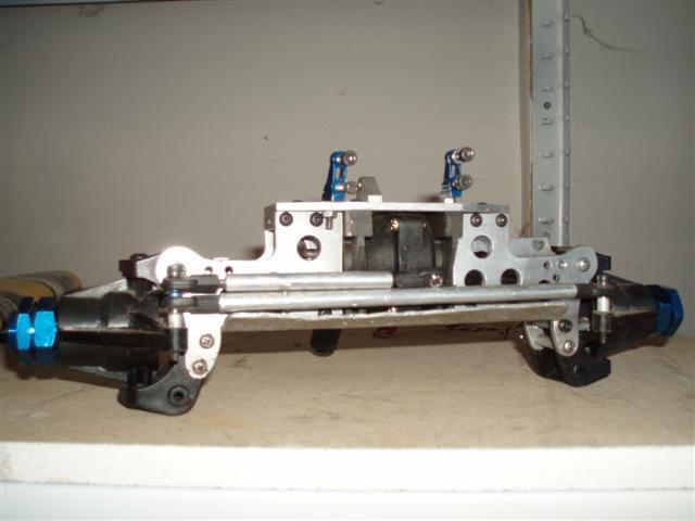

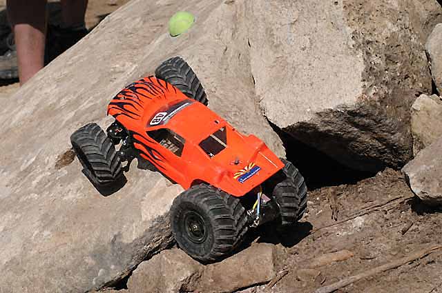

This is may latest 2.2.
Clod axles
Torsion stick
grover style dig
3rd at Nationals in moab '06

NICE PAINT JOB. DID YOUR DAUGHTER PICK THAT COLOR OUT. i'T'S PRETTY.

Congrats at the nats
Would you be so kind as to post a body off shot and maybe a description on how you do your dig. I am getting ready to put a 2.2 clod hump torsion together and really would love to have a dig on that one also
